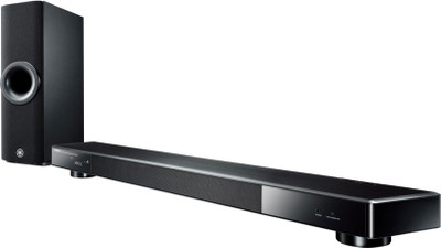

The new Yamaha YSP-2500 retails for $1,000, and sits in the middle of Yamaha’s Sound Projector range. The YSP-2500 features their Digital Sound Projector technology that beams sound off walls for discrete virtual surround channels without extra speakers. In addition, $1,000 nets you a wireless subwoofer, a CD-quality aptX Bluetooth connection, HDMI with audio return channel, HD audio decoding, and an IR repeater on the back of the unit for those setups where the sound bar might block the IR receiver on your display.

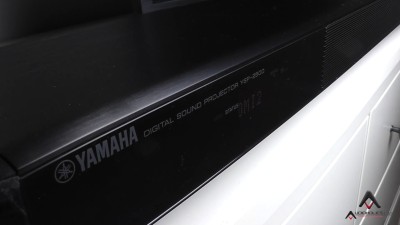

The YSP-2500’s main unit features a brushed aluminum cabinet for a high-end look, and measures 37-⅛” wide by 5-⅝” deep by 2-⅞” tall with the adjustable feet (2” without). The unit weighs just shy of 9 pounds, and can be wall mounted with an optional bracket. I personally think it would be a little gutsy to wall mount the YSP-2500, as the resulting fixture would appear rather shelf-like and become a potential resting spot for visitor’s drinks. On the other hand, by the time you mount a display above it, the thickness of the TV mount and display should make the nearly 6” deep Yamaha seem less extruded.

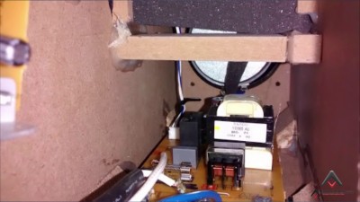

The included subwoofer is intended to sit in a horizontal or vertical configuration, and measures 5-¾” wide by 17-½” tall and 13-⅞” deep. It weighs 17.4lbs, and connects simply and wirelessly, though a wired connection is also possible. The subwoofer features a front-ported design, with two 4” drivers, and a 75 watt amp (5 ohms, 10% distortion, 100Hz signal). The cabinet is constructed of ½” MDF with moderate bracing; given the small size and modest output, it remained sufficiently inert. I was able to get a few spy shots by peeling back the amplifier plate and wiggling my cell phone inside, but I couldn’t completely dismantle the subwoofer for a more thorough inspection without fear of damaging the unit.
The Yamaha YSP-2500 Subwoofer internals.

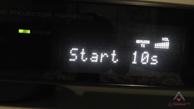

Setup was very simple. I unboxed everything, provided power to the main unit and subwoofer, and turned the main unit on. After a brief moment, the main unit and subwoofer discovered each other, wirelessly linked, and I was ready to playback full-range sound. Optimizing the system was a simple as connecting the included mic to the front of the unit, setting it at head-position (using the included cardboard tripod if needed) and pressing enter to start the auto-setup routine.
One thing I really appreciate is that Yamaha’s auto-setup gives you 10 seconds after you start the routine before the test tones and measurements begin. This allows you to leave the room, saving your ears from the grating tones, and preventing you from polluting the measured responses. When it’s all done, the YSP-2500 plays a loud musical chime to let you know that it’s safe to return. This simple user convenience is much appreciated, and I’d love to see other auto-EQ developers implement a delay and start/finish chime.
The Yamaha YSP-2500 Auto-Setup features a 10-second start delay.

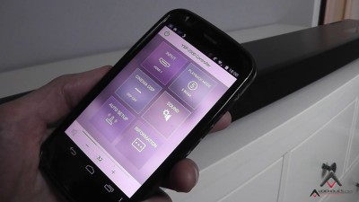

The physical remote is a little busy, but does a good job of assigning individual buttons to specific features to keep the user from having to dig around the menu system. The volume controls are easy to find by touch alone. Yamaha has also authored a “Home Theater Controller” smartphone app which I tested on Android, though it’s also available for Apple products. I found this to be one of the better smartphone controller apps that I’ve tried. A simple start page consists of 6 tiles that are easy to trigger, intuitive, and don’t send you multiple levels deep before you find the function that you’re looking for. This is the first app I’ve used that could have me permanently mothballing the physical remote.
The Yamaha Home Theater Controller App is well-designed and available for Android and Apple.
