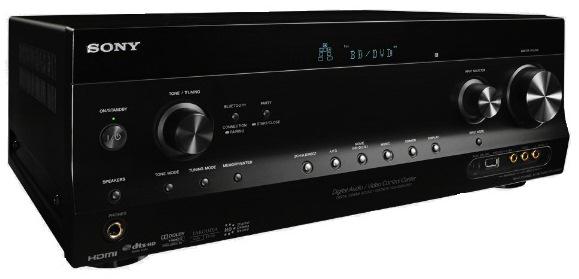

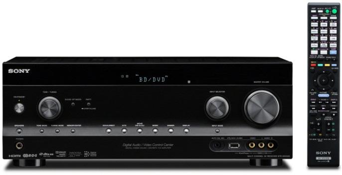

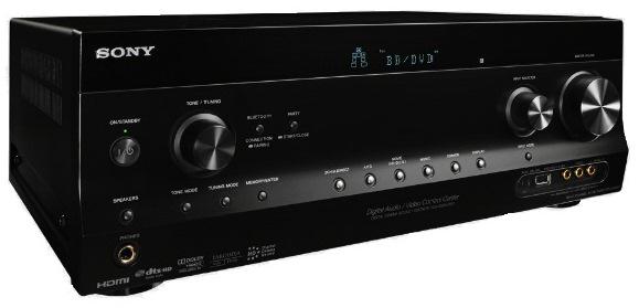

The $500 receiver market is extremely competitive. It's a high enough price point so that receiver manufacturers can start playing around with innovative technology, but not high enough to make a no-compromise product. This year, Sony chose to focus their funds on creating a feature packed receiver. And the STR-DN1030 packs an impressive list of features, most notably: built-in WiFi, Bluetooth, Airplay, HDMI upconversion and a new user interface. This means that, on paper at least, the STR-DN1030 looks quite impressive. But how does it actually hold up during operation? Do the features work well? And what was given up in order to stuff it with so many features? In order the answer these questions, we ran the STR-DN1030 through its paces during our review. Keep reading for the full analysis.
Build Quality

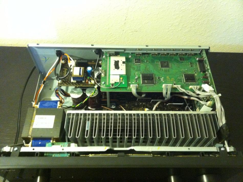

Sony’s marketing material touts that the STR-DN1030 is built with “audiophile” parts, including custom capacitors, a “powerful” amp board, and upgraded transformer. Rather than take their word for it, I opened up the receiver to take a closer look. I found that it was, well, unsurprising. This receiver is built about on par for a $400-$500 unit. The caps and transformer are good size for its class, but nothing to write home about. Although they claim 145wpc x 7, that would seem to be (as you'd expect) in line with FTC specs and not an all-channels-driven number.
Sony STR-DN1030 with top panel removed
One of the main reasons I was excited the get the STR-DN1030 in for review was its feature list. It is the first $500 receiver to have built-in WiFi and Bluetooth. Of course, other companies have offered Bluetooth dongles for a long time, and WiFi can be added to any receiver that has an Ethernet jack. However, the fact that Sony put both technologies into a $500 receiver when almost no one else is even putting them in receivers that cost twice as much, is quite impressive. Additionally, the STR-DN1030 has built-in HDMI up conversion from composite and component sources and comes with an auto setup mic. It also supports up to a 7.2 system, 3D, Dolby Pro Logic IIz, and HDMI standby pass-through. The only features that are notably missing are 4K support and powered zone 2 outputs. The lack of 4K support doesn’t bother me because anyone who can afford a 4K display should not be buying a $500 receiver. It would have been nice to have powered zone 2 outputs, but it is understandable that Sony had to cut something to keep the receiver affordable. When compared to other similarly priced receivers on the market, nothing else comes close to having as many useful features. Sure, some receivers have more HDMI inputs, dual HDMI outputs, or 4K support, but the real question is, will those features be used by consumers?

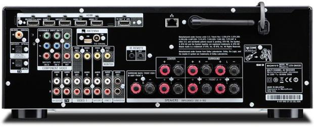

On the rear of the receiver are: 5 HDMI inputs, 2 component and 2 composite video inputs, 2 optical and 1 digital coax input, and 4 stereo audio inputs. At a time when most manufacturers are slashing legacy inputs in favor of a ridiculous number of HDMI inputs, it is nice to see Sony still supporting older equipment. At this price point, legacy is likely going to still be around.
On the front of the receiver is a USB port for use with iOS devices, select Sony MP3 players, and USB flashdrives. There is also a composite video and stereo audio input. I would have liked to see an HDMI input on the front as well, but I suppose one can’t have everything.

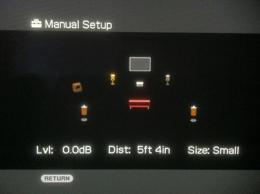

The speaker setup portion of the GUI is also confusing, but worked well after I got used to it. In order to select your speaker layout, you scroll through a list of preset options. Instead of preset layouts, I would have liked to see a list of speakers with enable/disable or yes/no options next to each speaker, but that is just my preference. For consumers who don't understand all those "channel" designations, having an icon-based solutions is actually pretty sensible. The receiver does support surround back speakers or front height speakers, but not both at once. If you are only running a 5.1 system, you can assign the extra set of speaker jacks to “speaker B” or “bi-amp” options, which is a nice feature. Each speaker can be fine tuned in .5db increments for level, 1” increments for distance, and 10Hz increments between 40Hz and 200Hz for crossover frequency. I was impressed that Sony chose 10Hz increments for crossover adjustment all the way from 40Hz to 200Hz. I recently reviewed the Yamaha RX-A2020 (a $1700 receiver) that didn’t have even have all those crossover options. As expected, the two subwoofer pre-outs are treated as a single output, meaning there is only a single distance and level adjustment.

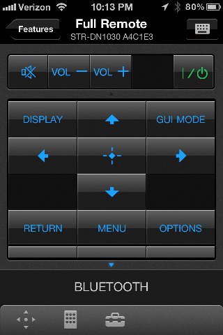

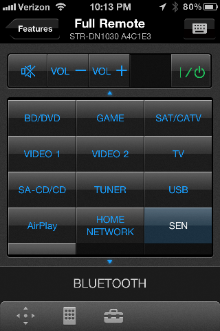

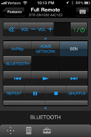

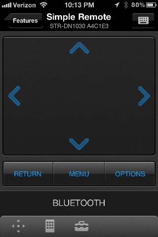

Sony’s Media Remote app is meant to turn your iOS device into a full-fledged remote control. It isn’t specific to the STR-DN1030, but actually supports a whole host of different Sony devices, such as their Blu-ray players and TVs. Depending on what type of device you are controlling, the app will give you a different set of options. Given that I was controlling the receiver, it gave me the choices of simple remote, full remote, and keyboard. The simple remote is a directional pad with return, menu, and options buttons. The full remote showed a list of almost every button on the original Sony remote. In order to see all of the buttons, you have to scroll up and down on the iPhone. Neither of these remote options worked better than the original remote, so I didn’t use the app often. I was excited to use the keyboard option in order to enter text into the receiver, but it just kept giving me an error and I never could get it to work. The Media Remote App does not show you what is currently playing on the receiver, or give you advanced control over network features. The Yamaha AV Controller App, for example, tends to be easier to navigate and allows for complete control, including browsing of DLNA devices and attached USB drives. The Media Remote App is far behind what other manufacturers offer.

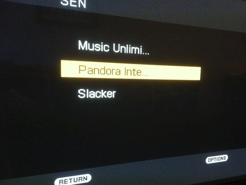

Sony’s decided to place vTuner (Internet radio), Music Unlimited (Sony’s music store), Slacker, and Pandora all under the umbrella term Sony Entertainment Network, or SEN. Fittingly, by pressing the “SEN” button on the remote, a list of the services is brought up on the TV. By including these services, Sony opened up the door for hours and hours of free music listening, which is something we at Audioholics are all for.
Before you can use the services, you must register the receiver with Sony. After that is out of the way, you can sync your current accounts with the receiver. Unfortunately, my experience using each of these SEN features was negatively impacted by a sluggish response, limited visibility of text (largely due to scrolling), and lack of visual cues to assist in menu navigation. Once I became used to the menu system, it worked decently, or maybe I just learned what services to avoid using. The sound quality of each service was great for background music, with the exception of some vTuner stations. I spent most of my time using Pandora because the user interface was the best out of the 4 music options. You are shown a simple list of available stations. It doesn’t show album artwork or give you the option to thumbs up/down or bookmark tracks, but you can add a new station. vTuner, Music Unlimited, and Slacker were very difficult to navigate, mostly because the GUI only showed 4 lines of scrolling text. Each service consistently provided a good listening experience, but if you want to stream vTuner, Music Unlimited, or Slacker, I would recommend using a different device, such as a Blu-ray player.
