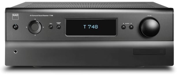

NAD T 748 AV receiver

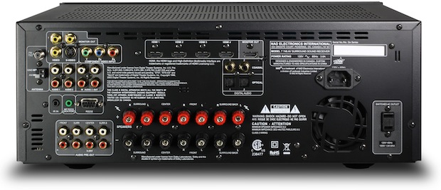

NAD_T748_back
The back of the NAD T 748 is fairly spartan with seven pairs of five-way binding posts, one for each channel. The T 748 doesn't support a second zone of audio so you can either use the surround back amps as intended or to bi-amp your main speakers. There is a single component video input, two composite video, and one S-video (other than the ones on the front) inputs. There are two each coaxial and optical digital audio inputs. An RS-232 serial connection and IR jacks are available for custom installers. There are also 7.1 channel analogue outputs for integrating an external amp.
The T 748 is really designed to route all inputs to its single HDMI output. While there are component video and S-video inputs, there are no matching outputs for these formats. Also, while the NAD T 748 upconverts all video to HDMI it lacks scaling, so that HDMI output will operate in 480i/p for all standard definition signals input into the receiver (your television can handle the upconversion, so this isn't a significant issue). The composite video monitor output must also be connected to the display to view the text-based (not graphical - think Denon/Yamaha menus from about 4 years ago) On-Screen Display. From the menu, you can set up to five AV presents for different types of program material, changing such characteristics as surround modes and speaker settings.
