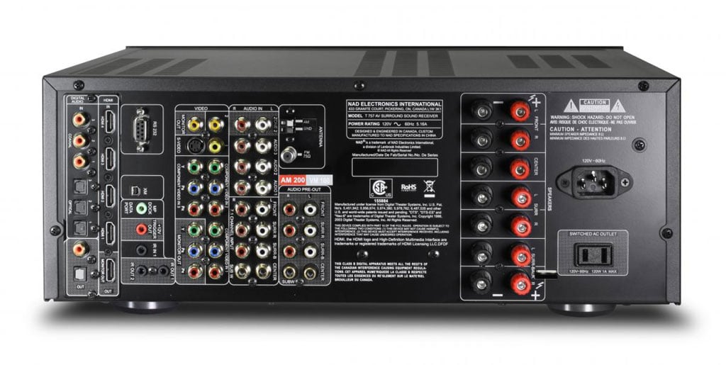

It's hard to see from the above picture how the modular design will work. Obviously the inputs and amps are all arranged vertically which probably indicates that they can be removed (doubtful with the amps, but the rest). Around the digital audio inputs, you can see cutouts where they come through the back panel. It seems to us that the digital audio/HDMI panel is the module that can be removed and replaced, probably a good choice on their part as the rest of the analogue inputs/outputs are unlikely to changed in coming years (unless you count "used less" as a change). This, it seems to us, gives you access to one bay for modular change. We would have thought more would be preferable but perhaps the thought was that one larger bay would give more ability to integrate unexpected technology in the future. Surely, the most likely component to change will be the HDMI inputs/output as HDMI seems to be the moving target of the AV world.
Overall the NAD T 757 has a decent number of connections available for a high-end receiver company. It is a 7.1 channel receiver that supports 2 zones of audio (the rear channels can be used to power Zone 2 or you can use an external amp). There are four HDMI inputs and one out, three component video in and one out, and three coaxial and and four optical (one on the front) digital audio. There are 7.1 channel analogue outputs for integrating external amplification as well as 7.1 inputs for legacy gear. An iPod dock is available for the T 757 to integrating your iDevice and will display song information on the OSD. All the latest HD audio formats and includes NADs proprietary EARS surround DSP.
