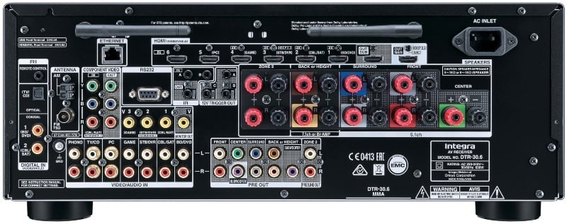

Integra DTR-30.6
The DTR-30.6 ($1000) is rated at 95 watts per channel and weighs in at 23 pounds. It has seven HDMI inputs and two outputs. 4k upscaling is performed by Marvell's Qdeo chipset. There are dual wireless antennas for WiFi and Bluetooth connectivity. While there are no 7.1 analog inputs, the DTR-30.6 has full 7.2 pre-outs for adding an external amplifier and a phono input for vinyl lovers.  The pre-outs for the surround backs are also labeled as "Height" indicating that you'll need to choose one or the other. According to the manual, you can select the type and placement of Atmos speakers but you can't have the internal amps power the surround backs and an external amp power the Atmos speakers. It is one or the other. The DTR-30.6 supports up to two zones of audio (either internally powered or with an external amplifier).
dtr-30.6 back
Integra DTR-30.6 Rear Panel

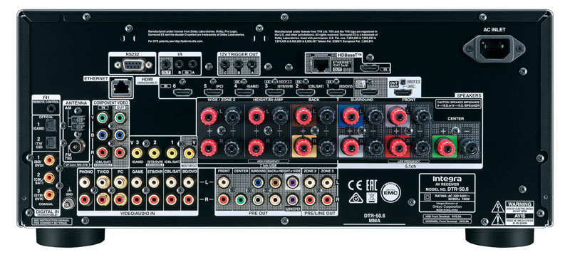

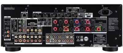

Integra DTR-50.6
The DTR-50.6 ($1700) increases the power of the amplifiers to 130 watts per channel and weighs in at just over 32 pounds. While the number and types of inputs haven't changed, the DTR-50.6 adds the ability to utilize "Wide" speakers. Like the other two receivers, you'll have to choose which seven speakers you want in your system. You can't use the pre-outs to powering more than seven speakers.
dtr-50.6 rear
Integra DTR-50.6 Rear Panel
