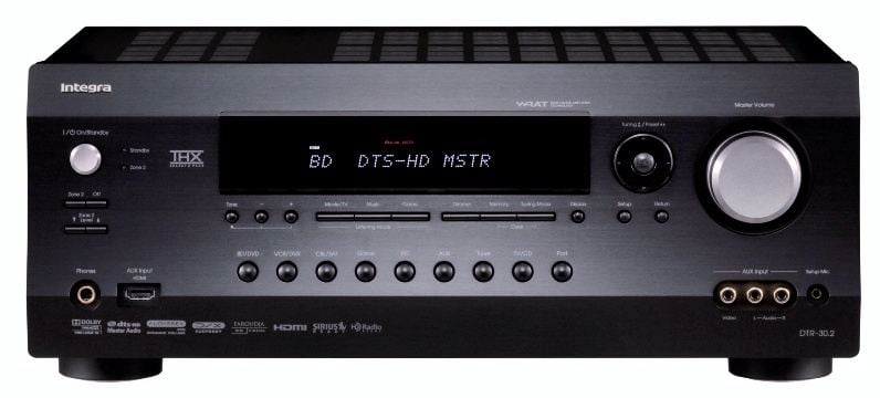

Lets' start with the basics. The Integra DTR-30.2 is a THX Select2 Plus certified 7.2 channel receiver with 100 watts per channel with the company's Wide Range Amplifier Technology (WRAT) with three-stage inverted Darlington circuits. As to be expected with a custom installer focused product, there is a focus on amplifier quality and Integra doesn't disappoint with their discrete output stages for all channels and push-pull amplifier design. Integra and Onkyo have been dedicated to multiple subwoofer outputs for a few generations now and for custom installers, this can be a big selling point. It would be more so if the subwoofers were independently controlled but according to the manual, it seems like they are dual mono. Included with this model is an HDMI pass through option which allows you to view and HDMI source even when the unit is in standby mode. The DTR-30.2 sports all the latest HD audio decoders including DTS-HD Master Audio and Dolby TrueHD plus a slew of the newest DSPs. Users will love to see Dolby Pro Logic IIz (with their front high channels) and Audyssey DSX (with their front high and width channels) on board. For those with large rooms or projection screens, expanding that front soundstage can be a huge boon. With the surround back channels assignable to these new channels, you won't need an extra amp for these speakers. You can't, however, assign the internal amps for a 7.2 configuration and use additional amps connected to the pre-outs for the high/wide channels so you are limited to 5.2 when adding these speakers.

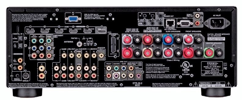

Taking a look at the back, you'll notice five way binding posts for all channels, 7.2 channel analogue outputs (for integration with separate amps), and an extra set of binding posts for your high/wide channels. Basically, you can set up for a full 7.2 system and switch, on the fly, to 5.2 with high/wide channels and back without having to change speaker wire. This is great for integrators and users that want as much flexibility as possible. There are five HDMI 1.4a inputs on the back with one output and an additional HDMI input on the front panel. Gone are the banks of s-video connections with two each component video, coaxial audio, and optical audio inputs. There is a component video output and a handful of composite video/analogue audio inputs for legacy gear. The vertically oriented large port is a universal port for integration with Integra's HD radio receiver and iPod dock (extra purchase required) as well as a Sirius radio port.
Of course, the focus with Integra is custom installations so you'll have to expect a few goodies that only an installer would know what do do with. There are three DC triggers, two IR inputs and one output, bidirectional RS-232, PC-input, Zone 2 capabilities, separate dealer settings for quick system restore, RiHD, and optional rack mounting kit. Along with the VGA input, you'll find a lot of functionality for integration into a whole home setup. Zone 2 can be volume controlled from the receiver or at the source and the VGA input can actually be upconverted to HDMI.

corey posts on June 09, 2010 01:19
Audyssey 2EQ seems like a bit of a mismatch. In this price range I'd be looking for Audyssey MultiEQ.
gene posts on June 08, 2010 22:48
I fixed the Dolby volume thing. Thanks guys.
anamorphic96 posts on June 07, 2010 19:22
micknkeef, post: 723681
i don't think this model has dolby volume as mentioned in the article.
I has Audyssey's Dynamic Volume. Probably just a mis-print.
micknkeef posts on June 07, 2010 19:09
