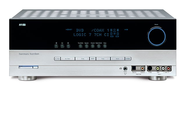

The Harman/Kardon AVR-347 is one of the lower-priced 1080p HDMI receivers available on the market today for those looking to get updated to the newest technologies. The receiver delivers plenty of power along with 1080p compatibility and upconversion over HDMI. The Harman/Kardon AVR-347 appears to be a no-compromise head unit capable of driving a fully-equipped home theater. With a host of features and a unique visual appeal, this receiver will also fit right in among the most elegant of home decors. But don’t let its good looks deceive you, because this receiver is more than capable of driving most speaker systems made to extremely high levels. The AVR-347 has more about it than a pretty face.
Some of the more notable features include 7.1 channel digital audio decoding, Logic 7 audio processing for 2 channel sources, and analogue video upconversion to HDMI (v1.1) at up to 720p resolutions (1080i or 1080p is not available as an upconverted resolution via HDMI though 1080i component analogue input will be passed through HDMI unchanged). DCDi by Faroudja handles the deinterlacing and scaling, so your video should look pristine. Some notes: 1080p resolution is only available as a pass-through and repeater for increased cable lengths without signal degradation. Since the HDMI chip in this system is 1.1, it will handle all the high definition audio formats, but only in either PCM format or native MLP for DVD-Audio discs. Native SACD isn't supported and can only be transmitted via PCM conversion (or analogue transmission) on the part of the player. The EzSet/EQ feature, Dolby Digital and dts DSP modes and XM satellite radio and iPod support (with optional and awkwardly-named "The Bridge" docking station) make this a well-rounded product suitable for nearly everyone. An RS-232C port is available "for software upgrades" but is not configured for use with advanced home automation systems or direct serial control of the receiver. That just about kills the chances of the HK being used for professional high-end installations. The HDMI repeater functions alone make this a noteworthy upgrade over the AVR-247 and also justifies the extra cost.

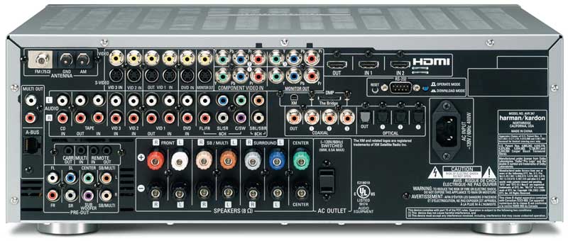

The AVR-347 is practically stuffed with inputs and outputs. There are three component video inputs and two Simplay HD-verified HDMI inputs. In addition to the superfluous S-video and composite video inputs, the receiver is also equipped with a 6/8-channel analogue audio input and 6/8-channel preamp outputs. This is just the thing for power hungry people that may want to add some external amplifiers in the future and it certainly takes care of legacy SACD and DVD-Audio players with multi-channel analogue outputs. A set of stereo preamp outputs can also be used for a discrete second zone - something we truly value in AV receivers. The only downside we found is that if you use a second zone you have to assign the Surround Back amplifiers to the Zone 2 - even if you are only using the preamp Zone 2 outputs. This is a flaw that should be fixed in future versions of the receiver.
