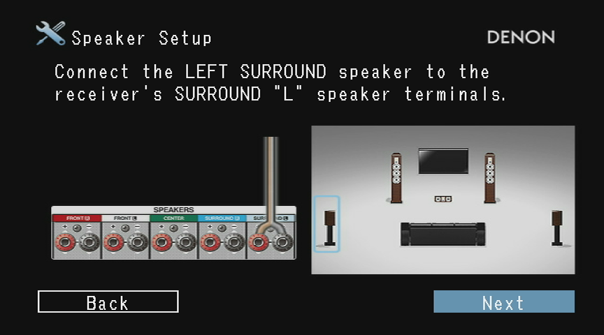

• New Setup Assistant with enhanced GUI, providing easy-to-follow setup instructions

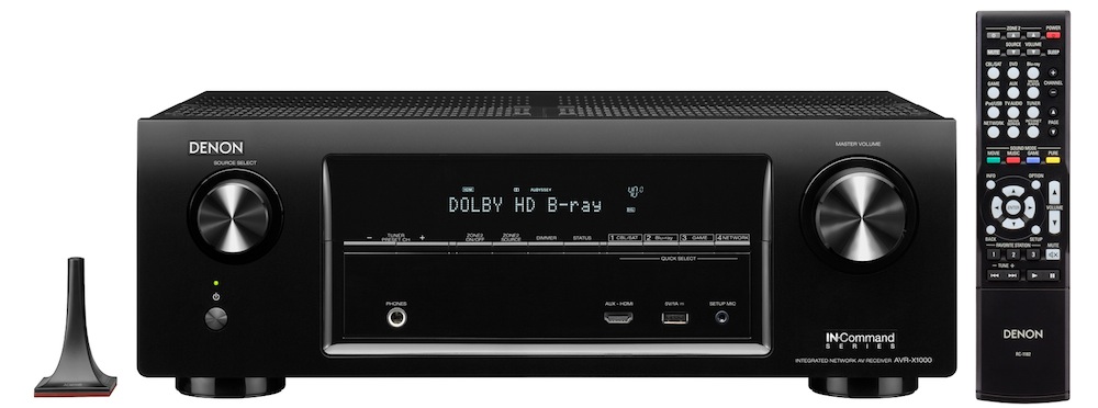

The least expensive in the new IN-Command line is the AVR-X1000. This 5.1 receiver sports 80 watts per channel and is rated as low as 6 ohms. It weighs in at a touch over 18 pounds, has six HDMI inputs, one output, and a ton of networking options.

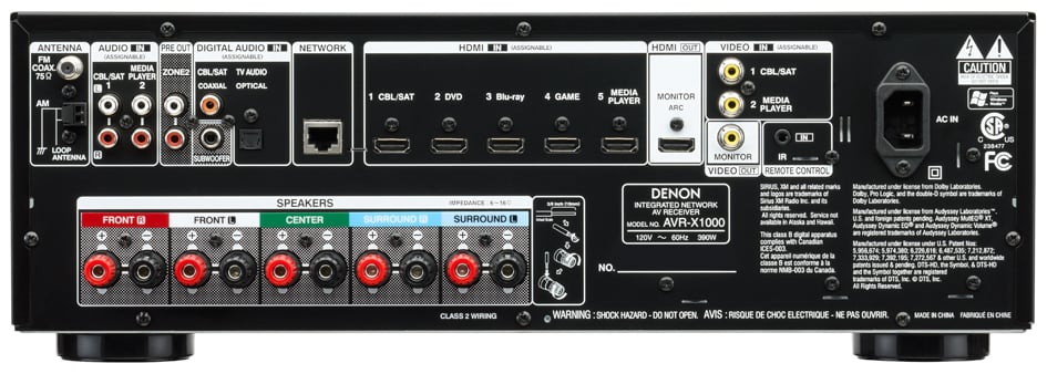

The back of the AVR-X1000 is fairly spartan but it has most of what you'll need. There are five HDMI inputs on the back and one output. The sixth HDMI input is on the front. The output is ARC enabled (Audio Return Channel) and can pass through 3D, 1080p, and HDMI CEC. There are two composite video inputs and one output. There are also two RCA-style stereo analog audio inputs, one of each type (coaxial and optical) digital audio inputs, and an Ethernet port for networking. Interestingly, Denon has included pre-outs not only for the subwoofer but for a Zone 2. This is a move that many manufacturers are starting to make. $500 used to get you a 7.1 receiver where the surround back channels could be used to power a second zone. An amplified zone 2 is starting to be phased out of this price point in favor of more HDMI inputs and network features. The speaker terminals (five pairs of 5-way binding posts) are conveniently color coded and arranged in a line rather than stacked, both of which will ease setup.
The front of the AVR-X1000 has, along with the HDMI input, a headphone output, 3.5 input for the setup mic, and USB port. This USB port can be used to access data from a flash drive or from your iDevice. When connecting an iDevice, the Denon AVR-X1000 will bypass the iDevice's internal DACs in favor of its own. This is a good thing because Denon has included 192 kHz/24-bit D/A converters for all channels.

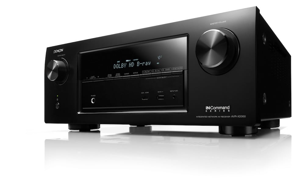

The AVR-X2000 costs $200 more than the X1000. Building on the feature-rich base of the X1000, the AVR-X2000 starts by bumping up the power to 95 watts per channel and adds two more channels of amplification. Denon has added an extra HDMI input to the rear for a total of seven. At nearly 21 pounds, the X2000 is considerably beefier than the AVR-X1000.

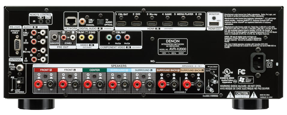

The rear of the AVR-X2000 is considerably busier than the AVR-X1000. Aside from the extra HDMI input, there's a component video input, but the composite video output has gone the way of the dodo. For experienced readers, they've already figured out that the AVR-X2000 has video upconversion from analog to HDMI. In addition, Denon has included scaling to 1080p or 4k. Two additional analogue audio inputs (up to four) are also included.
You will also find two more pairs of speaker connections for use with the surround back channels. If you decide not to use a full 7.1 system and opt for a 5.1 main system, those additional amps can be used to power Zone 2 (there are still pre-outs), bi-amp your main speakers, or as front height channels (there is no mention of Audyssey DSX so we believe this is through the Dolby ProLogic IIz solution.
Custom installers will be happy to see an RS-232 port on the back for control as well as an IR in and out (there was only an IR in on the X1000). AMX, Control4, Crestron, RTI, Savant, URC third party control support are standard with the AVR-X2000.
