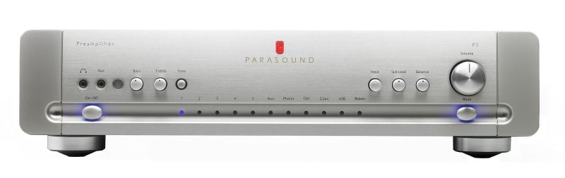

Build Quality & Feature Set
As
 most would expect from Parasound's Halo line, the P 5 preamp is (subjectively)
 a very attractive piece of equipment with a black or silver brushed
aluminum front panel, measuring 17-1/4"W x 13-3/4"D x 4-1/8" H with the
feet. Presuming build quality carries over from its Halo siblings,
overall build quality is likely to be quite good, albeit not quite in
the "cost no object" category. The front panel is tastefully laid out,
with a headphone output, auxiliary input to connect mobile devices, tone
 controls & bypass, input selector with blue LED indicators,
subwoofer level adjustment, balance controls, and of course, the volume
control and mute button.

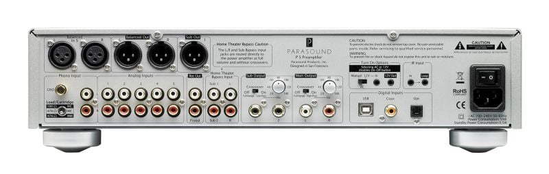

Moving to the rear panel, you get a
useful mix of connection options, including phono inputs (compatible
with MM & MC), five unbalanced stereo analog inputs as well as one
set of balanced analog inputs (the balanced connection would be
substituted for the 5th unbalanced input pair), home theater bypass
inputs, and the aforementioned trio of digital inputs. Outputs include a
 balanced and unbalanced stereo outputs for a power amplifier, a pair of
 unbalanced plus a single balanced subwoofer outputs, and a pair of
fixed level unbalanced outputs. In addition, controls are available for
bass management including adjustable & defeatable high and low pass
filters.
The back panel of the Parasound Halo P 5.
