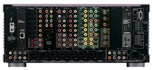

Integra Research RDC-7.1 Back Panel
Integra RDC-7.1 Remote, Build Quality, and Setup
From left to right we see the i.LINK, Ethernet, Toslink and coax digital connections, followed by multi-channel inputs, analog RCA's, S-video/composite and component video, HDMI, RS232 and the trigger system.  Integra Research accommodates component video or BNC, or both. I selected the extra component video card to support my current system configuration. Owners of certain high-end front projection systems may wish to opt for the BNC card instead. Pretty much all the bases are covered here and in the likely event of newer interface adoptions, the RDC-7.1 is ready with a quick card change from your local dealer.

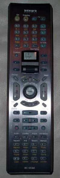

Remote Control
remote.jpgAt first glance the RC-555M remote control could be quite intimidating.  It's basically a long thin remote stuffed with a lot of buttons.  Though the buttons are well labeled, they could sometimes be difficult to read in a room with high ambient light due to reflections off of the anodized silver faceplate or in a darkened room since the backlighting was rather dim.  One of the redeeming qualities of this remote was the spin flywheel which functioned twofold; to toggle operation mode and source.  When you spun the flywheel the "mode" and "input" buttons illuminated green allowing you to select which you would like to control or both.  Initially I accidentally toggled the wheel with both options illuminated and it took me a few moments to figure out how to get the remote to operate the processor since it was stuck in DVD operation mode.  Selecting "mode" and spinning the flywheel won't take you back to controlling the processor which they designate as "amp".  You must instead press the flywheel for it to revert back to processor control.  Remember this or you will be in a world of hurt if you accidentally toggle the remote to control other devices.  I found the buttons I used most during normal operation, aside from the obvious volume and power, were the flywheel and "surround" and "DSP" keys which allowed the user to toggle surround modes on the fly.  On many processors and receivers it takes at least two or three keystrokes and/or submenus to address this feature. I much prefer the simpler approach of the Integra Research.  With this configuration, the user can simply toggle between PLIIx Music Mode or Movie Mode by the toggling a single button (a handy featuring when switching between different source types).
Programming the RC-555M was a snap, again thanks to the handy flywheel.  All you have to do is look up the manufacturers ID code and toggle the flywheel to component name you wish it to operate.  You can even customize specific keys and set up macro commands.
Unfortunately the program modes of the RC-555M are only reserved for (DVD, TV, VCR, CBL, and SAT) inputs.  The other inputs are hard configured for Onkyo/Integra hardware.  I successfully operated my Dish PVR box using the Integra Research supplied ID codes, but was unable to operate my Denon DVD-5900 with any of the supplied ID codes.  I had to manually program the remote to get it to operate my DVD player.
Overall, the RC-555M is a very competent remote with good tactile feel and build quality, though somewhat limited in programming function.  I just wish the backlighting was a bit brighter but as of yet we don't buy flagship high performance electronics for their remotes, and for as little as $300, a dedicated universal remote control can be purchased without such limitations.

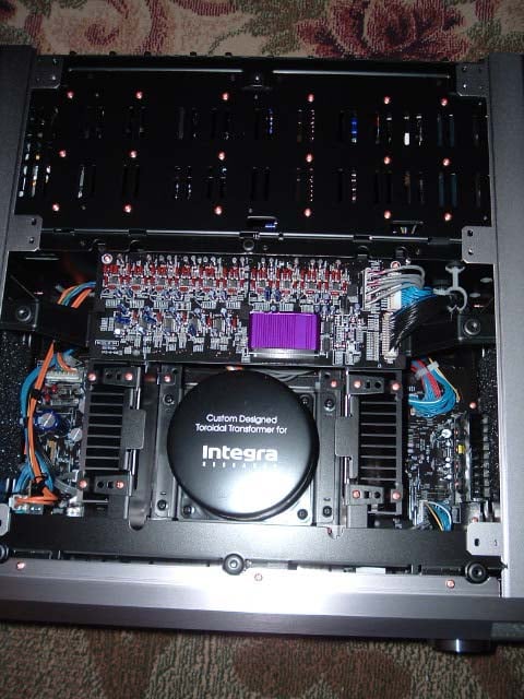

Inside the RDC-7.1
rdc71inside.jpgAnyone who is into cars always likes to get a good look under the hood before they take the plunge into proud ownership.  Test driving a new A/V processor is no different, at least not for me.   My curiosity got the best of me so I grabbed my trusty Torx screwdriver and removed the top cover.  With the sheer size and weight of the RDC-7.1 it's hard to believe this is a processor and not a flagship receiver.  Peering into it with the top cover off, I was pleased to see a well laid out design, oversized toroid power supply, and ample heat-sinked regulation.
Chips Anyone?
As with the RDC-7.1's predecessor, Integra Research has provisioned some of the best and most current processors and DACs on the market including dual 32-bit processors from Aureus™ Texas Instruments, 192kHz/24 bit DACs from Wolfsen, and a proprietary low jitter clocking system from Apogee which is said to audibly clean up jitter by taking in erratic or jittery timing signals and putting out cleaner, lower jitter signals. This allows optimum A/D and D/A conversion for improved sonic performance.

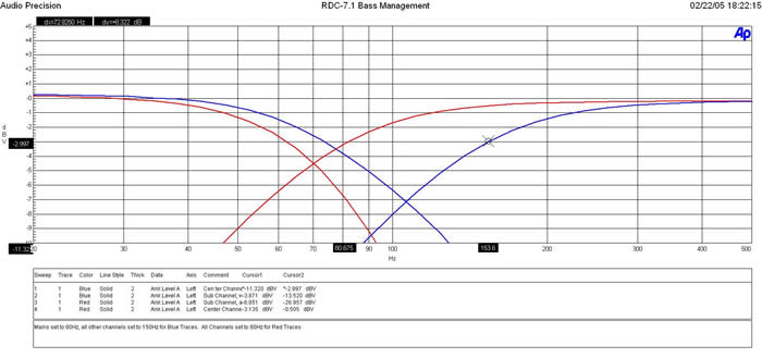

Integra RDC-7.1 Bass Management

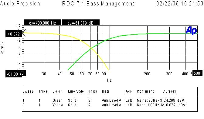

To test my assumption, I used the Audio Precision SYS 2722 Audio Analyzer to run some measurements via the analog two-channel inputs of the RDC-7.1 configured in two-channel and multi-channel surround modes.  What the SYS 2722 told me was that the LFE crossover setting only affects LFE info as stated in the menu.  This is a good start, implying if you set all other channels to a lower frequency, critical LFE info will NOT get truncated.  Many processors unfortunately do truncate LFE bass under this circumstance, the RDC-7.1 is not one of them.
This is a plot of the subwoofer LPF and Main Channels HPF when set to the THX recommended 80Hz crossover setting.  Notice the HPF is down -3dB at 80Hz with a 12dB/Octave slope while the subwoofer is -6dB down at 80Hz with a slope of 24dB/Octave as per THX.
Editorial Note
The reason for asymmetric filter responses between the HPF and LPF is to account for the natural roll off of the satellite speakers which is typically 12dB/octave.  This allows the best blend between the subwoofer and satellite system.
In the Blue Traces, we set all channels but the mains to 150Hz (extreme case), while the mains were set to 80Hz.  Notice how the subwoofer crossover -6dB cutoff has extended from 80Hz to 100Hz.  This is good news.
Granted, ideally it should have extended to the frequency of the satellite speaker with the highest crossover setting (in this case 150Hz), but I suspect Integra Research limited the cutoff of the LPF of the sub to 100Hz or so to avoid excessive bass energy from a single source which is localizable at frequencies above 80Hz and to avoid having too much overlap of the speakers with HPF's set to a lower value.  The Red Traces represent all channels set to 80Hz.  Notice the better summation at the crossover points.

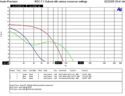

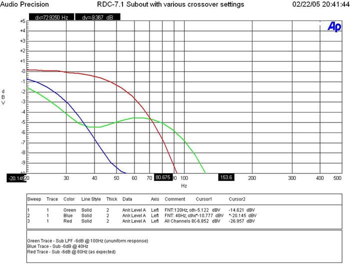

Let's take a closer look at the subwoofer output while varying the multiple crossover settings between the main speakers having high and low crossover settings, while the other speakers have low and high crossover settings, respectively.  The RDC-7.1 is configured in PLIIx Music Mode.
The Red trace represents all channels set to 80Hz.  The sub out, as expected, exhibits -6db at 80Hz.
The Green Trace represents the subwoofer output while the main channels are set to 120Hz while all others are set to 40Hz.  Notice the uneven response of the subwoofer output that appears to be rolling off at 40Hz, then rises until it rolls off again at 120Hz.
The Blue Trace represents the Main channels set to 40Hz while all other channels are set to 120Hz.  Notice how the subwoofer output -6dB point is around 40Hz.  Essentially any speaker groups set above this point will not properly recombine bass back into the subwoofer.  In other words, that information will be lost or extremely attenuated.  Initially I was disappointed until I thought about the logistics.  The RDC-7.1 was receiving a two-channel source.  Thus it was defaulting the LPF of the subwoofer to whatever setting the main channels were configured too.
The true test was to verify if the RDC-7.1 was smart enough to incorporate independent LPF's for each channel group when playing a discrete source such as DD or DTS.  Since my SYS 2722 doesn't have a built in Dolby Digital decoder, I couldn't input a digital 5.1 source to the RDC-7.1.  Thus I had to rely on my trusty Avia test disc and Sencore FFT analyzer.  Using the bass sweeps in Avia I verified that each speaker group's crossover setting was independent of the main channels so the RDC7.1 does in fact have independent LPFs for each speaker group! As an example, if the center and surround channels are set to 100Hz and the main channels are set to 40Hz, the bass from the center and surround channels will get correctly recombined into the sub for all discrete sources.
Overall this multi-crossover system appears to be one of the most flexible offerings to date, and can be very effective if used within confined limits.  We would suggest to always select satellite speaker systems with a -3dB point of 80Hz or lower, especially when using a product of this caliber in a full-blown high performance home theater system.  We also suggest maintaining a difference of no greater than 20Hz between crossover settings of all speaker groups and using caution when setting the main channels' crossover setting too low (especially when listening to two-channel sources in surround sound) to avoid loss of bass information from the other channels.  Always start at the 80Hz reference point and only deviate when absolutely necessary for your particular situation. In my system, I set all channels, including the LFE, to 80Hz (THX setting) except for the main channels which I set to 100Hz because I achieved better acoustical bass integration with my subwoofers and main satellite speakers.

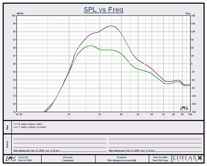

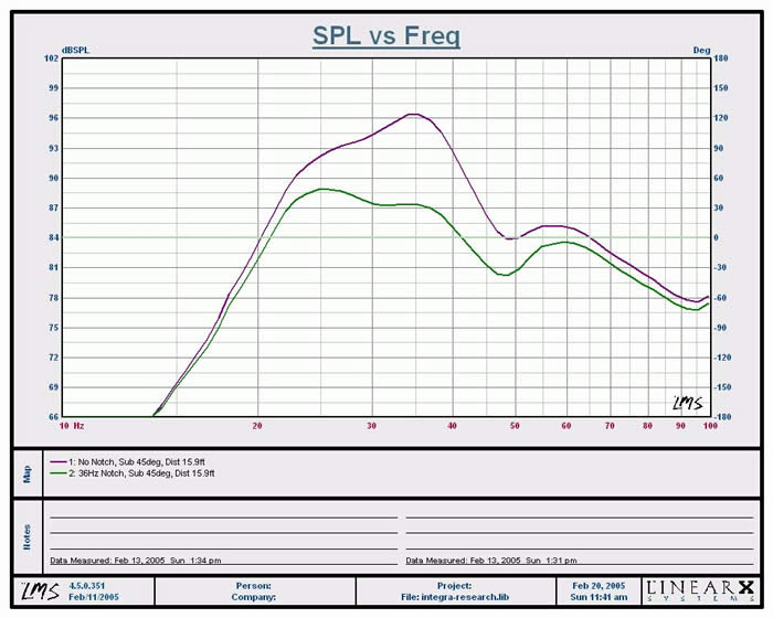

In room, on axis measurement at the listening position
onaxis.jpgUsing LMS I found the primary room mode that added a huge bump in the lower bass region. I adjusted the notch filter to minimize this-10dB from 25Hz to 40Hz.
I did a quick check in a remote seating location to verify the notch I added didn't do more harm than good for other listeners.
As you can see, the notch filter smoothed out the bass response even at other listening positions making the overall bass response +-10dB from 20Hz to 1kHz as opposed to +-20db without the notch filter.
offaxis.jpgUnfortunately there are no free lunches. When I ran my FFT analyzer into the RDC-7.1 with the notch filter engaged, I heard a very low level driver resonance present in all of the channels which became more predominant the lower in frequency the notch filter was set to. When I popped in a DVD I could hear the same resonance mode (though extremely faint) created by the notch filter in my rear channels if I put my head up to the midrange driver. In most cases this is inaudible, but it lead me to further investigate this issue with my trusty Audio Precision SYS 2722 Audio Analyzer.
What I found was the Notch filter was being applied globally to all speakers and NOT just the subwoofer channel. In my opinion, this is a major oversight as the only place the Notch filter sound be applied is to the speaker system capable of exciting room modes to benefit from it. In this case that is the subwoofer channel, not the channels we just applied bass management too!
Regarding the Notch Filter and reasons to NOT apply it globally:

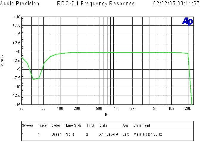

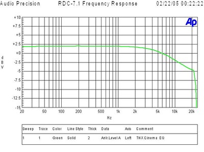

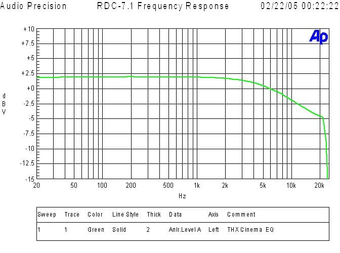

Regarding Notch noise issue: The noise gets worse as you lower the frequency. I found it most prominent when I set the Notch Filter between 20-24Hz. It is independent of Q or amplitude adjustments. When I set it to 20Hz, I can clearly hear resonance in all channels. To test this, I simply inputted bandwidth limited pink noise (20Hz to 250Hz) to an analog input and engage Stereo or All Channels mode. I suspect what I was hearing was a resonance/ringing issue of the filter response or noise induced somewhere in the associated circuitry.
rdc71-notch2.JPGPictured here is an electrical frequency response plot of the Center Channel (with no bass management applied) and the notch filter set for 36Hz -10dB from 31.5Hz to 40.5Hz. Note, I shut off the bass management of the center channel to illustrate the shape of the notch filter. With bass management applied, the notch filter is still present with the added roll off at whatever the center channel crossover is set to.
I informed Integra Research about this and they are investigating a firmware upgrade to allow user selectability over which channels (if any) other than the subwoofer channel utilize the notch filter. In the meantime, I stress caution when using this filter as it currently operates. Applying a notch for the sub channel is only relevant for the bass modal issue it is correcting relative to the sub(s) and listening area. The other speakers in the system, located at different positions create their own modal and nodal responses which usually don't coincide with the corrected response of the subwoofer.

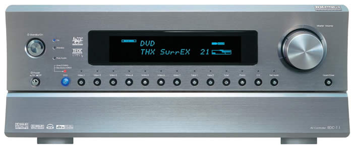

The RDC-7.1 is truly a high end processor in both form and function.  Its physical appearance and build quality have no rival. Its modular based design provides an easy path for upgradeability ensuring longevity of your investment.  All of the major surround formats and video switching options are covered for the most part, and the ability of provisioning extra component video switching or BNC connections will serve installers of high caliber home theater systems quite well.  While I would have liked to have seen inclusion of some sort of auto setup feature (at least for channel level and distance calibration), Integra Research informed me at the time of development of this product they weren't too thrilled with the available options on the market.  Much has changed in this area over the past two years (see our Audyssey MultEQ review), and Integra Research realizes this.  Don't be surprised if an upgrade module surfaces in the near future.  I feel there is so much more potential to unleash in this platform. If Integra Research supports hardware and firmware updates, it could make for an unprecedented value for a high caliber home theater system based on its performance, open architecture design, configuration flexibility, and ease of operation.

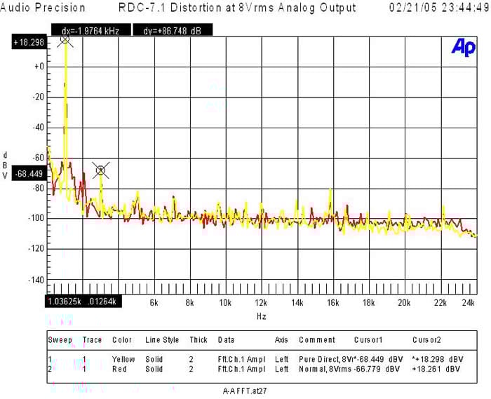

Integra RDC-7.1 Measurements and Analysis

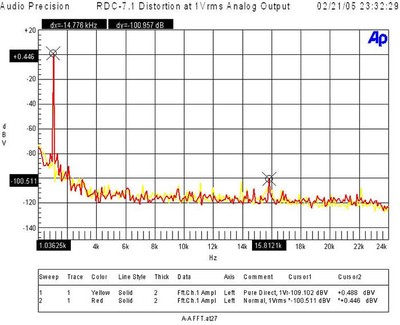

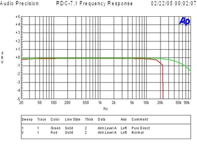

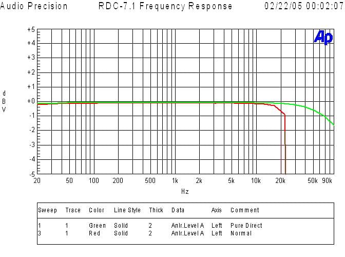

The red trace shows the frequency response via the analog inputs after they go through ADC and DAC conversion stages.  As you can see, there is about 0.5dB roll off at 20KHz followed by a sharp brickwall filter response rolloff at ½ nyquist frequency of 22kHz (44kHz sampling rate).  The green trace represents  "Pure Direct" mode, where the 3dB point was well above 100kHz.

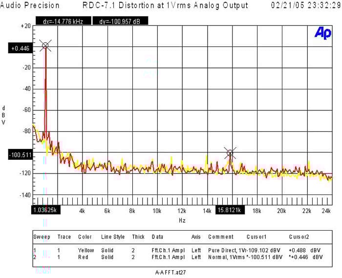

When the analog preamp was driven at 1Vrms (typically ½ signal strength to achieve ½ of max power of most power amps with voltage gain of 29dB) distortion levels were (+.0446 + 100.511)dBv = 100.957dBv or 100*alog(-100.957/20) = .000896%!  The yellow trace represents "Pure Direct" mode, while the red trace represents DSP analog input.  As you can see it is only slightly higher in distortion, certainly not dramatic enough to be audible.  This is good testament to the ADC design and implementation in this product!
Integra Research distortion spec at 1Vrms was .05%, about 5 times higher than I measured, or 35dB worse.  Talk about conservative!
When I drove the analog preamp to its limits it was able to output 7Vrms unbalanced and 15Vrms balanced (about 10dB more gain than you should ever need) and distortion levels were (+18.298 + 68.449)dBv = 86.747dBv or 100*alog(-86.747/20) = .00459%!
Note:  In "Pure Direct" mode the analog inputs were able to handle about 7Vrms before clipping input circuits and 2Vrms when engaged in analog DSP.  Most consumer equipment (ie. CD players, VCR, etc) drive 1-2Vrms max via their analog outputs so there shouldn't be any compatibility problems here.  If for some reason you find the input levels too high, causing clipping, the RDC-7.1 provisioning for independent level trims for each input will come in quite handy here.  This is great foresight on their part!

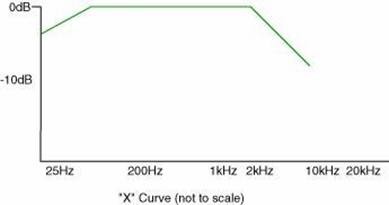

For those wondering what the typical response of THX ReEQ™ looks like, here is a frequency response plot with it engaged. While it's not the preferred two biquad solution, it just passes, since the total droop in energy in the 2K to 10K pass band closely mimics the original X curve correction. This response curve follows the digital, single biquad, low pass filter response. Sonic differences between these two types of filter responses are likely not audible in most applications given the much large variance of speaker responses and room interaction.
Editorial Note About THX ReEQ™ by John Dahl of THX
ReEQ was developed by THX's Tomlinson Holman in response to a request from the movie sound editors and mixers at Lucasfilm's Skywalker sound. The mixers found that when they listened to master tapes of their work on their home systems they sounded consistently too bright and edgy compared with what they heard in the movie dubbing stage where the masters were created. Movie dubbing stages are set up and calibrated to sound exactly like good movie theaters and vice versa. It's important to movie sound artists that they create the sound track while listening to the same system as the theater audience. In the movie biz this is known as accurate venue to venue translation.
In a movie theater the audience sits a long way away from the speakers, a theater is acoustically absorbent and the theater speakers have the high frequencies turned down slightly. In a home you sit close to the speakers, the room is acoustically live and the speakers do not have the high frequencies turned down. So you can see that a soundtrack recorded in a theater would sound bright when played back at home. The THX ReEQ filter compensates precisely for the response difference between a perfect movie theater and a perfect home theater.
The dubbing stage to theater translation is usually quite good but home theaters are another matter entirely. For example, a film played on a small TV without ReEQ may actually benefit by the high frequency boost while a decent home theater will almost always sound hard or edgy and therefore benefit from ReEQ.
Then there's the matter of the very small percentage of DVDs that have been "remixed for the home". That sounds like a good idea but who's system is it remixed for? How close will you sit to the speakers? How reverberant is your room? Etc, etc. Even when a disc is marked as remixed (which it may not be), these questions are impossible to answer in a technically and consistently useful way. This makes the THX ReEQ a known quantity based on idealized systems which can then be used or not as preferred by the individual listener.
Bottom line is… THX ReEQ, based on an ideal set of circumstances turns out to be quite useful even though home theater systems have wildly variable in-room responses making perfect corrections impossible 100% of the time.
Many thanks to John Dahl at THX for his background perspective on ReEQ.
