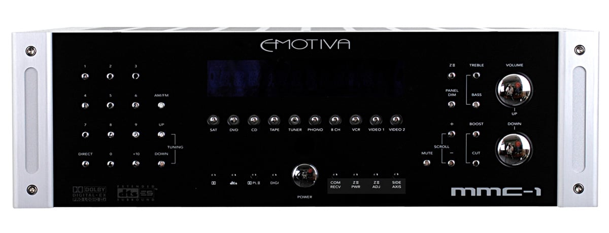

Emotiva MMC-1 Introduction
Lately the Emotiva brand has been the talk of the town, at least on the internet that is. Perhaps it’s because of their very aggressive pricing or maybe their unconventional 40% off tradeup program on new processors for existing owners. Nah, I think it’s because their products look cool, sound great and are easy to operate. Whatever the reasoning, I am certainly finding a lot of great stuff to write about the brand.
In my opinion, however, Emotiva shines more with their amplifier offerings than their A/V processors. When Emotiva first introduced the DMC-1 a couple of years ago, it carried a hefty price tag of $3,500 and was pretty much outgunned (feature wise) by most of the big brand name receivers costing only ½ that price. This product was geared more towards the audiophile that desired simplicity and great sound over the latest video processing features or DSP mode to simulate the sound of your speakers submerged in a partially flushed toilet bowl. It had some operational quirks (such as component video upconversion issues, audio drop outs on DTS, or not properly engaging PLIIx modes, etc), but Emotiva was highly proactive in resolving them. For more details on this product, I suggest reading Clint’s review of the DMC-1.
In an effort to increase value to the consumer, Emotiva basically took the DMC-1 platform and updated it, eliminated a few features and brought the price tag down to $1,199 (nearly 67% cost reduction since the inception of the DMC-1). Enter the MMC-1, the newer and better A/V processor from Emotiva at a substantially reduced cost.

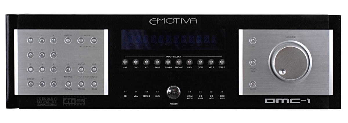

MMC-1 (left); DMC-1 (right)
Aside from these slight feature differences, there are cosmetic differences between the two products with the MMC-1 sporting Emotiva’s latest look which I am told by them will be their going forward appearance of their up and coming products. Personally I like this look at it reminds me of a Krell type product and isn’t as flashy or gimmicky looking as the DMC-1. The MMC-1 comes in a 3RU chassis with a milled aluminum faceplate and silver colored accent panel and has indirect cobalt blue illumination. My sample had rather sharp accent panels which Emotiva has told me they have filed down to make smoother since I noted it on this unit and my IPS-1 7CH test amplifier.

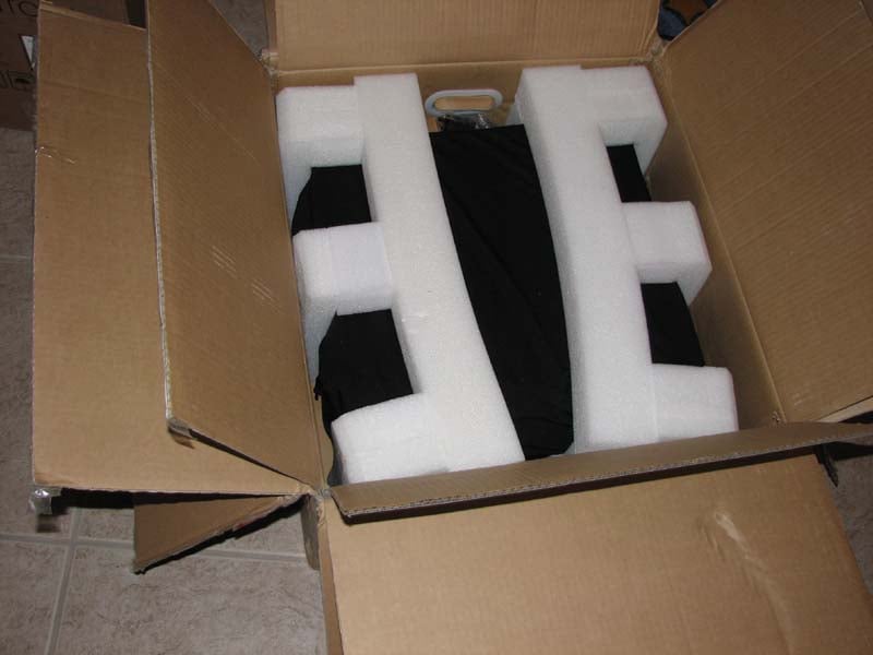

Normally I am
not one that shows pictures of product packaging in my reviews (in fact, I’ve
been known to make fun of this when my reviewers include them), but I must say,
I was quite taken by the very thorough packing job Emotiva did on these
products. Not only were the MMC-1 and IPS-1
double boxed, but the inner box had thick stryofoam molded inserts to ensure
the products were safe and snug – a great preventative countermeasure against
the tyranny of the disgruntled shipping guy who is working overtime delivering
your heavy package late in the day.

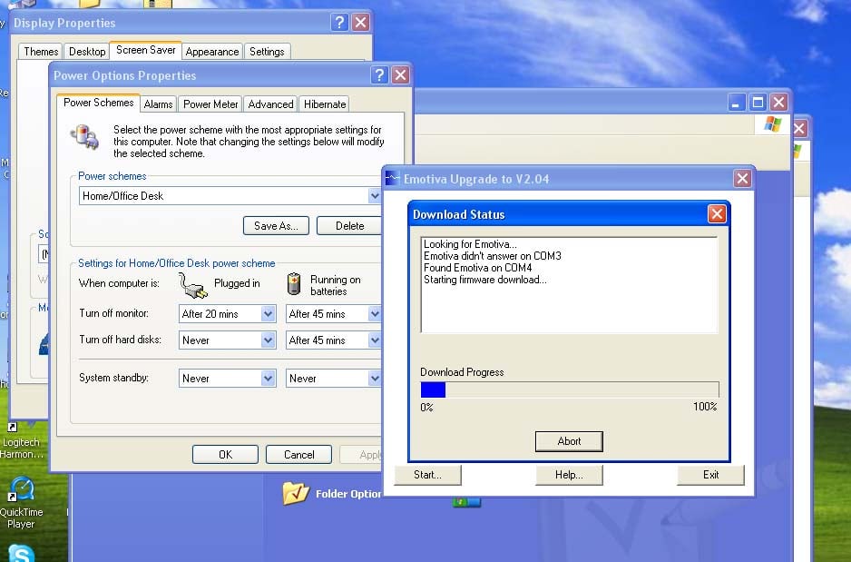

The system firmware can be updated as needed via the RS232 port on the backpanel. The latest firmware revision is located at: http://emotiva.com/support.shtm and I highly recommend periodically checking the site to ensure you have the latest revision. It’s good to see a company stand behind its product and continually improve upon its operation when issues arise.
I checked the
firmware rev on my test unit and it displayed 2.02, which was not the current
version according to the Emotiva website.
Thus I broke out my DB9 cable and keyspan USB to RS232 cable and
connected my laptop up to the MMC-1. By
opening the executable file on Emotiva’s website, I was prompted to select a
COM port that the MMC-1 was connected to.
I selected “auto” and it found the processor on COM 4. I was then prompted with the screen capture
shown here and the downloading process began.
I noted the entire process took about 20 minutes so I strongly suggest
using AC power if you are using a laptop and/or to disable any screensaver or
powersaver options on your laptop to ensure no interruptions during the file
transfer process.

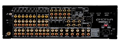

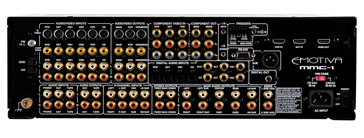

Just like the DMC-1, the MMC-1 has a nice rear end. All of the RCA connectors are gold plated and the layout is clean, well organized and highly intuitive. Note the HDMI switching, a feature absent in the DMC-1. The MMC-1 still manages to support the high current (500mA) triggers, a feature rarely found on all but top end receivers and A/V processors.

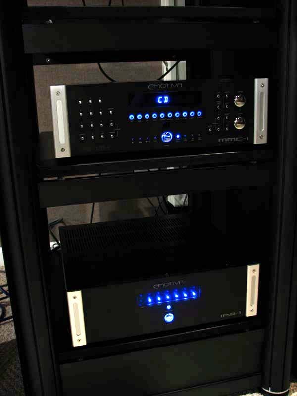

placed the MMC-1 and IPS-1 matching 7CH amplifier on my new Crystal rack from Audiav and sat in awe at how impressive
they looked once installed in this masterful rack. I had comments from many
industry folks that walked in my room and saw the Emotiva system powered on in
my rack. They almost always asked about
the cost and were dumbfounded when showed them the MSRP. “Surely
they cant sound that good at that price,” they’d say. I'd reply, “Sit down for a listen… and don’t call me Shirley.”

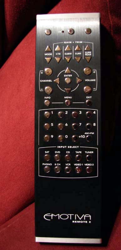

The MMC-1 remote control is about as basic as it gets. No learning functions, no LCD display or
backlighting. Instead you are delighted
with an aluminum brushed casing engulfed in shiny silver buttons all neatly labeled
and identified in a very logical layout.
This remote carries some heft which can come in quite useful as a baton
should a prowler breach your theater room late at night.
The gain and trim buttons are located towards the top with a 5 button circular configuration to handle all of your menu navigation options. Volume and channel buttons are located on each side with the channel presets located below, followed by discrete input buttons. Although there is no “source direct” button, I found by hitting the up/down “mode” button, the MMC-1 toggled to it. Overall this remote is useful and straightforward but you will want to invest in a separate universal type of remote control from the likes of Logitech or Universal should you want to control your entire theater system off of one remote control.

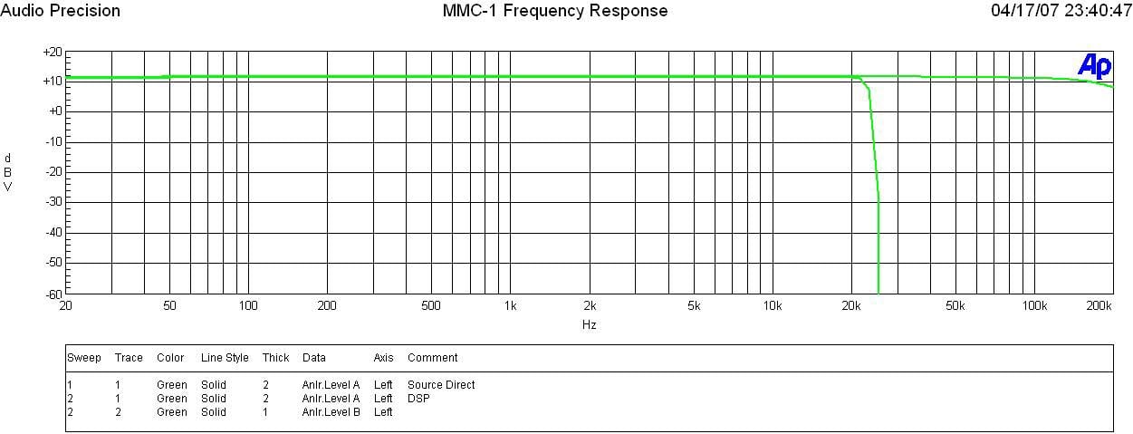

Frequency Response
MMC-1 Frequency Response
In “source direct” mode, the Emotiva preamp is rule flat beyond 100kHz with a 3dB point in excess of my test gear which is limited to 200kHz. In normal stereo mode, the frequency response is limited to the ½ the sampling rate of the ADC as expected which in this case was 22kHz.

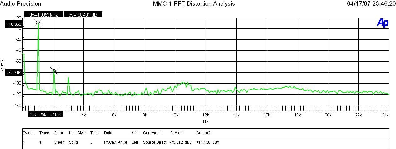

FFT Distortion Analysis at Full Power
At 3.5Vrms into a 600ohm load, the MMC-1 exhibited excellent distortion characteristics (10.865+77.616)dBv = 88.5dBV or 100*alog^-1(-88.5/20) = .0038% The slight rise in noise above 10kHz was perplexing, especially since the unit was engaged in “source direct”, but so low in the mud (-100dBV), that it really wasn’t worth further investigation.
