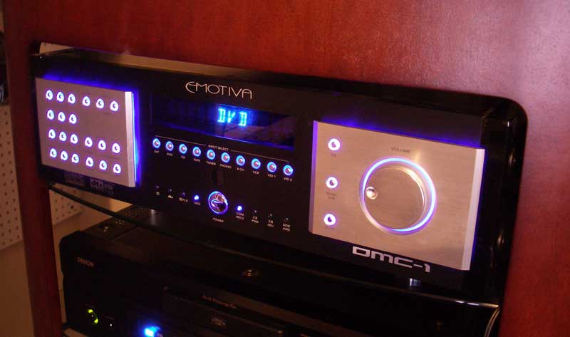

Speaking of buttons, there seem to be a lot of them on the front of the DMC-1. But really, it's the methodical arrangement of the buttons which gives one the feeling of having a science-fiction computer device at your fingertips. The volume control is very cool in that it functions digitally and allows volume to be changed in a non-linear fashion. The faster you turn the dial, the more dramatic the volume will ramp up or down. If you turn the dial slowly, you can easily adjust volume gradually in 0.5dB steps.

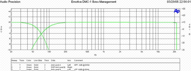

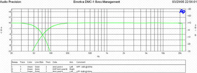

Editor's Note on DMC-1 Bass Management
We strongly recommend setting your crossover's within 20Hz of each other to avoid bass recombination issues andor truncated LFE bass with this processor. There are various ways to handle LFE channels and bass management within processors and several schools of thought populate the marketplace. When the corresponding speakers are set to "Small", Emotiva has chosen to allow the Center/Surround crossover settings to truncate the LFE track frequency information. What this means is that if the LFE track contains frequency information going up to 100Hz, but your center/surround crossover is set at 40Hz for larger, floorstanding speakers, that LFE track will also be rolled off at 40Hz at a rate of 24dB/octave. The LFE track info from 40Hz - 100+Hz is greatly attenuated from the system. If you think about it, this will largely only affect those subscribing to the ITU 5.1 speaker configuration with larger (but not full range) speakers all around. If this describes you, you can select a higher LFE setting, or you can opt to try using your system with all speakers set to "Large" to see how well the bass integrates in your room. Bass management is largely about options, and simply knowing what is happening is the first step in making sure you get the best sound possible in your listening room.
In our configuration, we were using a THX Select 2 System with both crossovers set to 80Hz. Setting the crossovers to 80Hz eliminated the truncation issue and resulted in well-balanced system integration. Simply keep these issues in mind as you configure your bass management and, particularly, select the crossover frequencies for your center and surround speakers.
When all crossovers are set to 80Hz, we see a perfect 12dB/oct HPF rolloff and -3dB @ 80Hz for all speakers set to "small", and 24dB/oct LPF rolloff and -6dB @ 80Hz for the sub/lfe channel as per THX recommendation. In most cases, this is the optimal configuration that you should at least use as reference point, only varying if your particular speaker system and/or room integration requires it.
Once you have set SIZE and the two L-R and C-SURR CROSSOVER frequencies, you can glance at the SUBWFR MODE setting, which allows a "double bass" or ENHANCED feature that sends signal to the Subwoofer even when your main speakers are set to "Large". This only affects 2-channel audio and has no effect with respect to 5.1 or 7.1 surround modes.

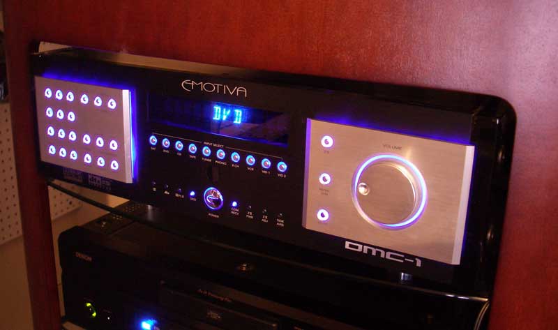

Opening up the packaging I found a well-encased DMC-1 with a beautiful brushed aluminum "floating" faceplate, polished black lacquer wood side panels, all part of a 3U rackmountable chassis. The floating faceplate was a rather nifty effect, with the indiglo blue backlighting creating a surround effect that literally lifts the accent panels off the face of the unit. I have not seen a more beautiful product. If you are one who may be bothered by the 10,000 candle power LED's that grace the front of the DMC-1 have no fear, the front lighting has 3 dim settings in addition to 'Off'. This unit is complimented by a very obvious attention to detail that shows up in every facet of it's design. Even the power button features a sculpted 'E' logo and comes backlit.

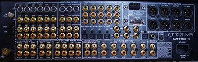

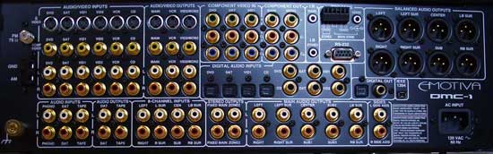

Before opening up the unit I spun it around and took a look at the back panel and connections.
Back Panel of the Emotiva DMC-1 7.1 Home Theater Processor
You cannot help but recognize the well-organized layout of the processor, with all inputs well-arranged and easy to reach. Connectors were ample, yet well-spaced and I felt that I was given plenty of room to maneuver my hands to get my source components connected. Emotiva chose to mirror this organized structure with the front panel buttons, providing almost a hybrid look of simplicity and functionality. While the processor has a plethora of buttons on the front, it maintains that "high-end" look that tends to model a more subdued feature-set and cleaner appearance.

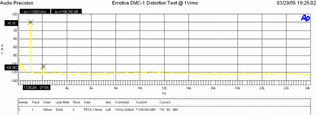

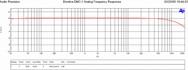

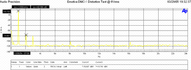

image012_012.jpgNot wanting to wait another second, I cracked open the unit (no, not literally!) to take a peek inside of this processor and see what made it tick. Despite the sparse initial appearance of the DMC-1, it only takes a few moments to find out that the efficiently laid-out unit packs a whole lot of top-shelf technology in its 27-pound chassis.
The Emotiva DMC-1 uses some pretty heavyweight chips to handle analogue to digital conversion and vice versa. The Cirrus Logic CS5394 24-bit/192kHz DAC and Analog Devices 24-bit AD1853 ADC make up this part of the processor while the high-end Motorola (Freescale) "Symphony" DSPD56367 chip handles all DSP functions including Dolby Digital, DTS decoding to the digital tone controls. You can see from the photo that while this device runs cool and requires only two amps of power, Emotiva elected to place a rather large toroidal transformer in the chassis as part of the power supply. I found the grounding of the unit to be excellent and the individual boards seemed to be well laid-out and securely fastened to the enclosure. Efficiency is a good thing and Emotiva put together a succinct and effective package.

The frequency response via the analog outputs of the DMC-1 are ruler flat out to about 50kHz with a -3dB point of around 200kHz.

When the analog preamp was driven at 1Vrms (typically ½ signal strength to achieve ½ of max power of most power amps with voltage gain of 29dB) distortion levels were (+.0.18 + 106.062)dBv = 106.242dBv or 100*alog(-106.242/20) = .000487%. This is excellent performance for a preamp.
null
When the analog preamp was driven at 6Vrms (more gain than you should ever need to drive any power amp to maximum power) distortion levels were (+.15.761 + 76.607)dBv = 92.368 or 100*alog(-92.368/20) = .00241%. Again this is excellent performance and indicates distortion is not an issue with this preamp at any unclipped drive level.

Subwoofer Output
Subwoofer output distortion was significantly higher than the rest of the preamp outs, though likely inaudible due to our ears perception of distortion at low frequencies. It was about .15% at all unclipped levels and reached clipping about +7.5Vrms which is more gain than you will likely use in any application.

The Emotiva is a beautiful processor to look at - as much a piece of artwork as it is a high-performance machine for high-end audio. This product is geared towards audio enthusiasts who desire the best sound quality possible. With an MSRP of $2495 it also comes in at almost $1500 less than the Sunfire Theater Grand IV, which has nearly identical innards and the same processing core. Add an MPS-1 7-channel amplifier and you beat an equivalent Sunfire combo by almost $3000. If you want all the latest features and gadgets, or if you are trying to spend as little as possible for your home theater system then look elsewhere, this product isn't for you. If, however, you want to enter the realm of high-end audio and experience separates at a competitive price to their peers, then the DMC-1 is a great processor to drive the reference system in your listening room.
