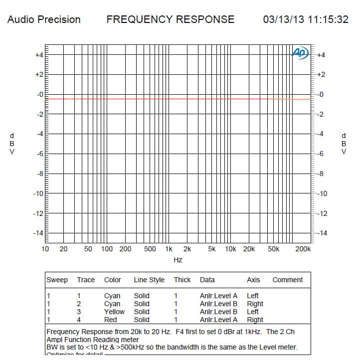

- Frequency response: 20Hz–200kHz <0.1dB stereo analog bypass; 20Hz–20kHz <0.2dB all other sources

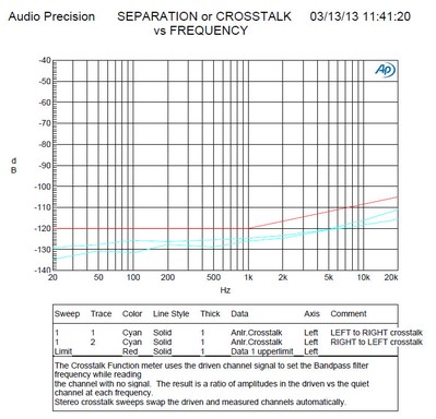

- Channel Separation: >100dB
- Crosstalk (any input to any output): >-120dB @ 1kHz

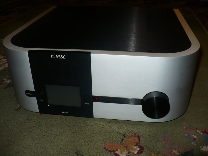

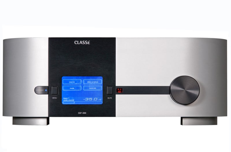

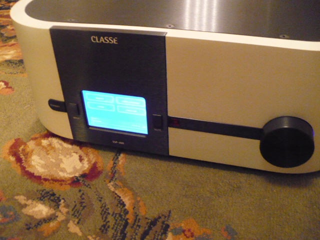

As befits a company that has roots in high-end audio, the SSP-800 features a minimalist, but distinctive, appearance along with a more minimalist feature set than your average A/V gear.
The face and sides of the SSP-800 are formed from a single piece of curved silver aluminum with black top and bottom covers nestled inside of the curve. Keeping with the minimalist tradition, rather than buttons everywhere, the front panel is simply adorned with an on/standby button with an indicator LED, a menu button, an LCD touch screen, a mute button, an IR sensor, and a volume knob. The silver face is accented with black aluminum piece where the touch screen is mounted along with the large volume knob, which is also black, and crossed with a horizontal black stripe aligned with the buttons. I will also note that there are no front panel A/V connections on the SSP-800, as is common with more mainstream audio gear.
There are actually two versions of the unit available from Classe: the standard configuration Delta chassis SSP-800 and the rack mount Custom Theater chassis CT-SSP that eliminates the curved front/side bezel and provides mounting hardware and attachment points. Other than the differences to the chassis to facilitate rack mounting, the two units appear to be identical, internally and functionally.

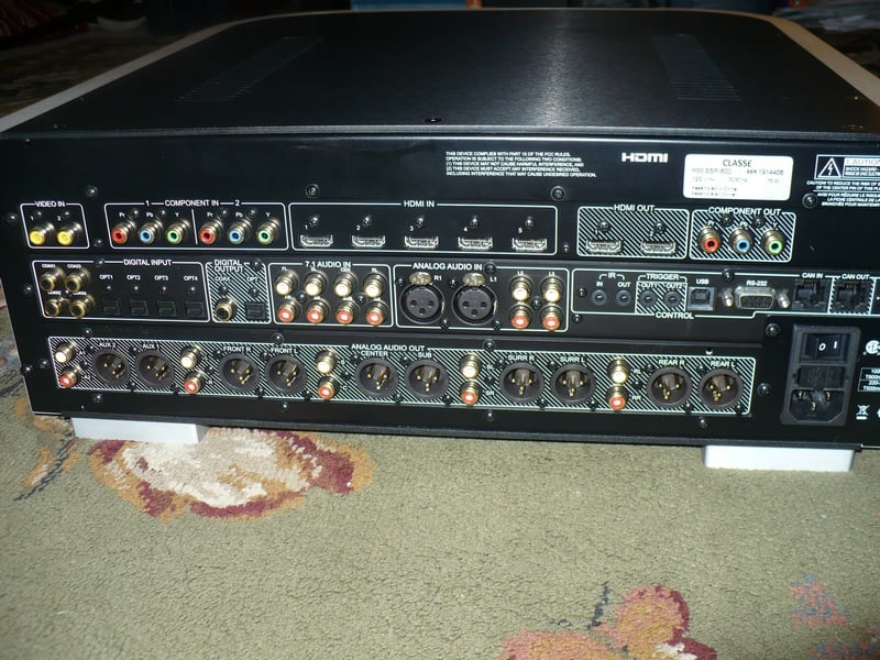

The back panel of the SSP-800 is laid out with a three-tier logic to the video and audio connections. The top row consists of all of the video inputs and outputs. From left to right, they are analog in, digital in, digital out, and analog out. The middle row consists of all of the digital audio inputs and output to the left, analog audio inputs at the middle, and with various control ports to the right. The bottom row consists of all of the analog outputs with the power cord, fuse, and main power switch at the bottom left corner.
The array of analog video connections provided with the SSP-800 includes two of each type: composite video, and component video with a single component video connection out. Digital video is comprised of five HDMI inputs and two outputs that support a full implementation of HDMI v1.4 including all current HD audio codecs, uncompressed LPCM audio, 1080p 3D video, audio return channel (ARC), Ethernet over HDMI (HEC), 36 bit Deep Color, and x.v.Color (xvYCC). The SSP-800 supports transcoding of composite video to component and HDMI and component to HDMI. While the SSP-800 supports 2D and 3D video signals up to 1080p at 24, 50, and 60 Hz, there does not appear to be any scaling functionality beyond that required for transcoding to different formats.
Depending on your point of view, the lack of video up scaling to HD resolutions by the SSP-800 may or may not be of any importance. At this point, almost all other modern source and display gear has the ability to take care of up scaling. One could argue that a piece like the SSP-800 should provide the best video processing available to make up for inferiority of any other accompanying components, but the reality is that it is highly unlikely that those who are in the market for a unit like SSP-800 will own any such inferior gear to face this issue.
Traditional digital audio inputs are plentiful with four each of coaxial and TOS link connection types and one of each is provided for output from the SSP-800. The SSP-800’s digital audio connections will accept signals up to 24 bits of depth at a frequency up to 192 kHz, but the documentation points out that TOS link may have trouble at that frequency and recommends using 96 kHz with this connection type. Both digital audio outputs support 24 bit at 96 kHz. Analog audio inputs on the SSP-800 consist of a single 7.1 analog RCA input channel, two pairs of RCA input channels, and a single XLR stereo input. The SSP-800 has 20 programmable source settings that can be configured with any of the available inputs.
The SSP-800 supports 10 analog audio output channels available as either balanced XLR connections or single ended RCA connections. Eight of the outputs provide 7.1 channel connectivity to a power amplifier and a powered subwoofer. The two additional channels are configurable either for bi-amplifying the main L/R channels, for additional mono/stereo subwoofer channels, to an additional listening area sharing the primary source, but not as a truly independent zone as is common with many receivers and pre/pros.
The control ports provided on the SSP-800 include an IR in and out, two 12v trigger out, a USB port, an RS-232 port, and a Classe CAN-Bus in and out connections. The IR in can be connected to an IR repeater for installations where the SSP-800 is out of sight and the IR out is capable of forwarding commands through to other connected components connected further down the line. In addition, the IR sensor on the SSP-800 can transmit IR commands to third party learning remotes using the Teach IR command found in the menu tree. The two 12V can be set to operate independently for greater flexibility to operate other equipment. The provided USB port is for firmware updates from Classe, without any other functionality. The bi-directional RS-232 port provides connection for external automation such as AMX or Creston based systems. Note that the RS-232 port becomes inactive when the USB port is in use, but it can also be used for firmware updates for the SSP-800.
Back panel screws on the SSP-800 are plentiful, securely attaching various analog and digital connection points to the chassis of the unit. RCA connectors in groups have at least one fastener at every other pair of connections and many have one per connection point while XLR connectors are fastened twice per connection point. This is very much unlike cheaper gear where people complain about tight RCA cable connectors prying on the back panel connections when it really is the other way around with cheap gear not having secure enough attachment of the I/O to the chassis. Ironically, the same people would likely also complain if cables were loose, regardless of connection quality.

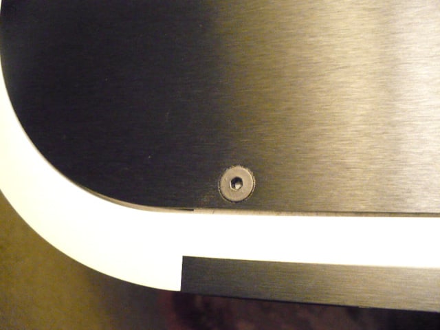

The otherwise high quality construction of the SSP-800 chassis did make a single slight apparent imperfection in the construction apparent. While not particularly visible, the top and bottom plate form a slight raised seam with the wrap around aluminum bezel along the straight segments but that fits flush at the curve. Running one’s hand along the seam, the slight offset can be felt. There is also a slight and uneven horizontal gap between both the top and bottom cover plates and the front bezel. The gap is widest at the left end of the black faceplate insert, where the touch screen is mounted, that is closest to the curve in the front bezel.
I am inclined to not think of these issues as flaws at this price range, but perhaps a tolerance limit of the of the forming/bending procedure used to make the front bezel. Perhaps this could be better, but this is unusual construction, so it is hard to say if such is the case or not.

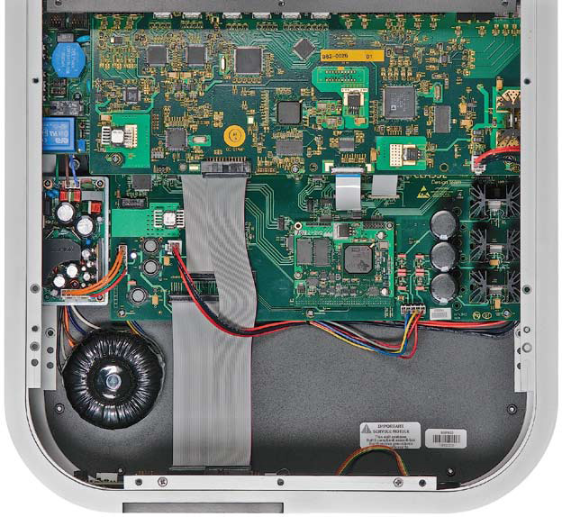

On the inside, the design of the SSP-800 shows its audiophile roots. The power supply consists of two independent sources: a traditional linear toroidal transformer for the analog audio circuitry and a high current, dual output switching power supply for the digital and control circuitry. Additionally, the audio circuits are isolated from the video and control circuits by optical couplers and low voltage differential signal (LVDS) pathways and all digital and analog signal paths and grounds are isolated from each other between and on the circuit boards. Throughout the documentation for the SSP-800, Classe takes great pains to describe the care spent in laying out the circuit pathways to minimize trace length and avoid potential noise-inducing issues as well as selecting the electrical components to go into those pathways to maintain purity of the signals passing through the unit. Such care is, of course, expected in the price realm audio gear such as the SSP-800 occupies.
The innards of the SSP-800 are kept safe from any electrical harm with over/under voltage protection circuitry. The protection circuit will kick in when either an over voltage exceeding +10% or an under voltage of –15% occurs. The unsafe over voltage condition will trigger a shut down to avoid damage to the SSP-800 while an under voltage state will trigger a warning indicator to let you know that the processor is having its performance pinched by too little juice.
The SSP-800 provides digital audio processing capabilities and bass management for all two-channel analog and digital signal inputs with the option to bypass processing to retain the unadulterated analog signal for purists. The 7.1 channel inputs only function in bypass mode, assuming that the source component not only does decoding, but handles any other post processing including speaker delays, speaker levels, and room correction, which is not available on the SSP-800 with bypassed processing. It is not uncommon for these types of features to be available on source components, but they are often more rudimentary with more clunky implementation than what is often available on sophisticated Pre/Pros.
Classe’s literature on the SSP-800 does not go into specifics about most of the processors driving the digital functionality in the pre/pro. Digital video processing functionality, such as up scaling, goes unmentioned in the marketing literature and the D/A audio converters are unnamed, but we are assured by Classe that they are high quality, custom configured parts, which is very likely true but cannot be verified. The only partially named part is the DSP, which is handled by dual TI chips said to operate at 64 bit double precision for floating point calculations. The marketing literature goes on about how this is done to ensure the most accurate signal processing, suggesting perhaps other products do not go to this extent and that it is significant.

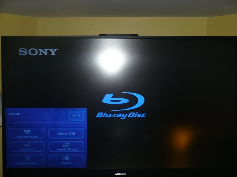

When first plugged in and the rear power rocker switch turned on, the SSP-800 will take several minutes where the standby/on indicator will blink and the unit will not turn on until it is finished. Once the standby/on indicator quits blinking, the unit can be switched to the operating mode, but this brings up a statement about initializing on the front display panel, a boot up process that takes a little longer than just turning on the unit. Once complete, the touch screen display shows the Home Page menu screen.
Here is where things start to get a bit different in how the workings of the SSP-800 are described by Classe. There are two basic menu structures, one used for regular operation and other for setting up the unit to operate. The first menu, for operating the SSP-800, is referred to as the Home Page throughout the documentation but not as a menu, although it is a menu. The other menu is referred to as the Menu System or just Menu, which is the menu to access all of the setup options on the SSP-800.
Unfortunately, the users manual leaves something to be desired in clearly establishing the menu hierarchy and layout. The Home Page menu is described in the user’s manual under the heading Using the SSP-800/CT-SSP while the Menu System menu is described under the heading The Menu System in the users manual. The user’s manual attempts to organize the menu hierarchy with sidebar titles and use of bold, normal, and italicized text, but the subheading items are not always listed in the main heading or in consistent order when they are subsequently described, so it is hard to keep track of where a given feature is in the hierarchy. The lack of clarity is further exacerbated by the pdf file of the user’s manual alternating between some unreadable, low-resolution images of the various menu screens that are pixilated to the point of uselessness and some more readable moderate resolution screen images.

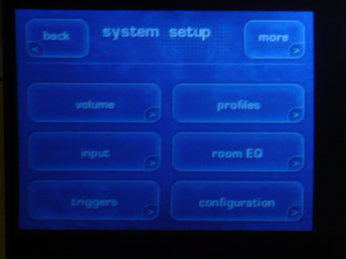

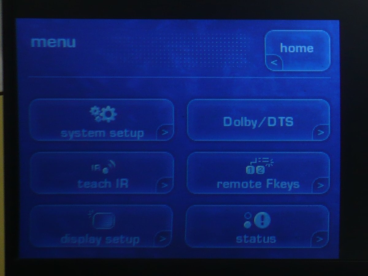

Overall view of the OSD Close up of the OSD
I will go through some of the functionality tucked away in these menus without generating the full hierarchy myself. The various menus will always display on the touch screen, which can be set for various levels of brightness, colors, and a delayed off when not in use, but the SSP-800 can be configured to present the menus as an onscreen display on the monitor television. The OSD covers only the lower left part of the screen and can be programmed to display for different user actions, time duration, or disabled completely. The front panel touch display, itself, fits up to six menu items on screen at once along with a More button when there are additional menu items and a Home button to take the user to the Home Page, both of which are located at the top of the screen. The display will also show a scroll bar to the side when there is a longer list of submenu options. All of the menus on the SSP-800 can be set to one of six different languages that are further customizable by local Classe dealers for regional variation in dialect and custom.
The Home Page menu display lists four options: Source, Video Preview, Mode, and Controls in addition to showing the current input selected, processing type, and volume level, both numerically and as a relative slider bar at the bottom. The Source menu option should be obvious in that is selects one of the assigned input sources for playback. The Video Preview button turns the face mounted touch screen into a video display of the currently selected source, which can be useful for out-of-the-way custom installations where line of sight is obstructed. The Mode menu command accesses all of the possible decoding and post processing modes. The Controls function brings up commands to temporarily adjust relative speaker audio levels (trims) and delays, Dolby late night dynamic compression as well as selecting listening/speaker configurations, and a trim reset to the programmed settings. All of the temporary settings are lost when a new input is selected or the SSP-800 is powered down to standby.
The documentation for the SSP-800 makes a distinction between decoding and post processing of signals. This is a logical distinction in that decoding outputs the signal in its native format and number of channels while post processing alters or expands the decoded signal to other formats and numbers of channels.
The setup Menu System menu is for setup of the SSP-800 is accessed by either the Menu button on the remote or the physical button on the front panel of the SSP-800. This is where all of the more permanent settings are made for the SSP-800. The manual does not provide a listing of the subdirectories under the System Menu heading, only a blurry picture of this menu and its pathways, and then jumps right in on the next page to describe the subdirectories. The missing list of items is as follows: System Setup, Teach IR, Display Setup, Dolby/DTS, Remote Fkeys, and Status.
Main Menu System Setup
Several of these menu items have relatively simple and straightforward functionality. Teach IR allows for programming the SSP-800 and the remote for additional IR commands. Display Setup allows the OSD to be set to different colors, screen position, brightness, timeout duration, programmed for which events trigger it to display, or disabled. This submenu is also where different languages can be set for the SSP-800. Dolby/DTS contains the usual Dolby ProLogic and DTS Neo6 settings for center width, panorama, and dimension along with settings for use with Dolby Volume. The Remote Fkeys submenu is where macros can be programmed for the remote control. Status displays information including firmware versions and hardware versions for various internal components, sensor data including temperature, voltage, line phase, and grounding states, and provides access to Classe’s CANbus configuration menus.
System Setup is the primary menu to configure the SSP-800 for operation with the following functions: Volume, Input, Triggers, Profiles, Room EQ, Configuration, and Black Level.
As with the menu level above System Setup, a number of the functions are straightforward. Volume is where settings for maximum and startup volume can be set along with settings for relative input levels and mute settings, which can be varied from full mute to any preset level or an amount to decrease the volume from the current setting. Volume settings on the SSP-800 can be made in 0.5 dB increments from –99.0 dB to +14.0 dB. The Triggers menu allows the two triggers to be activated and programmed. Each trigger can be set for a full range of functions beyond just turning on the unit including setting inputs and processing modes. The Black Level menu allows the SSP-800 to be set for either 7.5 IRE consistent with North American sources or 0 IRE for sources from elsewhere in the world.

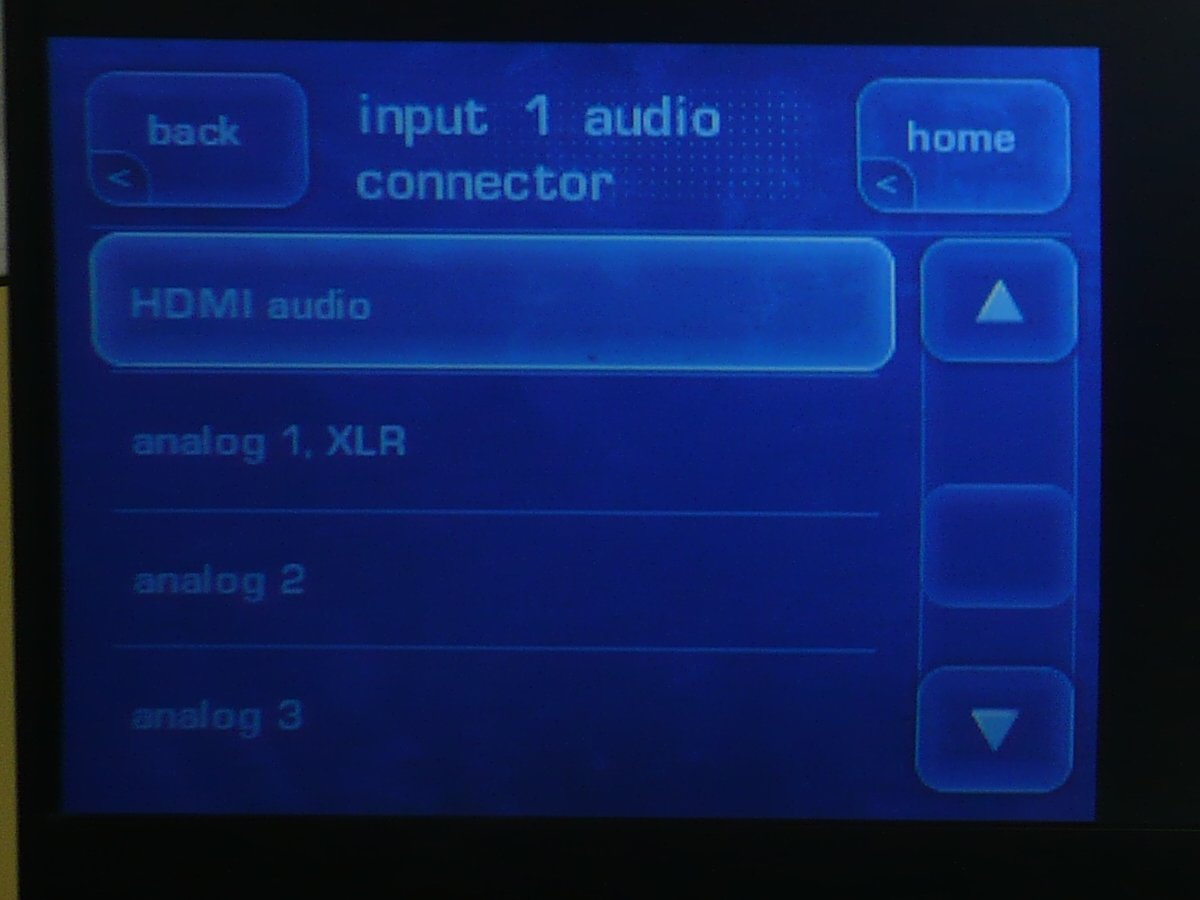

The Input submenu is where the twenty input channels can be associated with source input connections. Independent audio and video connections can are assigned in separate submenus and the audio can be associated with a default processing mode, an independent level adjustment called offset, and a group delay for lip-synching. Each input can be given a customized name and can be associated with one of the six programmable configurations as a default.
Input audio connection assignment Configuration submenu

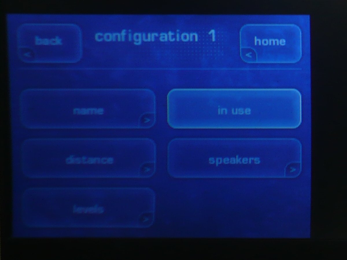

The Configuration submenu is where permanent audio settings are stored for speaker setup. Unlike a typical surround receiver, six different speaker arrangements can be created, which allows for a fair amount of customization. Each configuration can be given a custom name, set for a different number of speakers, and programmed for different relative levels, distance/delays, speakers that are or are not crossed over, crossover frequencies, crossover slopes, and how the auxiliary channels are assigned. Using configurations would allow one to create a specific setup for using surround sound versus stereo listening with and without subwoofers, respectively, perhaps a five channel versus a seven channel arrangement for sources with different numbers of discretely recorded channels, or a DTS versus Dolby surround mode.
There is some redundancy in the required input for each Configuration such as the delays for the speakers. Setting different configurations of which speakers to use with different levels and processing makes sense. Perhaps different relative speaker levels when a different number of channels or when a different processing mode is used, but the delay settings will likely all be the same unless one is attempting to program their own concert hall modes or perhaps just likes an echo chamber effect.
As for the actual settings that can be made for the speakers, they allow for a high level of precision. Level setting for each channel pair can be made in 0.5dB increments. The distance settings for delays can be made in 2 inch (0.051 m) increments, which is very likely closer spaced than your two ears.

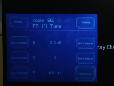

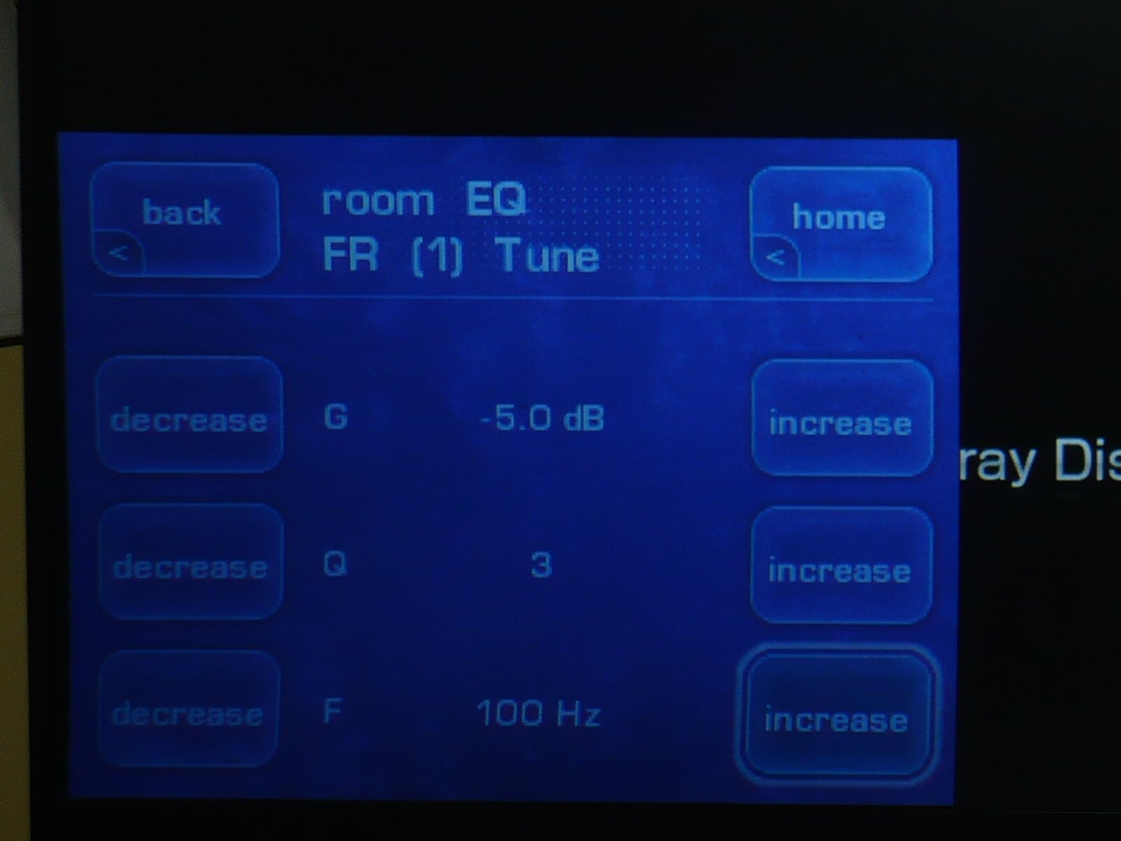

Room EQ settings
The Room EQ menu brings up the settings for the manual five-band room correction equalizer for each of the ten output channels. The equalizer can be activated or deactivated for each channel independent of the other channels and each band within a channel can be turned on or off independently. Center frequency settings for a band are made in 1 Hz increments from 20-200 Hz, 10 Hz increments from 200-2000 Hz, and 100 Hz increments from 2000-20000 Hz. The corresponding gain is adjustable from –64.0 dB to +5.0 dB in 0.5 dB increments and width can be set for multiples of 1 to 20 in integer increments. Because of the fully manual implementation of the room correction equalizer on the SSP-800, equipment and/or software capable of taking room acoustics measurements, or a dealer with the aforementioned items, is required to put the feature to effective use.
There are a couple of foibles in the implementation of the different functions and menus on the SSP-800. For example, the SSP-800 can be set to display either relative or absolute volume, but despite whatever setting is selected, the mute setup menu only displays absolute volume. Speaking of volume, while the SSP-800 has settings to adjust how quickly the volume changes with the remote control and with any connected automation, the physical volume knob on the front is very sensitive and has no such control. A few degrees turn will cause the volume to change by many dB and a half turn will take the SSP-800 from –99 dB to –20 dB, so a careless turn of the knob could lead to hearing and speaker damaging levels. It really defeats the purpose of having 0.5 dB fine volume adjustment when touching the knob causes the volume to take off like a bat out of hell. I also want to mention that the OSD will not display on a TV without an active source component selected. This is not always an issue, but if occasionally one wanted to make some setting changes to the pre/pro when it is first powered on, it cannot be done without first powering up and selecting a source. There is another issue with applying names to speaker configurations. The name given to a speaker configuration is never shown within the Configuration setup menu except under the submenu to create the name, otherwise they are simply Configuration 1, Configuration 2, etcetera, but it does show up in the Input menu where a default speaker configuration can be assigned to the input. These aforementioned really are minor issues that could be fixed with a firmware revision, but they can be irritating nonetheless.

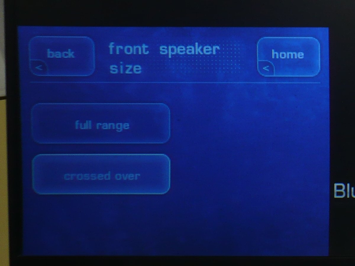

Within a defined speaker Configuration, each speaker group/type is set as Full Range or Crossed Over, which is more straightforward equivalent to setting speakers as large and small in typical A/V receiver/pre/pro parlance. When crossed over, each speaker group/type can be set for an independent crossover frequency in increments of 10 Hz from 40 Hz to 140 Hz.

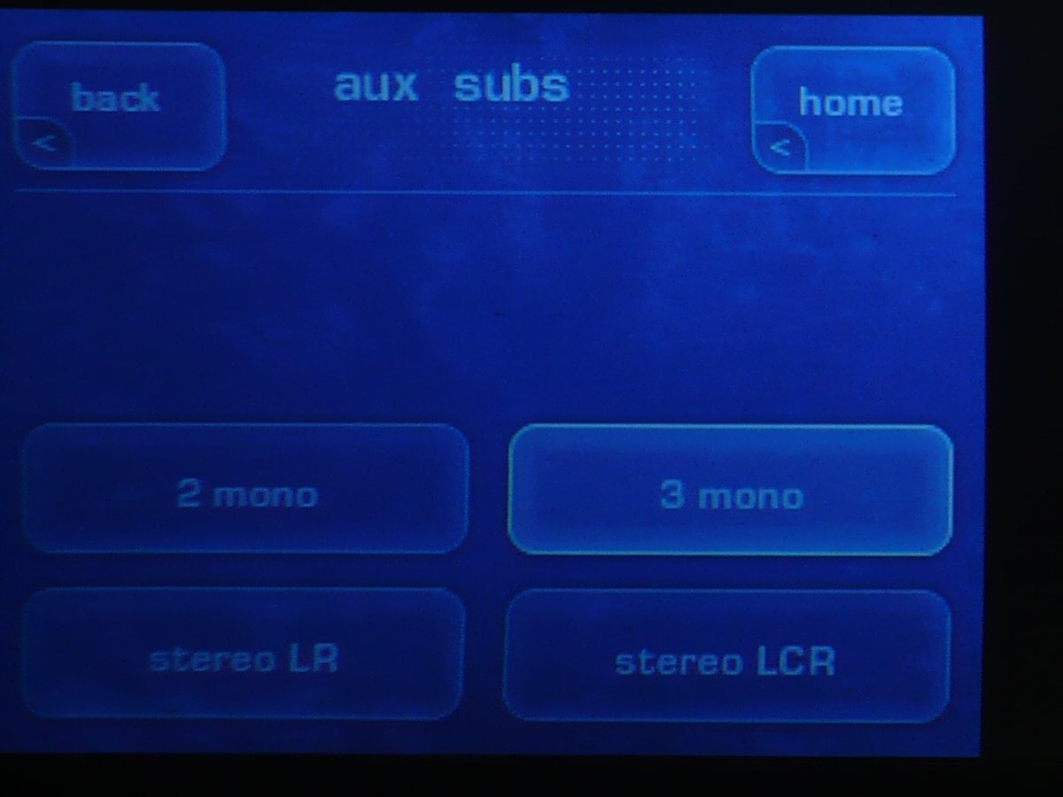

The two auxiliary outputs on the SSP-800 can be assigned as additional subwoofer outputs for a total of three subwoofer LFE channels without requiring a Y splitter cable providing an effective 7.3 system for those keeping count. The subwoofers can be configured for either one or two additional subwoofers as mono channels, L/R stereo, or L/C/R for one or two additional subs, respectively. It is worth noting that the SSP-800 will allow the auxiliary channels, when used as subs, to have independent level trim and delay settings for each of those subwoofer channels.

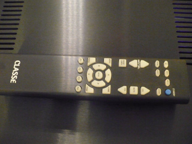

Following through with minimalist approach typical of more Audiophile oriented gear, the remote control that is provided with the SSP-800 is equally minimalist with far fewer buttons than many mass-market remote controls. There are no number keys, no key to directly select every input or every possible surround mode available on the pre/pro, and no keys to directly control other home theater equipment as is common.
All of the basic necessities are present, however, with power standby, mute, volume, sequential up and down input selection, info/status, adjust display brightness, and an enter key surrounded by four arrow keys. There are also keys to access the main menus, Home and Menu, select alternate surround modes, set temporary trims and lip synch timings, select alternate speaker configurations, access profiles, and four Fkeys to control user programmed functions.
The remote, itself, is solid and heavy, made of approximately 1/8” machined aluminum with a 3/8” thick screw-in cover plate for the battery compartment. The black tinted aluminum shell is complimented by cobalt blue backlighting that activates when any button is pressed.

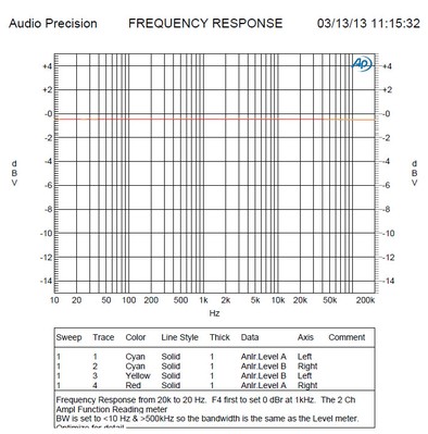

Using an Audio Precision SYS2722 Audio Analyzer, the following measurements of the analog sections of the Classe SSP-800 were performed.
Classe SSP-800 Frequency Response
The Classe SSP-800 exhibits ruler flat frequency response to the test limits of the AP audio analyzer (10Hz to 200kHz).

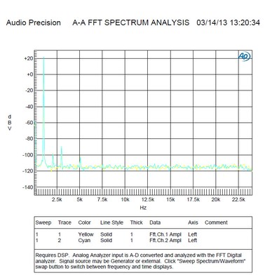

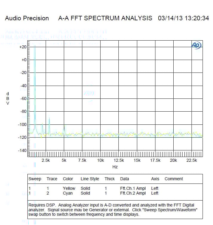

Classe SSP-800 FFT Distortion Analysis
At 1Vrms output, the SSP-800 exhibited virtually no harmonic residuals with the 2nd order harmonic being about 110dB below the fundamental. With the output cranked to 4Vrms, we still see an almost sterilely pristine output. The 3rd order harmonic dominates, but it’s about 110dB below the fundamental. Excellent measurement!

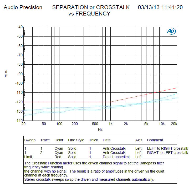

Classe SSP-800 Crosstalk
With one channel driven, the adjacent channel crosstalk was measured. At least 60dB isolation at 10kHz is a good design goal. The SSP-800 meets this with ease exhibited excellent crosstalk performance (-110dB at 10kHz and > -100dB at 20kHz). Classe did their homework in making sure a clean layout was achieved for the analog sections of the preamp and it shows.
