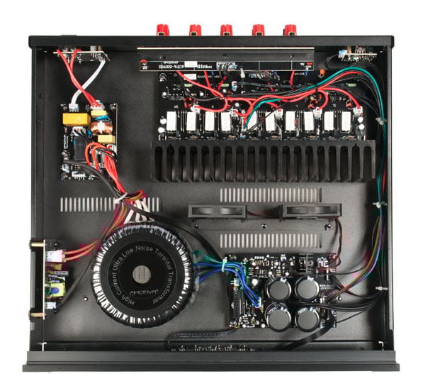

Emotiva UPA-500 Top View (cover removed)
Design Overview
The Emotiva UPA-500 is a traditional class A/B amplifier design utilizing a single large 350VA toroidal power transformer and large capacitance bank for its power supply. Having a singular larger sized power supply is an advantage that allows the amplifier to deliver more power to any given channel if the output devices can handle it. This, in turn, provides more available headroom, which is critical for effortlessly producing large dynamics and peaks in music and movies. Emotiva claims the UPA-500 has 40,000uF total power supply capacitance and, peering under the hood, you could see their claim is correct with the four 10,000uF, 63V parts connected in parallel. 63V parts provide more than enough margin above the rail voltage needed to hit the 80wpc rating that Emotiva is claiming. The amp module topology is very similar to its bigger XPA series sibling, but in a more compact surface mount form factor. Emotiva also employs a trick circuit that senses the line voltage and automatically switches between 120VAC and 220VAC. Why more amplifier manufacturers don’t do this is beyond me. The UPA-500, like all Emotiva amplifiers, has the CE mark which is a rigorous international safety and regulatory test to ensure the amp will cause no harm to your home or interfere with any of your household electronics or pacemaker (should you have one).

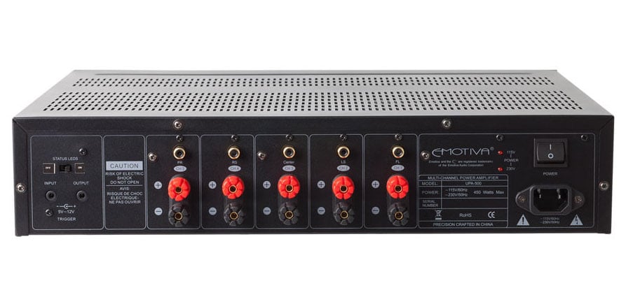

UPA-500 Back view
The back view of the UPA-500 is a bit pedestrian, but the connector spacing is well laid out. The speaker 5-way binding posts and analog RCA connections are all spaced apart 1.5". Try tugging on any of the connectors and you will notice how firmly planted they are into the back panel. Emotiva really knows how to build a durable amp. The UPA-500 doesn’t have balanced inputs, but would you expect otherwise at this price? Most users considering this amp are mating it with a budget A/V receiver or pre/pro that also doesn’t feature balanced connectors. There is a 3.5mm mini-plug trigger input compatible for 5-12V systems and the UPA-500 comes with a detachable two-prong 18AWG power cord.

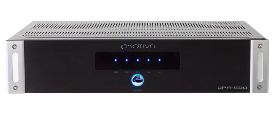

UPA-500 front panel View
The front panel sports Emotiva's same industrial look found in all of their current products. It includes their infamous silver power switch embroidered backlit with their logo (yellow for 'off' state, blue for 'on' state). There are five defeatable LED indicators (one for each channel) that illuminate blue when the amplifier is operating under normal conditions and flash red when all hell breaks loose. I was unable to create such a fault condition in my testing until I accidentally shorted the amp to the ground plate of my lab's 8-ohm test resistors and attempted to conduct a power sweep. Emotiva states that this amplifier is protected from all fault conditions which, to me, is very important and often overlooked by product engineers. I can't tell you how many times I've swapped cables during comparative listening tests where I accidentally shorted the leads. On competently designed amplifiers such as the UPA-500, the amplifier will simply shut down and protect itself and the foolish consumer (or in my case, reviewer) who forget to shut it off before swapping speaker connections. On poorly designed amplifiers, they will either blow output devices or... um, catch fire. In the 12+ years of reviewing amplifiers, I am proud to say I've only blown up one not so well engineered amplifier, which is a testament to all of other brands engineering their products correctly with consumer safety being of utmost importance. Of course, I blew up three samples of that one particular amp, but, moving on...

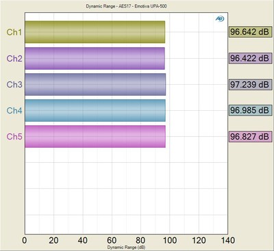

I did some quick spot-checking on the UPA-500 amplifier gain structure to ensure it could be properly driven with a wide assortment of preamps or receivers. My personal criteria for amplifier gain structure is that it should be able to hit full power when driven with 2Vrms. The UPA-500 hits full gain much sooner per my measurements which confirm Emotiva’s claim of 850mV. Seeing how most budget receivers preamp outs cannot deliver a full 2Vrms, this extra sensitivity Emotiva employed makes a lot of sense. I measured 29.7dB voltage gain (8 ohm loaded) which was very close to Emotiva’s 29dB specification.

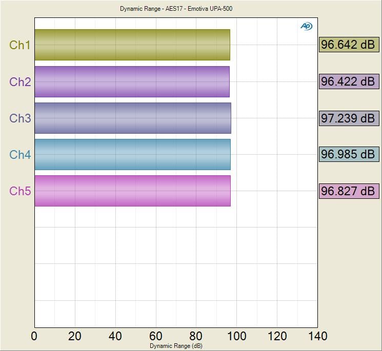

Signal to Noise Ratio
Emotiva UPA-500 SNR @ 1 watt (A-weighted)
Just like past UPA series amps from Emotiva, the UPA-500 exhibited a commendably low noise floor. At 1 watt, I measured 97dB (A-weighted) which is what Emotiva specs for this amp. If you want the un-weighted noise floor, you can subtract about 10dB from this measurement. At 117 watts, I measured 117dB (A-weighted).

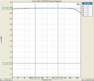

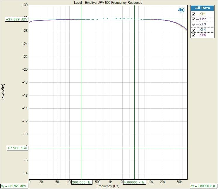

Frequency Response
Emotiva UPA-500 Frequency Response @ Full Rated Power
It was no surprise to me that the Emotiva UPA-500 exhibited ruler flat bandwidth from 10Hz to 50kHz with a gradual roll-off of about -1dB at 80kHz which is the bandwidth limitation of my test equipment. Emotiva claims the -3dB is 70kHz but I suspect it’s a bit higher based on what I measured here. What I found quite remarkable was the very tight channel to channel frequency response deviation of +/-0.081dB at 1 watt and +-0.10dB at full power. This indicates very tight tolerances in parts selection and excellent overall engineering.

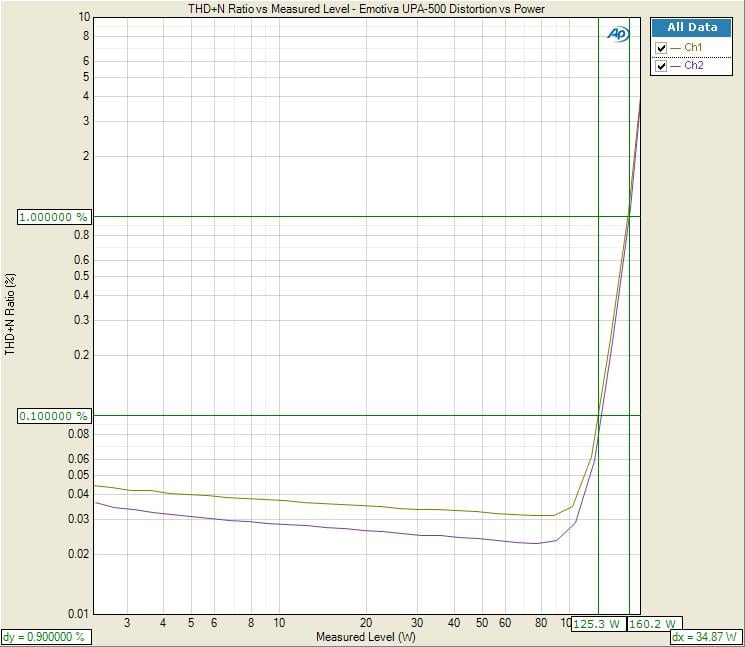

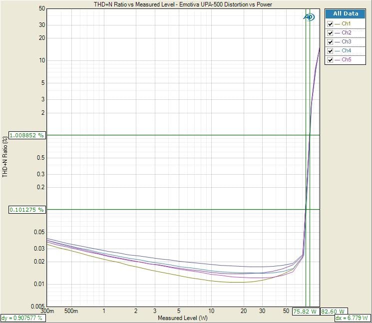

Power Measurements
Using our Audio Precision APx585 8-channel HDMI analyzer, we conducted a full barrage of multi-channel amplifier tests on Emotiva UPA-500. We tested power using three methods all of which were taken at < 0.1% THD + N:
Continuous Full Power Bandwidth (CFP-BW) from 20Hz to 20Khz into 8 and 4-ohm loads (up to two-channels)

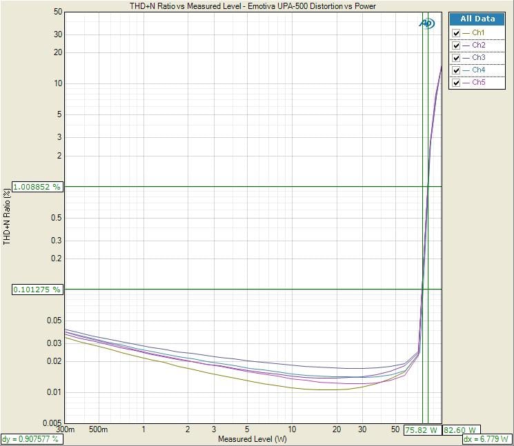

1kHz Power Sweep vs Distortion (1kHz PSweep) - popularized by the print magazines, this is an instantaneous power vs distortion test at 1kHz. The problem with this test is it often masks slew related and or frequency response problems some amplifiers exhibit at the frequency extremes, and thus inflates the measured power results. It does provide an instant gratification # for consumers to argue over on the forums so we are now incorporating this test to please the masses.

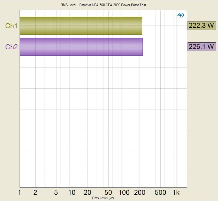

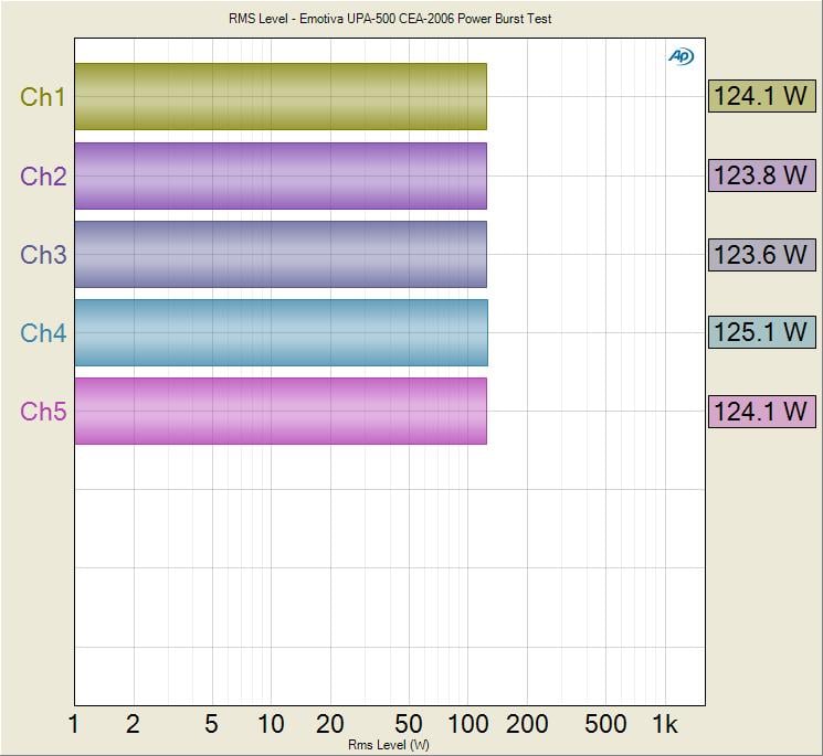

Dynamic PWR - 1kHz CEA-2006 Burst Method testing. This is a dynamic power measurement adopted from the car industry similar to IHF method only a bit more difficult for an amplifier and more representative of real musical content.
Keep in mind most review publications don't do continuous power measurements and they usually publish power measurements into clipping at 1% THD + N. Our measurements are very conservative as we use a dedicated 20A line with no Variac to regulate line voltage. We constantly monitor the line to ensure it never drops more than 2Vrms from nominal which in our case was 120Vrms.
For more info on amplifier measurements, see: The All Channels Driven (ACD) Test
Emotiva
UPA-500 1kHz Power Test
Left
Pic: ACD, 8 ohms;  Right Pic: 2 Channels driven, 4 ohms
Emotiva
UPA-500 Dynamic Power Test (1kHz)
Left
# of CH Test Type Power Load THD + N 1 CFP-BW 117 watts 8-ohms 1% 1 CFP-BW 225 watts 4-ohms 1% 5 1kHz Psweep 75 watts 8-ohms 0.1% 5 1kHz Psweep 82 watts 8-ohms 1% 2 1kHz Psweep 125 watts 4-ohms 0.1% 2 1kHz Psweep 160 watts 4-ohms 1% 5 Dynamic PWR 125 watts 8-ohms 1% 2 Dynamic PWR 225 watts 4-ohms 1%
Emotiva UPA-500 Power Measurement Table
Emotiva rates the UPA-500 as follows:
80 watts x 5 continuous @ 8-ohm (0.01% THD)
120 watts x 5 continuous @ 4-ohm (0.01% THD)
Emotiva doesn't specify at what frequency they rate their power output, but I assume they mean 1kHz which is how most manufacturers specify all channels driven power claims. My measurements in this scenario verified Emotiva’s power claims but mine were higher in distortion which is likely due to the fact that Emotiva does their power tests holding the line voltage constant whereas we don’t. If you compare our power sweep results to the dynamic power results you get about 1.8dB of headroom for all channels driven into an 8 ohm load and 2.5dB of dynamic headroom into 4 ohms for two channels driven. The power supply exhibits good headroom to deliver quick bursts of dynamic power when the program material calls for it.

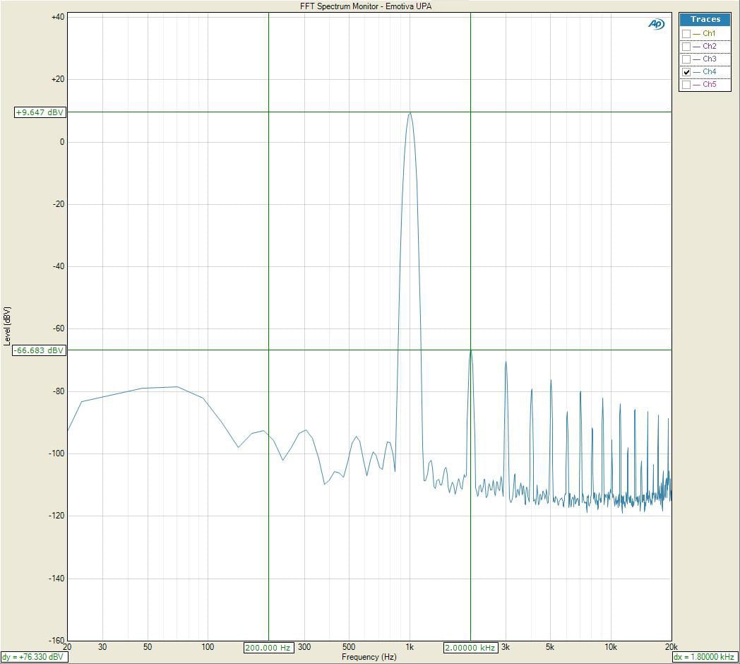

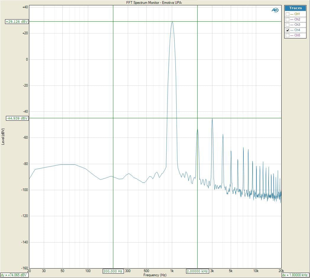

FFT Distortion Analysis
Emotiva
UPA-500 FFT Distortion Analysis
(left
image @ 1 watt ; right image @ full rated power)
I ran FFT distortion plots at 1 watt (left pic) and full rated power (right pic) to determine how clean this amplifier really is. At 1 watt, the spectral distortion wasn’t exactly stellar with the second order harmonic (9.55 + 66.58)dB being 76.2dB down from the fundamental or 100*alog^-1(-76.2/20) = .016%. At 106 watts, I observed (29.13 + 44.94)dBV being 74.1dB down from the fundamental or 100*alog^-1(-74.1/20) = .0040% The odd order harmonics start dominating as the amp starts hitting the rails and becoming slew rate limited at very high frequencies. These are decent measurements, but certainly not the cleanest distortion spectrum I've seen compared to some much higher priced well-executed designs.

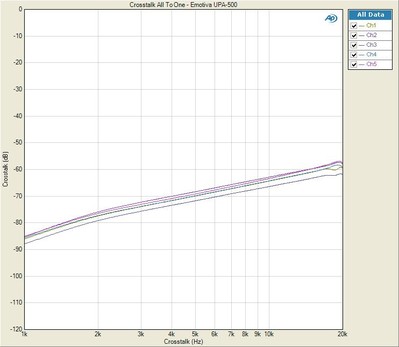

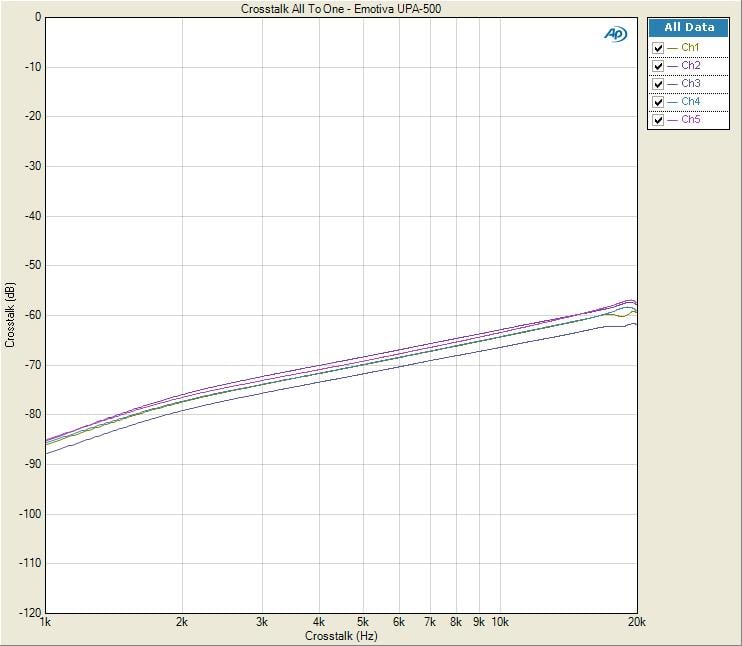

Crosstalk
UPA-500 All-to-One Crosstalk at Rated Power
The UPA-500 exhibited very good channel to channel crosstalk performance, much improved over the older and more expensive UPA-7 actually. With all channels acting as the noise source or disturber, I measured each idle channel one at a time to determine the worst case channel to channel crosstalk. At 1kHz the UPA-500 yielded -85dB @ 1kHz and -60dB at 20kHz for its noisiest channel. I consider anything less than -40dB @ 10kHz acceptable so the UPA-500 met that minimum requirement with over 20dB to spare. With only 1 channel acting as the disturber, the adjacent channel produced -95dB at 1kHz and -70dB @ 20kHz, again very good results.
