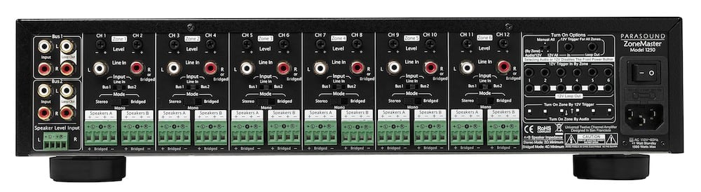

Parasound ZoneMaster 1250 Back

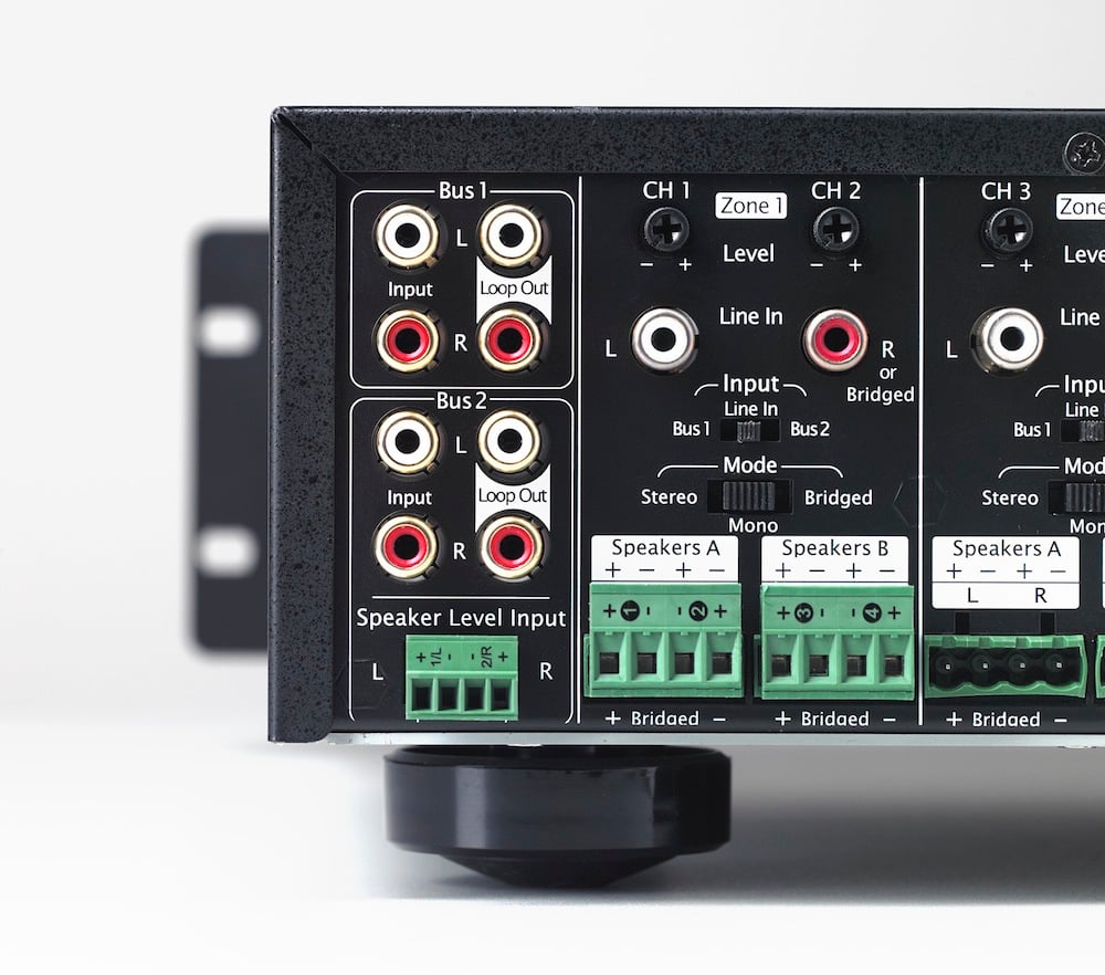

As you'd expect from a distribution amp, the Parasound ZoneMaster Model 1250 has two "Bus" inputs that can be routed to any of the amplifier channels. The Parasound 1250 has 12 channels rated at 50 watts all channels driven. Each channel can be fed from one of the Bus inputs or from a direct input. The 1250 can also accept a speaker-level input via the second Bus channel that can be routed to any of the amplifiers.
Parasound ZoneMaster 1250 Back Closeups

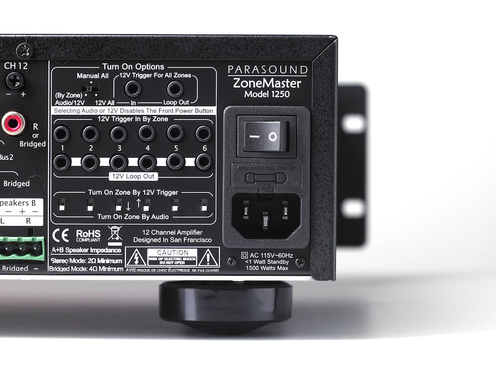

Each channel has not one but two pairs of speaker level outputs (Phoenix-style) so that two speakers can be wired to the same channel. These speaker outputs can accept up to a 12 gauge wire. As the Parasound ZoneMaster 1250 is stable into 2 ohms, this allows extreme flexibility for your speaker options in your distributed audio system. It has a Class A/B input stage and Class D power stage for extremely efficient operation. There are also independent 12-volt triggers with looping trigger outputs for each zone, and a global 12-volt trigger.

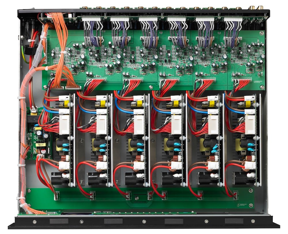

Parasound ZoneMaster 1250 Inside
The flexibility doesn't stop there. Users can opt to bridge two of the channels for 160 watts into 8 ohms or 200 watts into 6 ohms to augment their home theater channels. With new surround solutions like Dolby Atmos, DTS UHD, and AURO-3D coming out, having extra amplification lying around is now more important than ever.
