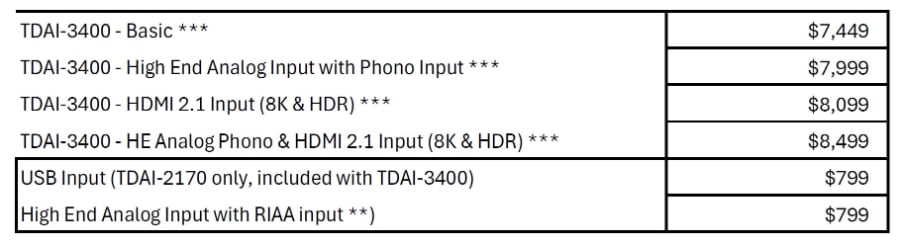

At $8,500 fully configured, it’s certainly not inexpensive, but does its feature set and performance make it the ultimate configurable two-channel streaming integrated amp? I intend to answer that question in this review.
TDAI3400-configuration
Lyngdorf TDAI-3400 Configuration Options & Prices

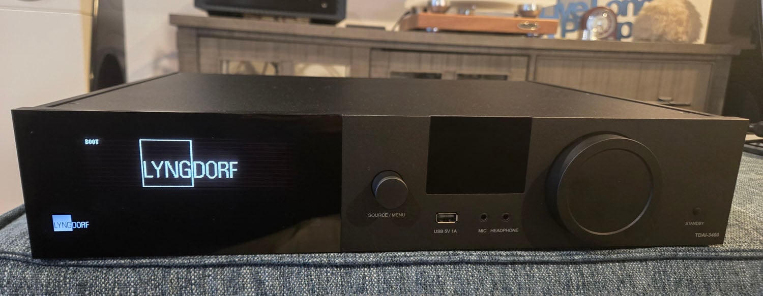

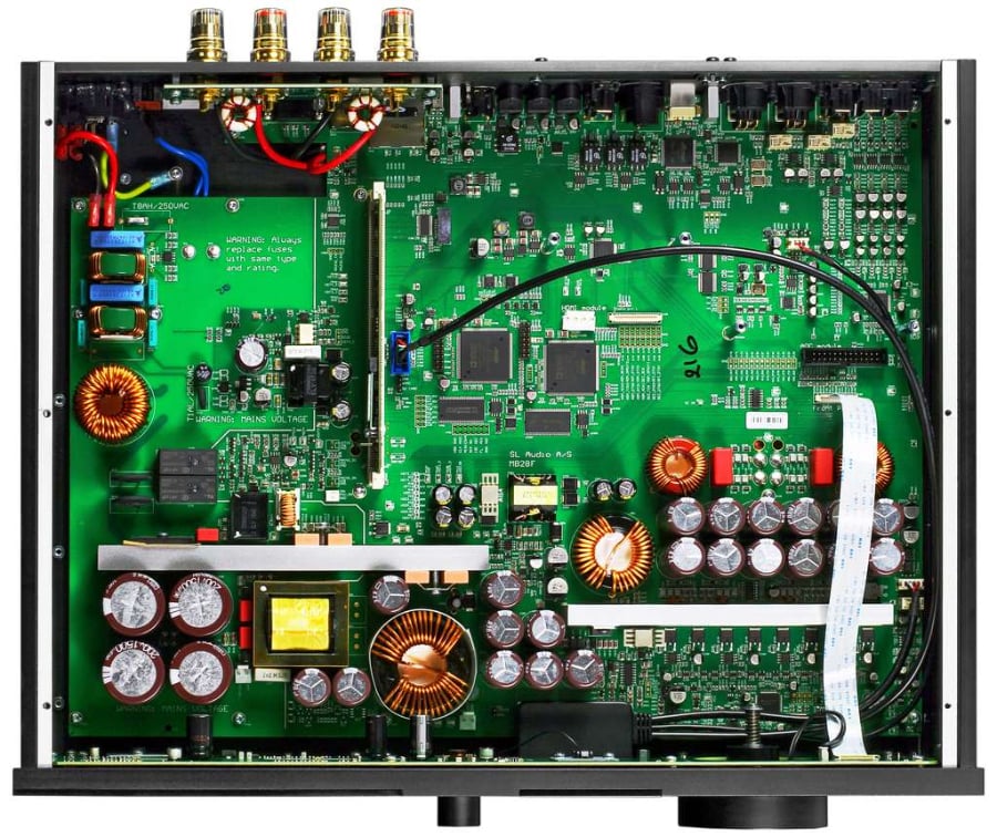

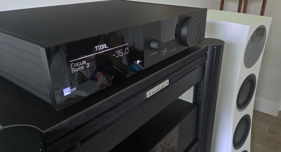

The Lyngdorf TDAI-3400 is laid out very neatly as you can see in the top view image. There is a decent amount of heatsinking on the power devices but I will do a 5 min FTC power test to determine if the unit can deliver it’s rated power without shutting down or melting, just don’t try this at home!

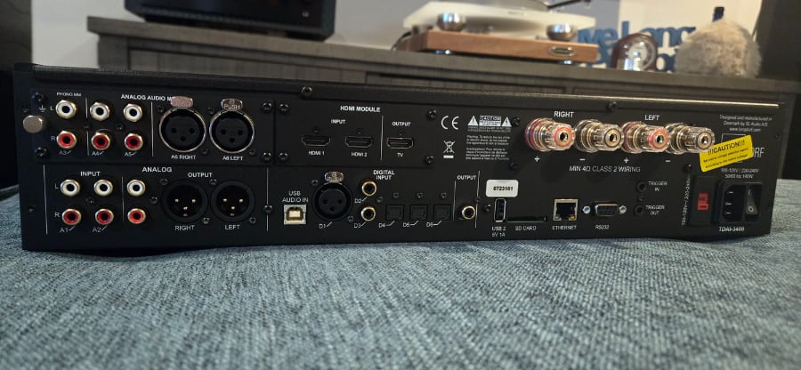

My TDAI-3400 review unit came fully loaded with the analog (including phono) and HDMI 2.1 8K/HDR 40Gbs modules. The TDAI-3400 is one of the rare few consumer products I’ve encountered with both unbalanced and balanced digital inputs, full bass management capabilities and advanced routing options, and dual subwoofer outputs. It’s a shame there is only one set of speaker output terminals but understandable to maintain its low profile height that gives the product a sleek elegant appearance.

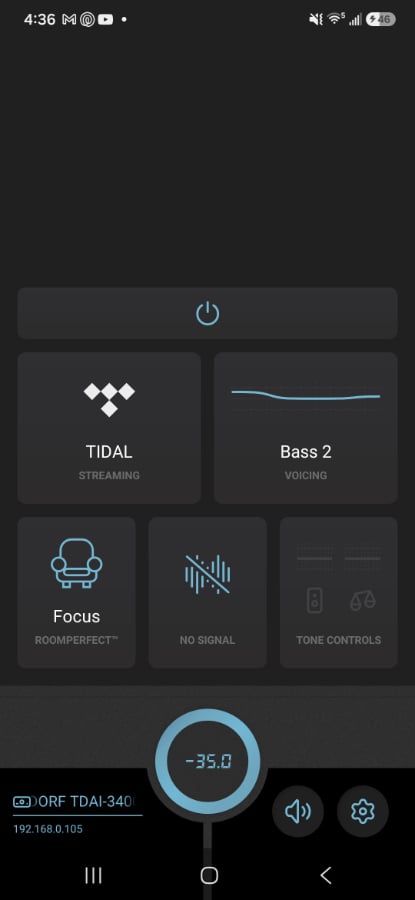

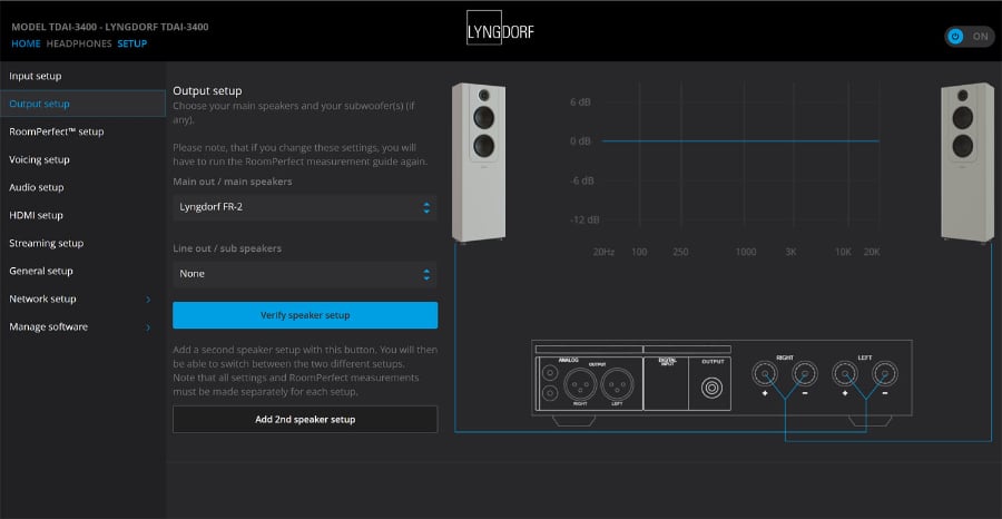

The web interface is accessible by typing “tdai3400.local” into a browser on a laptop on the same network as the TDAI-3400 (or clicking the link within the MyLyngdorf app). I recommend watching my YouTube video which gives you a comprehensive overview of the web interface including a tour of the various settings to help optimize the performance of your system.
   Lyngdorf-App1 Lyngdorf-App2  Lyngdorf-remote
Lyngdorf Android App

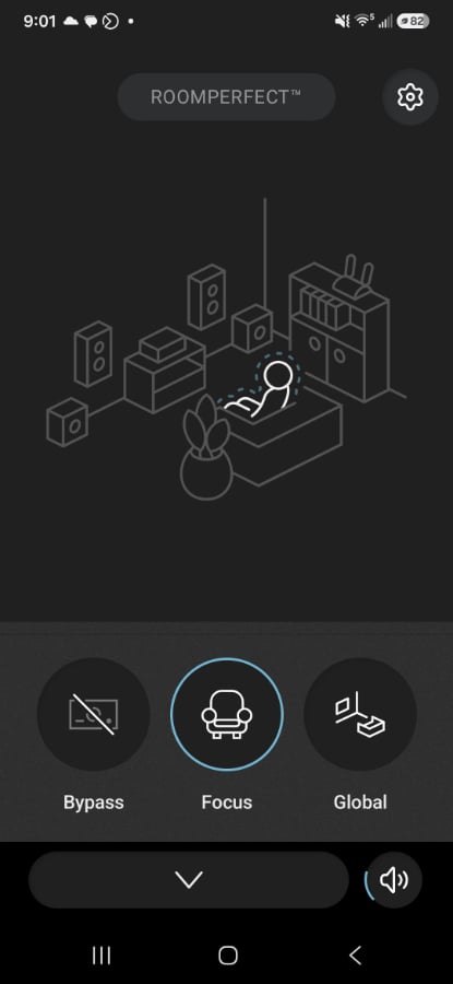

voltage-switchThe App is intuitive to use and an absolute breeze to toggle RoomPerfect on or off, and adjust and compare the various voicings. I wish more hi-fi products offered flexible PEQ and shelving filter adjustments instead of ordinary tone controls. Oh, the TDAI-3400 also has tone controls too and best of all, you can adjust the turnover frequency on them and even change the polarity of your speakers as pairs or left/right individually. Absolutely awesome tuneability for this product and the sky is literally the limit!

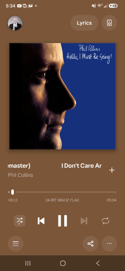

When streaming Tidal on the TDAI-3400, I found it easiest to just use Tidal connect directly through the Tidal App on my phone and it worked without incident.

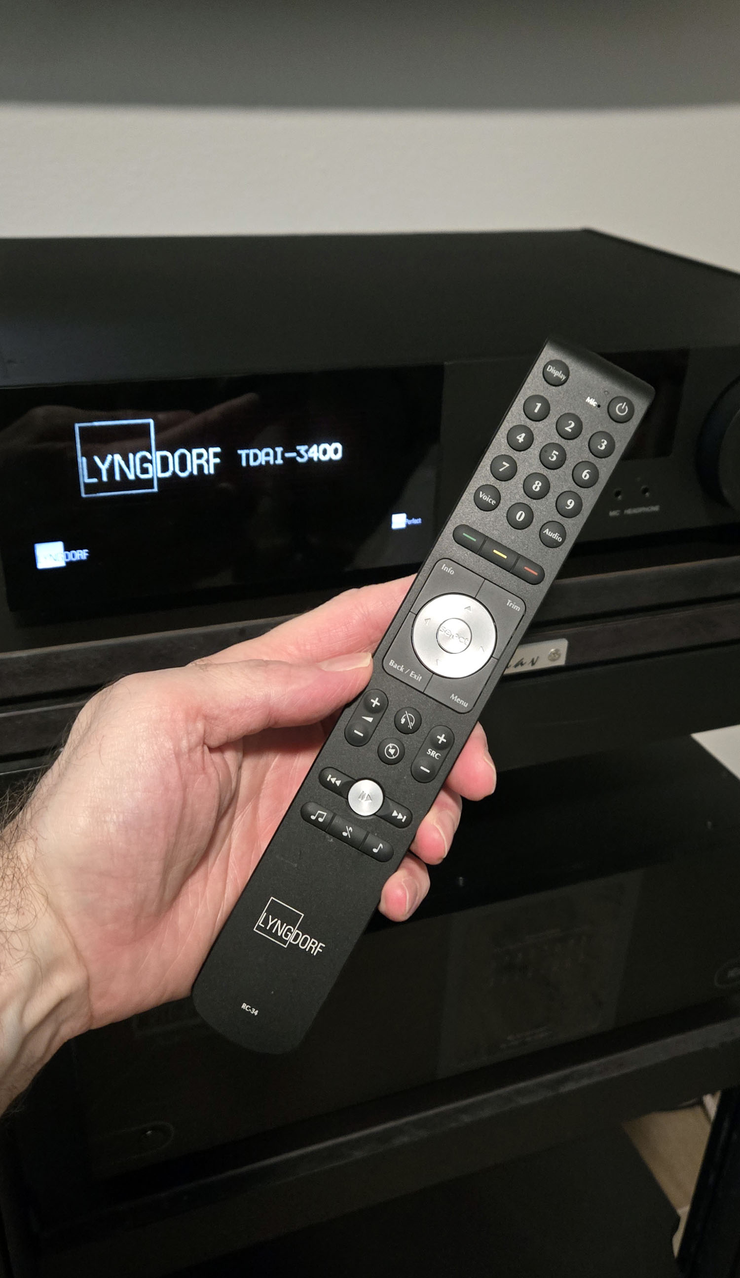

I found the remote control intuitive to use, with a clean layout that made navigating inputs, volume, and RoomPerfect settings effortless. It’s compact enough to comfortably operate with one hand, which is a must for me, while still feeling responsive and refined like a proper high-end component remote should.

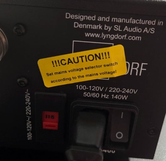

Editorial Note About Voltage Selector Switch – IMPORTANT -
During initial power testing of the Lyngdorf TDAI-3400, the amplifier clipped at around 31Vrms instead of the expected 40Vrms, limiting output to roughly 120 watts per channel into 8 ohms rather than its rated 200 watts per channel. The issue was later traced to the rear-panel voltage selector being inadvertently set to 220VAC instead of 120VAC, underscoring the importance of verifying the voltage setting for your region before powering up the amplifier. While many modern SMPS-based designs (including Lyngdorf’s own TDAI-1120 and 2210 models) offer automatic line-voltage sensing, Lyngdorf instead relies on a manual voltage selector. A sticker near the power inlet serves as a reminder for users to verify the amplifier is configured for the correct operating voltage before powering it on.

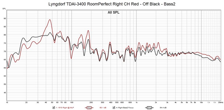

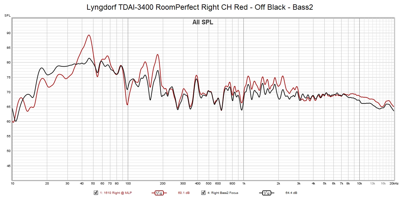

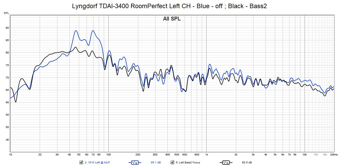

RoomPerfect In-Room Measurements at MLP for Left vs Right Arendal 1610 Tower 8
In my downstairs music room, the listening chair is close to the back wall which is a maximum pressure area and thus lots of bass build up which can sound boomy or too energetic if a loudspeaker system is has enough piston area to excite the room modes with authority. The Arendal 1610 Tower 8s triple 8” woofers are up to the task and with RoomPerfect disengaged, the bass can be overwhelming on heavy bass tracks. RoomPerfect did an excellent job at flattening out the bass peaks for both speakers while also extending the bass extension with some boost when employing “bass 2” voicing. Treble titled slightly down, but I felt “bass 2” was the best sounding voicing preset out of the various options offered.

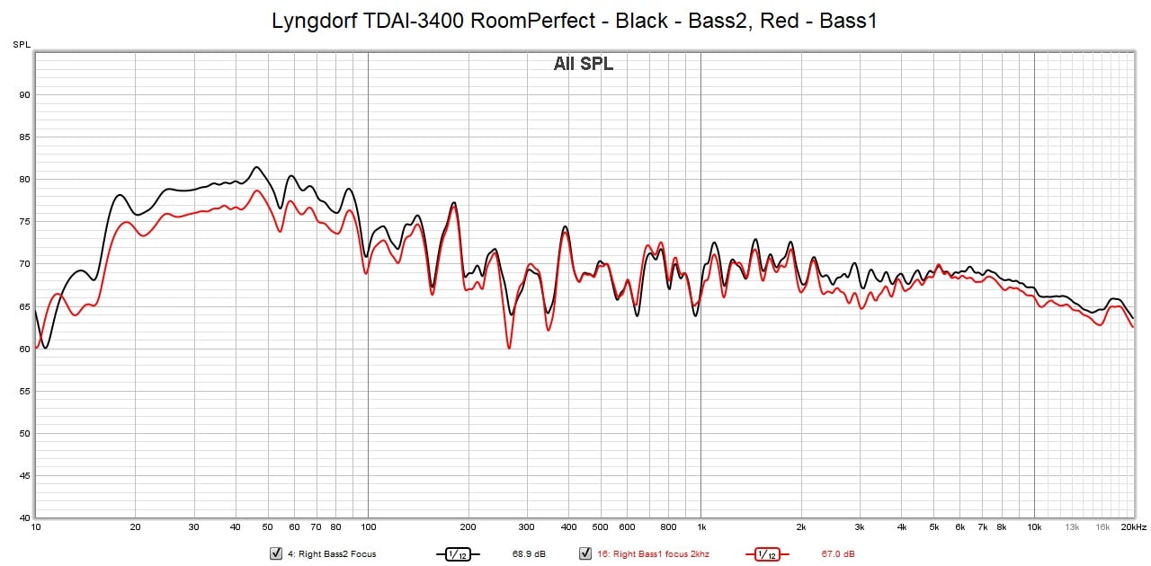

RoomPerfect-Right-bass1vs2
RoomPerfect In-Room Measurements at MLP Bass 2 vs Bass 1 Voicing - Right Arendal 1610 Tower 8
Bass 1 voicing resulted in the bass sounding too lean and it also introduced the 2kHz BBC dip which created an unnecessary notch in the response from 2kHz-4kHz which undermines the excellent engineering of the Arendal speakers that have excellent mid/tweeter driver integration and directivity control.

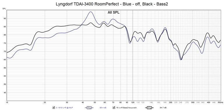

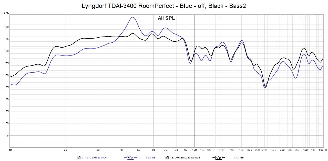

RoomPerfect-L+R-bass2
RoomPerfect In-Room Measurements at MLP for Left + Right Arendal 1610 Tower 8
With both speakers playing, you can see a much more linear response with RoomPerfect engaged and it even provided a little boost to a bass null in the 100-120Hz range that was perceived as much needed upper bass punch. With RoomPerfect engaged, I measured +-5dB from 15Hz to 200Hz around MLP which is the best response I’ve been able to achieve in this room with just a pair of speakers and no powered subs strategically placed as supplementation.

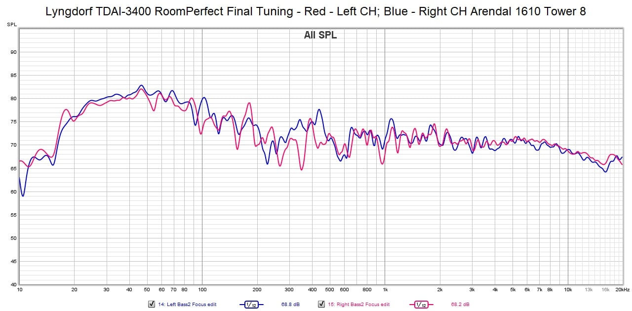

RoomPerfect-finaltune
RoomPerfect In-Room Measurements at MLP Custom Voicing - Left vs Right Arendal 1610 Tower 8
I customized the Bass2 voicing by employing a couple of shelving filters at low and high frequencies and through trial and error landed on these curves which sounded right in my listening set up. There is about a +5dB tilt up in bass response below 100Hz and a very flat response from 600Hz to about 8kHz with a natural tapering off of high frequencies above.
After dialing in the EQ, I went back and compared Focus vs Global modes of RoomPerfect.
  • Focus Mode: Prioritizes a single listening position, optimizing imaging precision, tonal accuracy, and bass integration for the main seat (or stored “focus” seats).
  • Global Mode: Averages correction across multiple measurement positions to deliver more consistent overall room coverage, with smoother response across a wider listening area but slightly less pinpoint seat-specific precision.
There were times when I preferred the “Global” mode in my setup, especially if I wasn’t sitting dead center at the MLP. However, if you can find that sweet spot, I believe “Focus” mode is the better choice. We observed this at a Lyngdorf listening event at Crowne Audio. In the front row, “Global” sounded best to my ears and to Lyngdorf rep Lee Rambler, but behind the MLP, “Focus” mode actually sounded more dialed in. This is subjective and something you’ll need to experiment with using real program material, such as your favorite demo tracks, as it can’t be fully evaluated using test tones and acoustic measurements alone.

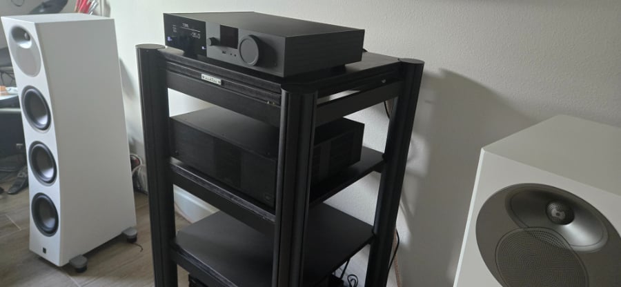

I set up the Lyngdorf TDAI-3400 in our downstairs music room featuring a pair of Arendal Sound 1610 Tower 8 speakers I currently have in for review. For source devices, I used the streaming features of the TDAI-3400 via Tidal connect with a 1Gbps ethernet connection along with my Denon DCD-A110 SACD player. The system was wired with Kimber Kable 12TC speaker cable and Bluejeans cable 1694 interconnects.

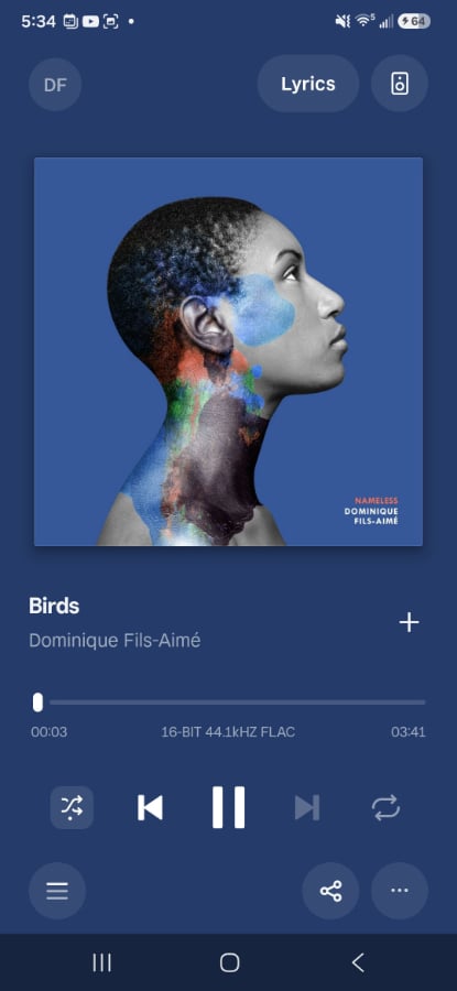

I started my listening session with Dominique Fils-Aime “Birds”. The vocal clarity of this track was excellently portrayed on the Arendal Sound 1610 Tower 8 speakers powered by the Lyngdorf TDAI-3400. With no RoomPerfect engaged, I did feel the tonal balance was a bit more laid back compared to my reference Denon PMA-A110 integrated amplifier. With RoomPerfect engaged “bass2” voicing and my added tweaks, spaciousness was improved and the bass tightened up with slightly more extension.
Birds PhilCollins  QueenMary
One of my favorite tracks, Phil Collins’ “I Don’t Care Anymore,” sounds surprisingly good streamed on Tidal. RoomPerfect brought out all of the subtle details in the ghost notes of Phil’s drumming, while the kick drum hit hard yet remained well damped, with none of the boominess I heard when RoomPerfect was disengaged.

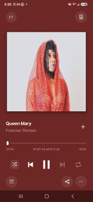

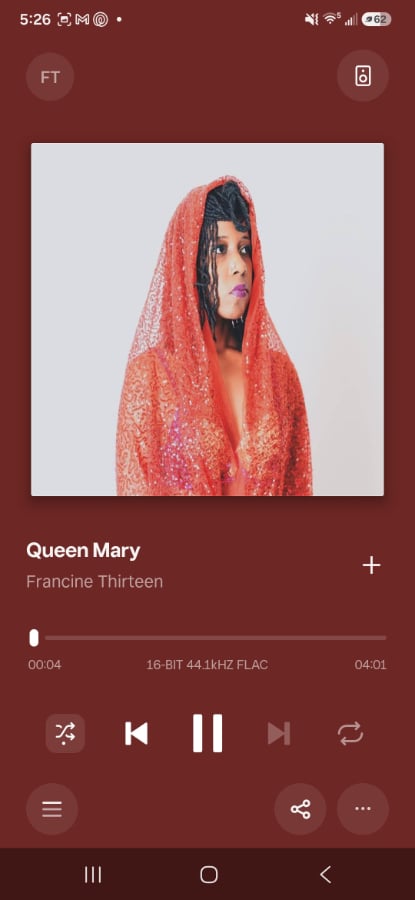

Francine Thirteen’s “Queen Mary” is a track that should be on everyone’s demo list when auditioning speakers or amplifiers. This song will quickly reveal weaknesses in bass response, and I’m happy to report that neither the Lyngdorf TDAI-3400 nor the Arendal 1610 Tower 8 speakers exhibited any such shortcomings. In fact, I was quite amazed at how effortlessly the TDAI-3400 drove the 4-ohm Arendal 1610 towers, even at listening levels louder than I’d care to sustain for more than a short period of time.
There’s a lot of decorrelated information in this track that creates a convincing “surround effect” from just a pair of speakers. The panning between the synthetic hi-hat and various sound effects was rendered with greater depth and soundstage precision when RoomPerfect was engaged, while the bass also sounded tighter and more controlled. The bass drop at the 0:26 mark put a smile on my face and persuaded me to turn the volume up just a little more.

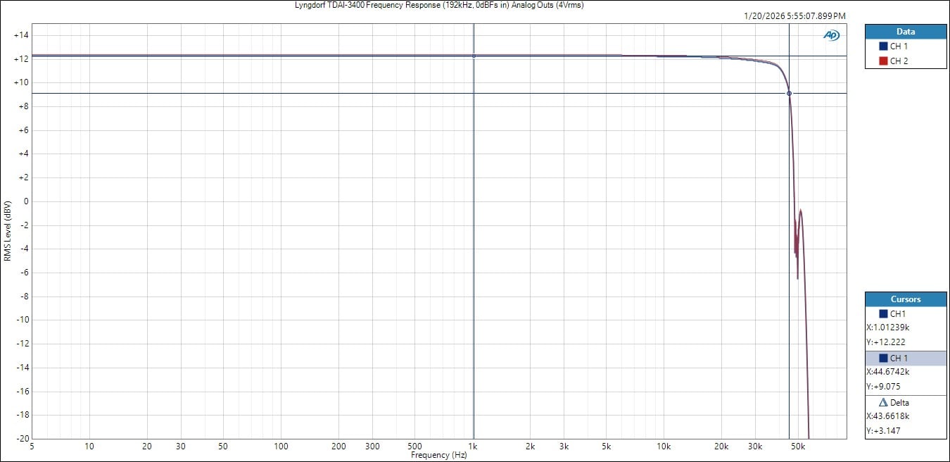

TDAI-3400 Analog Preamp Output
Frequency Response
TDAI3400-Freq192k-analogout

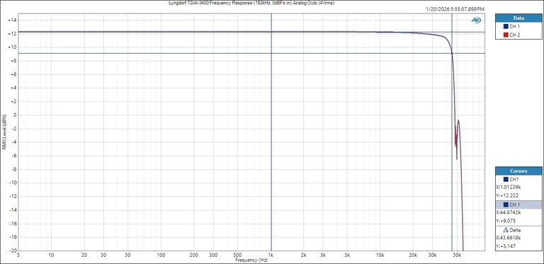

Lyngdorf TDAI-3400 Frequency XLR  Outputs
I measured the Lyngdorf TDAI-3400 frequency response from the XLR analog outputs using a 0dBFS 192kHz/24 bit test signal via AED-EBU digital input and observed a ruler flat frequency response all the way to ½ Nyquist which in this case is 48kHz since the TDAI-3400 downsamples to 96kHz. Channel-Channel deviation was +-0.085dB from 5Hz to 20kHz which is excellent.

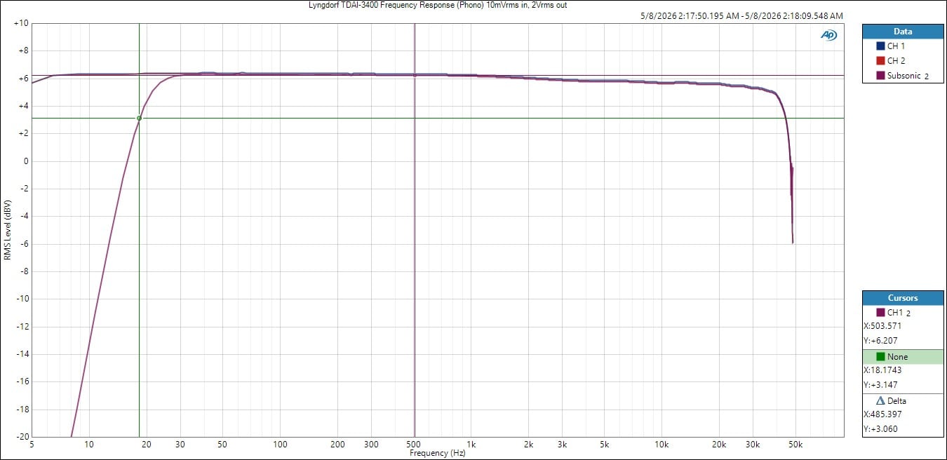

TDAI-3400-phono-out
Lyngdorf TDAI-3400 Frequency Phono Output
The Lyngdorf TDAI-3400 has a Moving Magnet (MM) phono preamp but no Moving Coil (MC) which is a bit disappointing at this price but what they give you for MM is nothing short of stellar. Using the original 3-time constant RIAA curve, I EQ’ed the APx585 source to get the expected flat response of the phono preamp. The source was driven from 1mVrms up to 20mVrms to determine frequency response, distortion and linearity. The typical MM cartridge voltage is anywhere from 2.5mVrms  to 5mVrms so the fact that the Lyngdorf was able to handle up to 20mVrms input cleanly is excellent. The defeatable subsonic filter works as expected at with a -3dB of 18Hz and slope of 24dB/oct.

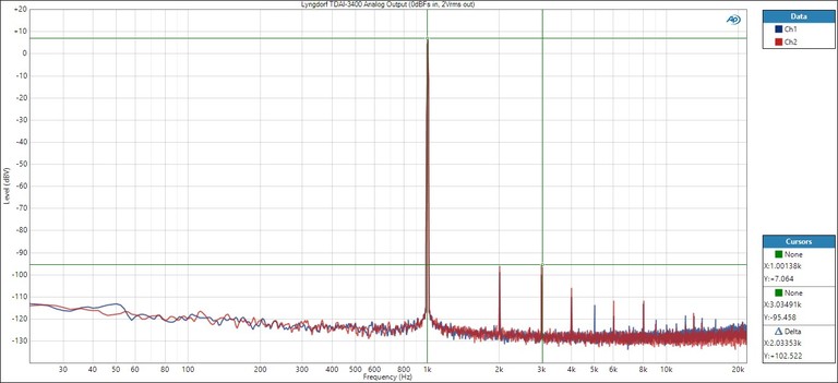

FFT Distortion Analysis

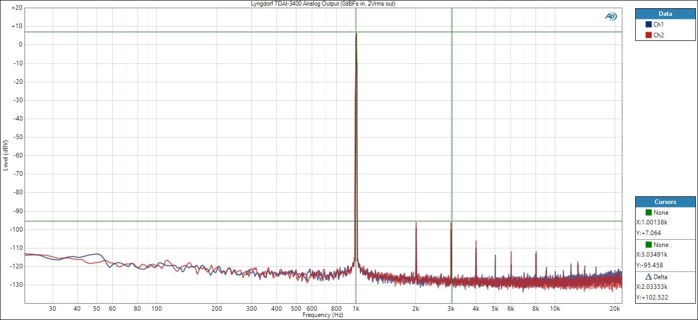

TDAI3400-analog-FFT-2Vrms
Lyngdorf TDAI-3400 1 kHz FFT @ 2Vrms (XLR output)
The Lyngdorf TDAI-3400 produced an excellently low distortion profile driven with 0dBFs input and 2Vrms output with the 3rd harmonic being 102.5dB below the 1kHz fundamental.

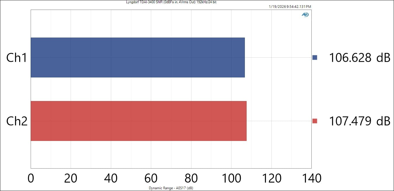

TDAI3400-SNR-4Vrms-24bit
Lyngdorf TDAI-3400 XLR Preout (4Vrms) – Signal to Noise  Test (1kHz 192kHz/24, A-wt)
With a 0dBFS 192kHz/16bit test signal, the TDAI-3400 measured 106 SNR at 4Vrms or about 18 bit resolution which isn’t quite up to the best I’ve measured (116dB or 19 bit) from other products in this category under similar test conditions, but still not a bad measurement and a marked improvement over standard 16 bit Red Book.

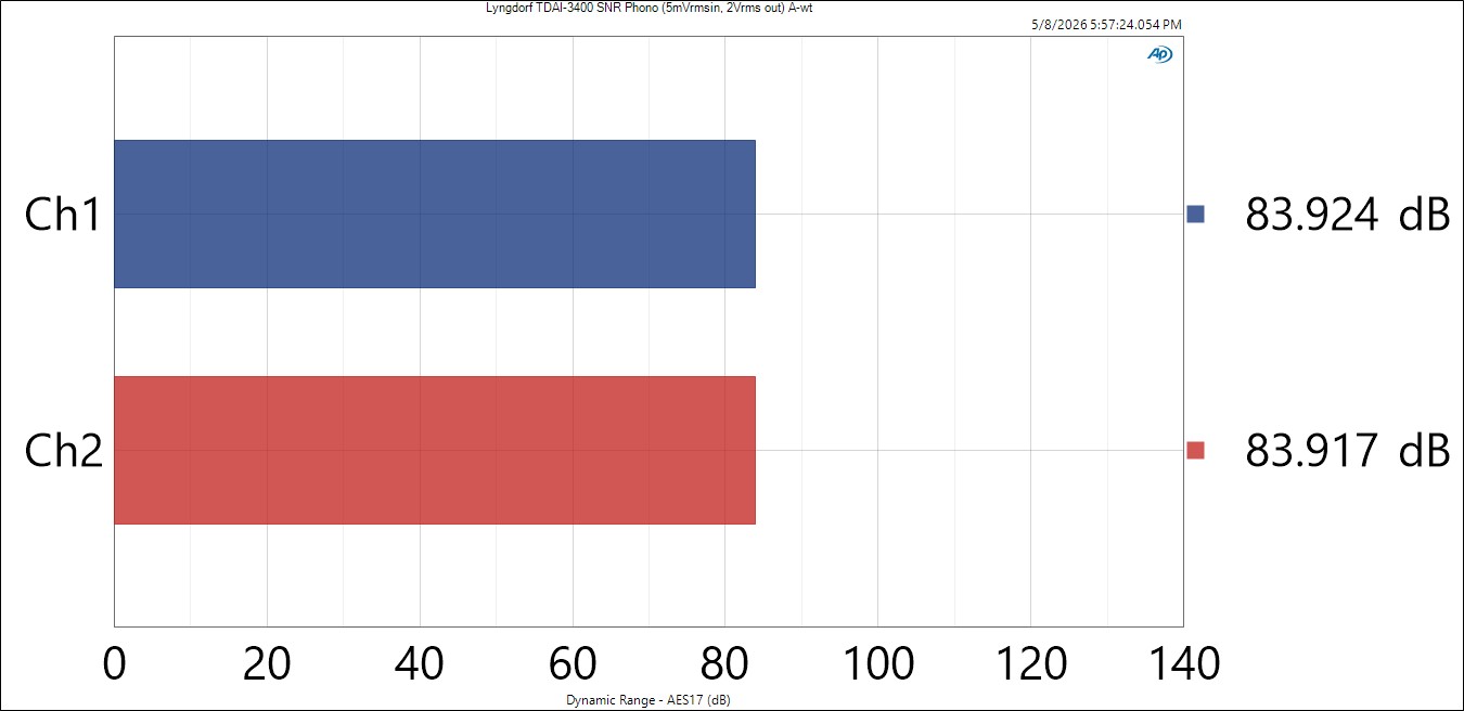

TDAI-3400-Phono-SNR-5mvrms
Lyngdorf TDAI-3400 Phono Out  (2Vrms) – Signal to Noise  Test (A-wt)
With a 5mVrms input signal to simulate the voltage level typical of a MM cartridge, I measured 84dB SNR (A-wt) at 2Vrms unbalanced and balanced which is excellent. Between the linearity, high input drive capabilities and linearity, Lyngdorf offers up a very high quality MM phono stage in their analog module and well worth it for vinyl lovers.

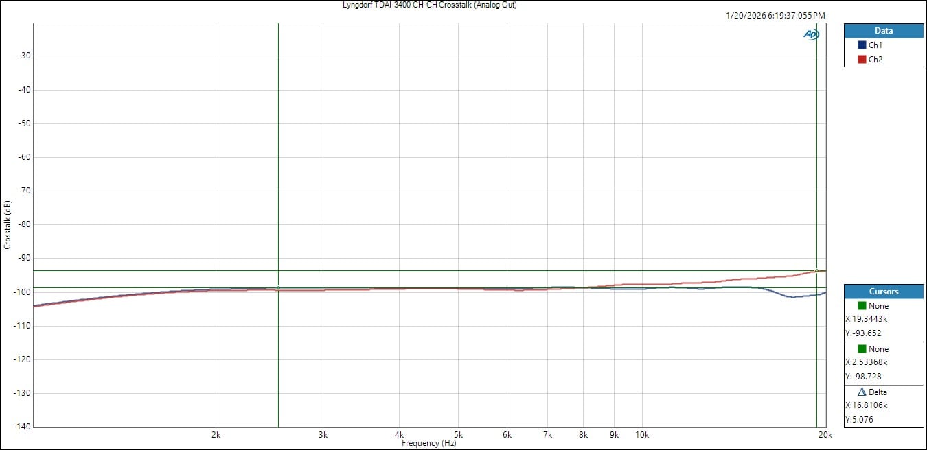

TDAI-3400-XTALK-analog
Lyngdorf TDAI-3400 CH-CH Crosstalk (1CH, Undriven) Analog Out (2Vrms)
The channel-channel crosstalk from the analog XLR outputs is excellent > 95dB  at 20kHz.

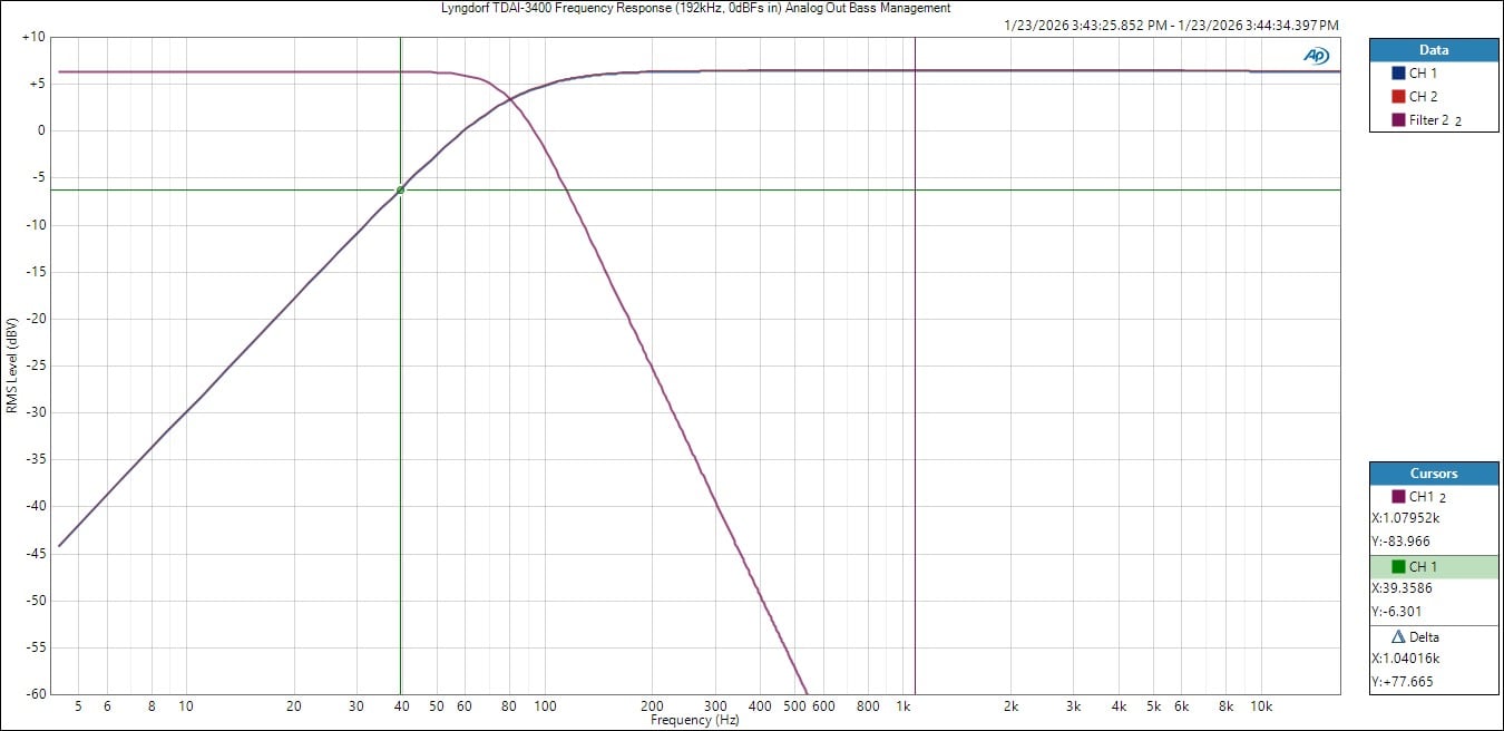

Bass Management
The Lyngdorf TDAI-3400 has the most advanced bass management options I’ve ever seen in a two-channel integrated amplifier. It’s flexibility is akin to a top notch multi-channel AV processor and it’s a welcome feature set I’d like to see other companies follow suite in this category of product. The TDAI-3400 accommodates dual independent subwoofer outputs which can be configured as stereo or mono and the bass management allows full crossover and filter slope adjustability and filter type (ie. Linkwitz-Riley, Butterworth, etc) for both HPF and LPF functions.
TDAI3400-BassMGMT-HPF-LPF
Lyngdorf TDAI-3400 Bass Management Measurements
Setting the crossovers to the standard THX 80Hz with 12dB/oct for the speakers and 24dB/oct for the sub out, I measured textbook roll-offs and perfect summation. I verified various crossover points and slopes and everything measured as expected.

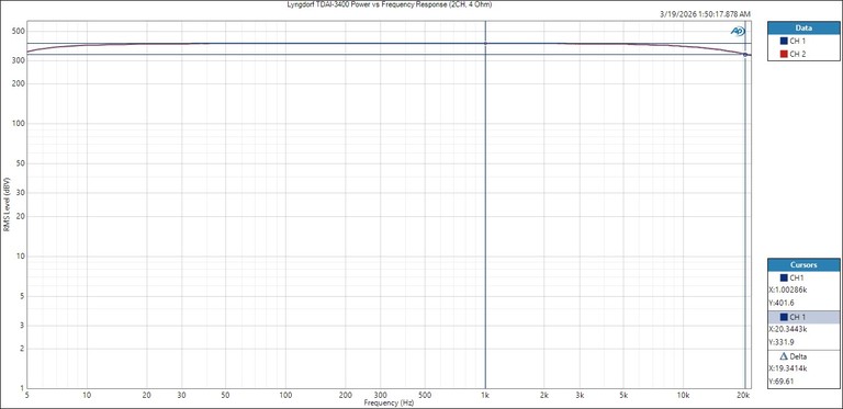

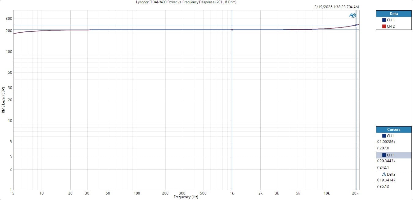

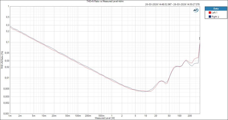

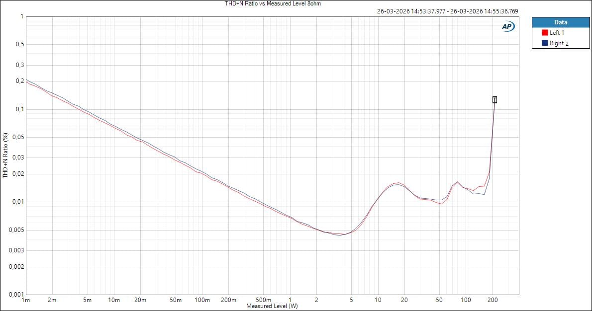

TDAI-3400 Power Amplifier Measurements

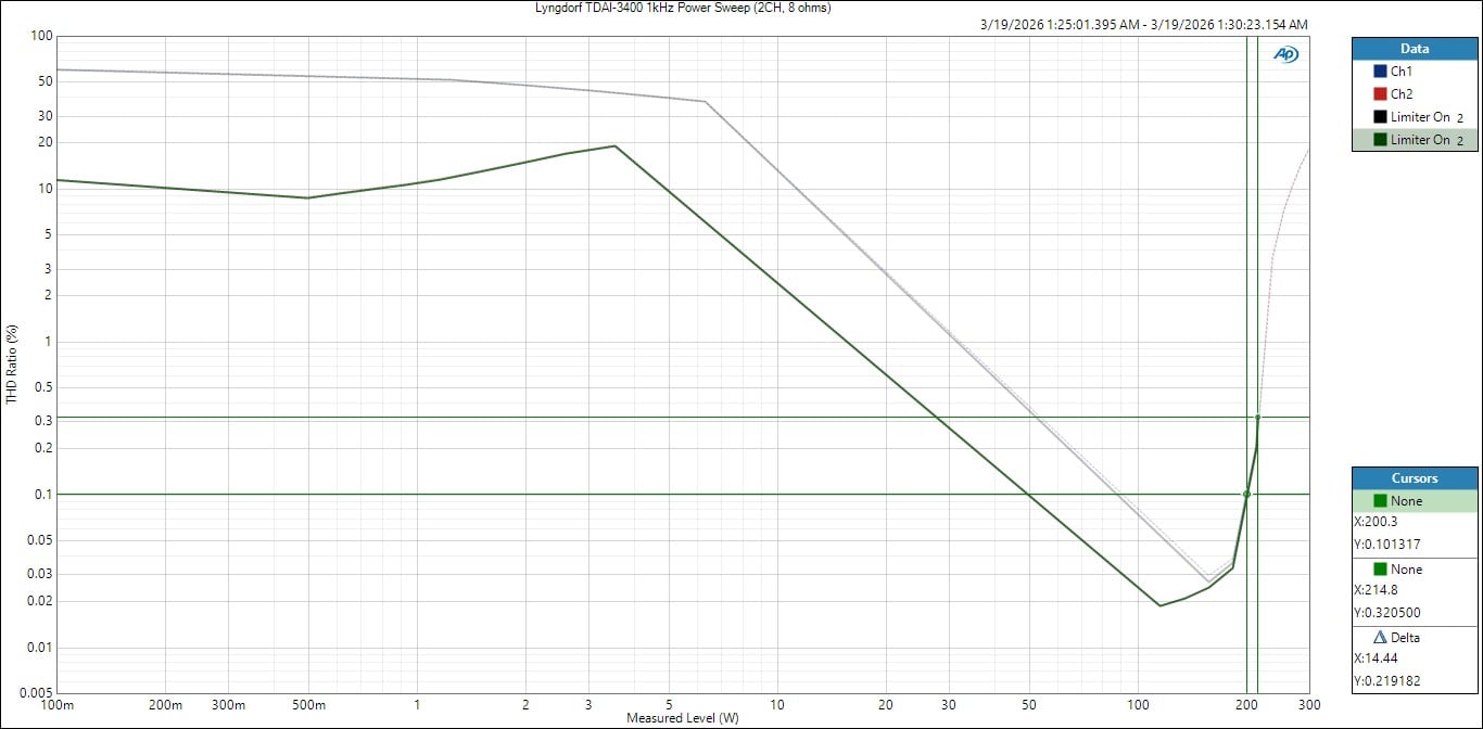

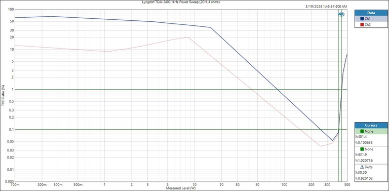

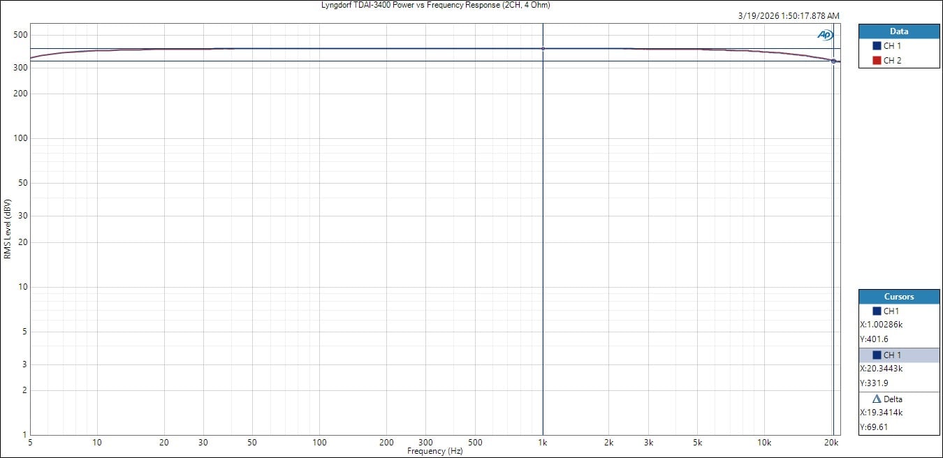

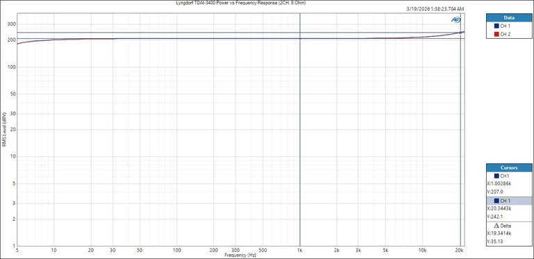

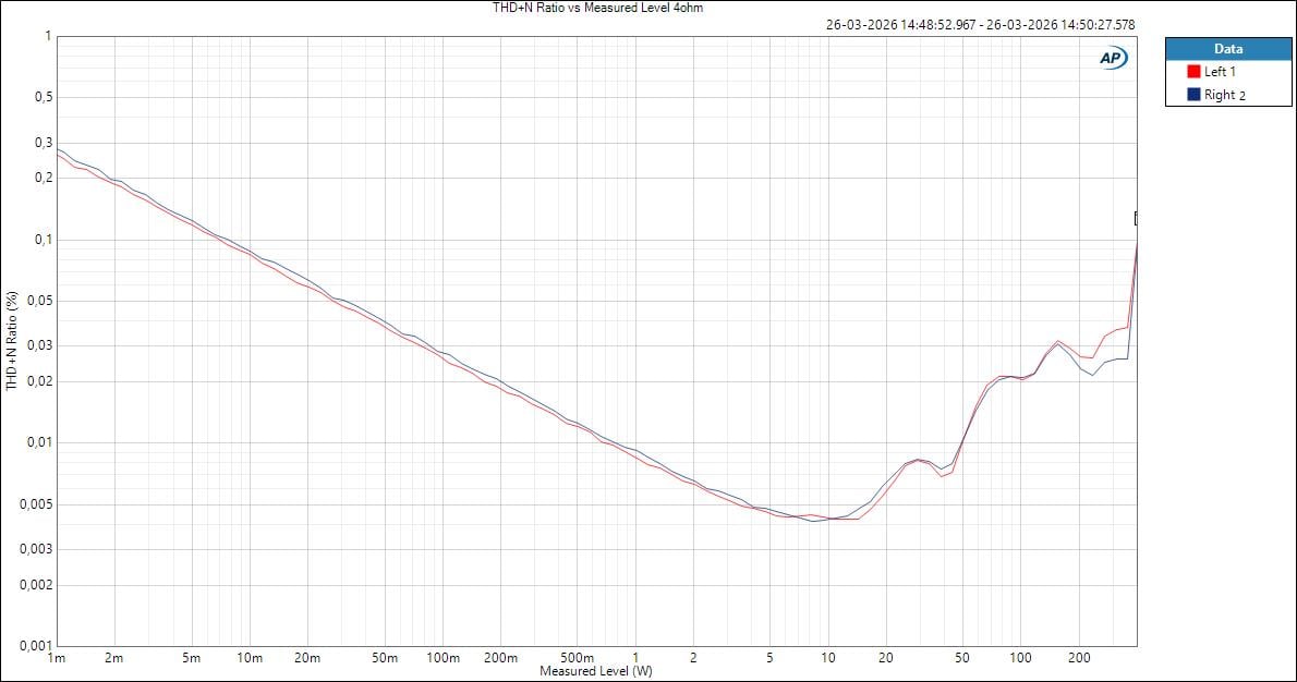

Using our Audio Precision APx585 8-channel HDMI analyzer, we conducted a full barrage of multi-channel amplifier tests on the Lyngdorf TDAI-3400 per our Amplifier Measurement Protocol. We tested power using three methods all of which were taken at < 0.1% THD + N:
  • Continuous Full Power Bandwidth (CFP-BW) from 20Hz to 20kHz into 8 and 4-ohm loads (up to two-channels)

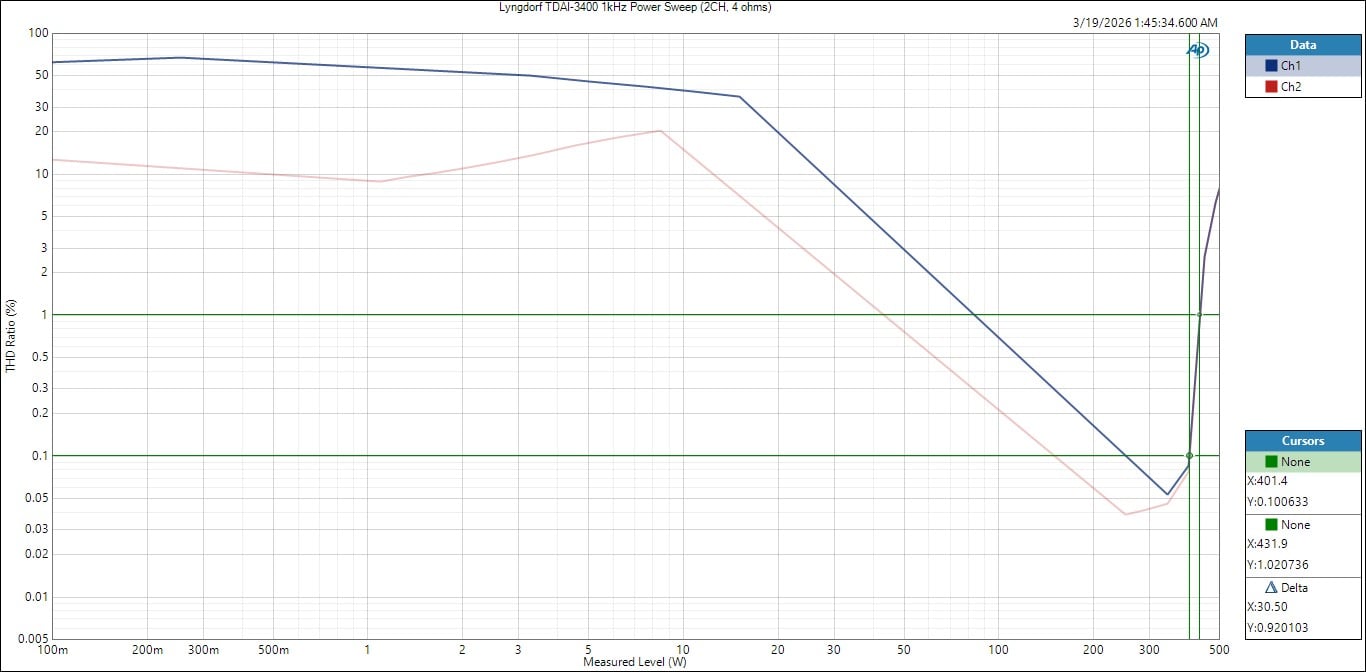

  • 1kHz Power Sweep vs. Distortion (1kHz PSweep) - popularized by the print magazines, this is an instantaneous power vs. distortion test at 1kHz. The problem with this test is it often masks slew-related and/or frequency response problems some amplifiers exhibit at the frequency extremes, and thus inflates the measured power results. It does provide an instant gratification number for consumers to argue over on the forums, so we are now incorporating this test to please the masses.
  • Dynamic PWR - 1kHz CEA-2006 Burst Method testing. This is a dynamic power measurement adopted from the car industry similar to IHF method only a bit more difficult for an amplifier and more representative of real musical content.
Keep in mind most review publications don't do continuous power measurements and they usually publish power measurements into clipping at 1% THD + N. Our measurements are very conservative as we use a dedicated 20A line with no Variac to regulate line voltage.  We constantly monitor the line to ensure it never drops more than 2Vrms from nominal, which in our case was 120Vrms.
For more info on amplifier measurements, see:  The All Channels Driven (ACD) Test

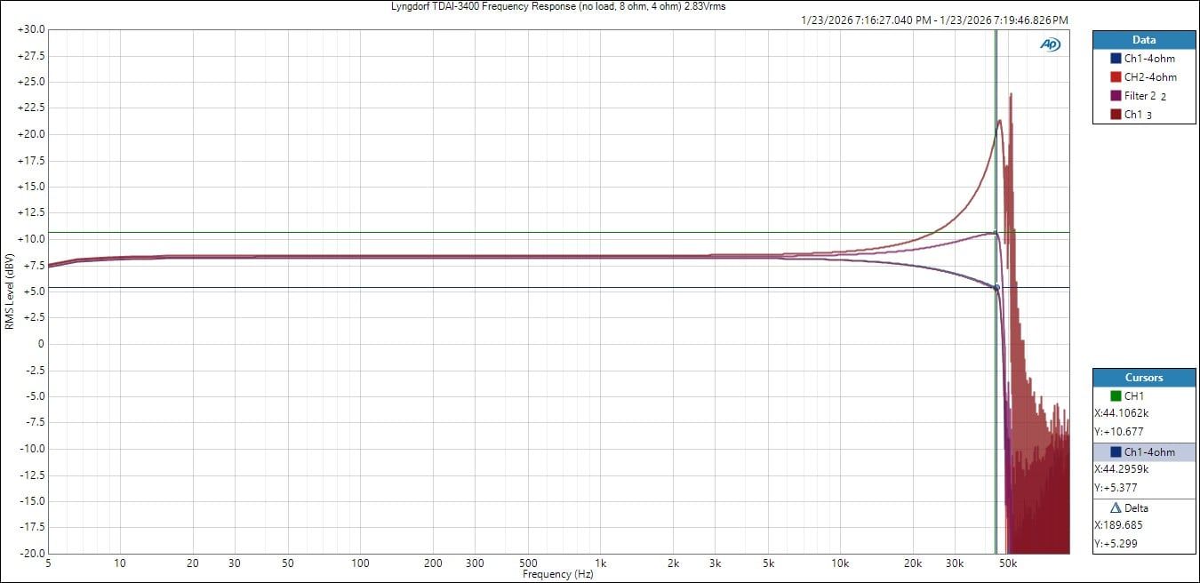

TDAI-3400-freq-spkouts
Lyngdorf TDAI-3400 Frequency Response 1 watt (8 ohm, 4 ohm, no-load) conditions
Sweeping the Lyngdorf TDAI-3400 at 2.83Vrms, I wanted to observe its frequency response variations under 8-ohm, 4-ohm, and no-load conditions. The best linear and Class D amplifiers are typically load invariant, meaning their frequency response remains virtually identical regardless of load. The TDAI-3400 is at a disadvantage here, as the response varies by as much as 15dB above 40kHz between the 4-ohm and no-load conditions, though thankfully that deviation is reduced to about 3dB at 20kHz. This means that, unlike a truly load-invariant amplifier, the TDAI-3400’s sonic performance may vary more noticeably depending on the loudspeaker’s impedance characteristics. This becomes less noticeable when using RoomPerfect to optimize the system response, especially given its ability to tailor the sound via the shelving filters and parametric EQ functions built into the Lyngdorf TDAI-3400.

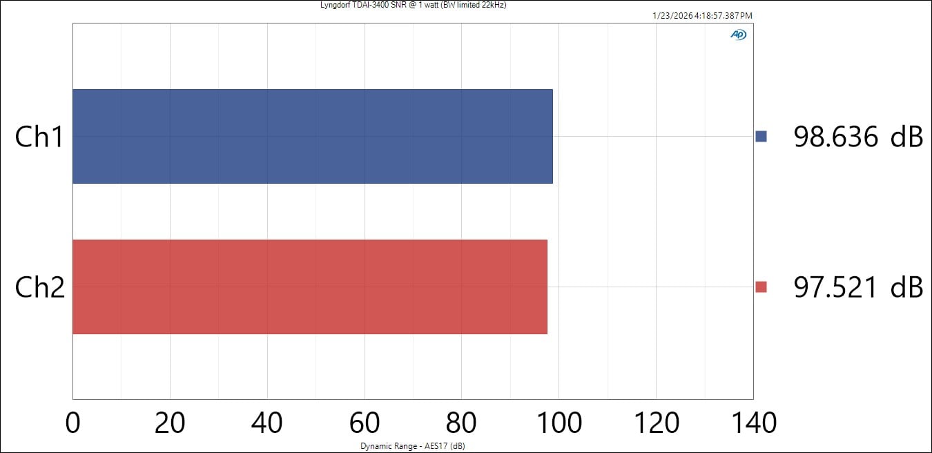

TDAI3400-SNR-1watt-bwlimited
Lyngdorf TDAI-3400 SNR @ 1 watt (bw limited 22kHz)
I always measure amplifiers at 1 watt so that apples-to-apples comparisons can be made between products with different maximum output capabilities. If you want to determine the SNR at rated power, you simply take the 1-watt SNR measurement and add:

Editorial Note about SNR Testing of Lyngdorf TDAI-3400
Because the Lyngdorf TDAI-3400 exhibits substantial ultrasonic switching noise, a 22kHz bandwidth-limited measurement yields a better SNR result than A-weighting alone, since the bandwidth filter more effectively removes out-of-band switching artifacts.
Because the Lyngdorf TDAI-3400 was measured using a 22kHz bandwidth limit rather than A-weighting, its SNR results cannot be directly compared to A-weighted measurements of amplifiers that do not exhibit similar out-of-band noise characteristics.
TDAI-3400-PowerBW-8ohm
Lyngdorf TDAI-3400 Frequency Response @ Full Rated Power (2CH driven, 8 ohms)
The Lyngdorf TDAI-3400 hit its 200 watts/ch spec unclipped from 5Hz to 20kHz for long sweeps with 2CH driven, 8 ohms. The slight rise in frequency response at 20kHz illustrates its load variant behavior.
TDAI-3400-PowerBW-4ohm
Lyngdorf TDAI-3400 Frequency Response @ Full Rated Power (2CH driven, 4 ohms)
The Lyngdorf TDAI-3400 hit its 400 watts/ch spec unclipped from 5Hz to 20kHz for long sweeps with 2CH driven, 4 ohms. The slight fall in frequency response at 20kHz illustrates its load variant behavior. This amp is able to easily double down power with halving load impedance and sustain it continuously with both channels driven is a testament to its robust design and impressive for an integrated amplifier you can carry with just one arm.
TDAI3400-Psweep-8ohm-LimiterNEW
Lyngdorf TDAI-3400 1kHz PSweep (2CH) - 8 ohms
The Lyngdorf TDAI-3400 produced 200 watts/ch at 0.1% THD+N and 214 watts/ch at 1% with both channels driven into 8 ohms. The limiter circuit prevents the amp from going into hard clipping beyond its rated power as you can see in the bold traces where power vs distortion stops above 0.3%% THD+N.
TDAI3400-Psweep-4ohm-NEW
Lyngdorf TDAI-3400 1kHz PSweep (2CH) - 4 ohms
When driving 4 ohm loads, the Lyngdorf TDAI-3400 was able to produce 401 watts/ch at 0.1% THD+N and 432 watts/ch at 1% THD+N with both channels driven right in line with Lyngdorf’s specifications.

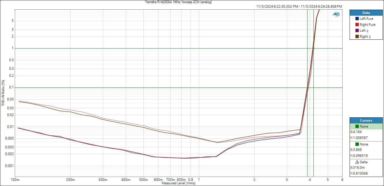

Editorial Note About Distortion Testing on the Lyngdorf TDAI-3400
The Lyngdorf TDAI-3400’s substantial ultrasonic switching noise can overload or contaminate the Audio Precision analyzer input and produce artificial distortion artifacts in the absence of the Audio Precision AUX-0025, making the resulting THD measurements unreliable for meaningful comparison. That is why I have also included the manufacturer’s test results, which are taken using the AUX-0025 filter, to provide a more accurate representation of the amplifier’s true distortion performance.
Lyngdorf-8ohm
Lyngdorf Measurements of TDAI-3400 1kHz PSweep (2CH) - 8 ohms
Lyngdorf-4ohm
Lyngdorf Measurements of TDAI-3400 1kHz PSweep (2CH) - 4 ohms
As you can see with the AUX-0025 precondition filter in place, the Lyngdorf TDAI-3400 THD + N measurements are much more inline with what we’d expect. SINAD is about 88dB at 5 watts which is very good but not as stellar as some of the newer Class D amps from competitors.

Most importantly, RoomPerfect proved to be one of the best room correction systems I’ve used in a hi-fi product. Like Anthem ARC Genesis, it’s easy to set up, requires minimal post-calibration tweaking, and most importantly, it sounds natural and musically convincing. Combined with the outstanding web interface and app control, the TDAI-3400 becomes an incredibly flexible platform for system integration and sound customization. Streaming via TIDAL Connect worked flawlessly, and the amplifier delivered excellent sonics with both digital and analog sources. It drove the 4-ohm Arendal Sound 1610 Tower 8 speakers effortlessly, while RoomPerfect expertly balanced the sound in my room to my liking.
