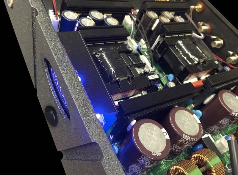

At the heart of the new Powerblock² is the 700ASC2 ICEpower module.  The 700ASC2 is the latest ICEpower module and integrates essential features, such as a comprehensive protection scheme against over-current or over temperature.
Legacy PowerBloc2 ICEpower modules
The Powerblock² utilizes two 700ASC2 modules with a heavy 1/4-inch aluminum heatsink plate strapped across the units
The 700ASC2 combines a high-performance Class D amplifier with a universal mains switch mode power supply.  Legacy Audio says that the regulated power supply ensures that the audio application obtains the same power regardless of AC mains voltage.  The Powerblock² utilizes two 700ASC2 modules with a heavy 1/4-inch aluminum heatsink plate strapped across the units.

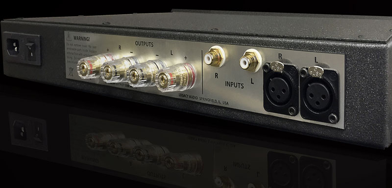

The Powerblock²'s rear panel is spartan but has just about everything you need.
Unlike previous Class D designs that were limited to a 20kHz frequency extension due to aggressive brickwall filtering, the Powerblock² is designed to reproduce an ultra-wide bandwidth of 1.5Hz to 70kHz.  This should  ensure excellent linearity right to the limits of human hearing and again reduce variability based on speaker load.

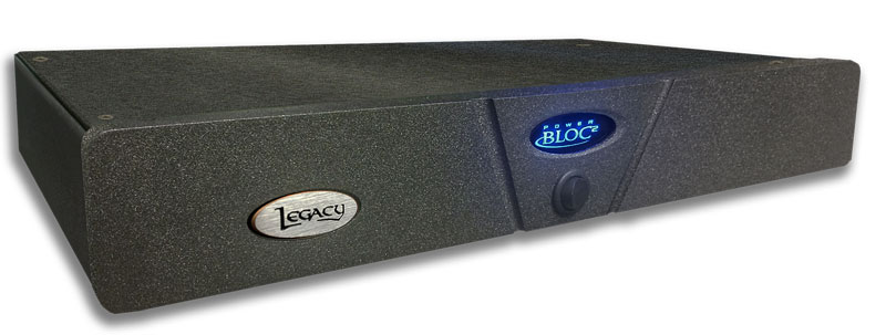

In addition to supporting traditional speakers, Legacy Audio speaker owners will appreciate the fact that the Powerblock² can be used in pairs with Legacy Audio's DSP based processors/crossovers, such as the Wavelaunch or Wavelet that Legacy Audio says helps improve the overall system performance, but doesn’t specify in what areas that performance increase takes place.
On the physical front, the new Legacy amp is incredibly slim and functional at only 3-inches tall and 14-inches deep.  If you’re working in custom installations or need high rack density, this Legacy Audio amplifier is a superb solution. There are two balanced (XLR) and two unbalanced RCA inputs plus high quality five-way binding posts which offer you all the flexibility you need.
Legacy Audio stated  that the goal of the Powerblock² was to “supply a quality amplifier that is budget friendly enough to be utilized for multi-amplification and home theater.”   It looks like they have succeeded.  Given the pedigree and power, the Powerblock² is very reasonably priced at $1,600. If the Powerblock² meets its potential, it has a very high likelihood of becoming one of high end audio’s super values.  When we get one in for testing, we will report back and let you know.
