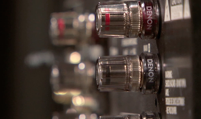

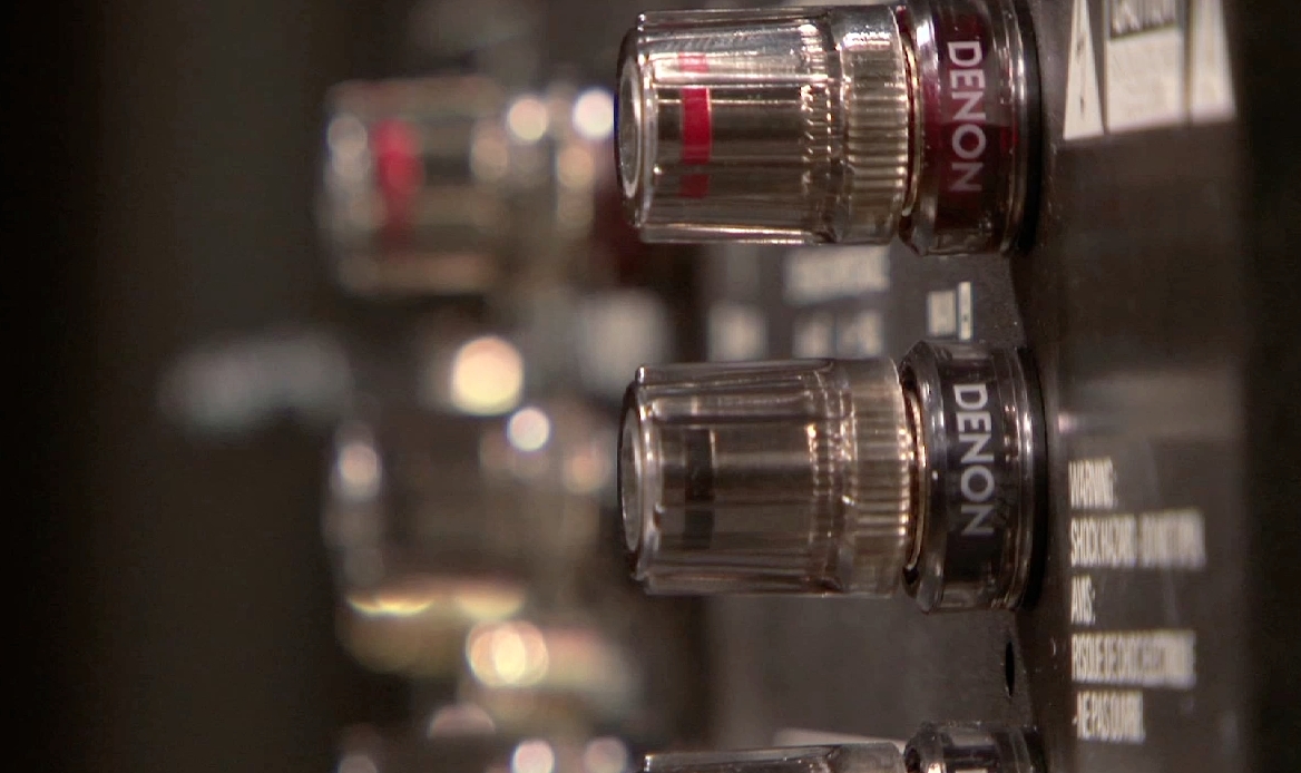

One absent feature is a line of power outlets on the back that can act to switch on devices when the PMA-A100 is turned on. As more and more audiophiles are turning to power conditioners, that's not entirely surprising. For speaker connections, the A100 has 4-pairs of high-end 5-way binding posts that can be used for bi-wiring a pair of speakers if desired. We've found bi-wiring to be mostly a waste of time, but some people have the cables lying around and enjoy it, so there you go - it's ready for you.
binding posts

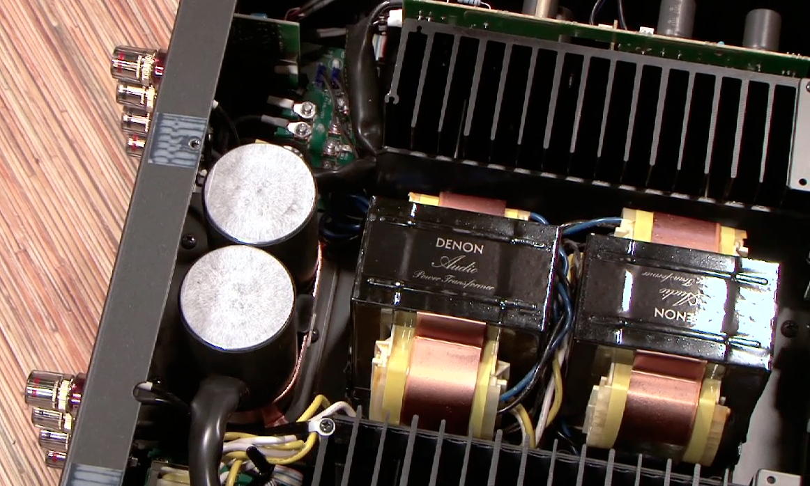

As for power, the A100 puts out 80 watts per channel into 8-ohms at .07% THD. Dynamic power is rated up to 160 watts into 4-ohms, but this is likely continuous given what we're seeing in the amp. We bench-tested this amp below and so check out how it performs when you halve the impedance. And the construction of the amp is beautiful inside as well as out. The power layout is symmetrical with dual transformers, giant 71V 12000 microfarad capacitors, and big heatsinks. It's a work of art.

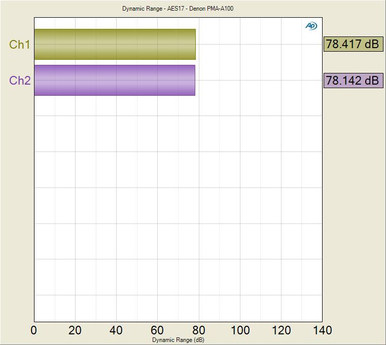

Signal to Noise Ratio
signal to noise
Denon PMA-A100 SNR @ 1 watt (unweighted)
The Denon PMA-A100 measured 78dB SNR at 1 watt with 100mV input signal.  This is a good measurement but not as stellar as we've seen on other high quality gear.  At rated power (80 watts), the SNR was 98dB.

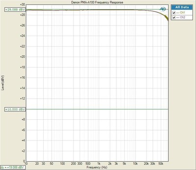

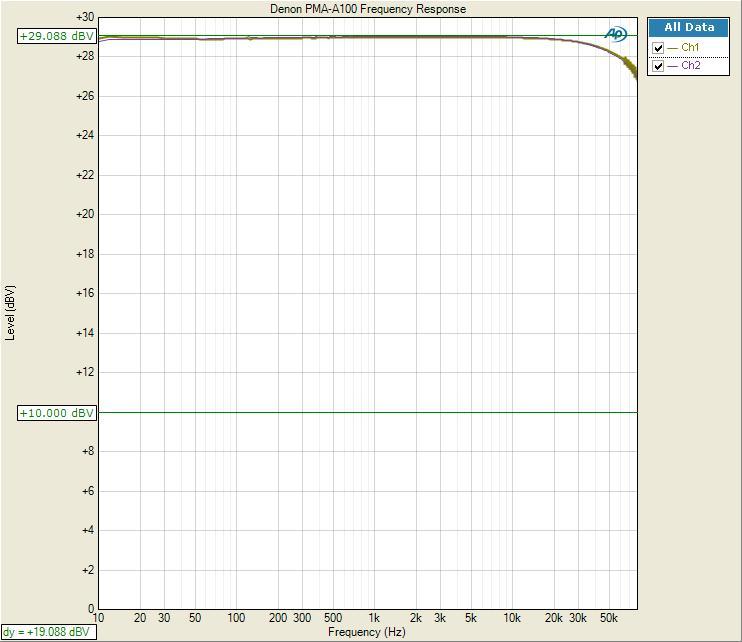

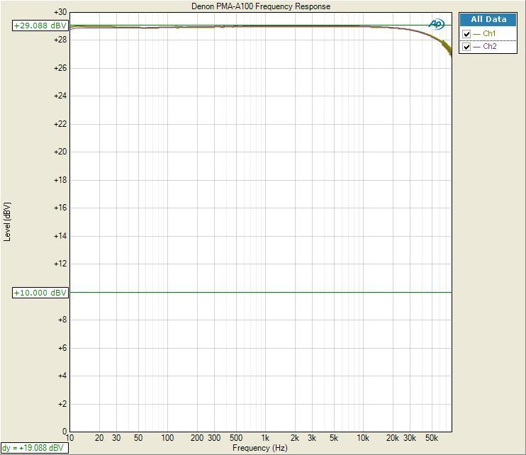

Frequency Response
frequency response
Denon PMA-A100 Frequency Response
The Denon PMA-A100 exhibited ruler flat frequency response for the full audio bandwidth even when driven at 100wpc into 8 ohms which is above its 80 watt power rating.  The -3dB point is around 80kHz which is the limit of the Audio Precision test equipment.

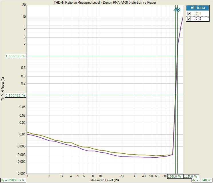

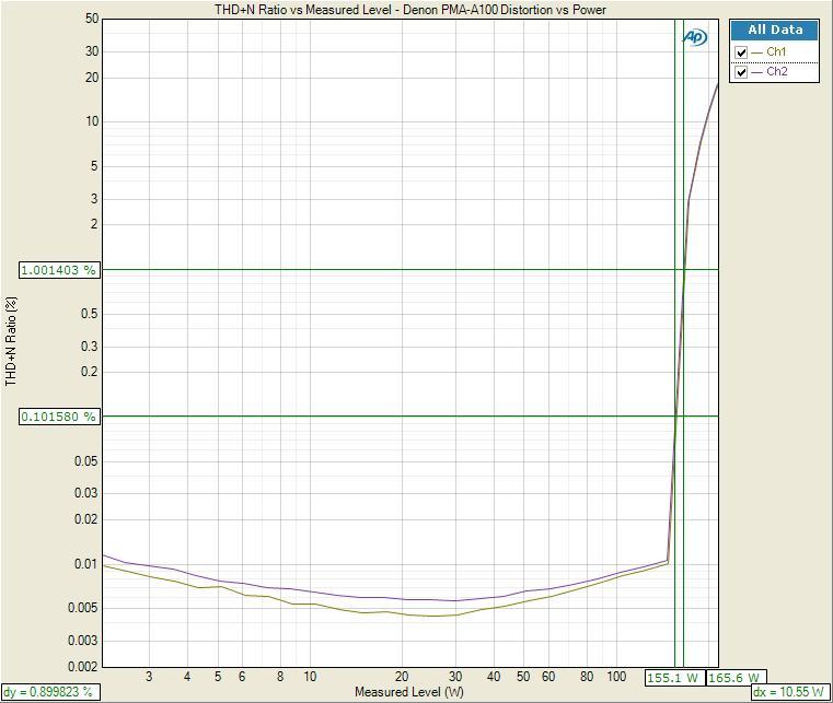

Power Measurements
Using our Audio Precision APx585 8-channel HDMI analyzer, we conducted a full barrage of multi-channel amplifier tests on Denon PMA-A100. We tested power using three methods all of which were taken at < 0.1% THD + N:
  • Continuous Full Power Bandwidth (CFP-BW) from 20Hz to 20Khz into 8 and 4-ohm loads (up to two-channels)
  • 1kHz Power Sweep vs Distortion (1kHz PSweep) - popularized by the print magazines, this is an instantaneous power vs distortion test at 1kHz. The problem with this test is it often masks slew related and or frequency response problems some amplifiers exhibit at the frequency extremes, and thus inflates the measured power results. It does provide an instant gratification # for consumers to argue over on the forums so we are now incorporating this test to please the masses.

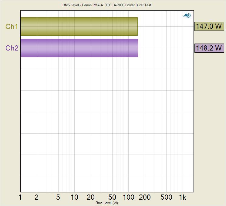

  • Dynamic PWR - 1kHz CEA-2006 Burst Method testing. This is a dynamic power measurement adopted from the car industry similar to IHF method only a bit more difficult for an amplifier and more representative of real musical content.
Keep in mind most review publications don't do continuous power measurements and they usually publish power measurements into clipping at 1% THD + N. Our measurements are very conservative as we use a dedicated 20A line with no Variac to regulate line voltage.  We constantly monitor the line to ensure it never drops more than 2Vrms from nominal which in our case was 120Vrms.
For more info on amplifier measurements, see The All Channels Driven (ACD) Test
power sweep 4 power sweep 4 ohms
Denon PMA-A100 Power Sweep Test (1kHz)
Left Pic: 2CH driven, 8 ohms;  Right Pic: 2CH driven, 4 ohms

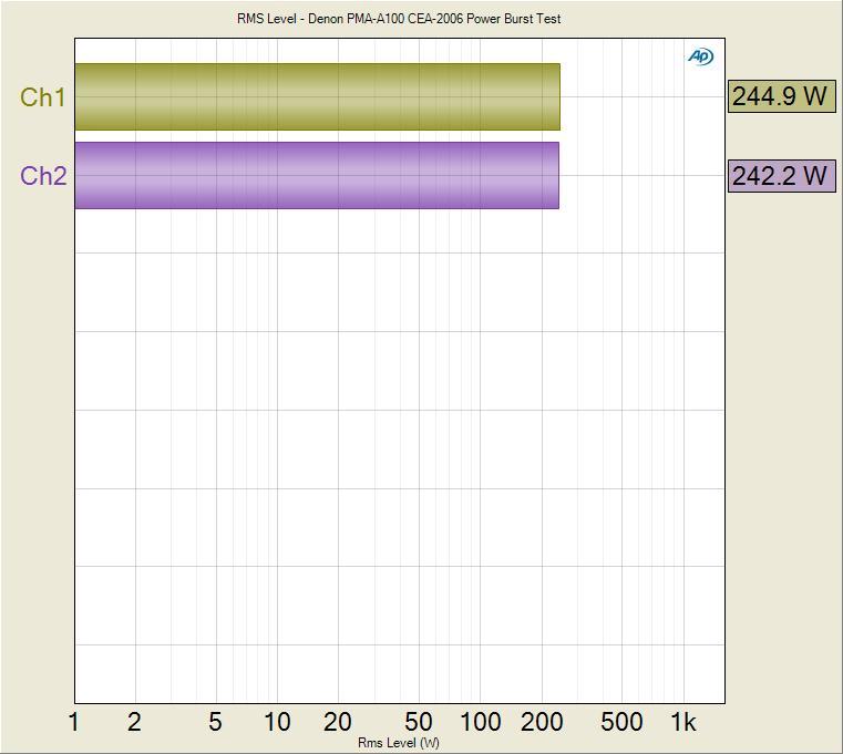

dynamic power 8 dynamic power 4
Denon PMA-A100 Dynamic Power Test (1kHz)
# of CH Test Type Power Load THD + N
1 CFP-BW 123 watts 8-ohms 0.1%
1 CFP-BW 195 watts 4-ohms 0.1%
2 1kHz Psweep 108 watts 8-ohms 0.1%
2 1kHz Psweep 115 watts 8-ohms 1%
2 1kHz Psweep 155 watts 4-ohms 0.1%
2 1kHz Psweep 165 watts 4-ohms 1%
2 Dynamic PWR 148 watts 8-ohms 1%
2 Dynamic PWR 245 watts 4-ohms 1%
Denon PMA-A100 Power Measurement Table
Denon rates the PMA-A100 as follows:
  • 80 watts RMS @ 8-ohm from 20Hz to 20kHz  (0.07% THD)
  • 160 watts dynamic @ 4-ohm @ 1kHz (0.7% THD)
Denon's amplifier ratings are a bit peculiar.  They could have very easily rated this a 120wpc amplifier and nobody would have argued it.  I assumed they derated the power as a marketing strategy so that reviewers like myself would praise them from being ultra conservative.  Let me just pause for a moment and throw some love and praise at Denon.....OK now that that's over, you would think Denon would have at least specified 4 ohm power as continuous and NOT dynamic since this amp can clearly deliver 165 watts continuously with both channels driven into 4 ohms.  At any rate, the PMA-A100 has a sturdy power supply and ample output current.  In fact, I'd say looking at the measurements, its clear Denon employed some current limiting when driving this amp into 4 ohms as it didn’t quite double down in power but still provided way above specified power.  The PMA-A100 should be right at home driving virtually any moderately efficient speaker to reference levels.

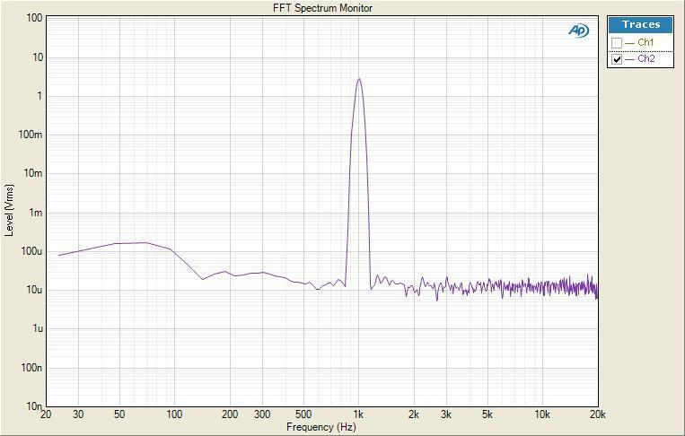

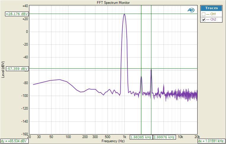

FFT Distortion Analysis
FFT 1 watt FFT full power
Denon PMA-A100 FFT Distortion Analysis
(left image @ 1 watt ; right image @ full rated power)
I ran FFT distortion plots at 1 watt (left pic) and full rated power (right pic) to determine how clean this amplifier really is.  At 1 watt, the spectral distortion was good that the harmonics were below measurable limits of my test gear!  At full rated power (80 watts) the 3rd order harmonic distortion product was higher than the 2nd which is usually undesirable but the levels are still exceedingly low (28.176 + 57.359)dBV being 85.5dB down from the fundamental or 100*alog^-1(-85.5/20) = .0053%

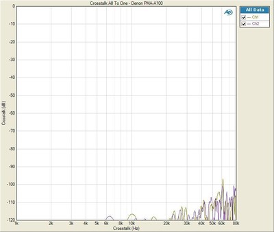

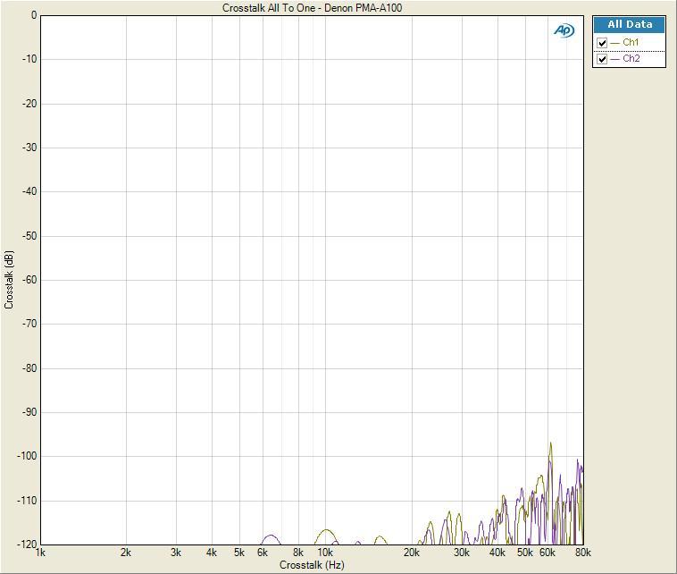

Crosstalk
Crosstalk
PMA-A100 All-to-One Crosstalk at Full Rated Power
I measured each idle channel one at a time while the other acted as the disturber to determine the worst case channel to channel crosstalk.  The PMA-A100 produced some of the lowest channel to channel crosstalk measurements I've ever taken on an amplifier!  This is no surprise given the immense real estate this amplifier has for only two channels.  Whether I measured at 1 watt or full rated power, channel to channel crosstalk was better than 100dB for the entire audio bandwidth.  Note how at even 80kHz this amplifier produced superb results.
