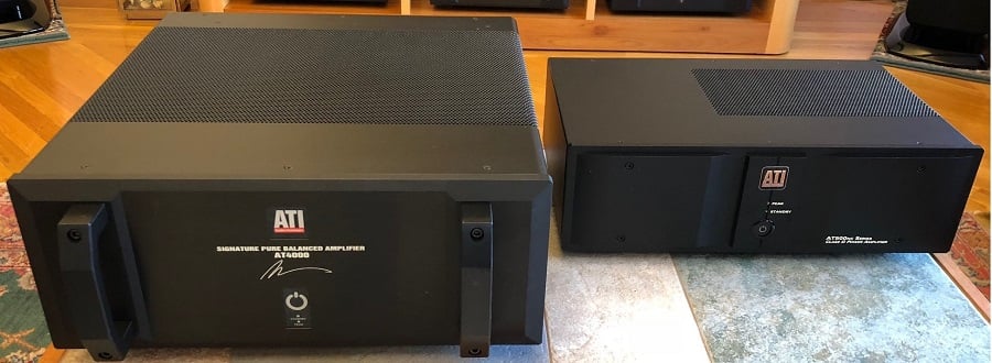

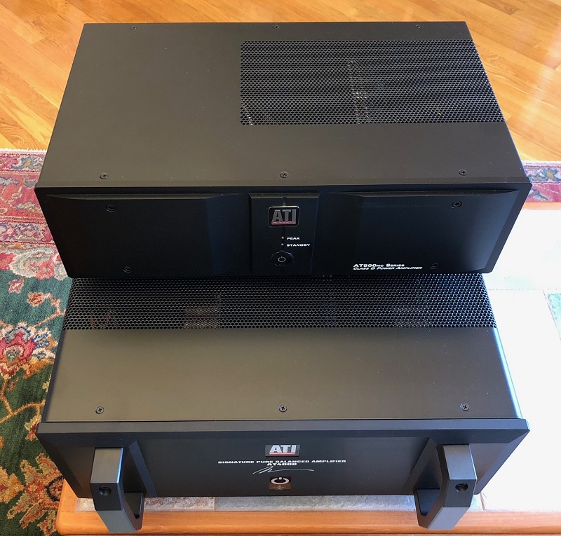

AT522NCandAT4002Front
The AT4002 (bottom and AT522NC (top).
The AT4000 is the slightly lower powered (200 versus 300 WPC) version in their top-of-the-line Signature Series amplifiers. In reality, the difference is about 1 dB. Like the AT6000, it is a fully-balanced class A/B design using two toroidal transformers and independent secondary windings to provide separate power supplies for each channel. The AT4000 amps can be configured from 2 to 7 channels. The 2-channel model is a dual-mono configuration.

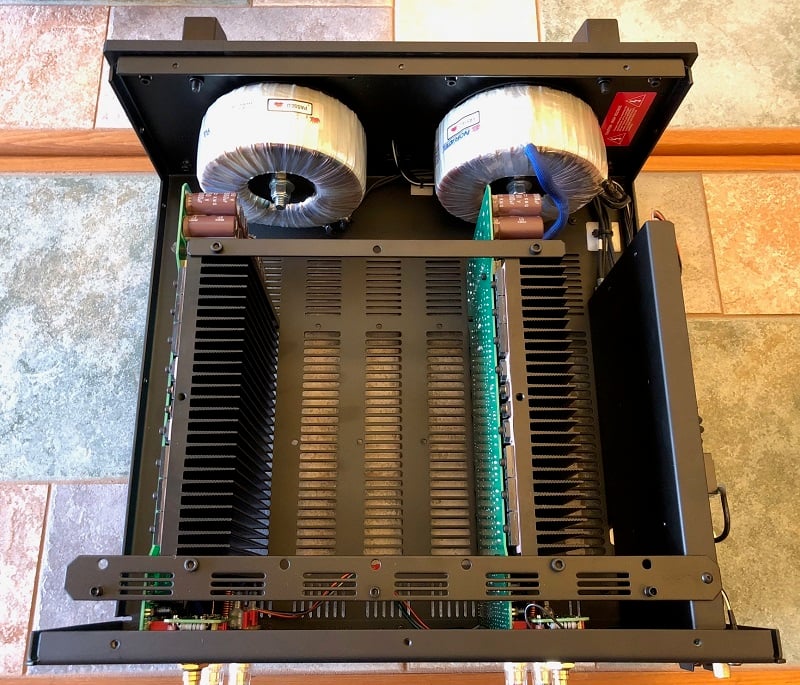

The AT4000 looks like a stouter version of the AT6000 sporting the same flat aluminum faceplate, handles, and 5-way binding posts but with a single power cord and power breaker. All the markings are present including the “Signature Pure Balanced Amplifier” and signed “M” for ATI’s designer and founder, Morris Kessler. The AT4000 is a fully-balanced Class-A/B amplifier with linear power supply. The Signature series represents ATI’s top-of-the-line performance that includes extremely low distortion and very low (>128dB) noise floor. The front power button/ light is an elegant touch-capacitive button. The ATI logo backlit can be touch-toggled on and off.
AT4002TopOpen
AT4002 Class A/B Dual Mono Amplifier

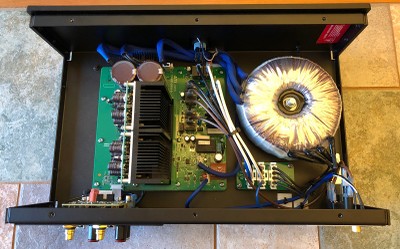

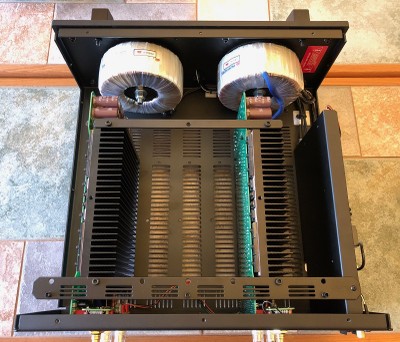

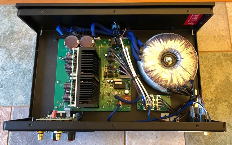

The AT500NC is an entirely different Hypex N-Core amplifier that uses ATI’s chiseled faceplate, 5-way binding posts (though not as nice as the AT4000), power cord, and fuse. The cosmetics match the announced ATI ATP-16 Home theater processor.
ATI has been using breakers for years, so the presence of a fuse was unexpected. Consulting the manual, it is understandable since different module counts require different fuses. There is a chrome-faced ATI logo and dual power button and light. When in stand-by, the power button light very-slowly pulses from off to dim. It’s nice that we live in a time where such things can be done, but whether they should be done is worth considering.
AT522NCOpenTop
AT522NC Hypex N-Core 2 Channel Amplifier
Both amps include balanced and single-ended connections controlled by a toggle that can be simultaneously connected, a useful feature for connecting a separate 2-channel system. Outputs are numbered, and I recommend using the outer channels for the mains (for optimal heat distribution). An optional ground thumb screw is provided as well as a single trigger input. STANDBY and PEAK indicators are located on the front panel. All amplifiers should include peak/clip indicators.

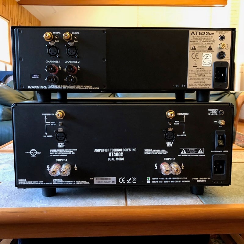

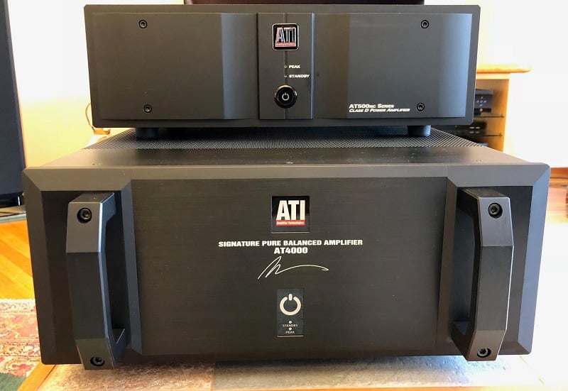

Both amps are standard-sized, about 17” wide, but that is where the similarities end. The AT522NC is 2 inches shorter and only 11 inches deep, which is approximately six inches less than the AT4002.  Weighing in at 39 lbs., the AT522NC is not one of those one-hand-carry class-D amplifiers. It has a linear, transformer-based power supply. Still, it is considerably lighter than the 51 pound AT4002. That AT500NC weight advantage increases with the channel count.
AT4002AT522StackedBack
AT522NC Class D (top) and AT4002 (bottom) Class AB rear panels

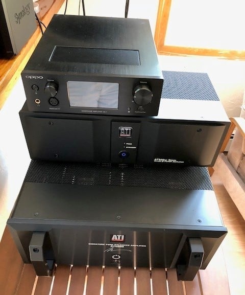

Stacking the gear provided the opportunity to perform some single-blind testing (SBT). Double-blind testing is the gold standard but SBT can be done “at home”. A friend and I took turns and, while not perfect, we both were able to pick the amps consistently. Preference is another matter, that varied with source material. With the M20’s, we were both taken with the AT522NC, giving it the nod.
Game Room System
I began testing with my game room system where the amps were conveniently stacked for quick-switching. FLAC files were played via Roon playing to the Oppo UDP-205 connected via balanced inputs to the Oppo HA-1. The HA-1 provides fully balanced preamplification. The speakers are a pair of Revel M20 bookshelf speakers. The M20’s dip to 4 ohms between 2 and 2kHz so it is best driven by an amplifier that can handle these loads.

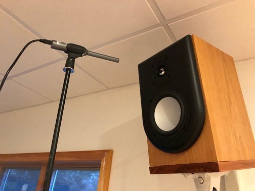

game room pic    M20Mic

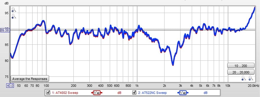

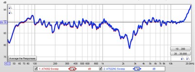

Although the AT4002 voltage gain is specified at 28 dB and the AT522NC at 27.5 dB, volt-meter measurements showed the AT522NC had approximately 1.5 dB more gain when driven by the HA-1. This gain difference was confirmed using near-field measurements and a calibrated UMIK-1 microphone. The level-matched near field measurement of the right M20 is shown below. The dips are due to room interaction but both amps track one another with near perfection.
AT4002 and AT522NC Sweeps with legendjpg
AT4002 (red) and AT522NC (blue) level matched REW Sweeps.
Quiet – No problem
These amps are both very quiet at the speaker. Technically, the AT4002 has 5 dB signal-to-noise advantage but both were virtually silent with my ear pressed to the tweeter. Transformer hum on both was undetectable at 2 feet.
