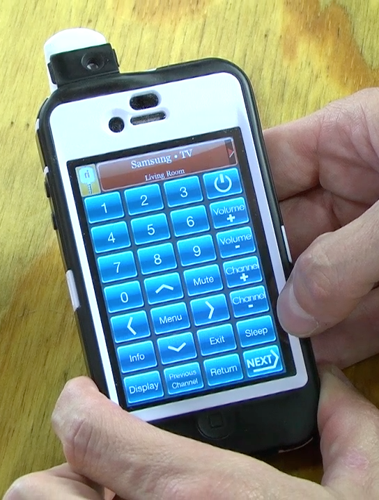

IR-Direct Remote Controls
So the most basic iPhone-based IR
remote would be something like the Ri remote with its free iOS app.
The Ri software functions like a remote aggregator, giving you a
virtual remote for each piece of gear. The problem is, each remote
has to load and it can take three remote controls to do some very
basic tasks, like turn on the TV, and turn up the volume on your A/V
receiver while watching DISH Network via a set top box or DVR. The Ri
remote also works using your headphone jack, but while that gives it
an almost nonexistent drain on your iDevice's battery, it also
requires you turn the volume up all the way and makes it
near-impossible to take calls while using the remote app. This $30
remote probably isn't worth your time as it doesn't simplify the
process, and in our opinion creates just as many, if not more,
headaches than using 5 different remotes.

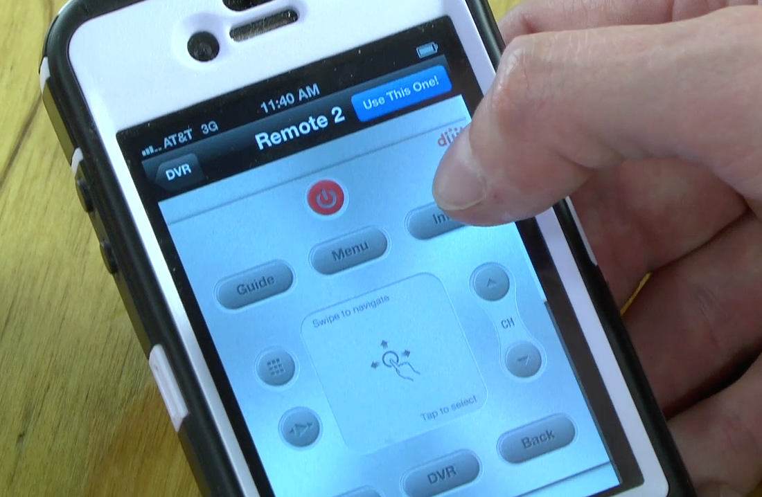

The next step up for direct IR-based remotes would be the $70 VooMote Zapper, which connects into your iPhone or iPod's docking port and uses wizards to program remotes into your iOS device. It's a tad more refined, but ultimately it still just combines a bunch of digital remotes into one accessible pile. There are no macros, no program guide and the app seemed to have difficulty getting all the controls right (though you can learn your remotes into it). It's more flexible and consistent, but still very limited in scope.

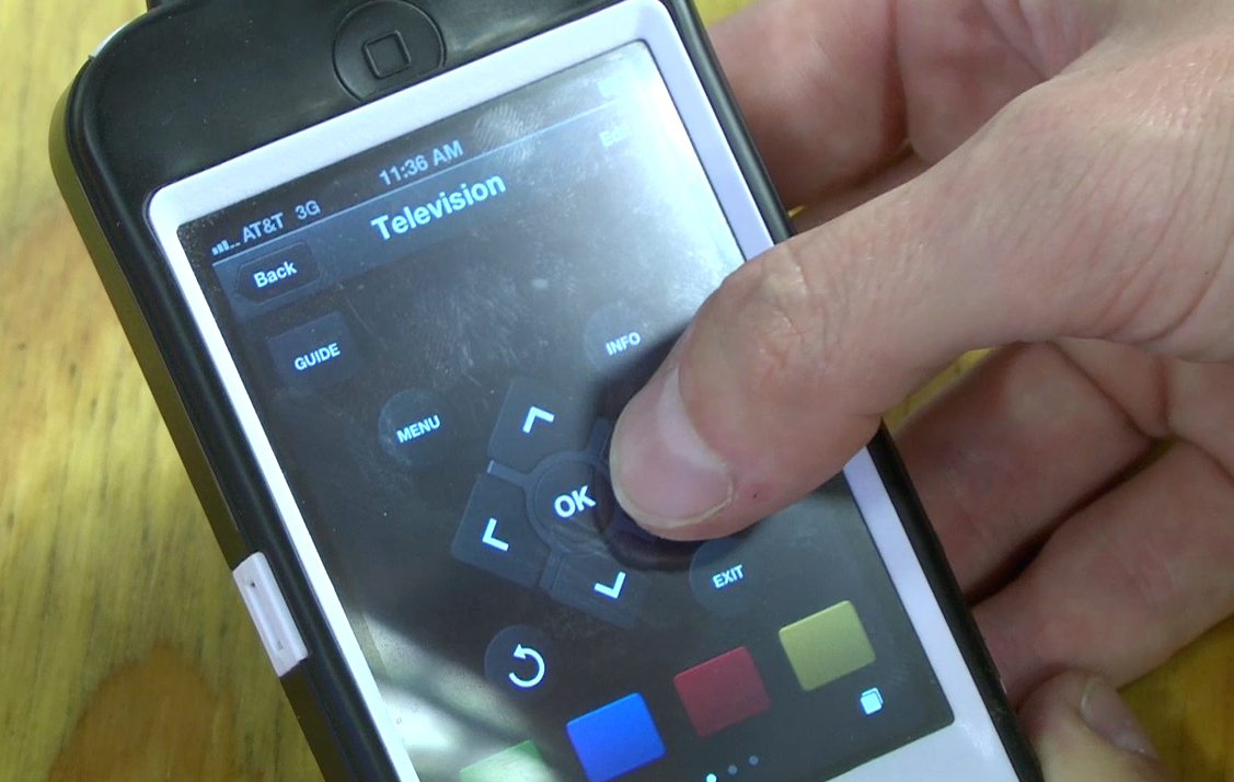

Bluetooth-based Remote Controls
This brings us to the worst category of
remotes. The category of remotes that we should force captured
terrorists to use as punishment for their crimes. That's the
Bluetooth-connected remote. Remotes in this category, like the $70
Griffin Beacon and the $80 Gear4 UnityRemote use the temperamental Bluetooth to connect
your iPhone or iPod Touch to the base station which then issues IR
commands to your gear. While the software for these devices tends to
get more sophisticated, the hardware sucks down batteries like an RV
drinks gas. On top of that, products like the Beacon require you to
tap them on the top to wake them up after 60 minutes as they try to
sleep to conserve battery power. The problem is that under real-world
use they still need to have their batteries changed every 3-4 weeks
and we've even seen them go dead while sitting dormant. Bluetooth is
also a limiting factor in that you can only connect one device at a
time and the connection is more than a little flakey.

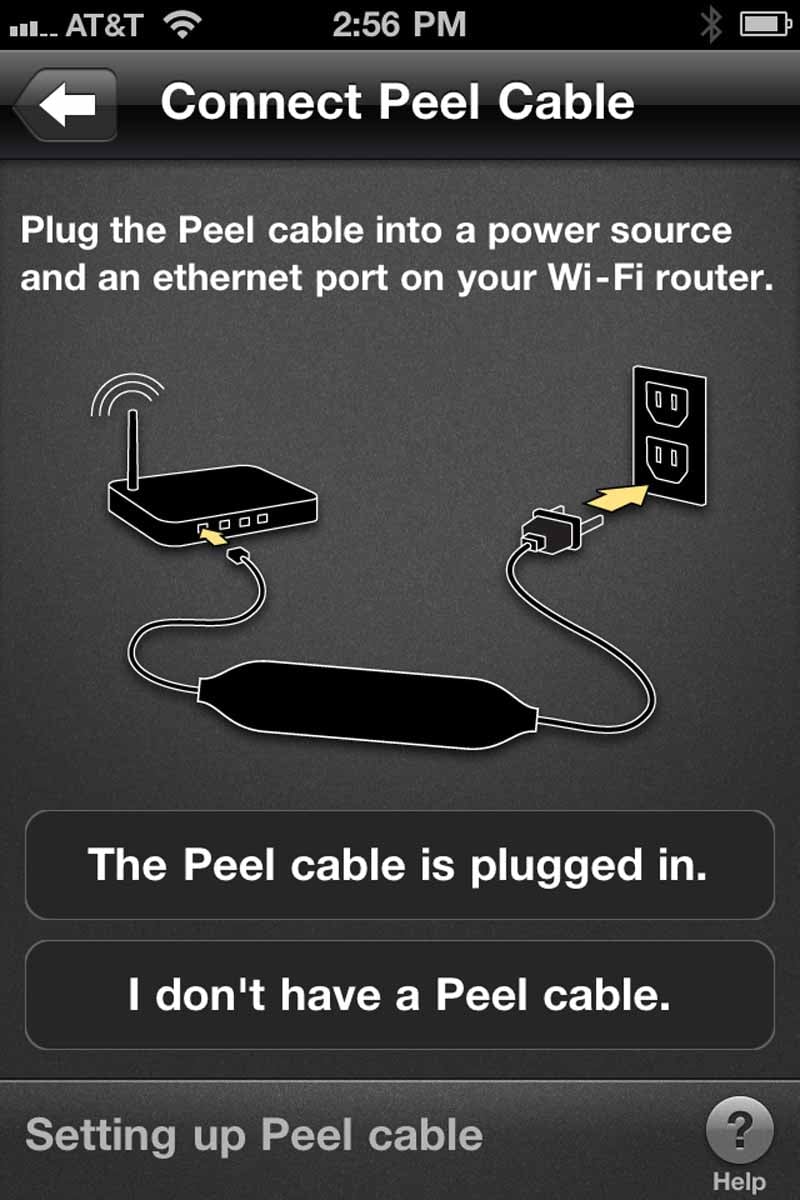

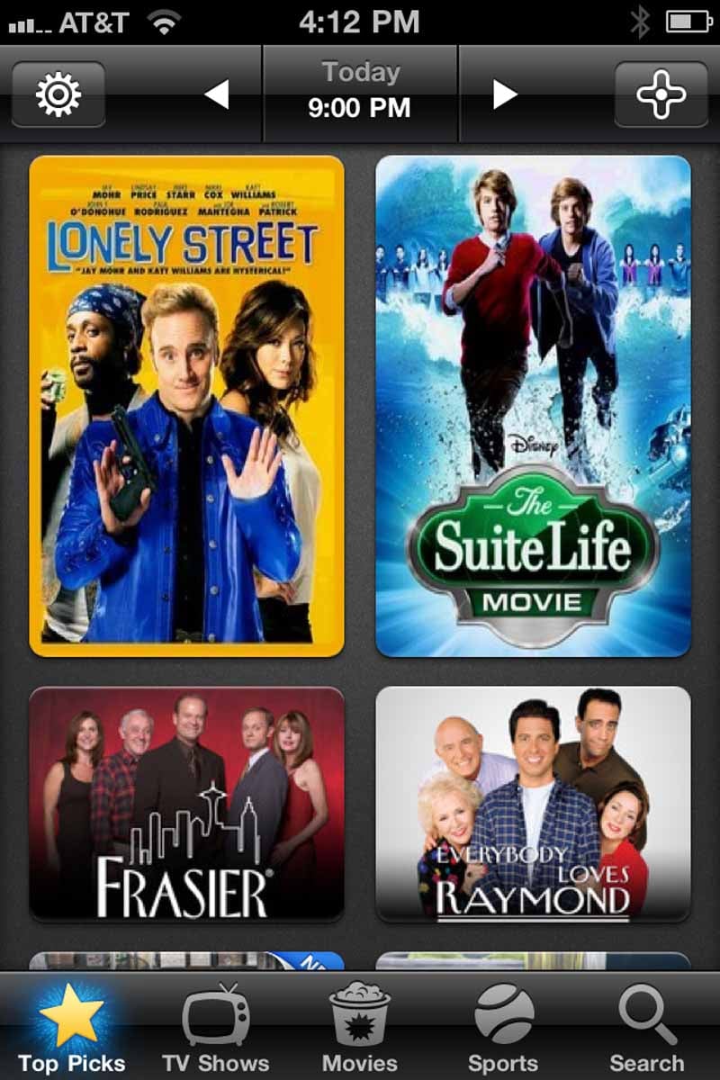

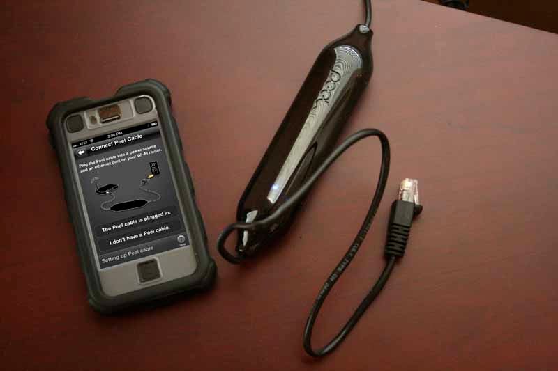

Bluetooth. One such device, the $99 Peel Universal Remote Control (which we did a written review of) does two
things well. First, it incorporates this WiFi connectivity
flawlessly, and it also uses an IR base station that seems to hold
its charge for a good amount of time. It also is program-centric, so
the very visual program guide drives all your viewing decisions, be
they movies or TV. Of course, if you want to watch a Blu-ray you can
always call up the direct remote functions and switch to that
activity - automatically and without having to use 3 -4 different
screens or virtual remotes.
