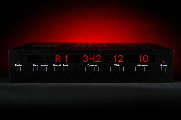

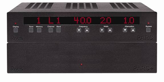

Rives Audio introduces the PARC + at CEDIA. The PARC + gives the award winning PARC 6 channels of equalization for home theater or multi channel music.
[parc] [pacr2]
Pictured above is the PARC (Two Channel) and the PARC Plus (Six Channel)
Parametric Room Correction.
The PARC / PARC + system have the following features:
1. 3 bands of parametric equalization
2. Operates in the bass region only, below 350 Hz, leaving the midrange and treble transparent
3. Q factors (width of peak) from 1 to 11
4. up to 18 db of attenuation
5. Fully programmable with 3 memory settings
6. Analog circuitry, no A/D or D/A conversion
7. Can be set up and calibrated by a Rives trained dealer in a matter of minutes
8. Balanced and single ended inputs and outputs
