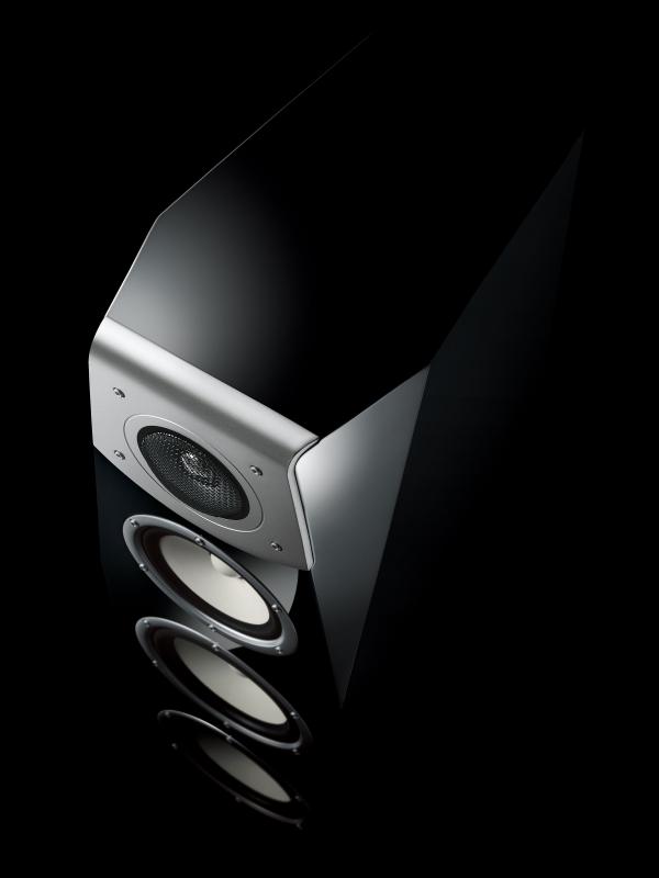

Tall, Dark, And Handsome
At first glance, the NS-F901 certainly looks the part of a high end speaker. With a well braced enclosure featuring non-parallel surfaces and 3-way mitered construction, issues related to cabinet resonance and standing waves should be minimal. The front baffle of the NS-F901 also sports a cast aluminum mounting plate for the tweeter, giving a little visual distinction as well as providing a solid, non-resonant attachment for the tweeter. Speaking of visuals, the NS-F901 does come in an attractive piano black finish, which in Yamaha’s case means the same finishing process that they use on actual grand pianos.
Top view of the Yamaha NS-F901.
