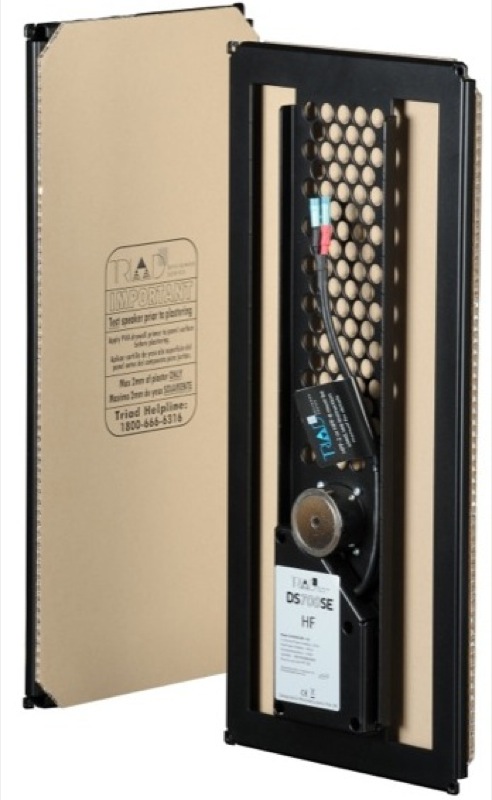

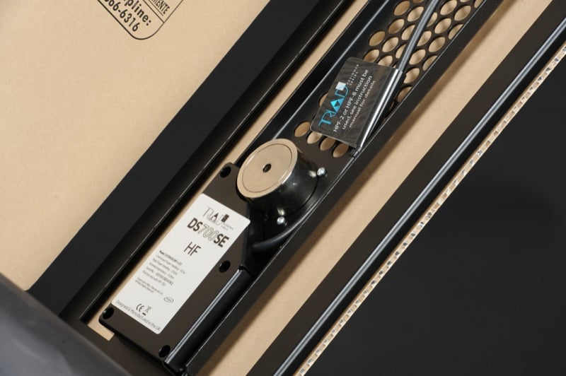

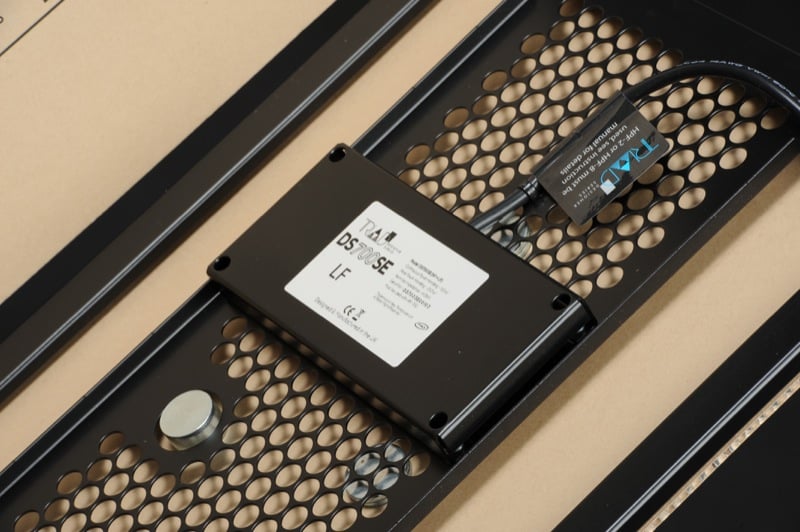

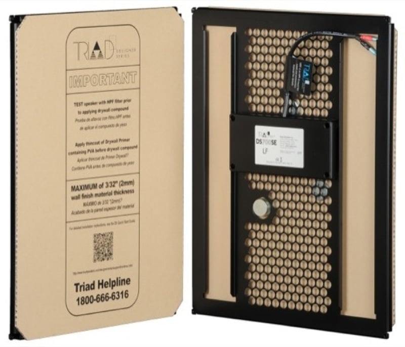

Edit: I emailed Triad and they set me some actual pictures of the Triad DS700se speakers. When I initially wrote this, I couldn't find any so I made due.
700se_HF_crop     700se_hf_close
Triad DS700se High Frequency Unit
700se_LF     700se_lf_close
Triad DS700se Low Frequency Unit
