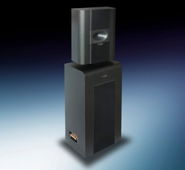

When we say monsters, we aren't kidding. At six feet tall, the P860s have a single 1.5" professional quality high-frequency compression driver mounted on a proprietary Procella constant directivity waveguide (80°H x 50°V above 1.5 kHz). The midrange is reproduced by dual high-performance 8" drivers aligned in a vertical Midrange-Tweeter-Midrange (D'Appolito) configuration. That's the top box in the picture above. Below, the lower box contains six 10" woofers in a push-pull configuration for the bass. The woofer box is sealed (as you'd expect in a push-pull configuration) allowing placement close to boundaries (an important feature as you'll soon see).
