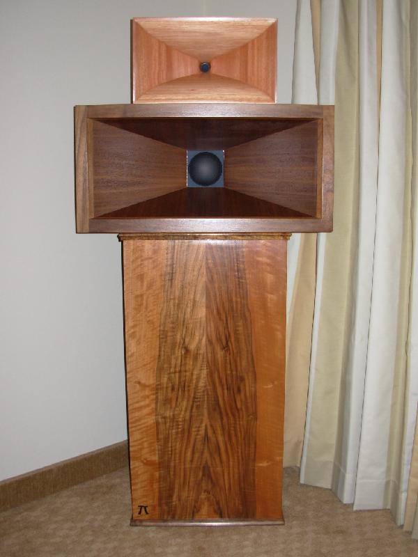

They currently boast a catalog consisting of various high sensitivity designs ranging from the one Pi, a modest sized bookshelf (relatively speaking) sporting a conventional soft dome tweeter and an Eminence Alpha 8 woofer, to the massive seven Pi, which features a 15” woofer, 10” horn loaded midrange, and a waveguide tweeter. Intermediate models include the two Pi (available as a large stand-mount or tower), three and four Pi (large stand-mounts), six Pi (corner horn), and eight Pi (a bass-reflex/horn hybrid). Rounding out the lineup are the three Pi, a single driver ported subwoofer, and the twelve Pi, a horn loaded subwoofer with dual 12” woofers in a push-pull configuration.

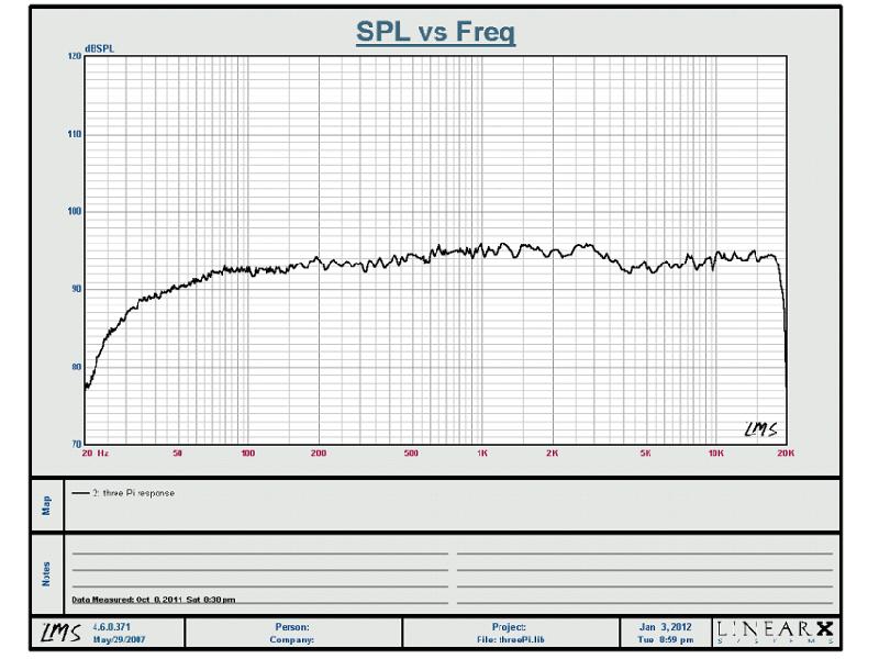

One thing you’ll notice when browsing through Pi Speakers' website is that they happily boast measurements for some, but not all, of their products. For the one Pi and two Pi speakers, ground plane frequency response measurements are available along with an impedance plot. The three Pi and four Pi speakers, which are designed with uniform directivity in mind, also include horizontal as well as vertical off axis measurements. These measurements are not available for the six, seven, or eight Pi speakers, but in the case of the six and seven Pi, which are corner horn speakers, a ground plane measurement wouldn’t be indicative of expected performance.
Ground plane frequency response of the three Pi speaker
A keen observer may also note the relatively high sensitivity boasted by every speaker in the Pi lineup, made all the more impressive since they are rated ground plane (except for the corner horns, which are measured in a trihedral corner), and are not in room estimates like some manufacturers use. This sensitivity also appears to be achieved without any obscene dips in impedance. For example, the three Pi speaker boasts a sensitivity of 95dB at 2.83V at 1 meter, while holding impedance at or above 8 ohms. One might reasonably expect the three Pi to be driven to high volumes with even an entry level receiver.
