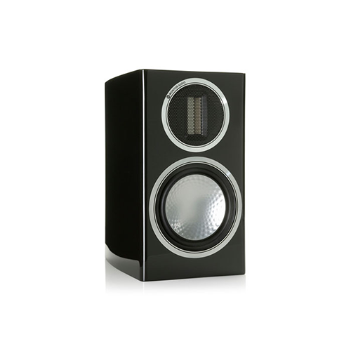

Gold 50
- System Format: 2-way
- Frequency Response: 55 Hz – 60 kHz
- Sensitivity (1W@1M): 86dB
- Nominal Impedance (ohms): 8
- Maximum S.P.L. (dBA): 109.8
- Power Handling – R.M.S. (W): 100
- Recommended Amplifier Requirements (W): 50-100
- Bass Alignment: Bass Reflex – HiVe II port system
- Crossover Frequency: 2.3kHz
- Drive Unit Complement: 1 x 5.5” mid driver 1 x C-CAM ribbon H.F transducer
- Cabinet Dimensions (HxWxD): 300x170x263mm (11 13/16 x 6 11/16 x 10 3/8 inches)
- Weight (each): 7.5kg (16lb 8oz)

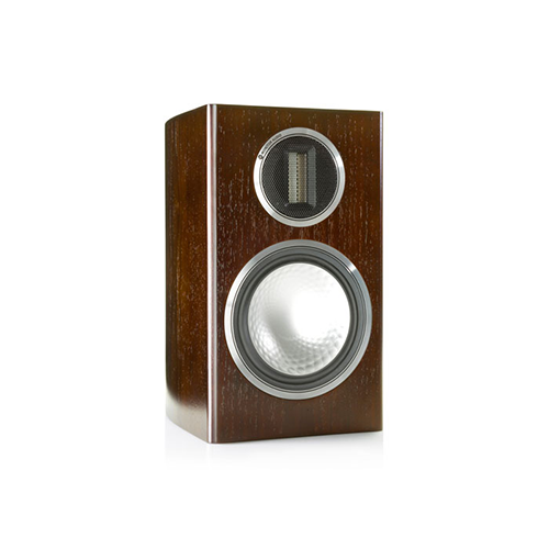

Gold 100
- Frequency Response: 42 Hz – 60 kHz
- Sensitivity (1W@1M): 88dB
- Maximum S.P.L. (dBA): 112.6
- Power Handling – R.M.S. (W): 120
- Recommended Amplifier Requirements (W): 60-100
- Crossover Frequency: 2.7kHz
- Drive Unit Complement: 1 x 6.5” mid driver 1 x C-CAM ribbon H.F transducer
- Cabinet Dimensions (HxWxD): 362 x 210 x 303mm (14 3/8 x 8 1/4 x 11 15/16 inches)
- Weight (each): 9.9kg (21lb 12oz)

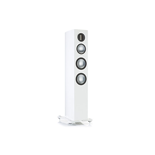

Gold 200
- System Format: 3-way
- Frequency Response: 35 Hz – 60 kHz
- Sensitivity (1W@1M): 89dB
- Maximum S.P.L. (dBA): 114.5
- Power Handling – R.M.S. (W): 150
- Recommended Amplifier Requirements (W): 100-150
- Crossover Frequency: L.F - M.F: 400Hz M.F - H.F: 2.6kHz
- Drive Unit Complement: 2 x 5.5” RST bass driver 1 x 4” RST mid-range driver 1 x C-CAM ribbon H.F transducer
- Cabinet Dimensions (HxWxD): 951 x 170 x 300mm (37 7/16 x 6 11/16 x 11 13/16 inches
- Weight (each): 22.2kg (48lb 14oz)

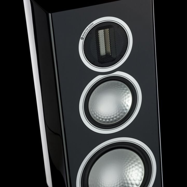

Gold 300
- Frequency Response: 30 Hz – 60 kHz
- Sensitivity (1W@1M): 90dB
- Maximum S.P.L. (dBA): 116.8
- Power Handling – R.M.S. (W): 200
- Recommended Amplifier Requirements (W): 100-200
- Crossover Frequency: L.F - M.F: 790Hz M.F - H.F: 2.3kHz
- Drive Unit Complement: 2 x 6.5” RST bass driver 1 x 4” RST mid-range driver 1 x C-CAM ribbon H.F transducer
- Cabinet Dimensions (HxWxD): 1060 x 210 x 330mm (41 3/4 x 8 1/4 x 13 inches)
- Weight (each): 27.2kg (59lb 14oz)

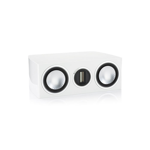

Gold C150
- System Format: 2 way
- Frequency Response: 55Hz – 60kHz
- Maximum S.P.L. (dBA): 111.5
- Power Handling – RMS (W): 150
- Bass Alignment: Sealed Cabinet
- Crossover Frequency: 2.8kHz
- Drive Unit Complement: 2 x 5.5” RST bass / mid driver 1 x C-CAM ribbon H.F transducer
- Cabinet Dimensions (HxWxD): 172 x 461 x 303mm (6 11/16 x 18 1/8 x 11 15/16 inches)
- Weight (each): 6kg (13lb 4oz)

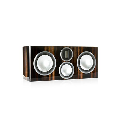

Gold C350
- System Format: 3 way
- Frequency Response: 40Hz – 60kHz
- Maximum S.P.L. (dBA): 113.8
- Power Handling – RMS (W): 200
- Recommended Amplifier Requirements (W): 100 - 200
- Crossover Frequency: L.F - M.F: 800Hz M.F - H.F: 2.3kHz
- Cabinet Dimensions (HxWxD): 254 x 581 x 333mm (10 x 22 7/8 x 13 1/8 inches)

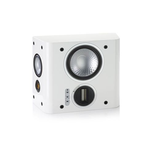

Gold FX
- Frequency Response: 60Hz – 60kHz
- Sensitivity (1W@1M): 87
- Maximum S.P.L. (dBA): 110.8
- Power Handling – RMS (W): 100
- Crossover Frequency: Bi-Pole: 2.3kHz Di-pole: 2.6kHz
- Drive Unit Complement: 1 x 6.5” RST bass driver 2 x 4” C-CAM mid-range driver 1 x C-CAM ribbon H.F transducer 2 x 1” Gold C-CAM dome H.F tweeter
- Cabinet Dimensions (HxWxD): 310 x 390 x 160mm (12 13/16 x 15 3/8 x 6 5/16 inches)
- Weight (each): 11.9kg (26lb 2oz)

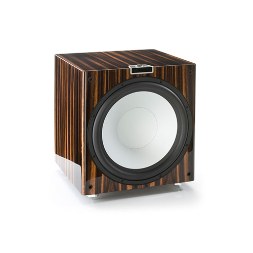

Gold 115 Subwoofer
- System Format: Sealed Cabinet. 25mm M.D.F construction with internal bracing. Sealed amplifier compartment
- Low Frequency Limit: 18 Hz
- Upper Frequency Limit: 40 – 120 Hz Variable
- Low Pass Filter Alignment: Active 4th order 24dB/octave (6/12/18/24 dB user adjustable)
- Amplifier Power Output: 650 watts continuous. 1200 watts Peak
- Equalisation: 4 settings (off / music / movie / impact)
- Phase Control: 0 – 90 – 180 - 270 degrees
- Digital Volume Level: -60 to +10dB in 1dB increments
- Drive Unit Complement: 1 x 15” C-CAM subwoofer driver
- Input Impedence: 20 K Ohms
- Dimensions: 430x400x400 mm (16 15/16 x 15 ¾ x 15 ¾ inches)
- Weight: 35.3kg (77lb 10oz)

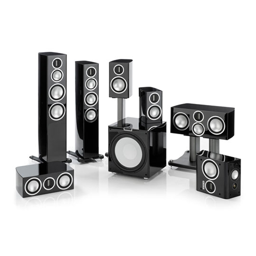

As a Monitor Audio Enthusiast, when we heard that they were coming out with a revamp to their “Gold” series speakers we were ecstatic. Using its GX Gold speakers as a model, Monitor Audio refined its high-end speaker line with this new series. Equipped with optimized drivers and empowered by the production quality of their Platinum flagship range, their Gold series speakers turn another page in the story of Monitor Audio's audiophile speaker family.
Eight new dedicated stereo, center channel, surround and subwoofer models have been released. Changes of this line include enhancements of the C-CAM Rigid Surface Technology bass cone, tighter production tolerances for their advanced C-CAM ribbon tweeters which provides extension to 60kHz, updated C-CAM RST drivers, new magnetically fixed "floating” cloth grilles which provide a smarter more functional grille design, and curved cabinet profile for increased rigidity. These upgrades to the new Gold range are designed to offer a greater transparency leaving you simply to choose the system that's right for your room.

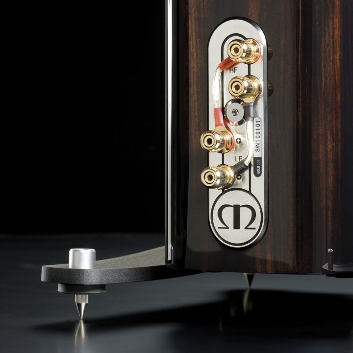

Crossovers
Comprising high quality polypropylene film capacitors, air core and laminated steel core inductors, individual driver crossovers are mounted on a dedicated panel accessible from the underside of each speaker. The adjacent speaker terminals are gold plated to maintain signal integrity and contact reliability. All Gold speakers are wired internally with Pureflow Silver cable.

The Gold Series Lineup
Gold 50
The sculpted low-diffraction cabinet of the Gold 50 houses a single 5.5” RST bass driver and C-CAM ribbon. The bass driver is designed to exhibit the low frequency extension and power handling of a much larger transducer. The new C-CAM ribbon is claimed to achieve sounds to 60 kHz. Optional, dedicated floor stands are available, which can be filled to provide the ultimate foundation for the best possible sound quality.
We’re hoping this little unit will defy its modest dimensions – Tests will see.

Gold 100
The 100 is a larger two-way stand mount speaker featuring a 6.5” RST bass driver and C-CAM ribbon. Monitor Audio claims the performance of this smaller speaker will sound more like a typical 8” driver. They say their 6.5” design provides higher overall efficiency with dynamic headroom to deliver impressive bass extension and control, rendering complex material with tonal accuracy and perfect timing. As with the Gold 50, optional, dedicated floor stands are available.
Gold 200
The first of new Gold’s floor-standers is also the most compact. This three-way design speaker comprises an improved pair matched ribbon, twin 5.5” bass drivers and a 4” midrange driver, which is housed in a dedicated enclosure. We’ll see if Monitor Audio’s claim of high overall efficiency, wide bandwidth and vanishingly low distortion is true in a full review of these floor standing speakers.

Gold 300
Standing at over a meter tall the 300 is a three-way floor-standing loudspeaker comprising twin 6.5” bass drivers, a single 4” mid-range driver and a high frequency ribbon transducer. With such an impressive complement of drivers, we’re hoping the 300 has the power delivery and scale to fill large rooms with awesome dynamics as well as the finest musical detail. Monitor Audio claims an audio range from below 30Hz to over 60kHz.
Gold C150
The ultra-compact C150 center speaker is small enough to fit into most AV racks and is designed to match the smaller Gold speakers in a more compact home theater configuration. Because it shares tonal characteristics with all models, its capabilities are also compatible with any ‘Gold’ system design. The C150’s sealed cabinet is home to twin 5.5” drivers and the ribbon in a two way MTM horizontal orientation. Monitor Audio claims an audio range of this compact center speaker from 50Hz to 60kHz.

Gold C350
The C350 center speaker is designed as a no-compromise center channel solution for serious home theater installations. Its three-way, four driver configuration mirrors that of the 300, although the bass drivers are tuned to work in the C350’s sealed cabinet. Unsurprisingly the C350 is the perfect match for its floorstanding counterpart. Monitor Audio claims this center speaker is designed to produce frequencies from 40Hz to beyond 60 kHz. Engineered for a neutral tonal balance and distortion free sound, the C350 should project clear dialogue and mid-range detail. A dedicated floor stand is available to ensure the most secure footing and ideal vertical orientation.
Gold FX
The FX speaker is designed to provide direct or ambient surround sound, which may be switched manually or automatically via a 12V signal, to accommodate the functionality of high-end home or professional cinema applications. The FX’s slim wall-hugging profile incorporates than six drivers. In monopole mode for discrete side or rear sound channels its front-firing 6 ½” RST bass/mid-driver and C-CAM ribbon transducer are designed to deliver ultra-wideband sound to match the tonal balance of any ‘Gold’ speaker combination. In dipole mode the FX uses two pairs of side firing 4” C-CAM bass/mid drivers and 25mm C-CAM gold-dome tweeters. The FX can be flush mounted on side or rear walls. Installation is made easy by the inclusion of a ‘sloppy fit’ wall bracket, which allows leveling and adjustment prior to fixing.

Gold W15
In a rigid compact enclosure, Monitor Audio has installed an ultra-long throw 15” C-CAM bass driver, triple suspended for a full 38mm (1.5”) of linear excursion. Featuring a massive magnet structure and under the control of a 650W D2AUDIO DSP controlled amplifier this deep bass subwoofer will be a priority for our subwoofer reviewers. We’re eager to fully test the bass and reference results for SPL, dynamic control and headroom on this unit. Monitor Audio claims the W15 will deliver taut gut-churning bass all the way down to a seismic 18Hz while also having an intelligent design, featuring an advanced automatic room correction system called LEO (Listening Environment Optimizer). LEO simply and automatically eliminates the detrimental bass boost of boundaries and corners through the use of a microphone and test tones. The Gold W15’s sealed enclosure and front-firing driver make it easy to install, and calibration from the front-mounted controls and dimmable LED display is simple, even from a distant position. It’s equipped with a 12V trigger and remote control with four user EQ pre-sets.
