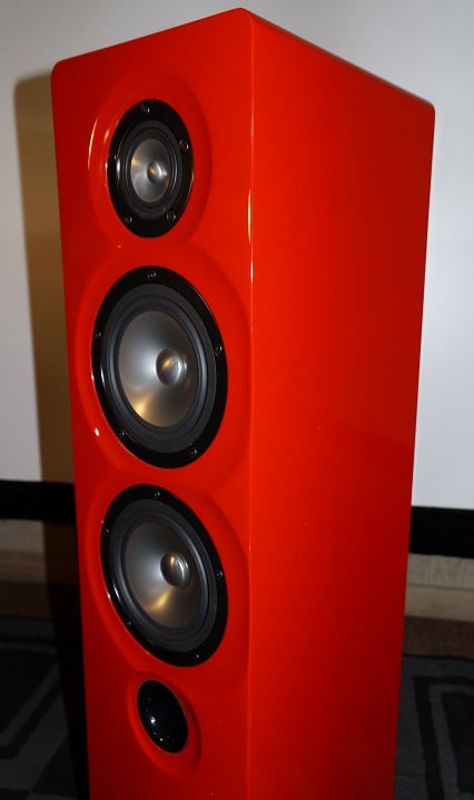

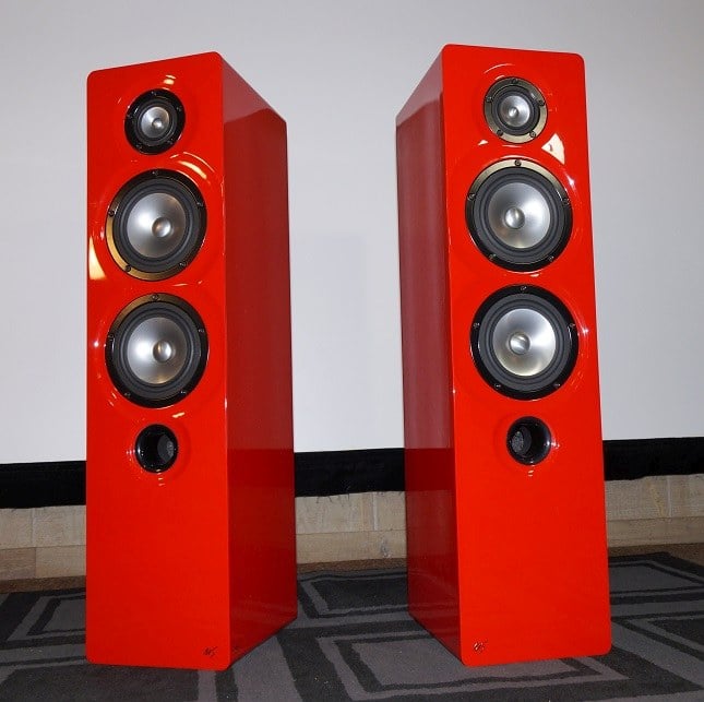

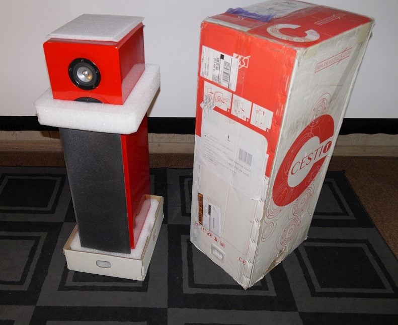

The Cesti T towers arrived in boxes with a clever locking mechanism that kept the packaging safely together and also made it easy to unpack. Within the boxes, the speakers were sandwiched between thick foam blocks on the top and bottom of the box, with a thick foam band protecting the middle. While the packing looked good to protect the speakers from bumps and shocks, the speakers did not come in any kind of plastic wrapping that would protect them from moisture, an odd omission at this price point. Nonetheless, the speakers arrived at my doorstep in excellent condition.
Out of the box, the Cesti T speakers looked snazzy. They have a sleek, modernistic design, and that vibrant red color with its exquisite polish certainly gives them flair. Yes, ‘snazzy’ is the word I would use for these; they are not so conservative that they become sedate, nor are they so unconventionally styled that they become ostentatious. The rounded corners and the grooves of the waveguides around the drivers give the Cesti T’s clean lines that are free from any sharp angles. The drivers present themselves as aluminum disc cones surrounded by the black rings of the surround and driver frame. The only logo on the speaker is the inconspicuous initials ‘ML’ in the bottom corner of the speaker. If you look carefully, you can see that the waveguides are not completely symmetrical with respect to the cabinet. They have a slight directional preference. With the grille on, the speakers do lose much of their personality, and, as we will discuss later, the grille does not improve their sound, so there is no harm in leaving the grille off if the user prefers. The use of magnetic grilles keeps the front baffle clean of grille guides. The Cesti T speakers also come in white and black colors for those who want a more reserved look and would rather not have the speakers stand out as much. To sum up the Cesti’s appearance, they look good, and, depending on their color, they should be able to fit in a wide range of decors.

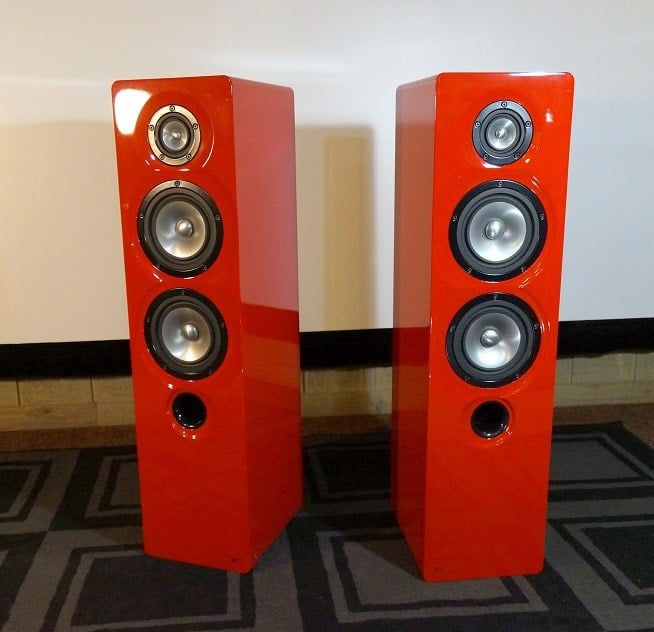

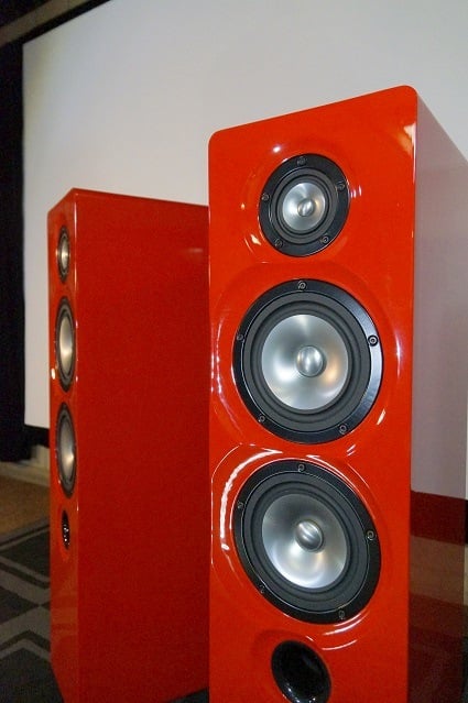

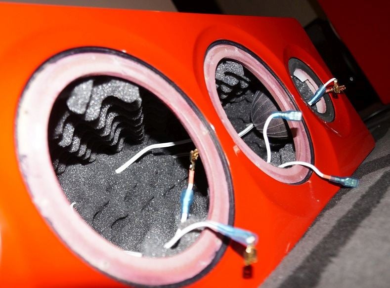

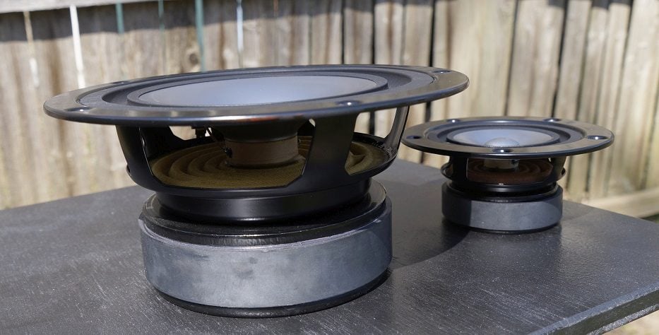

The drivers themselves use a shallow-profile mixed-alloy cone and a healthy-sized magnet. They have the distinctive “button” dustcap seen on all MarkAudio drivers. The cone itself is very light. The 2” driver looks very much like a shrunken version of the 4”. These drivers are also used as sole drivers in MarkAudio-SOTA speakers sold in Europe and are specified in those speakers as having a full-range response. The president of North American distribution tells me that he is thinking about bringing the single driver speakers to the American market. As with most full-range drivers, these are not able to take enormous amounts of power. The amplifier requirements in the specs sheet should be heeded here. These drivers are not as durable against large amount of current as conventional driver types seen in this price class.

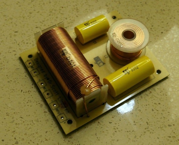

The crossover for the Cesti T speakers is a simple design. It uses second-order slopes for both the high-pass filter and low-pass filter. As such, there looks to be only a pair of inductors and a pair of capacitors on the board. The Inductors and capacitors are sizable and look to be up to the task. As stated above, the rationale for such a simple crossover is that the cones are so much alike that they will be able to blend easily, so there is no need for a complicated crossover with steep slopes.
As with the
crossover, the cabinet co
nstruction is also relatively simple, but there are a
few noteworthy details. The paneling looks to be just short of 1” thick,
perhaps ⅞”. There is no real bracing in the upper part of the cabinet, but
there is a solid board bracing the lower section, perhaps to reduce the
internal volume for the 4” drivers. The 2” driver is sealed in its own
compartment in some kind of plastic rounded cone. This rounded cone shell looks

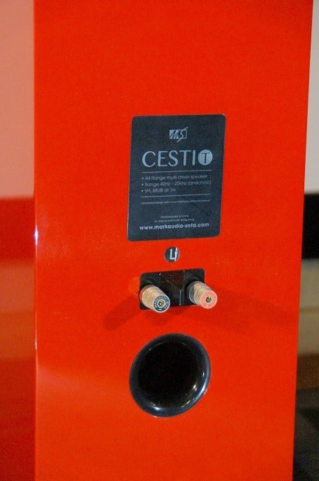

to be shaped to diffuse any standing waves. The Cesti T towers have a port on
both the front and back of the speaker, and port plugs are included with the
packaging for those who want to reduce the bass response. There are some
shallow waveguides carved around each cone on the exterior of the cabinet. One
interesting thing about these waveguides is that they are not symmetrical on
each speaker, but the waveguides do mirror each other as a speaker pair. One
half of the waveguide opens up on one side of the cabinet while the other keeps
contained in the front baffle. This is intended to allow broader dispersion of
sound on one side of the speaker, which can be used to either minimize
side-wall reflections or heighten them, depending on the user’s preference. The
binding posts have a little divider between them, which is a nice touch that
helps to prevent strands of cable from accidentally touching the other polarity
and causing a short. I wouldn’t mind seeing this on more binding posts in the
future.

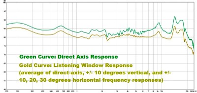

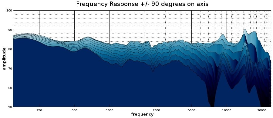

MarkAudio-SOTA Cesti T Tower Speaker Measurements and Analysis

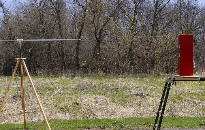

For our measurements, the Cesti T speakers were elevated at a height of approximately 4 feet with the mic height level with the 2” driver and 2 meters away in a large, open area. This gives us a window of 7 ms before ground reflections hit the mic, and that allows us usable data down to 150 Hz before resolution is completely lost.

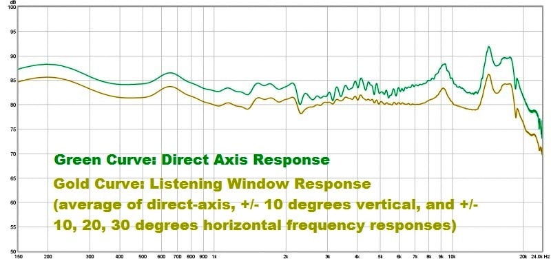

MarkAudio-SOTA Cesti T loudspeaker response (2 meters outdoors)

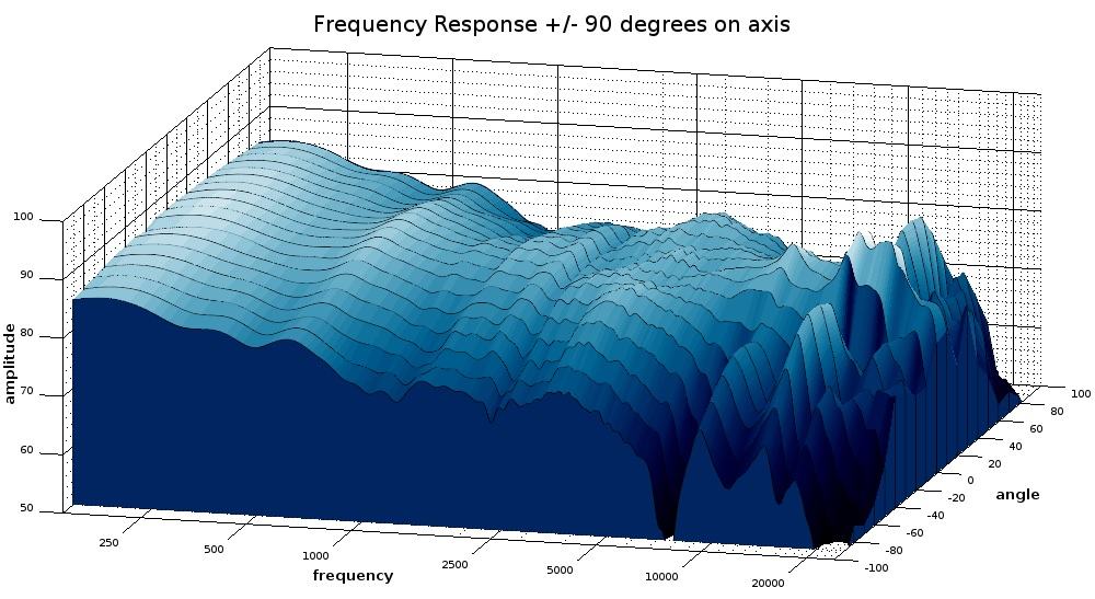

The above graph show the direct axis frequency response of the Cesti T tower speakers and also the Listening Window curve, which is an averaging of the direct axis response with the vertical responses 10 degrees above and below and horizontal responses at 10, 20, and 30 degrees outward. These responses are unsmoothed. From low frequencies to high, we see that the Cesti T speakers have somewhat elevated bass with respect to the mids. This elevation gently tapers off into the midrange frequencies where we see a nicely flat response up to 8 kHz, and we also see what might be a slight comb-filtering effect from the drivers interfering with each other, but it is very mild and was not something I could hear. At 8 kHz we run into a sharp spike and another much wider spike stretching from 13 kHz to 18 kHz. These spikes are without a doubt the causes of the bright nature of the speaker on axis. They are caused by cone break-up, and this is when the cones begin to bend above certain frequencies. It looks like the 8 kHz spike is caused by the 4” cone breaking up, and the 13 to 18 kHz spikes are caused by the 2” cone or perhaps a combination of both cones. The Listening Window curve, which is an average of the direct response and axises close to the direct response, show that the treble spikiness abates only slightly when these responses of the front of the speaker are gelled together.
MarkAudio-SOTA Cesti T speakers horizontal frequency response +/-90 degrees from axis: 3D view
MarkAudio-SOTA Cesti T speakers horizontal frequency response +/-90 degrees from axis: 2D view
The above graphs show the horizontal response of the Cesti T speakers, measured at 10-degree increments out to 90 degrees. Here we see a very nice, wide, and uniform dispersion up to 7 kHz. A severe dip crops up above 7 kHz at 40 degrees and farther angles. The high-frequency response spikes become very pronounced as the off-axis response sags in these outer angles. The break-up modes can be seen to cause raggedness in the treble frequencies at nearly all angles.

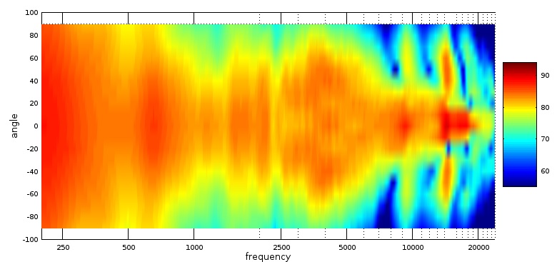

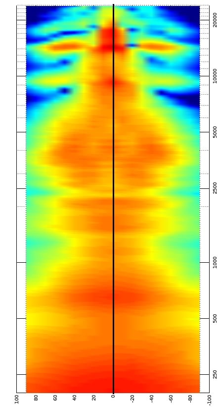

MarkAudio-SOTA Cesti T Polar Map
The above polar map depicts the horizontal
dispersion of the Cesti T speakers, b
ut in a different way then the ‘waterfall’
graphs above it. In this graph we can see some waist-banding around the mids
near the crossover region, although nothing severe. The breakup modes can be
seen to spread a lot of acoustic energy at off-axis angles. This would account
for the sibilance heard at toed-out frequencies, even when the direct-axis
brightness was reduced from the change in angle.

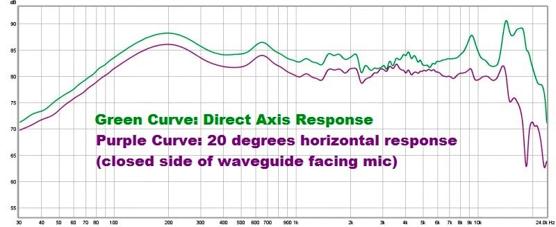

One interesting thing that can be seen when we rotate the polar map 90 degrees is the effect of the asymmetrical waveguide on both sides of its axis. I have drawn a line through the direct axis to emphasize these effects. We can see the left side of the graph projects acoustic energy more widely than the right side, and this is because the waveguide is broader on the right side of this model and expands out more from the driver. The waveguide contains the acoustic radiation in a tighter pattern on the left side. The effects become apparent above 7 kHz, and the asymmetry of the waveguide doesn’t look to be influencing the speaker’s behavior very significantly below that point.
The axis I would recommend to the listener is 20 degrees on the side of the ‘closed’ end of the waveguide, for this reason:
At 20 degrees angled to the closed end of the waveguide, the response is really quite good, and I would advise users to have that angle facing the listening position, which, in many cases, would have this speaker facing straight ahead in parallel vectors. The problem remains that acoustic reflections from room surfaces can still bring in some of that elevated treble response. I will repeat that on recordings that do not lean heavily on these high frequencies still sounded very good- perhaps a little forward but detailed without being edgy. The addition of a reasonably good tweeter and a much steeper low-pass filter would go a long way towards correcting these problems, but it would seem to be against MarkAudio-SOTA’s design philosophy at this time, which is a pity.

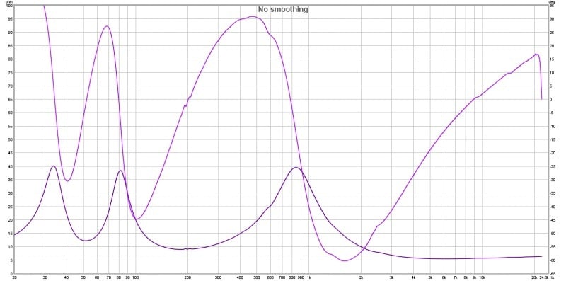

MarkAudio-SOTA Cesti T Impedance and Phase Response
We can see that the Cesti T speakers are tuned to about 50 Hz from the saddle between the peaks in the bass frequencies. The Cesti T speakers do not pose a stiff electrical demand on amplifiers. Impedance never dips under 5 ohms at any point. Impedance does consistently hover around 5 ohms for the treble frequencies, but even here the phase angle is never severe, so this should be an easy load for any amplifier. Sensitivity was measured as 86.4 dB for 2.83v at 1 meter, which isn’t very far from MarkAudio-SOTA’s spec of 88.5 dB for 1 watt at 1 meter, given the impedance curve. This is not an unexpected sensitivity spec for a speaker of this design. This speaker does not need a heavy-duty amplifier to get loud, not that it can handle a lot of current anyway. Again, we should mention here that users should pay attention to the power-handling specification provided by MarkAudio-SOTA.
