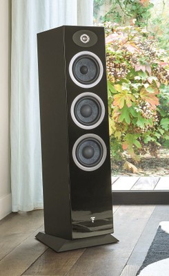

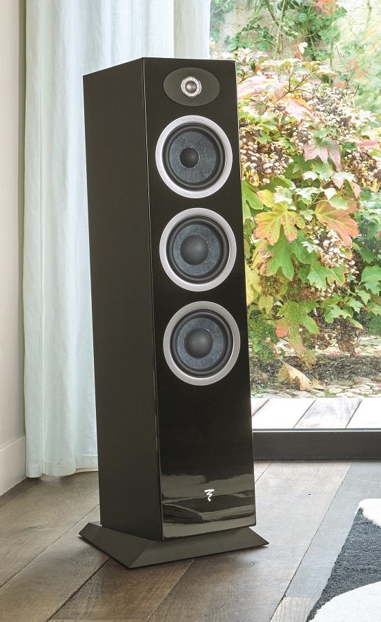

Focal Theva No2 (LEFT) and No3 (RIGHT)
At a glance, the Chora series shares many of the same attributes as the outgoing Chora series: similar aesthetics, similar TNF tweeter, and Slatefiber cones. Focal again employs their TNF tweeter: an inverted dome with a small-diameter voice coil and an aluminum/magnesium diaphragm. One of the unique aspects of this tweeter is the use of a Poron surround instead of the usual soft rubber. Poron is a soft material with shape memory that Focal claims can dramatically reduce distortion in the critical 2-3kHZ region where human hearing is the most sensitive. One significant difference that can be seen between the Chora tweeter and the Theva tweeter is the shape of the waveguide. The Chora uses a round waveguide whereas the Theva uses an oval one. The oval waveguide will do more to limit dispersion on the vertical plane while broadening dispersion on a horizontal plane, whereas the circular waveguide in the Chora series wouldn’t have any dispersion difference for any plane angle.

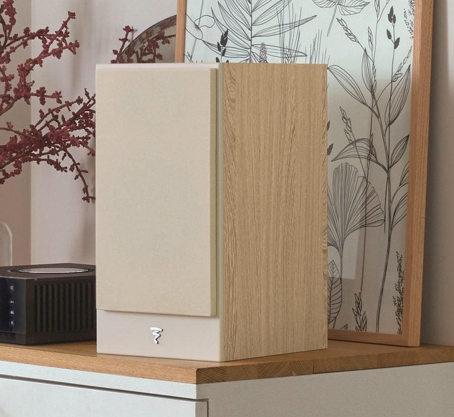

One visible change in the Theva enclosure design is that the port has been moved to the rear of the speaker as opposed to the front-mounted orientation of the Chora speakers. This will help reduce the audibility of port turbulence as well as do more to load the bass against room surfaces. It also cleans up the look of the front baffle of the speaker. Speaking of a cleaner look, the Theva grille now covers most of the front baffle instead of only part of it. The Chora grille was always an awkward design that only protected the woofers and did not cover the port or tweeter. That was strange since the tweeter is the most delicate part of the speaker, and low-mounted ports have always been an enticing compartment for small children to stuff toys or any other object that would fit.

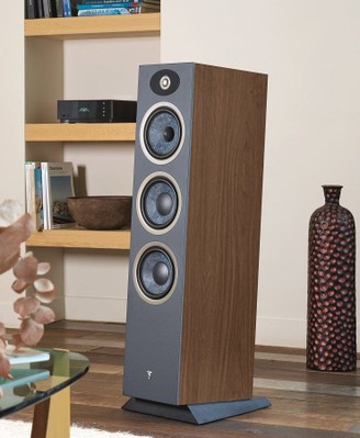

The Theva shares a similar plinth base to the Chora that gives the tower speakers a slight backward tilt. This is done to time-align the tweeter with the woofer since the acoustic center of the woofers will usually be a bit behind that of tweeters for the same mounting frame depth. That is Focal’s explanation for the lean, however, I think it was done more for visual style, and that would be good enough for me, so the speakers don’t have as staid of an appearance.

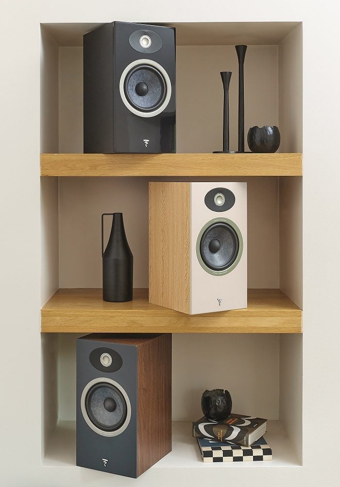

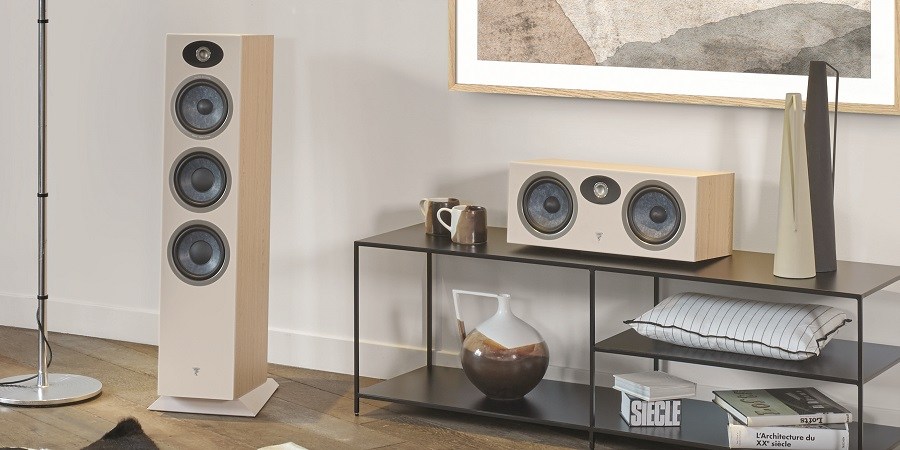

The Theva line hits most of the necessary components for a home theater if that is desired. There is a bookshelf speaker (Theva N°1: $499 each), a slim tower (Theva N°2: $899 each), a full-sized tower (Theva N°3: $1,199 each), a full-sized tower with Atmos modules (Theva N°3-D: $1,499 each), a center speaker (Theva Center: $649 each), and surround speakers (Theva Surround: $649 each). The one thing that would round out this speaker line better is a more appropriate subwoofer. Focal has subwoofers but not one that quite fits the Theva line. The pricing for Focal’s 600P sub seems like a better fit for the Vestia or Aria series, and their Cub Evo and Sub Air subwoofers would be underpowered for the Theva speakers. It’s possible that Focal wants to keep most of the manufacturing in France, and that would be too difficult to do within a reasonable cost with a product that has a plate amp. A missing sub for the line isn’t a big deal, since there are a lot of good subwoofer manufacturers with products that could fit this line just fine. Subwoofers in this class are a crowded market, and I don’t blame Focal for not wanting to struggle for attention in this space.
