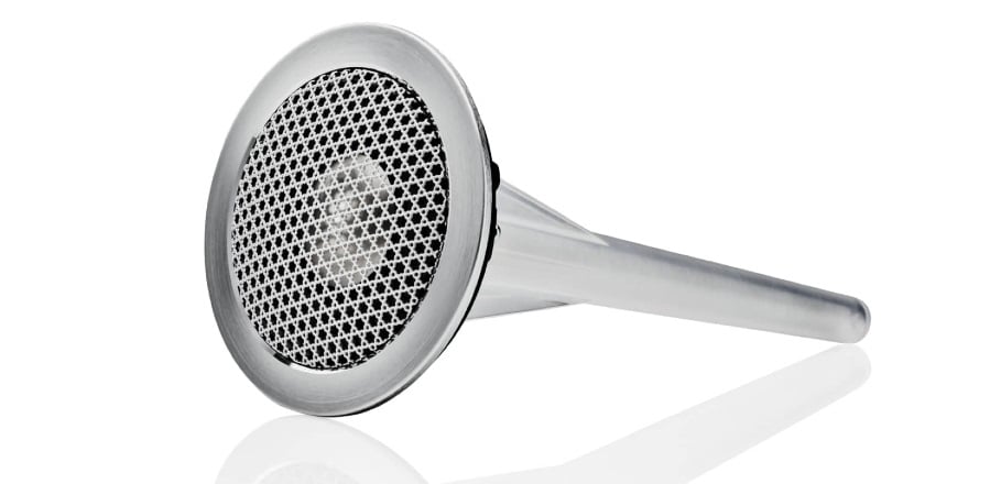

New Tweeter
Bowers & Wilkins says that the 600 Series S3 features comprehensive changes to every aspect of acoustic performance, and that many of these enhancements come by way of new components derived from the 700 Series S3. The company has a history of taking of advantage of trickle-down technology — a strategy that makes sense when you develop and manufacture all key loudspeaker components in-house. The biggest change in the 600 Series S3 is an all-new tweeter featuring a titanium dome. Previous versions of the 600 Series used an aluminum dome. Why the switch? During a live-streamed press event several weeks before the official launch, Andy Kerr, Director of Product Marketing & Communications for Bowers & Wilkins, explained that the titanium dome used in the 600 Series S3 is both better damped and stiffer than the aluminum dome it replaces. The new tweeter isn’t just the result of a change to the material used, but a completely new design featuring a two-part construction wherein a 30-micron titanium ring is used to brace a very thin, light, and rigid 25-micron main dome. This assembly is housed in a significantly elongated tube-loading system, similar to the one used in the 700 Series S3. Bowers & Wilkins says that the longer tube loading system “reduces the resonant frequency behind the dome, leading to a more open sound that is less impacted by the cabinet that houses it.” The new tweeter also benefits from a mounting plate inspired by the 700 Series S3, leading to better, more open dispersion, according to the company. Finally, the tweeter is protected by the brand’s very latest, more open tweeter grille design, taken directly from the 800 Series Signature. Bowers & Wilkins says that the combined effect of these new technologies and design elements is a tweeter that delivers “a smoother, more refined sound without sacrificing resolution or detail.”

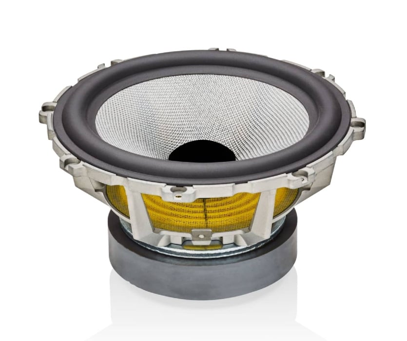

Bowers & Wilkins is known for its proprietary Continuum Cones, which have replaced the yellow kevlar cones of yesteryear. The Continuum Cones used throughout the 600 Series S3 range feature more powerful, lower-distortion motor assemblies compared to previous versions. These upgraded motor assemblies are once again inherited from the 700 Series S3 speakers, and are used both in the pure midrange driver found on the new three-way tower speaker, and in the mid-woofers used in the rest of the lineup. The floorstander’s paper cone bass drivers also feature 703 S3 motor systems. The high-quality, upgraded bypass capacitors from the 700 Series S3 have made their way into the crossovers of the 603 S3 range, reportedly resulting in higher resolution and transparency.

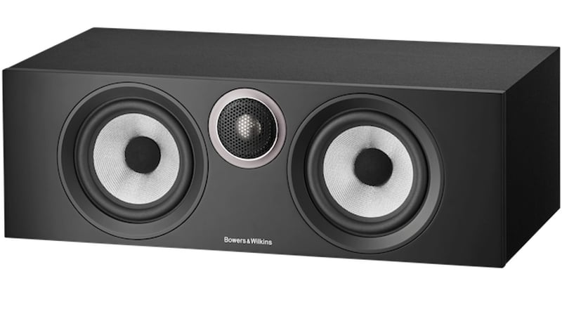

The HTM6 center-channel speaker employs two 5-inch Continuum Cone mid-woofers flanking the titanium dome tweeter. Its frequency response of 72Hz - 28kHz (±3dB) suggests that Bowers and Wilkins expects home theater customers to add a subwoofer, though the speaker does extend down to 42Hz (-6dB). Sensitivity is about average at 87dB. Nominal impedance is 8Ω, with a minimum impedance of 4.3Ω. The HTM6 utilizes a nested MTM design to reduce off-axis lobing for widening the listening area.
