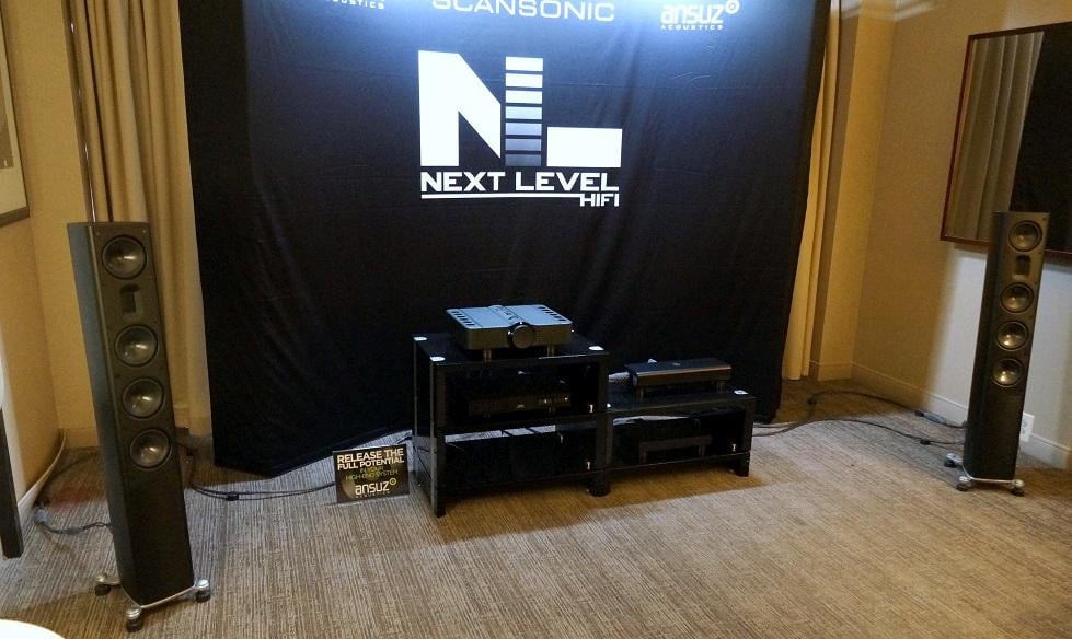

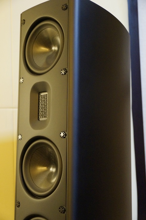

Scansonic HD MB-5 MSRP:
$6950 / pair
One speaker
that caught my attention early in the show was the crisp clean sound of the Scansonic HD
MB-5. One aspect of this speaker that took me by surprise was the
quantity of
bass; how did such a slim speaker pound out kick drums and double bass with
such authority? The HD MB-5's use all four
of the 4.5” carbon weaved woofers for bass below 200 Hz in a ported
enclosure. Four 4.5” drivers have identical surface area to a single 9” woofer,
so they can add up to some actual displacement. What's more is that
displacement is performed with four motors instead of one. They can dish out
excursion with a lot of force and can be less affected by thermal compression
and induction compared to a larger single driver. An advantage of these smaller drivers is that they can have a
wider dispersion than large drivers, and this can create a nice spacious sound
by way of side-wall reflections. The Scansonic HD MB-5 uses a sealed, extreme
low-mass ribbon tweeter crossed over at 3.5 kHz, a high crossover point, but
one which 4.5” woofers should be able to support without fear of severe beaming
issues. The top two woofers that sandwich the tweeter are used up to the
crossover frequency, while the lower two woofers are only used from 200 Hz and
below. This is known as a 2 1/2 way design topology. This MTM configuration plus the waveguide around the tweeter should give
the MB-5 nicely controlled horizontal dispersion. What I heard was likely
nearing the limits of bass capability of the MB-5, but it was impressive
nonetheless. The clean midrange and detailed treble pulled me in and made me want to stay in
the room. The Scansonic HD MB-5 looks like a solid design that has a small
footprint, and anyone in the market for such a speaker would do well to seek
out a pair for a demo.

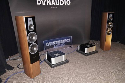

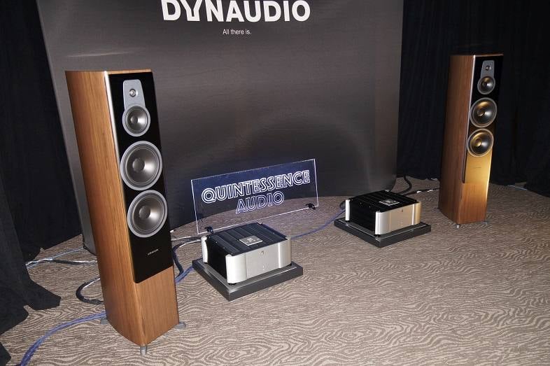

Dynaudio Contour 60 MSRP: $10,000 / pair
The rep at Dynaudio must have read my mind as I entered the room. As I seated myself, and without any exchange of words, he queued up Kraftwerk’s ‘Trans-Europe Express’, a most welcome change of pace from the blues, jazz, and progressive-rock that fills the halls of AXPONA, an unfortunate byproduct in a hobby that is composed mainly of men in their late 50’s and 60’s. It might not have been the most high-fidelity recording, but what soul who claims to love music could not resist bobbing their head along with the simple melodies and uncluttered percussion of this seminal electronic album? The speakers sounded great, which is seemingly a tradition from Dynaudio. Two 9.5” woofers rocked the bass and a 6” mid-range woofer took the range from 220 Hz to 4,500 Hz (a very wide range for a midwoofer of that diameter). A 1” soft-dome tweeter design that Dynaudio calls Esotar² handled the treble. This is all stored in a hefty cabinet that weighs nearly 120 lbs. Plenty of bracing is evident for a solid, inert cabinet that has Dynaudio’s characteristic aluminum front baffle resembling stylish armor plating. This is a speaker that was designed to play loud without losing fidelity, which is a fact that is reinforced by its 390 watt IEC power handling spec. I would have liked to stay in the Dynaudio room longer, but sadly the Kraftwerk recording ended. With it ended my brief respite from elderly men’s preferences in music, although there are surely many people out there now that consider my own musical tastes to be archaic.

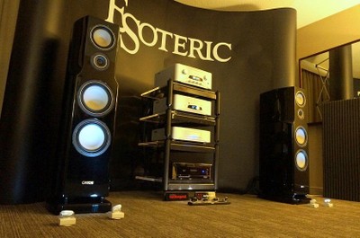

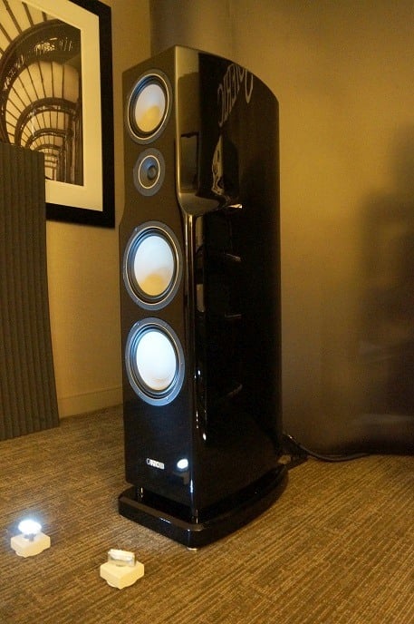

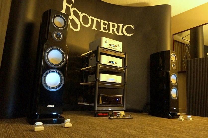

Canton Reference 3 K MSRP: $15,600 / pair
Don't b
e distracted by its good looks, there is also a good speaker hiding behind the
stately, almost imperial, aesthetic of the Canton Reference 3 K speakers. It is
easy to be intimidated by their regal bearing, but the sound emanating from
them was very easy to get along with. I wish I had asked what piece of music
was playing during my stay in the Canton room, but I was too entranced by the
vivid impression of a grand piano playing in a concert hall backed by an
orchestral accompaniment that these speakers projected. Good speakers can be like
that with the right recording: transporting devices to another place or time
entirely. The heart of most three-way speakers like the Reference 3 K is the
midrange driver. In this case it uses a 7” aluminum cone with a
ceramic-tungsten structure and plays from 200 Hz to 3 kHz. Two 8.5” woofers
with similar cone composition take the low end with the help of a down-firing
port. The treble is taken care of by an aluminum oxide ceramic dome tweeter.
The midwoofer is internally separated inside the cabinet and the cabinet
itself is heavily braced weighing in at 123 lbs. If this speaker had an
automobile equivalent, I would say it would be a S-Class Mercedes: luxurious,
but high-performing. I certainly wouldn’t mind owning a pair of these speakers
(or the car).

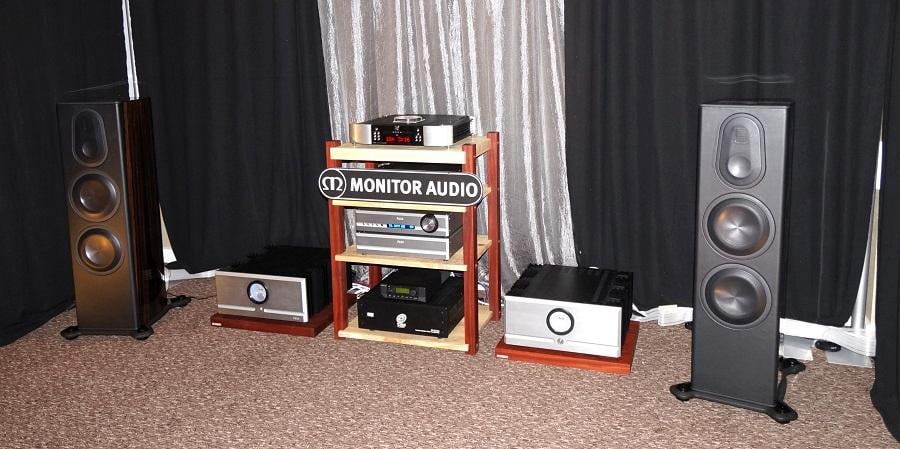

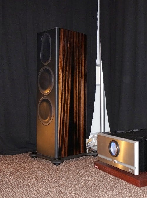

Monitor Audio PL300 II MSRP: $14,495 / pair
Monitor Audio’s latest PL speaker series is a true
tour-de-force of speaker technology, so it was a delight to see the
formidable
PL300 II speakers at AXPONA. The music sounded like Miles Davis; with his
distinctive trumpet that sounds like it’s floating over the the
percussion, piano, and bass guitar yet still perfectly in sync. The sound was
quite vivid as replayed from the PL300 II speakers. I could nearly see the
haze of smoke in a Harlem jazz club in the mid 50’s (or was that smoke from a nearby
electrical fire?) The speakers sounded terrific. The Monitor PL II series
benefit from a long list of design innovations and attention to construction
detail that can be read on their website, so I won’t recount it all here. There
is a couple of neat things going on in the PL300 II that I do want to mention. One
interesting aspect of its design is that the drivers are not simply screwed in
the front baffle; instead, they are held in by a bolt from the rear side of the
cabinet. This creates an equal amount of force around the driver periphery, and
it also acts as additional bracing for a more rigid cabinet. It also gives the
speaker a cleaner appearance by doing away with the need for front-mounted
screws. Something else I found interesting is the way the voice coil former is
attached to the cone. Traditionally the former is simply glued to the cone
directly, but in the PL300 II speakers, Monitor uses a patented design where a
specially calibrated pliable nylon ring attaches the former to the cone. This
ring is designed to be rigid up to the crossover frequency but becomes springy
above that frequency. This can damp high frequency energy thereby reducing
cone breakup. It's also perforated to allow for better cooling of the voice
coil. These are just a few of the many intriguing design decisions made for the
PL II series speakers, and for those interested in speaker design, it is worth
looking over their brochure to see some of the
other neat details about their construction.

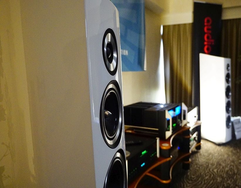

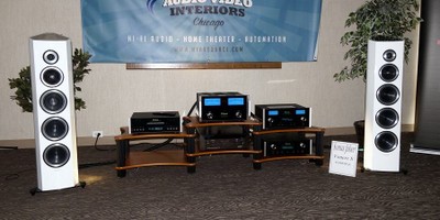

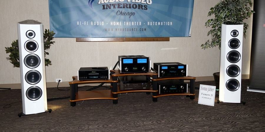

Sonus Faber Venere S MSRP: $5,000 / pair
Though they might look like a five figure speaker,
and even have the name of a five figure s
peaker, the Sonus Faber Venere S
speakers only cost $5k a pair. They sounded as elegant as their name and managed to attract
interest even in the same room as Martin Logan’s flagship Neolith speakers. The
vendors in the room alternated playback between the Neoliths and the Venere S
speakers, and while the Venere S speakers could not match the Neolith’s dynamic
range, I heard many listeners around me compliment their sound quality,
especially for the cost. Although the room they were in was quite large, they
still managed to project palpable bass throughout the space. The three 7” bass
drivers crossover at 250 Hz were doing their job impressively there. A 6”
midrange takes the frequency range up to 2,500 Hz where it hands off duties to
a 1” fabric dome tweeter. These drivers all are designed in-house by Sonus
Faber. The elegant cabinet design is not just for looks; lack of parallel
surfaces help to break up standing waves within the cabinet thereby reducing
panel distortion, so form follows function here. The chic looks and nice sound
belied the Venere S’ $5k price point, and it was nice to see a speaker that
made the sound- and look- of hi-fi more accessible than most of the other
setups seen at AXPONA.

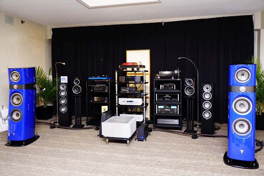

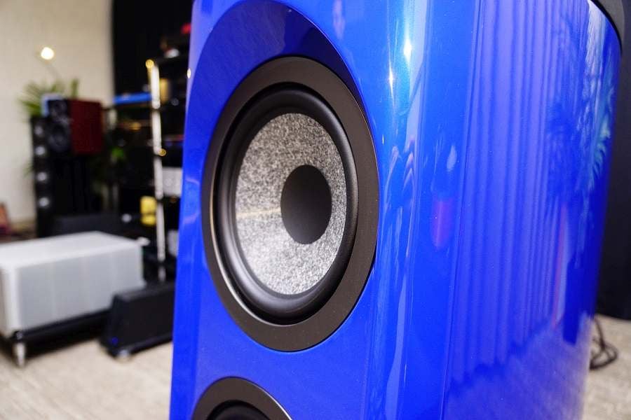

Focal Sopra N°3 MSRP: $19,999 / pair
On the opposite end of the price spectrum is Focal’s new Sopra N°3 speakers which made an appearance at
AXPONA, and dazzled attendants with their looks a
s much as their sound. The
pounding kettle drums from a Hans Zimmer composition shook the large room while
the brass section was rendered by the Sopras with lifelike intensity. The
Sopras showed no sign of strain as they blazed Zimmer’s music at volume levels
that one would expect from an Imax theater. This all made for a stunning visit
to the Focal room. The Sopra speakers are not inexpensive speakers, but they
are jam-packed with innovative design and construction. The Sopra uses a 1.1”
Beryllium inverted dome tweeter in its own enclosed section of the cabinet. It's engineered so that its backwave radiation is heavily absorbed and does not
interfere with the tweeter’s operation. The top section of the Sopra is the
housing for the 6.5” midrange driver which takes the range of 250 Hz to 2,200
Hz. Careful modeling was performed to simulate induction effects in order to
find the optimal placement of a shorting ring which reportedly resulted in a
70% reduction in distortion. Two 8.25” long-throw drivers cover the bass along
with a down-firing port for a -3dB point of 33 Hz. The cones of the bass
drivers and midrange use a sandwich construction of a woven glass fiber outer
layers enclosing a structural foam that provides a very high stiffness with
respect to its mass. Construction and bracing is extra heavy-duty as the
speakers weigh 154 lbs each. The Focal Sopra N°3 speakers sounded and looked
very pretty, but they also cost a very pretty penny.
