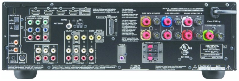

Inputs and Outputs
The Onkyo HT-R570 has the ins and outs you'd expect on a basic A/V receiver. First off, the four HDMI pass-through inputs will switch four HD sources effortlessly to the single output. Dual component video inputs means that legacy products will also be able to get tied into this receiver. In order to use both, you'll need to connect both component and HDMI to your display since the receiver does not offer any video upconversion. There are also three other composite video inputs, but no S-video connections (which is just fine with us). In addition to these video inputs there are dual stereo inputs for CD and Tape (hey, what's that?) and two each of optical and coax S/PDIF connections.
Note the lack of 5.1 analogue inputs
In terms of speaker connections, this model is the first where all primary (left/right/center/surround/surround back) speakers get 5-way plastic binding posts, but the Front B speakers get spring clips. This is not uncommon at this price point, but it does indicate the lack of a dedicated Zone 2 for this system, opting instead for a second parallel amplified set of B speakers. Spring clips of this type do best with 18 gauge or higher (smaller) cable. While the similar TX-SR507 has a dedicated Zone 2 output, the HT-R370 utilizes those amps for the Surround Back channel. In addition, the TX-SR507 adds preamp outputs for Zone 2 and Surround Back channels (great for adding a wireless solution for your rear speakers). It was interesting to note that the HT-R570 included support for Sirius satellite radio, while the TX-SR507 did not.

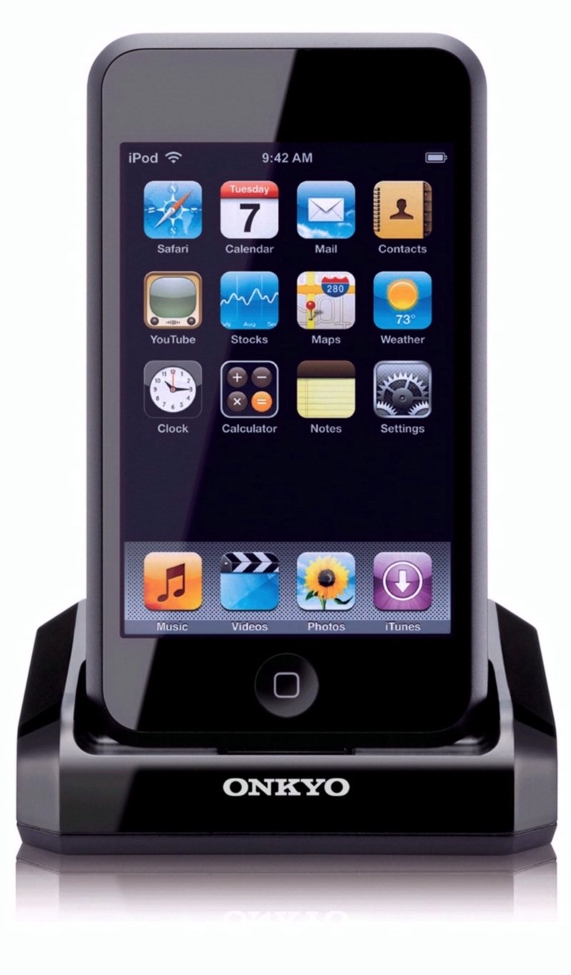

That weird-looking D-connector on the back is a proprietary iPod dock port that Onkyo uses to connect to the included UP-A1 iPod dock. This dock lets you incorporate the iPhone right into your home entertainment system. The UP-A1 supports your iPhone or iPod's ability to send music, movies, TV shows, music videos, and video podcasts to the HT-R570. It draws a steady power supply from the AV receiver via the same convenient cable that delivers the video and audio signals. The UP-A1 also offers handy features found on previous Onkyo docks: the ability to recharge your iPod or iPhone. On compatible receivers (of which the HT-R570 is not), the dock also gives you onscreen display for content navigation and selection.

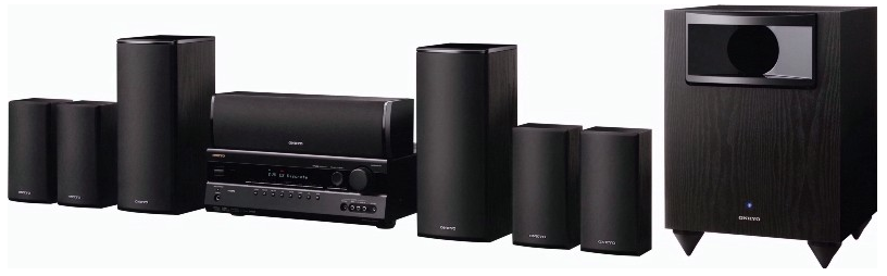

Main Left/Right and Center Speakers
In this system the front left/right speakers differ from the rest in that they have a larger driver. Each speaker is just 15" tall and about 6" wide, so they are easy to place in any home. These speakers also step up to a two-way system, and the dedicated 1" tweeter means that you'll get clearer audio with less distortion. The mains produce frequencies, according to Onkyo, down to 55Hz. The center is nearly the same, but uses a pair of 3-1/4" woofers and goes down to 65Hz.
The Surrounds and Surround Back speakers are a smaller version of the mains except that the cabinet size is nearly 6" shorter (adding a tiny bit more to its depth to compensate). They also utilize a single 3-1/4" "full-range" driver and are ported, extending down to 80Hz. The front and center speakers weigh in at around 6 pounds each, while the surrounds are just over two pounds. All speakers in this system are made of wood materials and are a nice upgrade from Onkyo's entry level HTiB speakers which are encased in plastic.
Subwoofer
The included sub is active, meaning it has its own amplifier and must be plugged into an outlet, and contains a 10" driver with a large front port. The box itself is roughly 12" x 18" x 16" making it a pretty big box, but still small enough to hide away if necessary. We'd recommend keeping it up front if possible and moving it around to find the location that yields the best low frequency response. This is a solid sub, and we've seen many subs in similar systems come with an 8-inch driver - which is often not big enough (in an inexpensive passive system) to go down to that critical <30 Hz range. Onkyo claims a frequency response of 25Hz with this sub, but provides no specs on how it came to that measurement. It would be safe to assume that the sub is at least 3dB down at this frequency, if not more. You can upgrade this subwoofer with an aftermarket solution at any time. Some recommendations are the Axiom Audio EP125 ($375), Aperion Audio Bravus 8A ($319), and the Velodyne Impact-12 ($369).

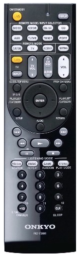

Remote Control
The remote that comes with this unit is sufficient enough to handle most basic systems (TV, DVD player and the AV receiver) but don't expect to have it operate your DVR or more sophisticated cableTV functions. It works via preprogrammed codes and cannot learn commands from other remote controls. The layout is intelligent, with direct access over inputs and the four listening modes (which can be further toggled by repeatedly pressing each button.) There is no backlight on this remote, so plan on using it during the day or learning where everything is for nighttime use. A good universal remote should land this thing in storage pretty quickly - and that's our recommendation for most entry level remotes.
