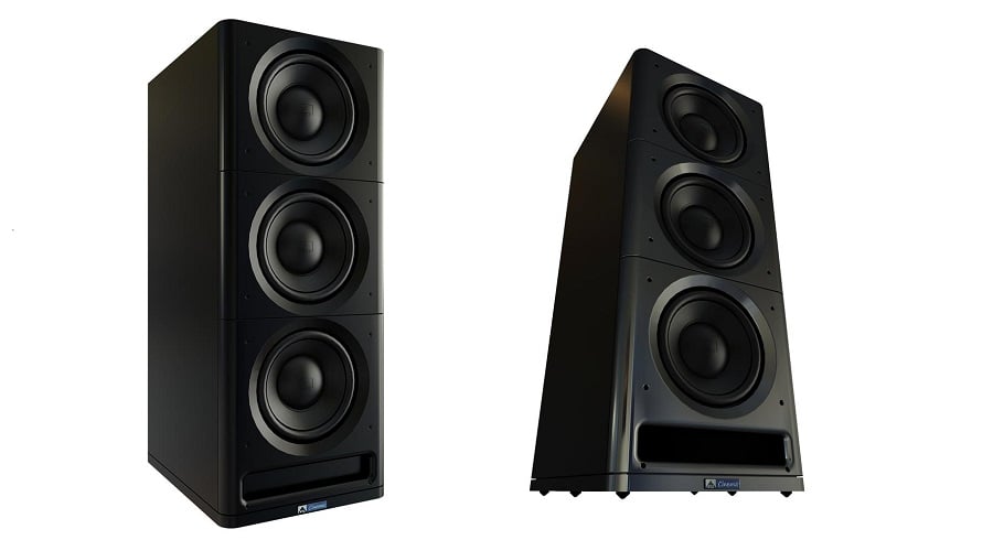

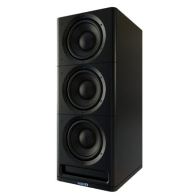

The 3X12 is a large bass reflex or vented design with a set of three 12” drivers arranged in a vertical array on the front of the enclosure and a large heavily flared slot vent below the drivers and also on the front of the enclosure. The amplifier system for the 3X12 is rated at 1500watts and the amplifier plate and controls are on the back panel of the enclosure. Each driver has an individual grille cover which is cloth covered and is easily removed or replaced. I decided not to use the grilles for the 3X12 as I liked the look better without them.

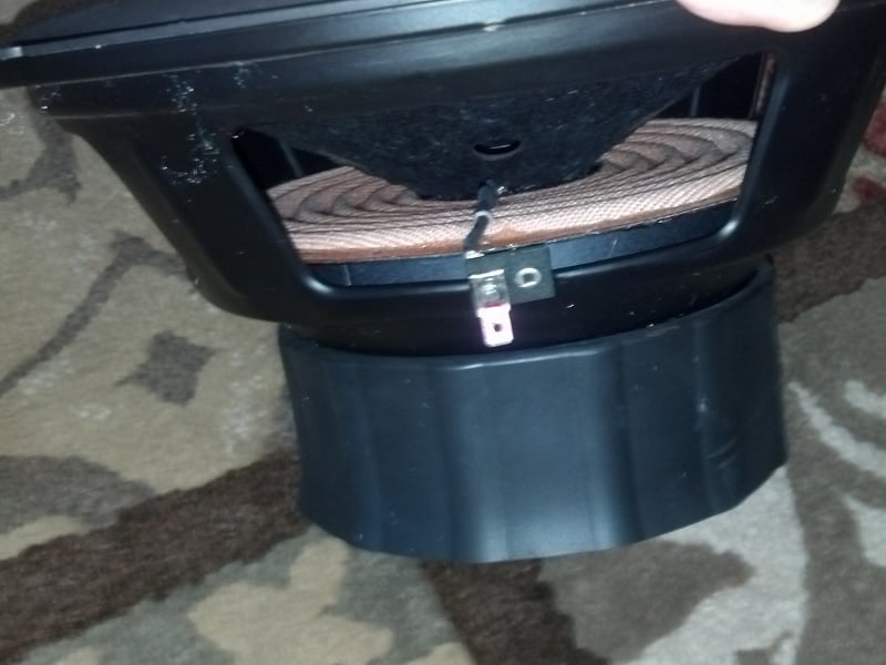

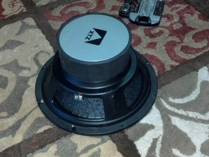

The drivers for the 3X12 are accessed by removing the piece of wood that holds each grille and becomes the front fascia of the subwoofer. Each driver has an individual cover baffle that holds the grille and driver mounting screws. The drivers can be removed by unscrewing four large star drive bolts from each baffle cover to access the driver mounting flange and then removing the screws holding the driver. The drivers are each a 12” nominal frame diameter and feature a pressed paper cone with a poly dust-cap embossed with the XTZ logo. The frame is stamped steel and the suspension system consists of a rubber half roll surround and a 6.5” diameter spider with a small spacer for extra clearance. The drivers utilize a single 2” diameter voice coil which appears to be 4 ohms nominal. The motors have a double stack of ferrite magnets which are about 6” in diameter and weigh 96oz. The back plate is adorned with the XTZ logo and the magnets are covered with a protective rubber boot. The motors also employ a shorting ring in them which lowers inductive, even-order distortions related to asymmetries in the motor system. The drivers are not massively overbuilt like some others but they are engineered well and there are three of them to share the work load, which often ends up performing better than a single “uber” driver.

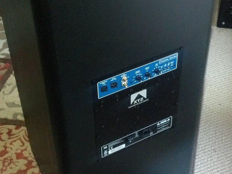

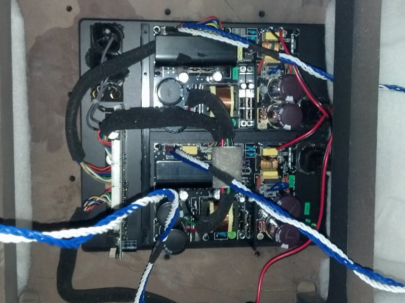

The amplifier system for the 3X12 actually consists of three 500watt rated, class D amplifier modules, each of which is in charge of powering its own driver. All are controlled by the same singular set of controls on the amplifier input plate which is on the back of the cabinet. Two of the modules are actually mounted to the amplifier control plate. The third is mounted off to the side on the left cabinet wall. The amplifier controls consist of the usual things like: Variable gain, a 0-180 degree phase control, variable low pass filter control with bypass setting via a toggle switch and a detachable power cord. The inputs consist of both RCA unbalanced and XLR balanced connections. There is also a direct pass through XLR out. There is an auto on/off toggle switch which only works for the unbalanced connections. The XLR balanced input needs to have the toggle set to always the always “ON” position.  Finally there is a toggle switch to control a room EQ setting. The settings are either “Anechoic” which is for larger spaces without significant boundary reinforcement or “Room” which reduces the deep bass level below 35Hz for smaller spaces which exhibit significant boundary reinforcement. The power cable for the 3X12 does not have a center ground pin utilized but since I used the balanced connections the entire time I experienced zero ground loop or noise issues even with the gain on the amplifier at maximum.
XTZ Sound 3X12 Amplifier Modules
The cabinet of the 3X12 is built from one inch thick medium density fiber board. The internal construction features a pair of large cross braces spaced at about the 1/3rd points of the panels and connecting the side walls and front and back panels together rigidly. The slot vent is quite large and features a flared opening for less air noise at high output and it also helps to stiffen the bottom of the cabinet. The cabinet walls also have a generous amount of damping material on a number of the internal surfaces. As previously mentioned the side walls are not parallel and the cabinet widens toward the rear panel to a significant amount. This will help avoid standing wave issues between those internal surfaces. The driver cover panels are a thick piece of MDF machined with a couple of nice round overs that cover and hide the mounting screws and hold the grilles over the drivers. It’s a nice way to handle the issue of aesthetics and provide ease of driver access. The 3X12 has a relatively dead and well damped cab despite its large panel area, due to the efforts described above. The parts, build and finishing quality are all quite good. The impression is of a thoughtfully conceived and well-executed design.
