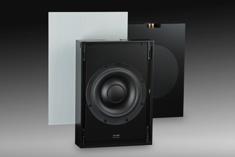

As many of our regular readers are aware, generating deep, powerful bass for music or home theater usage generally calls for a fairly large and capable subwoofer. So what happens if you'd like credible low end reproduction, but for lack of space or aesthetic concerns, you need something effectively invisible? Enter the Triad InWall Bronze 4 Slim Sub. For those unfamiliar with Triad, they aren't exactly a newcomer to the A/V market, having been founded in 1982. Specializing in custom solutions, the vast majority of Triad's speakers are built to order in the US. The Bronze/4 Slim Sub is Triad's latest in-wall subwoofer offering, made to quite literally disappear into a room.

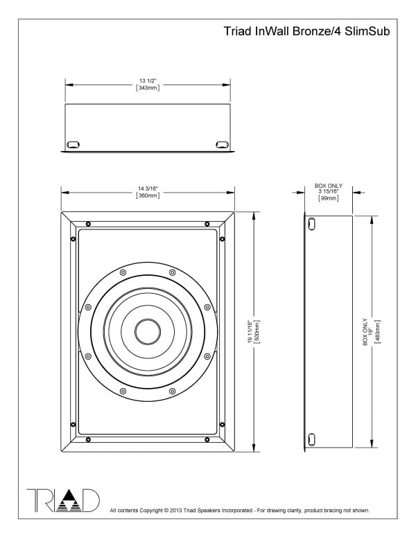

So what exactly goes into making a Bronze 4 Slim Sub? Triad's latest solution sports a 10" aluminum cone driver in a very shallow (slightly less than 4" deep) sealed enclosure, and power is provided courtesy of an external 350 watt DSP controlled BASH amplifier. The Slim Sub is made to slip into a standard 4" deep wall cutout, and be flush with the surrounding wall, unlike its predecessor which protruded several inches from the wall. This is in part accomplished by utilizing a rounded steel back plate as opposed to a much thicker sheet of MDF, which allows the driver to reach full extension in the relatively shallow enclosure.
CAD Drawing of the Triad InWall Bronze 4 Slim Sub
Usually the grill is about the last thing people talk about when it comes to subwoofers, but Triad's Acoustimesh grill is worth a quick note. First and foremost, Triad will custom paint-match the grill at the factory, allowing the Slim Sub to blend into any space, right out of the box. The other nice thing to know is that the Acoustimesh grill is metal, which may be of some comfort for those audio buffs that happen to have young children.
