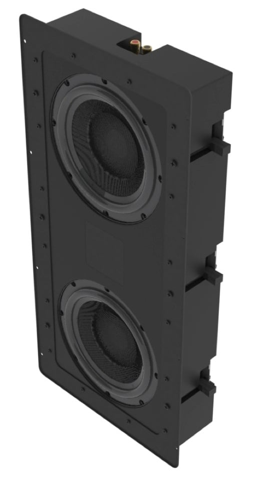

- Dual 8" custom designed fiberglass cone long throw woofers
- 33Hz-150Hz
- 106dB maximum output
- Sealed cabinet dimensions: 12.2" x 24.7" x 3.75" (WxHxD)
- Cutout requirement: 10.6" x 23.5" (WxH)
- Six dog-toggle style wall clamps
- Wire channel to avoid pinching
- Magnetic grilles

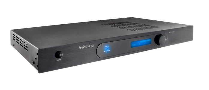

Included external digital amplifier
- 520 watts
- Balanced and unbalanced inputs plus line level inputs

Well, to answer the second question, $1700. No, it isn't cheap, but you aren't just paying for the name. The HRSIW8 in-wall sub sports dual 8" woofer with custom designed fiberglass cones. These long throw woofers are housed in a sealed enclosure which will fit easily in your standard 16" on-center stud bay. The enclosure is 3.75" deep and includes a wire channel to minimize the space requirements. The included cutout template will lead you to a 10.6" by 23.5" hole in your wall. Six dog-toggle style wall clamps hold the speaker in place. The magnetic grille is (we're hoping but it isn't specified) paintable.
The rack-mountable Sunfire amp is external to the subwoofer and includes a number of interesting features. First, it has both balanced and unbalanced inputs. This evolution from the SDS subwoofer line digital amp includes Sunfire's Frequency Filtration Design for high fidelity bass as well as an included DSP with room equalization and a number of filters for fine tuning the response. An included remote allows users to change preset equalizer modes on the fly (also means discrete commands which is helpful for custom installers that want to integrated the presets into a universal remote system).
