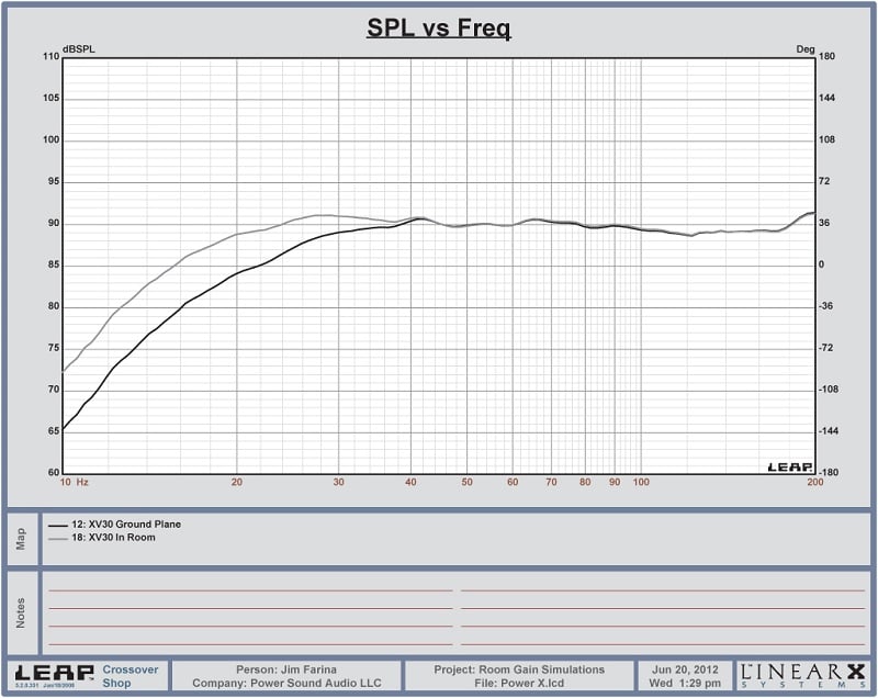

The first thing that caught our eye with Power Sound Audio was not the size, shape, or performance of their subs. It was that they test their subs using the CEA2010 (2 meter ground plane) standard. Most subwoofer manufacturers are happy to give you a frequency response specification with no indication of how they arrived at it (there are times we think they just sit in a room and say, "Yeah, that probably goes down to 20Hz"). Not so with Power Sound Audio. They not only use rigorous testing but also publish the results. Take a look at this graph from their largest sub, the XV30:
This is a 1/6th octave smoothed ground plane measurement paired with a simulated in-room response. We didn't have to pin down the manufacturer to find this out - they state it directly on the product page. Not only that, but they have Frequency Response and Long Term Output Compression graphs. As you can see in the above graph, in the ground plane measurement, the XV rolls off softly starting at 30Hz but doesn't really reach its -3dB point until around 21Hz. This is an excellent response and leads to a simulated in-room response of 16-18Hz -3dB. If that doesn't have the bass-heads in the crowd salivating, this will: the MSRP is $1249.

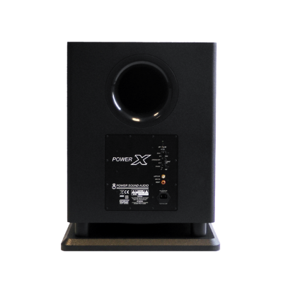

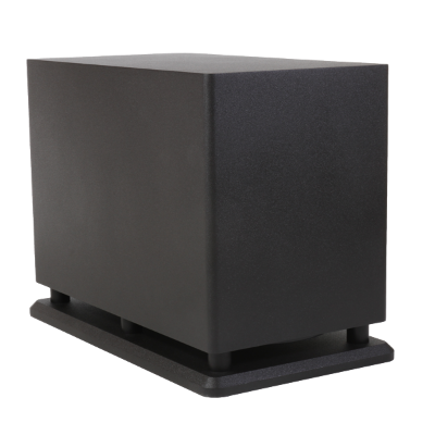

The XV30 sports two down-firing 15" woofers, a large, rear facing port, and a 750 watt amplifier. The amp has an On/Off/Auto switch, knobs for volume, phase (0-180), and crossover, (40-150Hz) and RCA inputs. Power Sound Audio brags a precision analog control through DSP though we are not exactly sure what that means. There is built in temperature, CD offset, overload, short circuit, and load protection plus soft limiting. The drivers are proprietary with 2" peak-to-peak excursion, carbon steel motor structure, vented pole geometry, reinforced kraft pulp cone. The enclosure is 36” by 20.5” by 26.75” (D x W x H) which, honestly, sounds like a large end table to us. It sports the sort of finish you can only sell online (vinyl wrapped) and 1” thick MDF baffles and 1.5” thick MDF base. It weighs in at a back breaking 158 pounds. The XV30 and the smaller XV15 and XS15 subs are available for pre-order but won't be shipping until August at the earliest.
