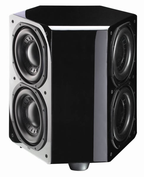

Paradigm Reference Signature SUB 1
Design
  • Six high-excursion eight-inch drivers, patented built-in Ultra-Class-D™ power amplifier, USB port, sealed enclosure
Amplifier
  • 3,400 watts Dynamic Peak/1,700 watts RMS Sustained
  • Auto-On/Off, Trigger-On/Off, soft clipping, thermal protection, electrical shorting protection
Bass Drivers
  • 38-mm (1.5-inch) four-layer voice coil, high-temperature composite former, 4.7-lb. (2.1 kg) ceramic/ferrite magnet / motor structure
  • Oversize FEA-optimized Pleated LCS™ Linear Corrugated surround
  • AVS™ die-cast heatsink chassis, 203-mm (eight-inch) RCR™ mineral-filled co-polymer polypropylene cone
