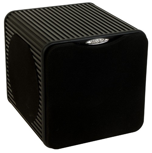

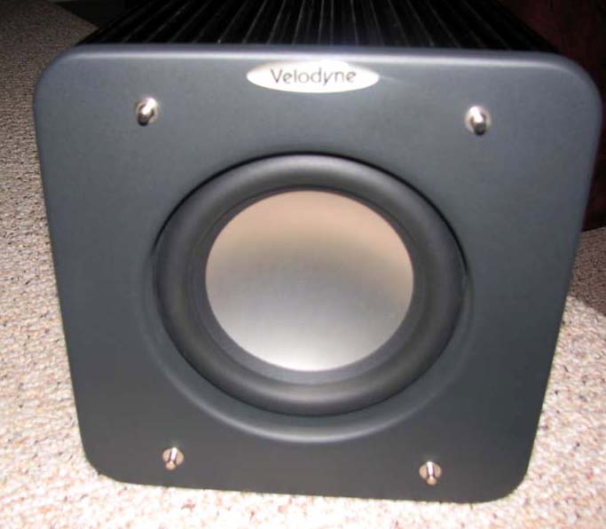

The Velodyne MicroVee is certainly the smallest subwoofer that has entered my sound labs for testing. Incidentally its one of Velodyne's only multi-driver subwoofer products sporting a sexy 6.5" (5" piston area) aluminum cone woofer and dual 6.5" (5" piston area) side firing passive radiators. The box is almost completely void of space thanks to large driver, passive cones and powerful 1000 watt amplifier. In order to get any appreciable SPL out of such a small enclosure, it is necessary to utilize a high excursion driver coupled with passive radiators to increase effective cone area and a hulking amp to equalize extended bass response. Unfortunately, this is a costly solution to implement, hence the $799 retail price which is incidentally $100 more than their next model up, the MiniVee. The MiniVee has a single 8" driver (6.5" piston area) with more output capability and extension than the MicroVee, but has a slightly larger enclosure taking up about 40 in^2 more floor space. The MicroVee has a pro-audio type look to it thanks to the ribbed extruded aluminum cabinet which is said to dissipate heat build up. Because of its small size, it can be neatly tucked under a desk or behind the office garbage can which is where I placed mine during this review. The MicroVee comes in black or white to blend into your room décor incase you can't find a small enough space to hide it out of sight.
The back panel of the MicroVee has all of the functionality and connections you'd expect to see on larger subs, which includes volume level control, variable low-pass crossover from 50Hz to 200Hz, 0/180 degrees phase switch, crossover bypass, auto on/off, speaker level inputs and outputs and RCA and mini-jack connections. The power cord is a two-prong type and is not detachable.

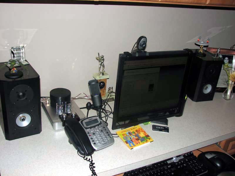

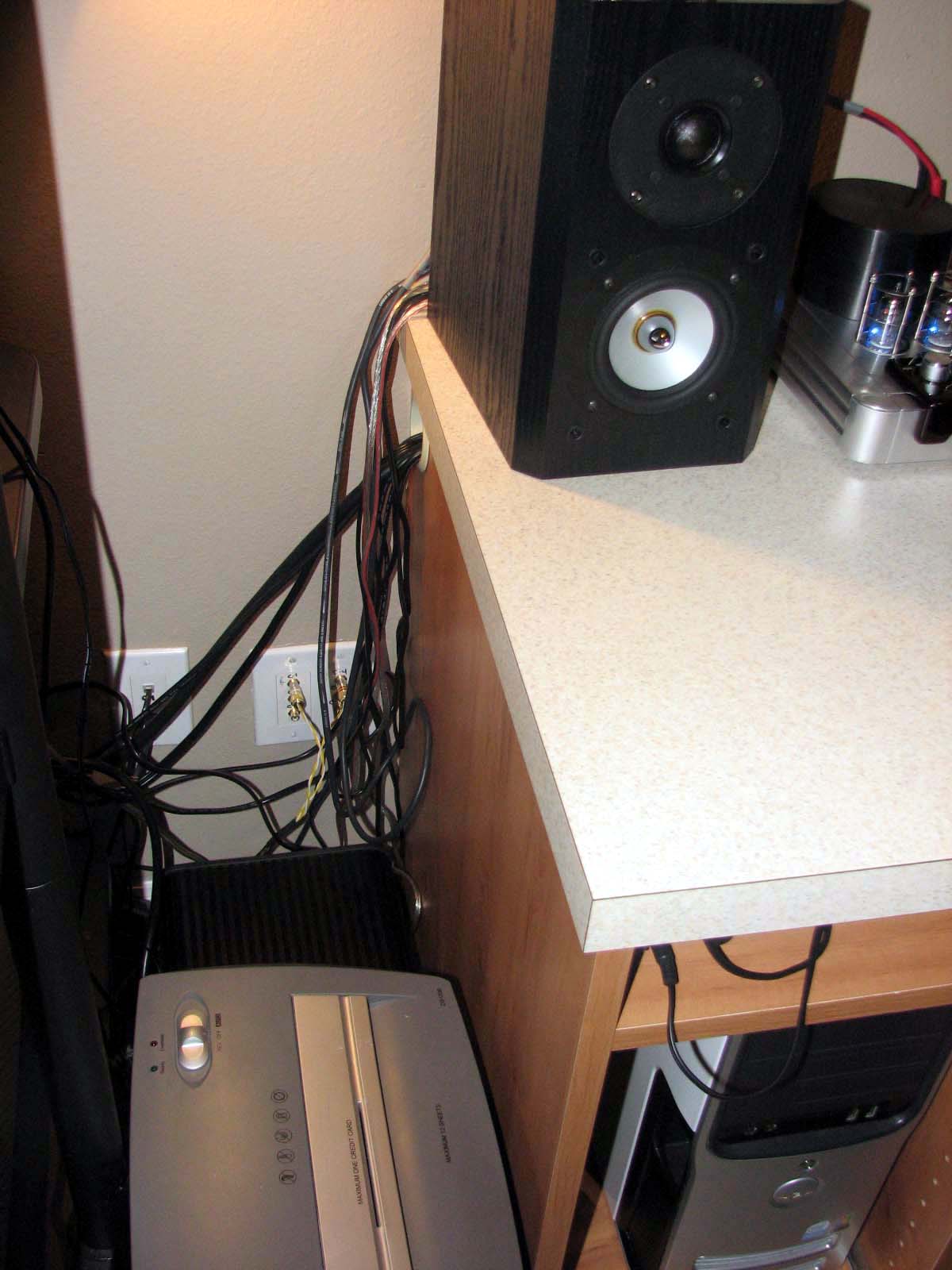

I tried the MicroVee in several locations in my office, but found it blended best with my speakers when placed on the floor below the left speaker and behind my trash can. I tried placing it on the desktop but it produced such a large tactile response that it seemed artificial when listening to bass intense music. The MicroVee was connected to my EMP VT40.2 Hybrid Tube Amp Speaker System via speaker level paralleled to the 41-SE/B speakers. I found the line level outputs of the VT-40.2 amp to be about 10dB too hot for this sub which caused it to reach maximum gain when the volume control on the sub was set any higher than a finger nail thickness from zero. A more graduated level adjustment would have been appreciated. I was unable to make coarse level adjustments using the volume control because the sub reached a high gain state with the volume barely turned a few clicks past minimum regardless of what source device I connected to it. When using speaker level connections to my EMP VT40.2, I still only needed to set the master volume of the MicroVee just below the second dot from zero to reach the right output level. The volume control was quite finicky and I wished Velodyne would have instead employed a stepped potentiometer so you could lock your setting in place without fear of being blown off your chair because the volume control got accidentally bumped higher when you were moving the sub to do some spring cleaning.
I found the MicroVee sounded boomy regardless of placement until I adjusted the crossover down to its lowest setting (50Hz) which still provided plenty of output for the 60Hz -3dB point of my speakers (more on this in the measurements section). I advise experimentation here and not to be fixated on using a specific setting based on the extension of your satellite speakers.
Unless otherwise noted, all listening tests were conducted using the streaming services of Pandora.com fed from my PC to my Headroom micro preamp and DAC connected directly to the EMP VT-40.2 Hybrid Tube Amp Speaker system.

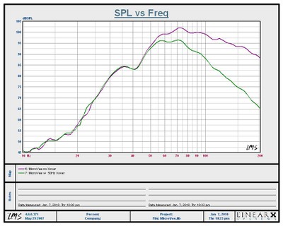

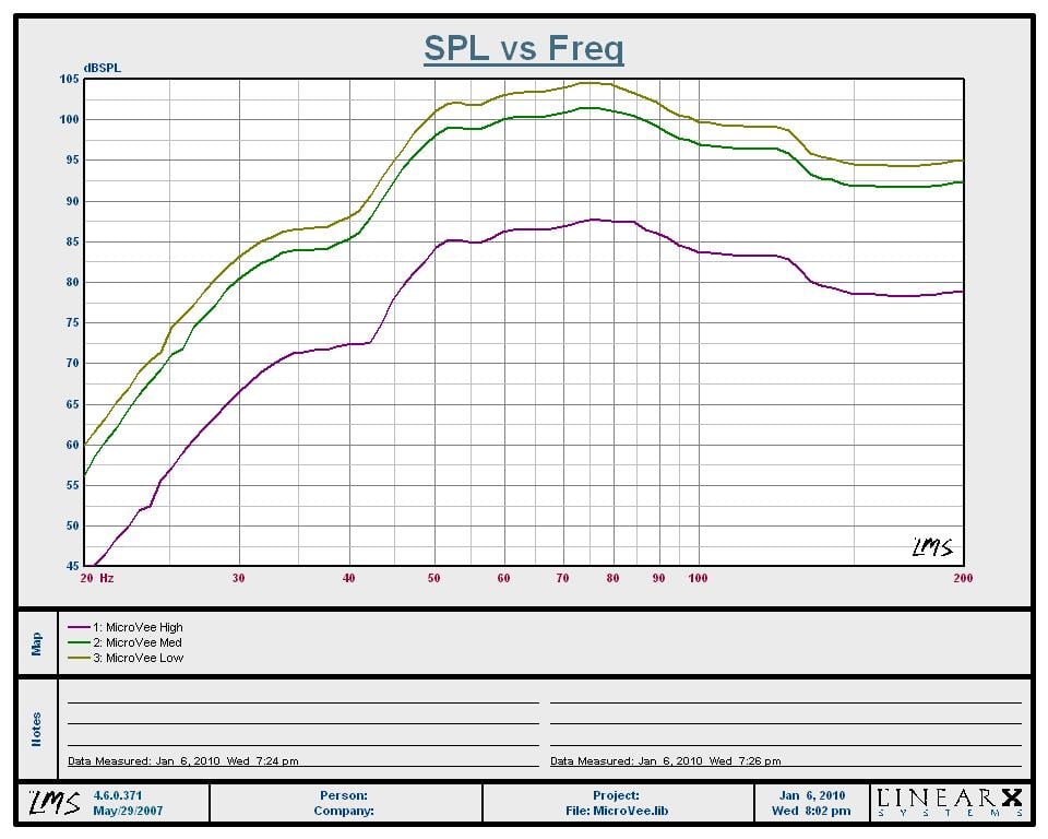

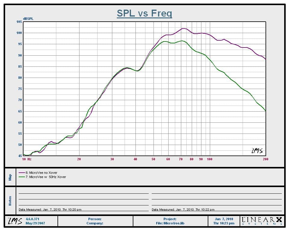

Velodyne MicroVee Nearfield Frequency Response
I measured the MicroVee at various output levels using the groundplane technique at 3 inches from the front driver. The output was scaled -19dB down to give the actual SPL output I could hear at my listening position which was roughly 4 feet away. The frequency response was pretty linear down to around 50Hz where it dropped around 15dB below 40Hz. Since the sub has multiple passive radiators, and the mic was in such close proximity, the roll-off was slightly accentuated so you could expect a bit more low frequency gain than is illustrated in this graph. I was impressed that this little sub was able to hit 105dB SPL levels from my listening position which is higher than I'd ever listen to my desktop system given the close proximity to the them. The MicroVee certainly has plenty of output for small office spaces.
Velodyne MicroVee Nearfield Frequency Response with Xover
Purple trace: no xover ; Green trace: xover @ 50Hz
Oddly with the internal crossover engaged on the MiniVee at 50Hz, the output dropped about 4dB above 50Hz, but the -3dB point was 80Hz. This explains why I preferred the lowest setting as this sub simply doesn't have a steep low pass filter employed and provides too much output above 80Hz unless the lowest crossover setting is used. Bass above 80Hz is highly directional, especially when sitting in close proximity to the sub which most users will be doing with a MicroVee. I suggest starting at the lowest crossover setting or using the bass management of your receiver or source device if they have such facility (most desktop systems won't).

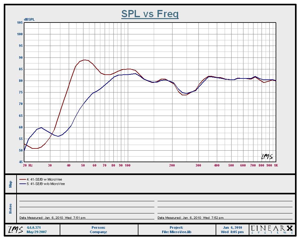

Combined Velodyne MicroVee + EMP 41-SE/B Frequency Response
1/3rd Octave Smoothed @ listening position
I measured the MicroVee in concert with one 41-SE/B speaker. The output of the sub was calibrated for both speakers playing thus why the level is about 3dB too hot in this measurement scenario. As you can see, the MicroVee extended the -3dB point of my desktop system from 60Hz to around 40Hz. With the MicroVee engaged for music listening, my desktop system sounds much fuller and tactile.
