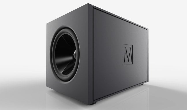

As a home theater enthusiast, you’ve likely always dreamed of owning the ultimate subwoofer—a subwoofer that once and for all redefines the term “visceral experience”. Well, one thing's for sure, when the folks over at Magico dream of the ultimate subwoofer, the sky's the limit! Magico, a name that is virtually synonymous with ultra high end speakers, has just announced their first subwoofer products: the QSub-18 and the QSub-15. And what a way to enter the subwoofer market.
The 550lb, 8,000 Watt Magico QSub-18
Forget everything you've thought about a subwoofer before and listen to these specs. The QSub-18 is said to be capable of delivering an incredible 136 dB SPL (sound pressure level) with less than 1% distortion at an earth-rattling 20Hz (it goes down to 15Hz in case you were wondering). Unfortunately, Magico hasn't identified how those measurements were made (i.e. measurement test signal, distortion, frequency, etc). Without knowing the details of the test, we would simply caution against accepting all the specs at face value.

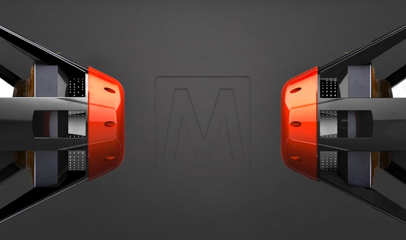

That incredible power drives two massive woofers (dual 18" with the QSub-18 and dual 15" with the QSub-15) which are both capable of 34mm of linear excursion. The dual woofers are mounted in 2" thick aluminum baffles and fire adversely in phase to cancel each other out, thereby eliminating driver-causing resonances. Magico boldly claims, "This is the way a subwoofer should be built." We tend to agree.

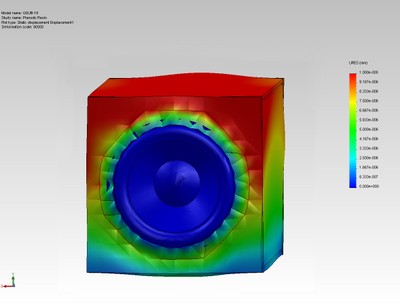

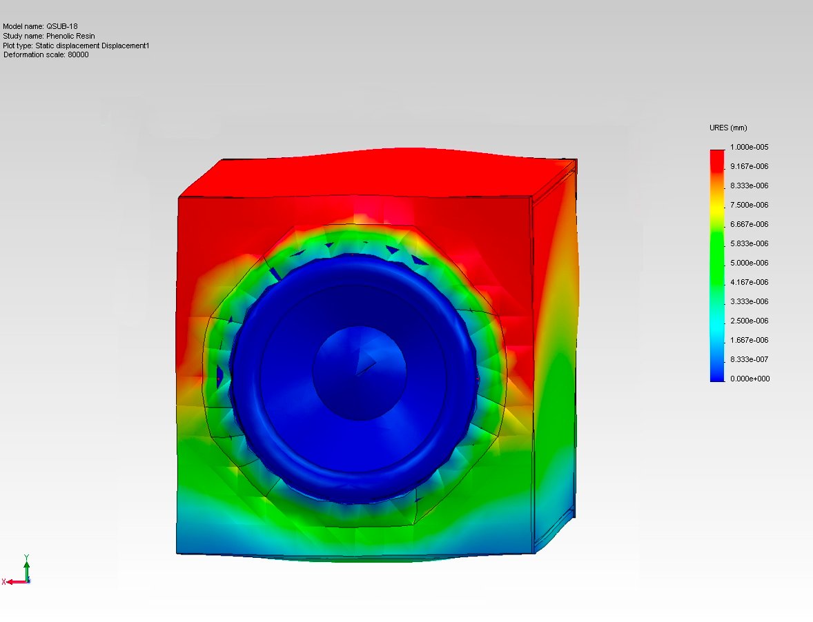

With the introduction of these subwoofers, Magico claims that they are tackling the biggest problem subs have in reproducing low frequencies: enclosure warping. Enclosure warping is where due to the enormous sound pressure buildup, the pliable walls of typical subwoofer enclosures absorb a tremendous portion of the energy generated by the drivers. This energy absorption consequently leads to distortion and massive group delay (smearing). Magico claims that the QSub can reach an internal sound pressure level of to 175dB - the equivalent of a commercial jet at takeoff - with less than 1% displacement of common enclosures.
FEA Study on Cabinet Flexing
