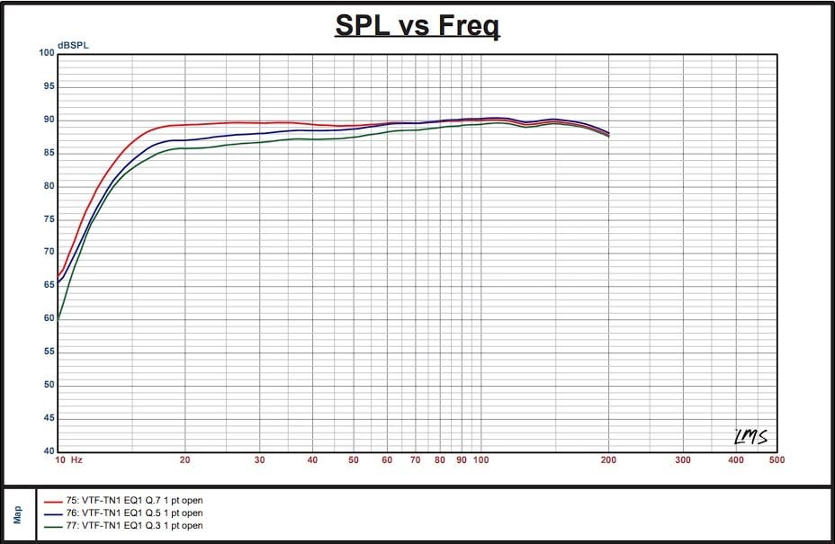

To be sure, the performance improvements aren’t likely to be a huge step up from the VTF-15h MKII. But where it does improve performance is significant: the VTF-TN1 aims for a lower tuning frequency than the VTF-15h MKII and should offer superior deep bass. That should enable it to tackle some serious deep bass since the VTF-15h MKII could be tuned to 22Hz in ‘Max output’ mode or 16Hz in ‘Max Extension’ mode. By comparison, the VTF-TN1 can be tuned to 18Hz in ‘Max Output’ mode and an astonishing 15Hz in ‘Max Extension’ mode. This is a noteworthy move in today’s subwoofer marketplace where other brands are giving up on sub-20Hz bass to focus more on easy gains above that point. The VTF-TN1 accomplishes this by moving away from the triangular ports of the VTF-15h MKII in favor of a pair of massively flared, 4” diameter cylindrical ports that should improve stability and output in the port-generated bandwidth. In fact, Hsu was able to record passing 12.5Hz bursts tests of the TN1 which wasn’t something they were able to achieve with the VTF-15h MKII.

VTF TN1 Single Port Response
