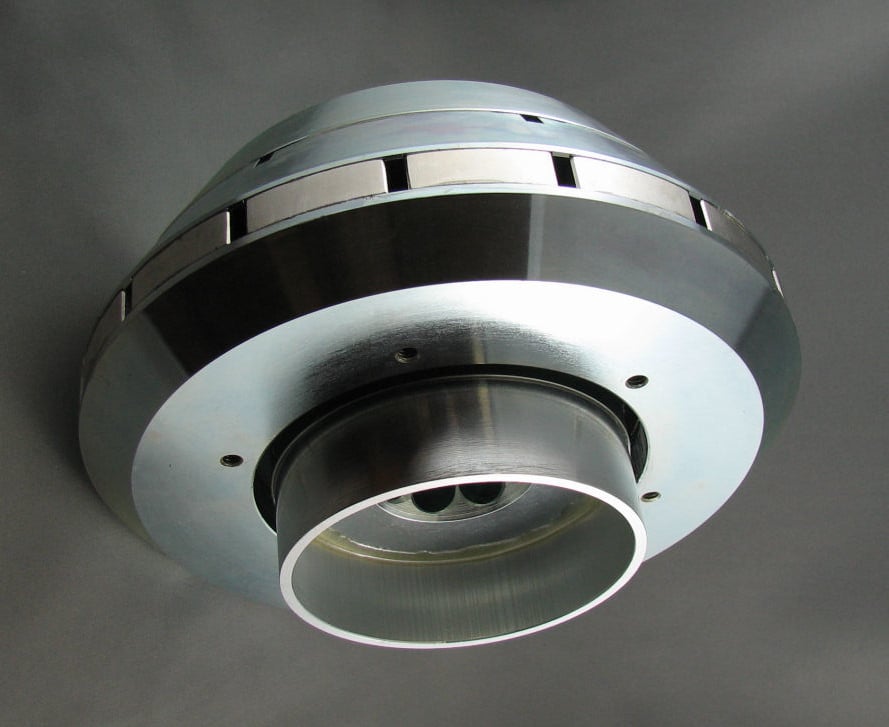

18.2 Motor
TSAD18V2 Motor Structure
The heart of this subwoofer is its incredibly powerful motor structure of the TSAD18V2 driver. The 18" driver for this sub is built in-house by Funk Audio.  Starting with a 4.5” aluminum voice coil surrounded by a 44lb FEA optimized Neodymium magnet structure, featuring a 9” diameter segmented Neodymium magnet ring, dual shorting rings, and a very specialized “forced air” cooling system allowing the voice coil to keep its cool even when fed with the “high power” amplifier option that sends an unprecedented 4800 watts RMS (9600 peak) to each of the two drivers.  The driver cone is constructed of a carbon fiber / paper composite with cast aluminum basket and anodized aluminum dust cap and is said to have a 3" pk-pk travel.  With a 10" diameter spider, forced air cooling and such a powerful motor structure, its obvious this is one bad ass driver ready to be fed some wattage.

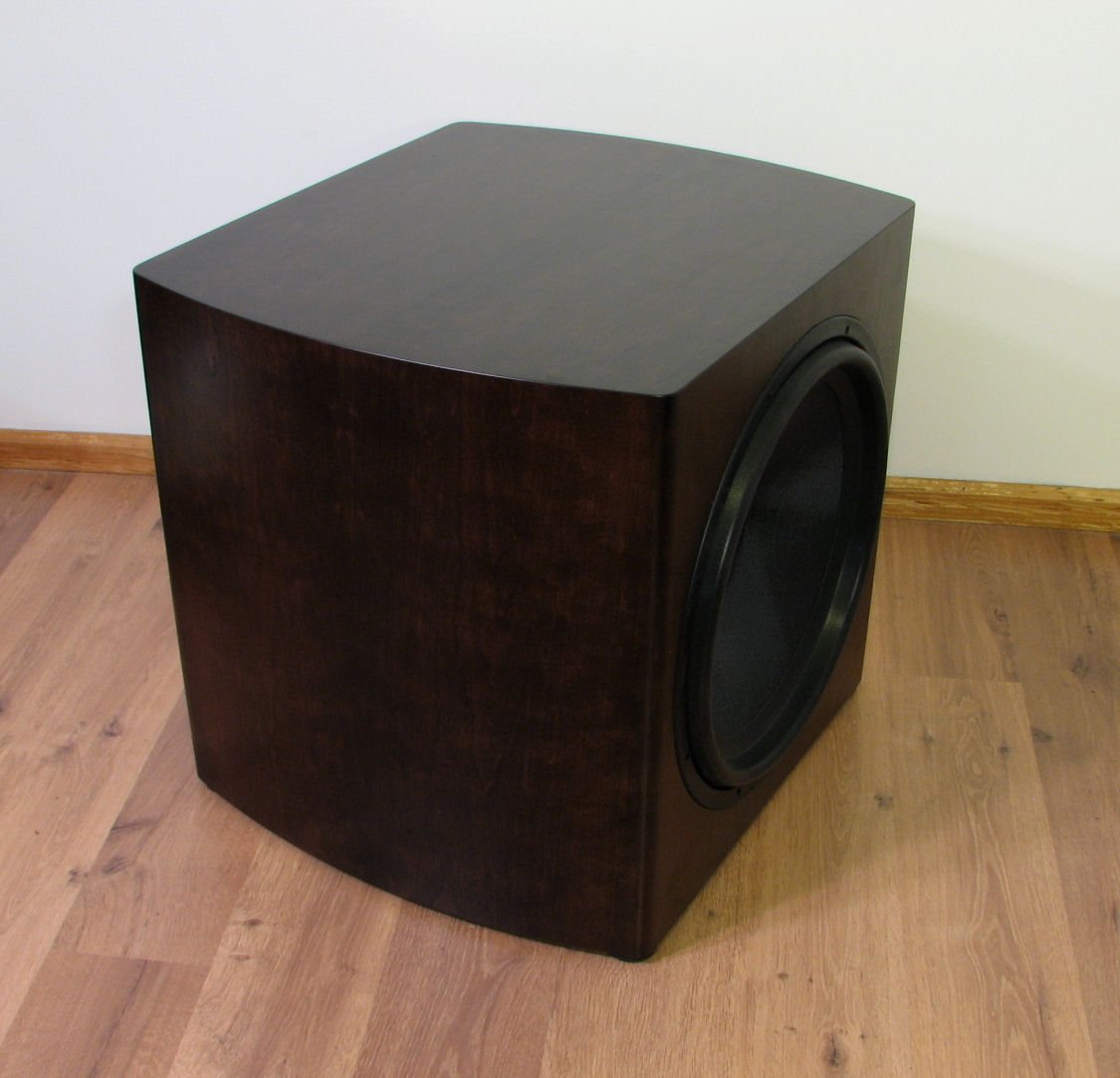

The 18.2 subwoofer is a dual opposed 18” design. The two TSAD18V2 drivers are contained in a very solid Baltic Birch plywood enclosure, featuring 1.5” thick baffles, top and bottom, curved laminated front and rear walls, and extensive bracing. All measuring in at 21” wide 22” high ans 24” deep, with a total weight, without amplification, of 175lbs.  This subwoofer is definitely a two person installation.
Power Up
The 18.2 subwoofer is available in two power levels; Power level One provides a single amplifier (17”wide 13” deep 4.5” high) producing 2400 watts RMS for each driver, for a total power of 4800 watts RMS (9600peak), Power Level Two provides dual amplifiers, one for each driver, producing 4800 watts RMS for each driver, for a total power of 9600 watts RMS (19,200 watts peak).  Power level two is said to enable the 18.2 sub to hit an ear drum busting 125dB peak output at 2 meters groundplane.  Funk Audio provided 2 meter CEA test date with distortion for the 18.2 sub with Power II amplification as you can see below.  You can rest assured that no matter what level you chose for this sub, it will surely make Grandpa Simpsons teeth explode and will probably loosen a few of your fillings too.
