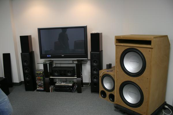

Honestly, this isn't a total redesign. If you took the current sub and stood it up (something it wasn't designed to do), you'd have the rough idea of what the new sub will look like. They've mitered some corners and moved the port so that it is front firing but the basic dimensions are the same. One thing that customers really harped on was that they like to see the drivers of their speakers. Even if they only rarely remove the grill, the fact that they can is a plus. Well, eD isn't going to disappoint with dual 18" drivers facing into the room!

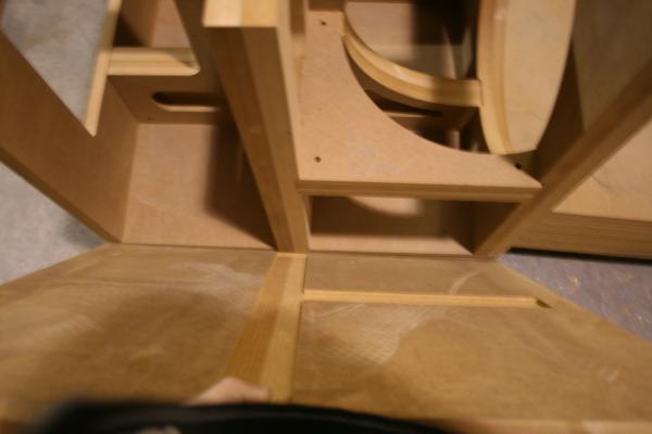

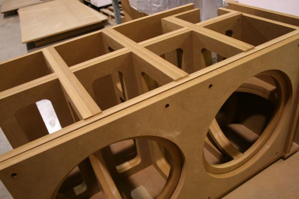

Heavy? Yes. According to eD they utilize their EFS material (denser than MDF) for the cabinets in 1"-2" thicknesses. Brett Bell of eD says about the A7-900, "EFS construction, made using 1-2 layers of 1" EFS through the entire cabinet.  All bracing is done in 2" thick pieces (dual layer 1" EFS) that interlock not only into each other but into the walls of the cabinet as well." When you look at the calculated weight of around 400lbs, you can see that they aren't kidding. While on the website they have listed spikes as the foot option, I'm guessing not. I'm also guessing you're going to want to be SURE of your subwoofer placement when you set this thing up.
A7-900-side-construct     a7-900_basebracing

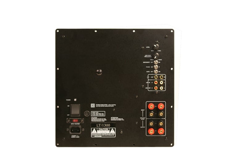

A7-900_ampThe amplifier is the same as the one in the original A7-900. Built for eD by Keiga and based upon an ICEPower module developed by Bang & Olufsen, this sub should have tons of power for all but the most demanding of environments. The amp has 50-100Hz variable crossover, dedicated crossover-defeating LFE input, and speaker level inputs. I was surprised at this price point to see only a 0/180 phase switch and not a variable control. I was also surprised that there wasn't an "always on" option (only off/auto on). ICEPower runs very efficiently and many of their amps don't even have a standby option. The 25Hz boost switch also seems a bit out of place in a sub that certainly looks like the last thing it'll need is more bass.

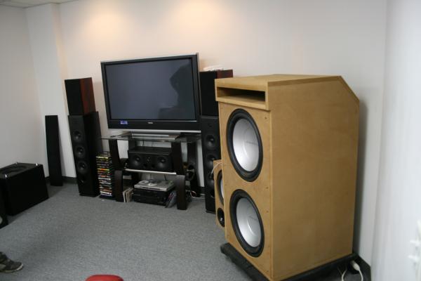

The new A7-900 will have a 26" by 27.25" footprint - certainly not large by Internet direct standards. It will, however, be over 49" tall! That essentially makes it a very large floorstanding speaker without the mids and tweets. Part of the redesign was to give the owner more flexibility. The new A7-900 can be positioned upright or lying on its side (under a projection screen for instance). The finish on the sub will be the same handcrafted rugged finish on all their new subs (matte black and textured). The in-room response is rated down to 16Hz at 110dB.
A7-900_inlisteningroomThe A7-900 is a HUGE sub. The weight alone is going to deter many people. Those who want big performance at a fraction of the price of some of the brick & mortar brands, this may be an option. You're going to need a fairly large room and probably a motion sickness bag as you're likely to be shaken out of your seat. We wouldn't be surprised to see warning labels accompany this sub to the tune of:
