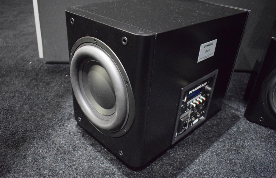

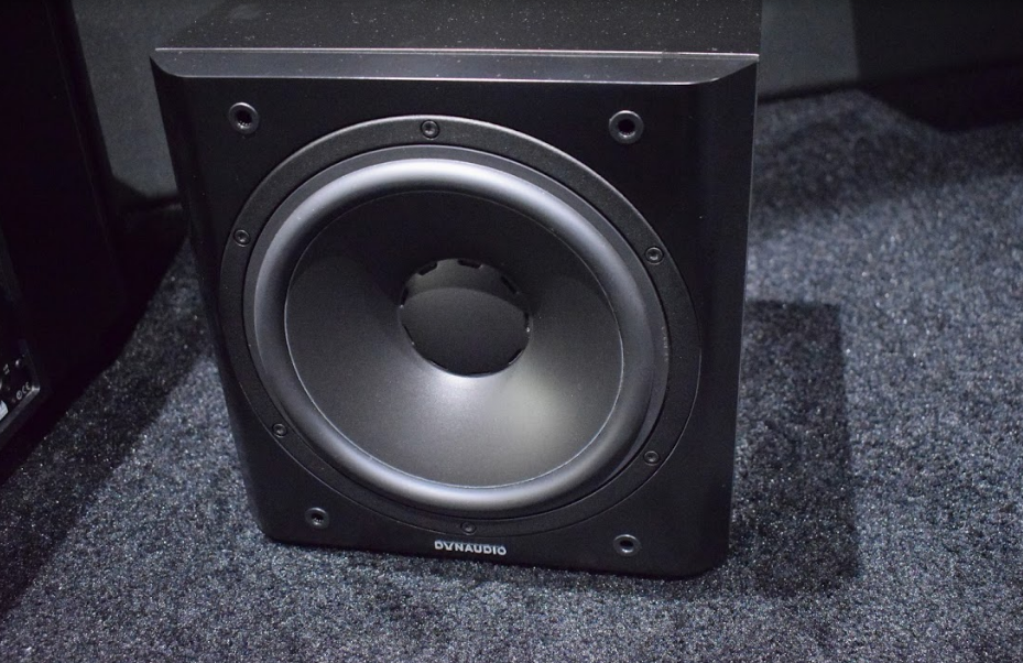

The Sub 3 is a flexible subwoofer that’s been designed to work just as well with movies as it does with music. Like the build quality of their other speakers, the Sub 3 should deliver weight, authority and punch for your low end needs. The Sub 3 is a fairly compact and convenient unit that should also take the strain off your stereo or multi-channel setup while also improving the midrange performance in the process. The Sub 3 has the same dimensions as the previous Dynaudio Sub 250, so it will be easy to accommodate, but their engineers have managed to squeeze in the more powerful 300W amp and full feature set of the larger Sub 600.
Other new additions include a double-thickness 1.5" front baffle (curved, similar to Contour) designed to increase rigidity, plus a brand-new 9.5" driver, which joins the rest of the Sub 3’s Contour-quality components.

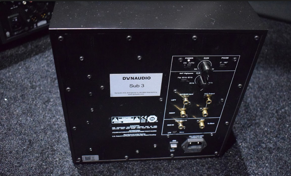

Dynaudio Sub 3 Backpanel
The Sub 3 comes with dual RCA inputs and outputs to let you pass a signal through the Sub 3 itself. You can also fine-tune the crossover point (flat, 60Hz or 80Hz) using the Sub 3’s high-pass filter to ensure the best performance possible. Dynaudio has worked really hard to get all the smarts of the Sub 600 into a body the size of the Sub 250, while also adding a brand-new driver. Most importantly, they've managed to get the price in between the two, which means you're now getting all the smarts of the Sub 600 for $1,000 less.

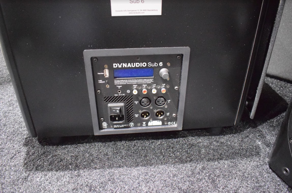

Although it can be used with other speakers, the Sub 6 is designed to easily integrate with Dynaudio speakers. And, for anything from the Contour range upwards (Contour, Confidence, Evidence, Special Forty, Special Twenty-Five), the Sub 6 features advanced intelligent DSP technology that tailors its performance so that it can turn a two-way speaker system in a three-way one. For other models, including non-Dynaudio speakers, the crossover frequency, gain, and phase can be set manually.
In charge of its powerful bass response are two brand-new 9.5" MSP+ Hybrid Drive units, designed specifically for subwoofers, alongside a 500W power amplifier built into its base. These new drivers sit at either end of the sealed enclosure design, which stands wider than it does deep to help it sit more discreetly against a wall.
Dynaudio Sub 6 Backpanel
The Sub 6 has dual RCA and XLR connections to suit most systems and comes with a number of handy features to help larger and more advanced setups. This includes the ability to set a time-delay to ensure the sub and speakers are working in sync with one another. All you have to do is enter the distance from the sub to the speakers and the sub will adjust itself automatically using both time and phase delays. There’s also a fully parametric EQ, including three filters to counter the effects of any room modes, to ensure the best possible performance.
