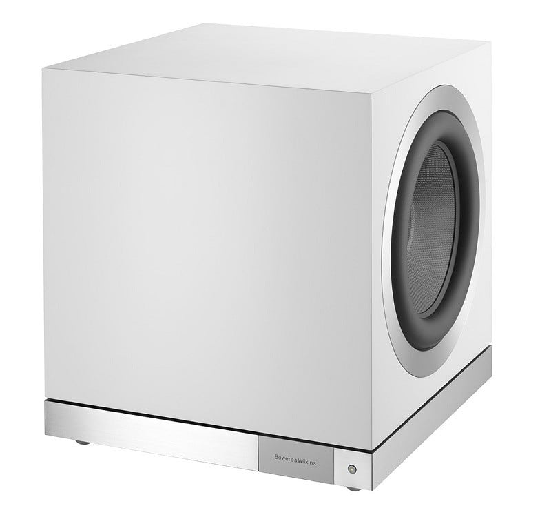

Bowers &
Wilkins has rec
ently expanded the high end of their subwoofer line by adding
three new subwoofers. These new subwoofers are called the DB1D, DB2D, and DB3D,
with woofer diameters of 12”, 10” and 8”, respectively. The venerable DB1 has
stood alone at the top of B&W’s echelon since its release six years ago,
but B&W has announced three new additions to the DB series. Like the DB1,
they use a dual-opposed woofer design, meaning that the woofers are mounted on
opposite sides of the cabinet. An advantage of this approach is the motion of
the woofers negate each other’s momentum effect on the enclosure, so the
cabinet should be completely free of any rocking motion. As one would expect
from B&W at this price point, the enclosure build is heavy-duty, with their
new dual 12” subwoofer weighing nearly 100 lbs, despite only being a roughly
17” cube. There are some advantages of placing two smaller drivers in a single
enclosure over a single larger driver such allowing a smaller cabinet to
accommodate more overall cone surface area. As an example, the two 12” cones of
the DB1D have nearly the same surface area of a single 17” cone. Two drivers
can also share a greater thermal load and can be less affected by thermal
compression than a single driver.

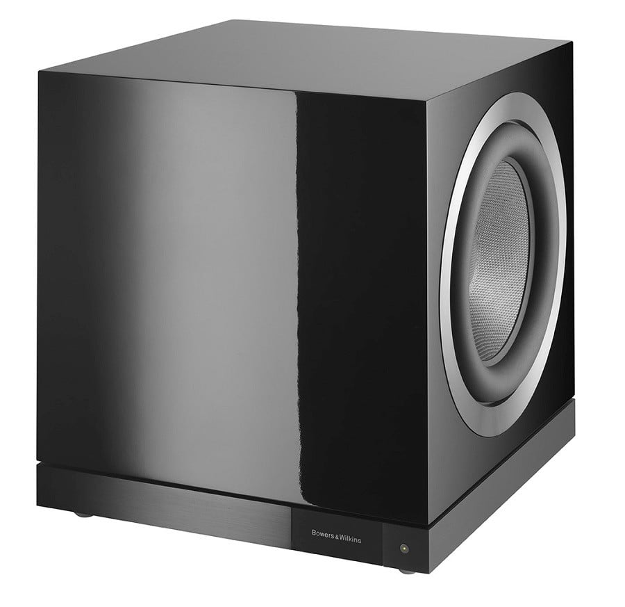

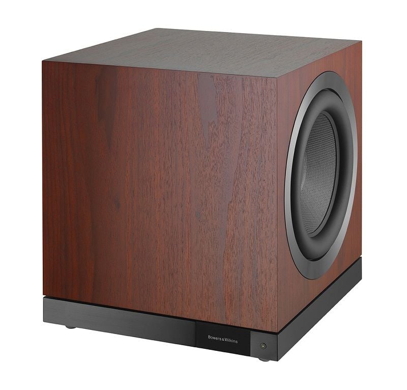

The
cabinetry and available finishes have not changed from the DB1 and as such look
impeccable. But don’t let the same-styled exterior fool you: underneath the
hood, much has changed from the DB1 design; specifically the driver designs. The
