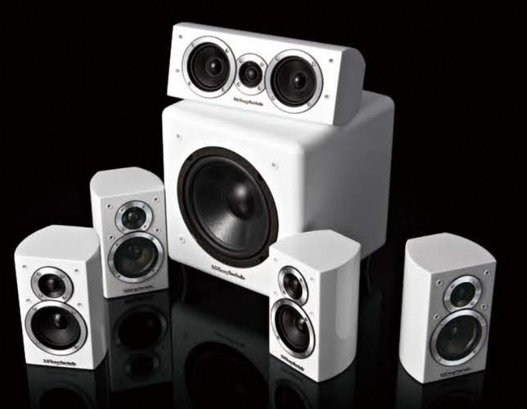

Wharfedale is name that is well known in audio circles. While your neophyte friend might not have heard of them, it won't take long on Google to figure out that they are a respected brand. Their new DX-1 has been released overseas for a while now so there is plenty of information on the set for them to research. The DX-1 features four identical satellites, a larger center, and a standalone subwoofer.

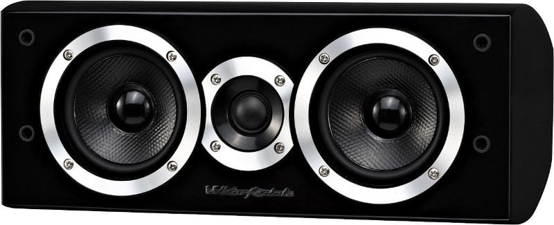

One thing we like to see in a HTiB system is a larger center. Since the vast majority of duties HTiB's perform is movies/TV, dialogue is of vital importance. The center includes two 3" polypropylene woofers and a .75" silk dome tweeter (the satellites have only a single woofer). The satellites are all wall mountable via keyhole mounts and have a sealed design for easy placement. They are small enough at 7.6" H x 4.9" W x 4.9" D to fit just about anywhere. The center is designed to sit on a shelf as there is no mention of wall mounting. All the speakers do, however, have rubber spikes to protect your surfaces.

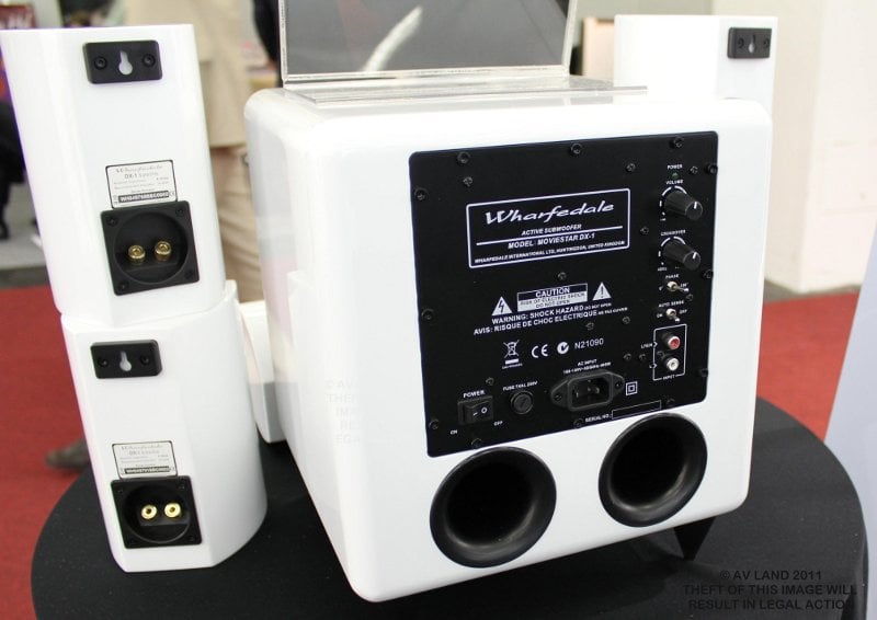

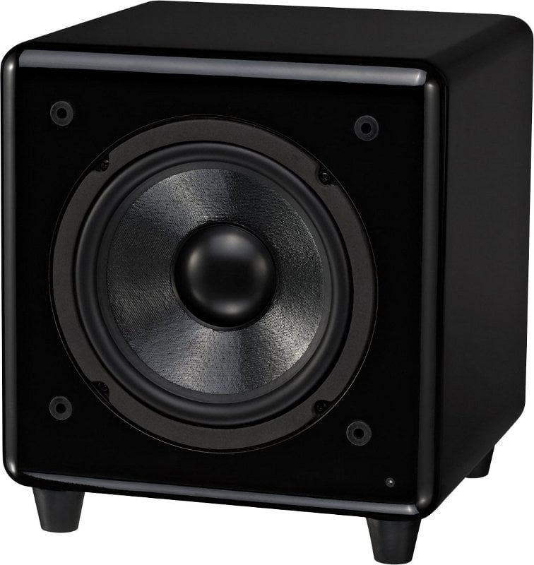

The included 150 watt subwoofer has a front-firing 8" long throw woofer with dual rear ports. We aren't a fan of rear ports on these types of subs (or speakers) as HTiB offerings often end up in non-optimal placements. There are knobs for volume and crossover (30-150Hz) and switches for phase (0-180) and auto sensing input. There are no speaker level inputs in the picture above but the press material lists that they will be available. We'll have to wait and see. There are both left and right RCA inputs (the right serves as the LFE input).
We were impressed to see screw-type gold-plated inputs on the satellites rather than the standard spring type. This will allow a much stronger connection that is much less likely to fail. The DX-1 system comes in either gloss white or black and is rated down to 40Hz (which is probably pretty accurate rather than the bloated specs we normally see). The only issue we see is that the satellites are only rated down to 120Hz while the center is rated down to 80Hz. The THX recommended crossover is 80Hz for most multi channel systems. In this case, you're probably going to be missing something as it is unlikely that either the satellites or center play flat down to their bottom spec. You'll want to closely experiment with the crossover frequency in the bass management of your receiver and likely set it higher than 80Hz. A good starting point would be around 100Hz and its a good idea to locate the sub towards the front of the room within reasonable proximity to the main front channels to minimize potential localization issues with using a higher crossover setting. Bass heads will want to opt for running two subs, one located near each front channel. This will allow the usage of an even higher crossover setting (120-150Hz) to get a better bass blend to the bass deficient satellite speakers.
