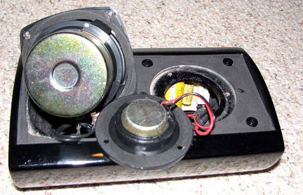

The drivers
of the TSAT-1000s utilize plastic baskets for the woofer which happens to be
properly magnetically shielded with a bucking magnet and encapsulated can. The
cone material is a doped aluminum with a butyl rubber surround. The tweeter utilizes a neodymium magnet
structure with a poly-cell dome reminiscent of the pre-Harman Infinity speakers
of the late 80s / early 90s. The crossover network was another big surprise to
me. Instead of using a cheap 1st order high pass filter with an
electrolytic cap in series with the tweeter like so many competitors do at much
higher asking prices, tSc put a lot of thought and high quality parts into the
crossover network of this system. This helps explain why the performance

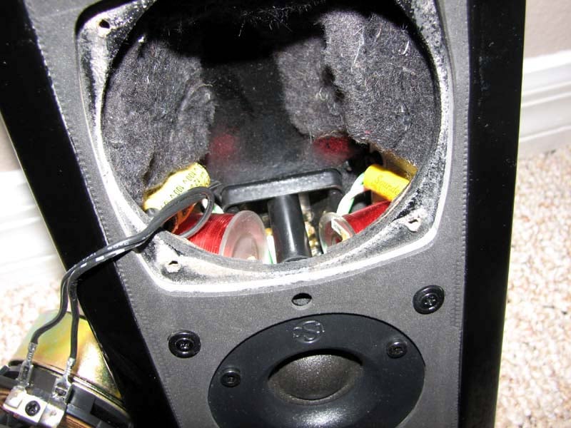

exceeded my expectations. Almost half
the cabinet is stuffed with high quality air core inductors, high grade
polypropylene audio capacitors and ceramic resistors. From what I could tell,
the TSAT-1000s employ 2nd order high pass filters on the woofer and
tweeter network. This cabinet is packed with quality parts and should make
buyers feel good about purchasing a quality engineered product that just
happens to be priced below the real market value.

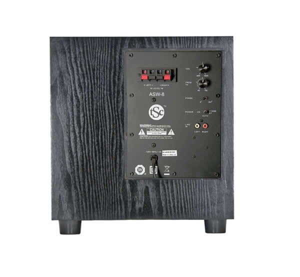

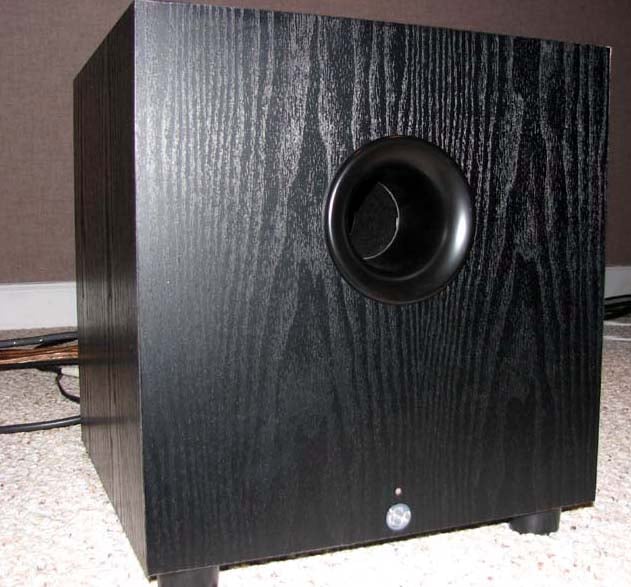

ASW-8 Subwoofer
The ASW-8
subwoofer is a neat little sub. It features a downfiring 8” driver in a front
firing vented enclosure. On paper, the 50watt BASH amplifier doesn’t sound too
impressive but keep in mind this amp has 6dB of headroom which means it can
pump out 200 watts under short term peaks. The ASW-8 sports two line level
inputs and speaker level inputs but no speaker level outputs. If you plan on connecting this system to a
receiver with no bass management facilities, you may want to consider stepping
up to an ASW-10 which has both speaker level inputs and outputs. Both models
have an auto on/off feature, variable low pass filter and 0/180 degree phase
switch.

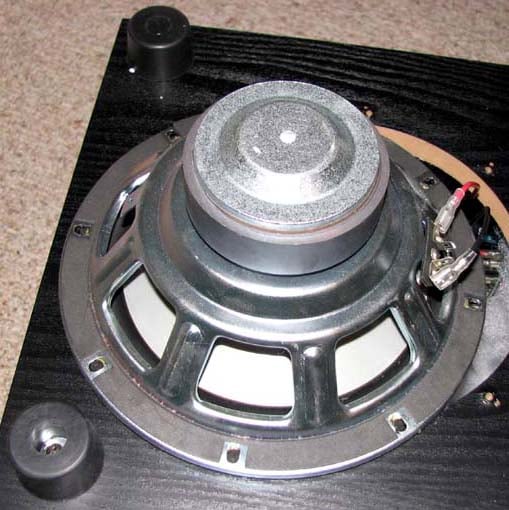

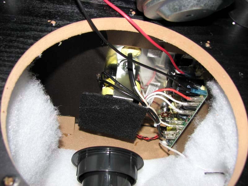

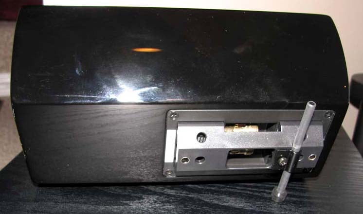

Getting inside the ASW-8, we see a nicely stuffed cabinet which appears to be molded from 5/8” thick MDF. The amplifier has a nice meaty power supply and the 8” driver with a 1” voice coil and 18oz magnet with a metallized stamped basket. The subwoofer is unshielded so keep that in mind if you plan on using this for a computer system. tSc claims the woofer uses a Santoprene surround featuring a ribbed shape to allow for a long travel without the woofer cone moving off center at either end of the stroke. The woofer cone seems to be a poly cone but has the appearance of an aluminum driver.
Editorial Note about Downfiring Subwoofers
Why use a downfiring bass driver like tSc does in their ASW-8? As you move further off the central axis, the ability of the speaker to radiate the sound diminishes. The rule of thumb often used is that when the wavelength (speed of sound divided by frequency) is about the same size as the circumference of the radiator, the speaker will begin to beam the sound towards the center axis, at the cost of off axis response. The directivity of the speaker increases. By placing a subwoofer facing the floor, one can gain advantage from this effect. The frequencies desired (low frequencies below 100hz), radiates omnidirectionally as desired, while the distortion products, that is to say frequencies 2, 3, 4, 5 or 6 times that of the fundamental driving frequency are going to be attenuated significantly by the inability of the speaker to radiate them at 90 degrees. These high frequencies simply go away, lost in your carpet, and your ears do not have to hear them.
The downside of this approach is a reduced life expectancy, as the constant pull of gravity will eventually wear against the suspension of the speaker, moving the voice coil off the desired center position, leaving the speakers ability to push as well as pull diminished.

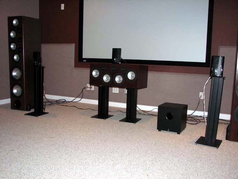

Since these speakers are designed to be mounted on a wall, all of my listening tests were conducted with them placed directly against a wall boundary. I tested them in two scenarios: as a 2.1 computer system in a nearfield listening position and as a 5.1 theater setup in my large theater room. On my PC, I had them connected to my Headroom Micro Dac and Preamp powered by a Panasonic SA-XR50 receiver while in my theater room I connected them up to my Denon AVR-5805mkii and DVD-5910CI DVD player. All cables were furnished by Impact Acoustics (Sonicwave TOSLink) and Bluejeans Cable (10AWG speaker cable and analog interconnects).

Multi Channel Listening - Large Home Theater Room
It was time
to move the tSC system into my theater room to gauge its performance as a full
fledged 5.1 system. I had low expectations for what this little system could do
in my nearly 6,000ft^3 theater room and I treated it more as a spot check to
ensure the system wouldn’t crap out at reasonably loud listening levels. I
placed the front speakers on 32” stands, the center channel on top of my RBH
Sound T-1/SER center channel and the rears on top of my chair riser elevated by
some disconnected bookshelf speakers. I had to place the rubber feet on all of
the speakers to keep them from moving during loud listening levels due to their
low weight, smooth cabinet surface, and ability to play louder than I expected.

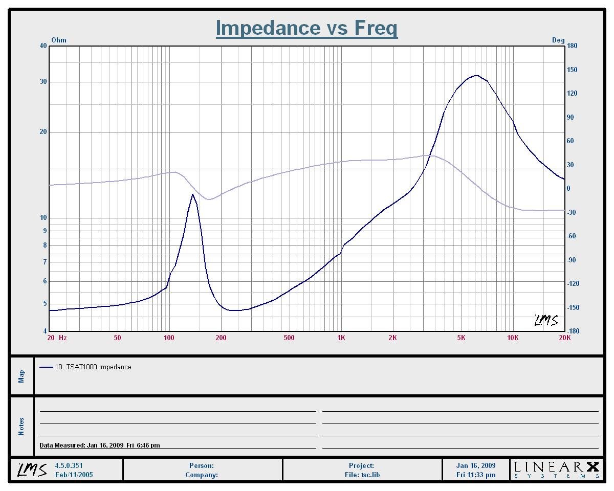

Impedance / Phase Measurements of the TSAT-1000
The TSAT-1000’s are rated as 8 ohm nominal speakers. I would consider them closer to 6 ohms due to the lowish sensitivity (85dB / 1 meter) and the impedance dip in the 200Hz to 500Hz range where spectrally there is a lot of musical content in that range that eats amplifier power. Phase is kept within +-30 deg throughout the entire audio band and the crossover design indicates some well thought out engineering. tSc did everything possible in eeking out the most bass response possible from such a small enclosure but due to their size there will always be compromises. Bass manage them and reward them with quality ample power if you plan on listening to them at loud sustained levels.

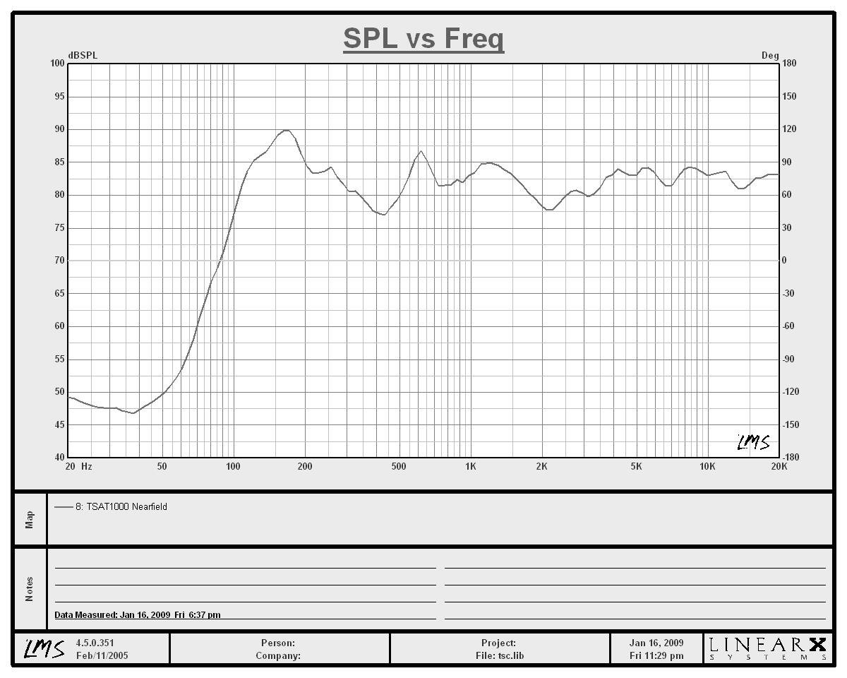

In Room Nearfield Frequency Response of the TSAT-1000 (1/12th octave smoothed)
The TSAT-1000 measured surprisingly linear - actually more so than far more expensive speakers that I’ve measured in the past. Usable bass response went down to about 100Hz but fell at a 30dB/Oct slope below that. I highly recommend crossing these speakers over at around 100-1200Hz and keeping the sub towards the front of the room somewhere between the main speakers to minimize localization and optimize integration with the satellites. The TSAT-1000s measured smoothest slightly below the axis of the tweeter so don’t worry about mounting these speakers above ear level as they will perform just fine.

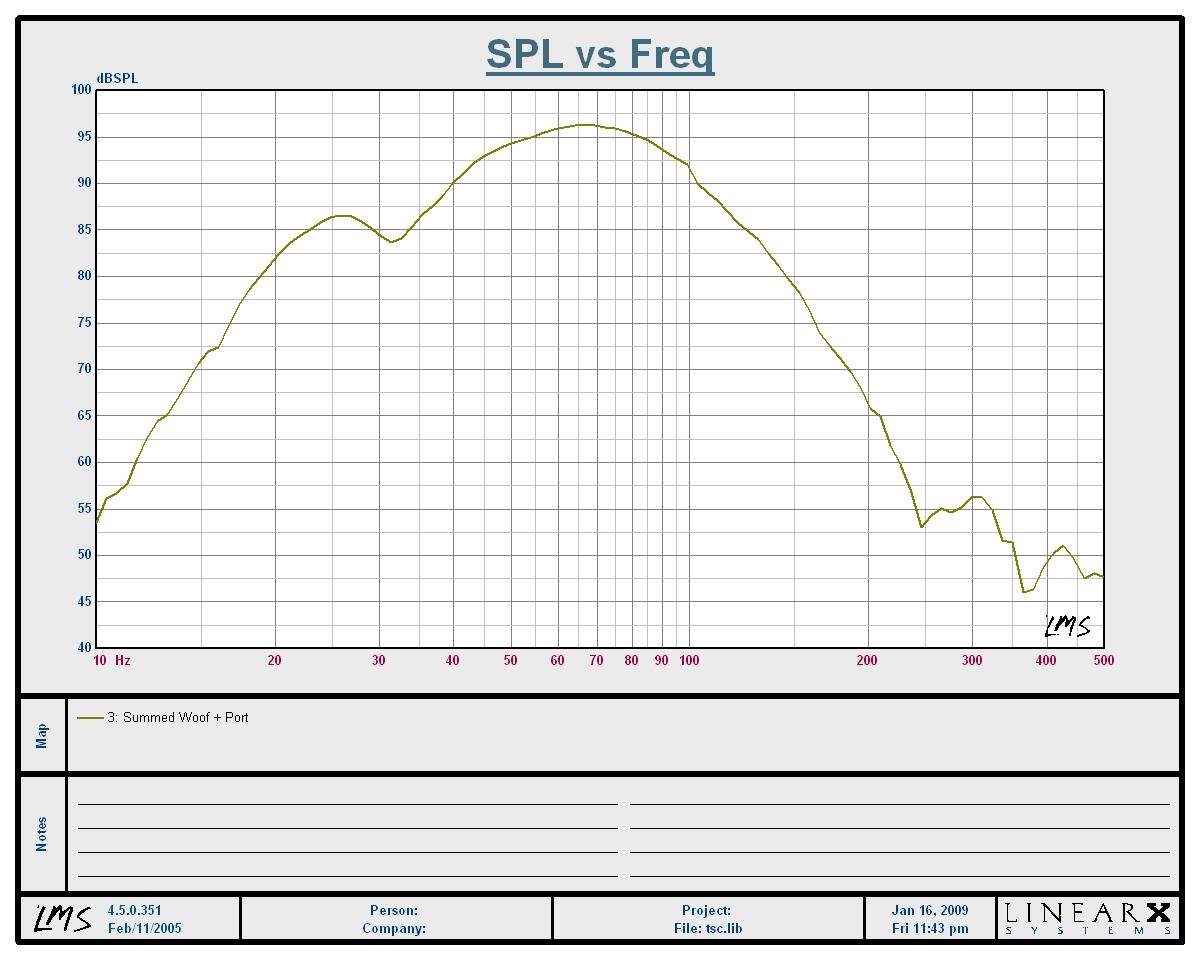

Summed Nearfield Frequency Response of the ASW-8
The ASW-8 exhibited impressive bass extension for such a small, lower powered / low cost design. The -3dB point was around the manufacturers claimed 33Hz. It has usable output to around 120Hz or so and then falls off rapidly. This response curve indicates a good match for the TSAT-1000s.

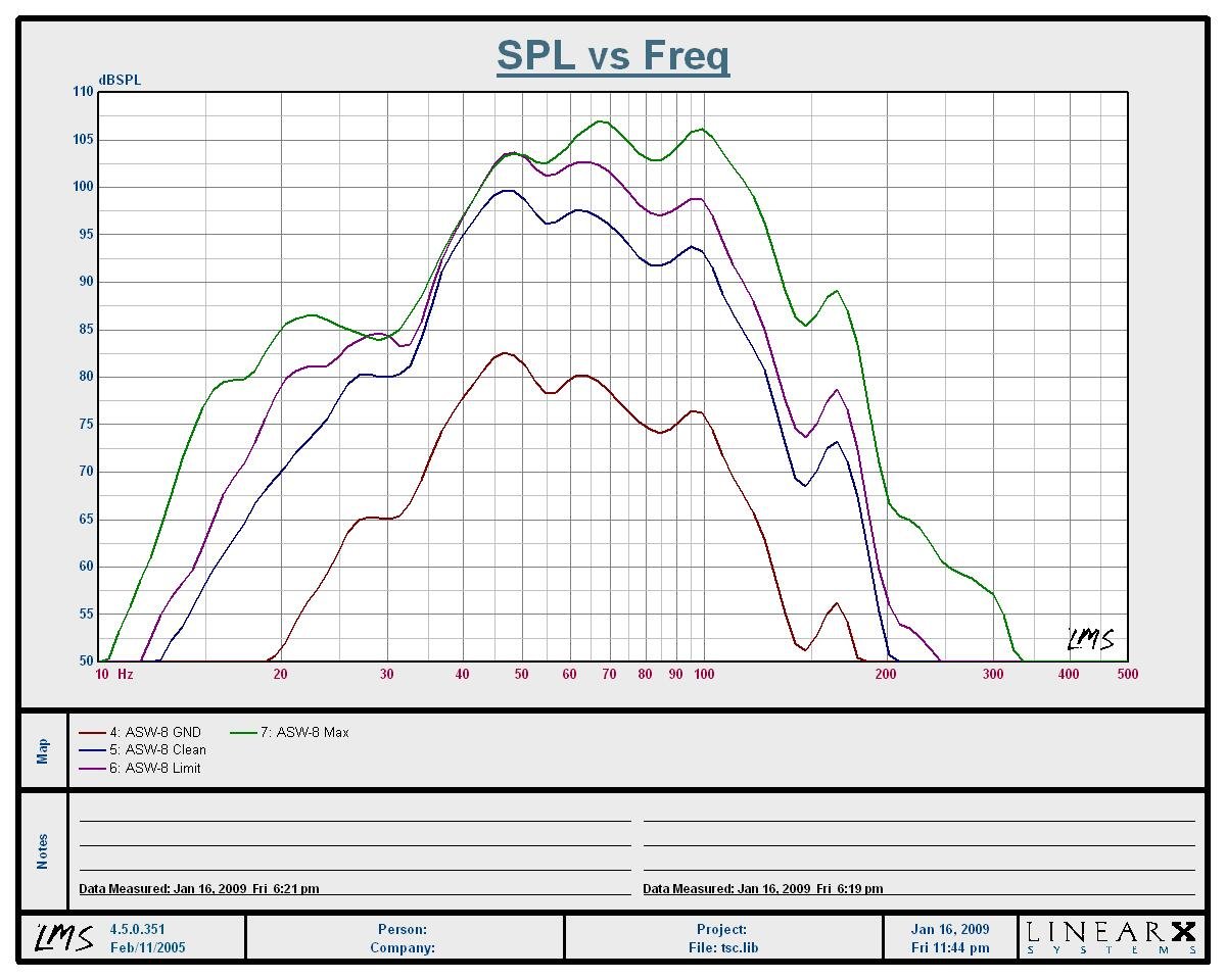

ASW-8 SPL vs Frequency (goundplane scaled from 20 inches to 2 meter)
Just for fun, I pulled some in-room groundplane measurements of the ASW-8 in my office. I put the measurement mic on the ground 20 inches from the ASW-8 and measured at various SPL points to find the max limit of the sub. The measurements were then scaled to 2 meter. The ASW-8 was able to cleanly deliver around 100dB SPL throughout its entire bandwidth. At this point the door in my office was rattling out of control and I felt like I was in one of those competition car stereo shows. As I drove the ASW-8 harder, I started to hear excessive port noise as you can see by the rising frequency below 25Hz in the 102 dB (purple) and 105 dB (green) SPL plots. All in all this is unbelievably juicy performance from something that costs less than a dinner at Bern’s Steakhouse.

The TSAT-1000’s work best when mounted slightly above
ear level. Don’t forget to route your speaker cable through the bracket before
installing it on the wall. If your using the bracket as a bookshelf stand, make
sure you attach the cable to the speaker before installing the clamp to the
back of the speaker as its nearly impossible to run your finger though the
little opening to connect the speaker wires or banana plug terminations once
the bracket is engaged. I really don’t
recommend using the bracket this way as it forces the speaker to be placed
horizontally which will sacrifice performance due to driver lobing issues
associated with placing a two-way speaker sideways. These speakers are small
enough to not have to make such a placement compromise. If you must place them
on a bookshelf, do so vertically but it’s imperative that you attach the rubber
sticky feet else the speakers will vibrate right off the surface if played
loudly enough.
As good as the ASW-8 is for the money, I’d suggest
getting two to really round out the bass which will provide a much fuller lower
mid bass impact and tactile response if placed up front near the main
satellites equidistantly from the listening area. I have little to complain
about with respect to performance and features on this subwoofer other than
being a bit puzzled why tSc provided discrete left and right line level inputs
instead of a single LFE input for an easier connection to the receivers
subwoofer output.

Although the ASW-8 is bland in styling, because of its smallish size, it doesn’t draw much attention to itself, at least until it's fired up. Make no mistake however that this little sub is much more capable than one would expect given its size and price. If I were on the market for a $300 subwoofer, I’d pocket $100 and buy two ASW-8s.
