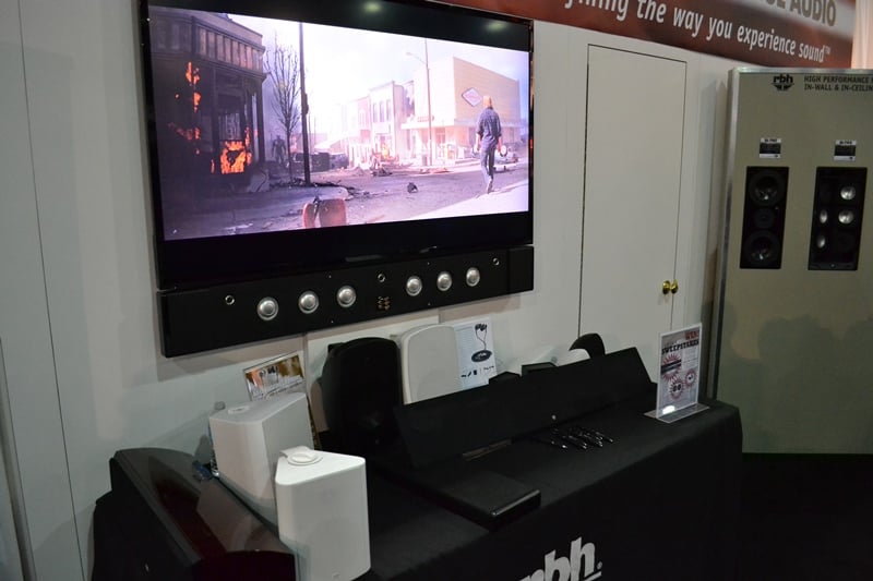

Ultra 3 grill off

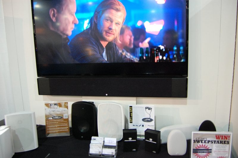

RBH Ultra-3 on display at CEDIA 2014
