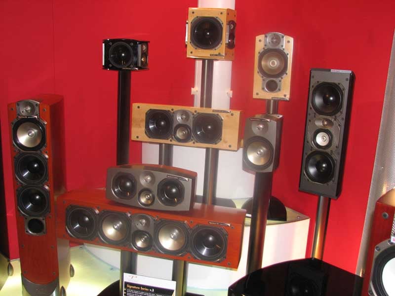

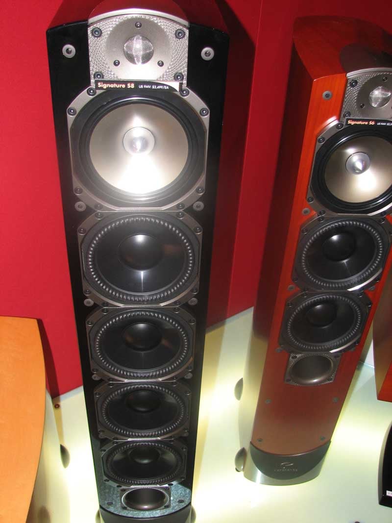

Paradigm  unveiled a 3rd version of its flagship Reference Signature Series which are claimed to be the highest output, most dynamic high end loudspeakers ever produced.  Contributing to v.3’s 50 percent increase in output (3dB more sensitive) are extensive modifications to the bass/midrange drive units. Signature v.3 bass/midrange drivers are fitted with extreme low-density NLC (Non-Limiting Corrugated) TPE surrounds, FEA*-optimized and overmolded onto the cone. Paradigm claims 10 times more effective than standard thermoplastic elastomers in damping vibrations and resonances and the new corrugated design has increased peak-to-peak cone excursion from 20-mm in earlier versions to a full 30-mm. A new long-stroke split-coil motor system takes advantage of the extreme excursion by doubling the linear portion of the stroke without requiring a larger magnet. The redesigned motor also keeps mass and inductance of the voice coil low for breathtaking midrange clarity.
Paradigm Reference Signature DriversBass cones on Signature v.3 speakers were re-engineered for increased stiffness and better equipped for higher output with new NLC™  Santoprene surrounds. To support the extended excursion, the motor structure was also redesigned, increasing the linear portion of the stroke through voice coils almost double the original in length. New core parts including a yoke and pole piece were retooled and FEA-optimized and even the magnets were thickened to accommodate double-distance cone travel.
Value-conscious audiophiles will appreciate the option of Paradigm Reference G-PAL(gold-plated pure-aluminum) dome tweeters on the compact S1, C1 and ADP1 models, making the Reference Signature experience even more attainable.
Upgrades to Signature v.3 Bass/Midrange and Bass Drive Units
  • Overmolded NLC non-limiting corrugated TPE (Santoprene for the bass
    drivers) surrounds
  • Redesigned Nomex Spiders
  • Redesigned die-cast aluminum heatsink chassis with AVS cooling
  • Advanced split-coil motor system (bass/midrange drivers)
  • Cutting-edge long-stroke motor system (bass drivers)
  • Thickened permanent ceramic (hard ferrite) magnets with focused-field geometry
  • Retooled magnetic pole piece and metal top plate (bass drivers)
  • Metallized high-integrity dust caps (bass/midrange drivers)
  • Injection-molded mineral-filled polypropylene bass cones boast a 30% increase in mineral content
The Signature v.3 lineup (prices shown are cherry finish, U.S. FMV):
  • S1 G-PAL– Two-driver 2-way compact bookshelf, G-PAL (gold-plated, pure-aluminum) domes - $599/ea
  • S1 P-Be - Two-driver 2-way compact bookshelf, P-Be (pure berrylium) domes - $799/ea
  • S2 – Two driver 2-way bookshelf - $1,299/ea
  • S6 – Four-driver 3-way floorstanding - $2,599/ea
  • S8 – Six-driver 3-way floorstanding - $3,499/ea
  • C1 G-PAL– Four-driver 3-way center, G-PAL (gold-plated pure-aluminum) domes - $1,099/ea
  • C1 P-Be- Four-driver 3-way center, P-Be (pure berrylium) domes - $1,299/ea
  • C3 – Four-driver 3-way center - $1,999/ea
  • C5 – Six-driver 3.5-way center - $3,499/ea
  • ADP1 G-PAL– Five-driver 3-way surround, G-PAL (gold-plated pure-aluminum) domes - $999/ea
  • ADP1 P-Be- Five-driver 3-way surround, P-Be (pure berrylium) domes - $1,299/ea
  • ADP3 – Five driver 3-way surround - $1,599/ea

Most of what Brian writes about the phase plug is spot on but there are some downsides too. B/C of the reduced surface area of the cone, you sacrifice a bit of efficiency at the lower frequencies. Also, phase plug drivers typically don't play as loud in that region and are more prone to bottoming out than a similar driver with a dust cap. As a midrange, they can work wonders in a 3 way system since the driver can play higher in frequency and blend better with the tweeter. They can also reduce off axis beaming which can improve imaging as well.
So the question remains is the driver in the v.3 a true phase plug or just a fancy dust cap? I emailed Paradigm for clarification.
