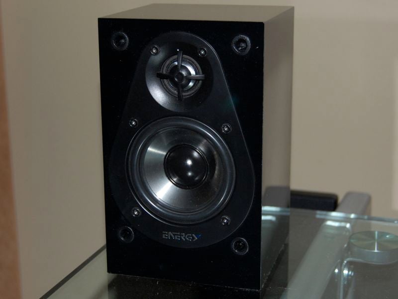

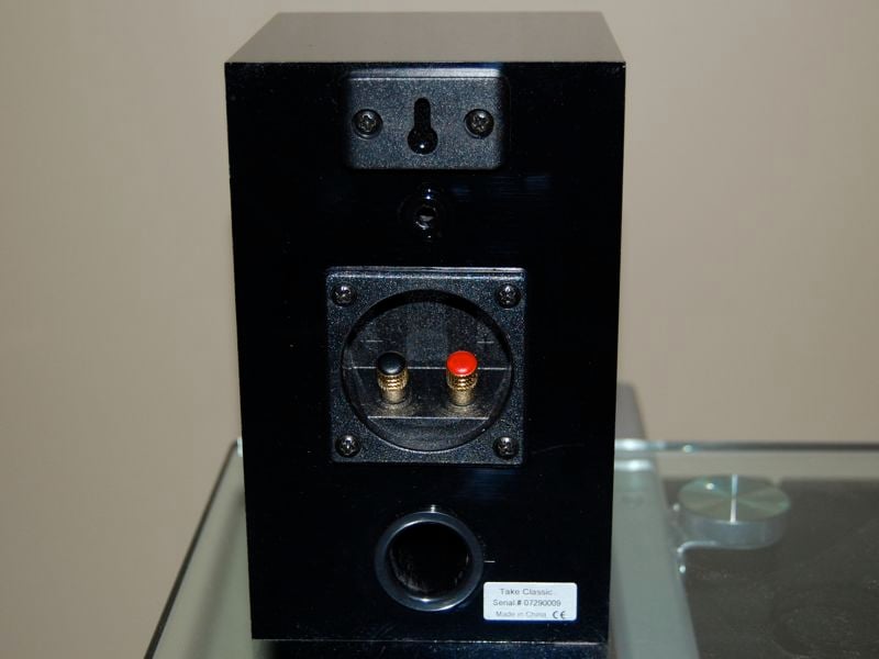

The four identical Take Classic Satellite speakers are small but well-built little guys that measure approximately 7" x 4" x 4" and weigh about three pounds. Each contains a 3" poly-titanium woofer and a 3/4" Hyperbolic aluminum-dome tweeter. They are a rear-ported design, and are housed in a high-gloss black finish that is pretty sexy. They have a very sturdy cloth grill that has a slight curve at the top that extends above the top of the speaker, adding a touch of style to an otherwise typically boxy speaker. On the rear there is a keyhole-style hanger and a threaded insert for wall-mounting, and a set of what I thought at first glance were sturdy push-pin speaker cable connectors, which I have been critical of in the past. But upon closer inspection, I found that they are miniature 5-way binding posts.
I am noticing a trend now
of higher quality push-pins or mini 5-way connectors from some
respectable manufacturers such as on this system from Energy. Earlier
this year I reviewed a set of satellite speakers from NHT, and they had
very heavy-duty push pins that were actually pretty cool. Energy has decided to go with a mini 5-way. Considering the system and its probable
use, they seem adequate, although if you are running anything thicker
than 14 gauge wire you will have problems. I guess the jury is still
out on these "mini-me" binding posts.

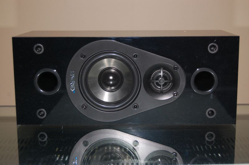

The Take Classic Center channel speaker is very similar to the Satellites. Utilizing the same tweeter and woofer combo (oriented horizontally), this speaker has dual front ports and is a bit larger, measuring in at approximately 10" x 4" x 4" and weighing a few ounces more. It shares the same high gloss black finish and high-quality black cloth grill. Both the satellites and center can handle up to 100 watts of power, and have an efficiency rating of 89 db.

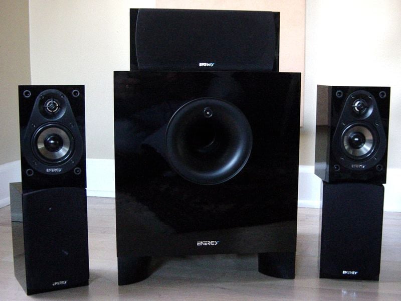

The ESW-8 subwoofer is a relatively small
(about 13") cube, with built-in feet. The box is also high-gloss
black, matching the speakers, and has a front-firing port, but no
grill. There is a tiny blue light just above the port to let you know
it is powered up. This little powerhouse contains a downward firing 8"
woofer with a patented Ribbed Elliptical Surround. The sub is powered
by a 200 watt amp and has a frequency response of 33-150Hz +/- 3dB. It
weighs in at about 20 pounds.

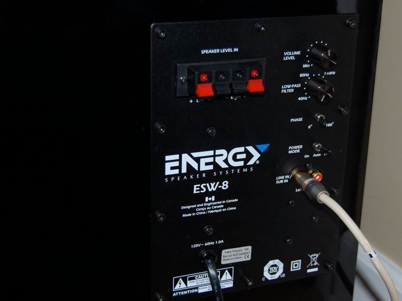

On the rear you will find both speaker level (push pin) inputs, as well as left and right line/sub inputs (RCA connectors). There is a selectable power switch (on/off/auto) and a phase switch. The crossover is variable from 40-150Hz, and there is a volume level. Setup was simple, and I had it dialed in very quickly with pleasing results.
