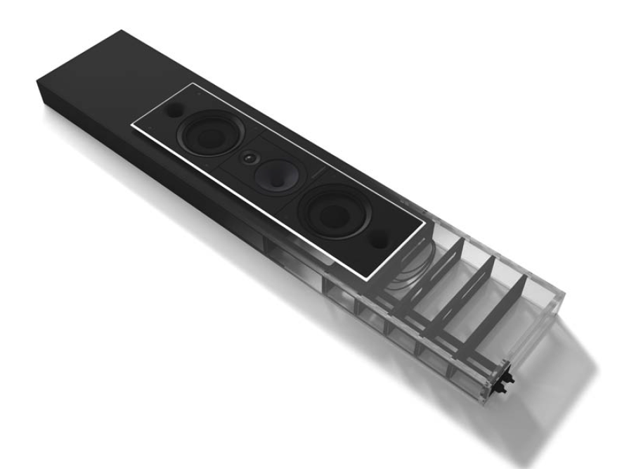

CWM8.3
  • Description: 3-way in-wall loudspeaker
  • Drive units: 1x 25mm (1in) Aluminium Carbon Braced Tweeter with Nautilus Tube™
  •                   1x 130mm (5in) woven blue Kevlar cone FST midrange driver
  •                   2 x 180mm (7in) Carbon Fibre Rohacell Bass drivers
  • Frequency range: 30Hz - 40kHz
  • Power handling: 200W
  • Sensitivity   : 89dB
  • Impedance : 8Ω (minimum 5Ω)
  • Frame outer: 880mm x 254mm (34.6 in x 10in)
  • Cut-out: 240mm x 240mm (9.4 in x 9.4in)
  • Cut-out allowance: 8mm (0.31in)
  • Protrusion: 8mm (0.31in)
  • Back box: 1328mm x 350mm 90mm (52.28 in x 13.78 in x 3.54in)

B&W CWM 8.3
B&W CWM 8.3
In order to overcome the space limitations of in-wall/in-ceiling speakers, B&W designed large back boxes/enclosures for each speaker. The enclosures are designed using Matrix bracing technology and are made of highly glass-filled thermoset resin for added rigidity. The enclosure must be purchased separately for with each speaker, as they can be installed with or without it. If possible, it is best to use the enclosure but they are so large that they have to be installed before the wall is finished. If the CWM 8.5 or 8.3 are being installed horizontally, the studs will need to be modified to accommodate the enclosure. For existing walls or retrofit installations, the speakers can be installed without an enclosure.

The CWM8.5 sports a single 1” tweeter and 7” woofer, is rated down to 35Hz and has a power handling of 120W. The CWM 8.3 sports one 1” tweet, one 5” midrange driver, and two 7” bass drivers, is rated down to 30Hz and has a power handling of 200W. The bass drivers in the CWM 8.3 are made of carbon-reinforced Rohacell, as found on the 800 Series Diamond. Both speakers have an 89db sensitivity. All of the CI800 speakers have an 8Ω (minimum 5Ω) impedance.
