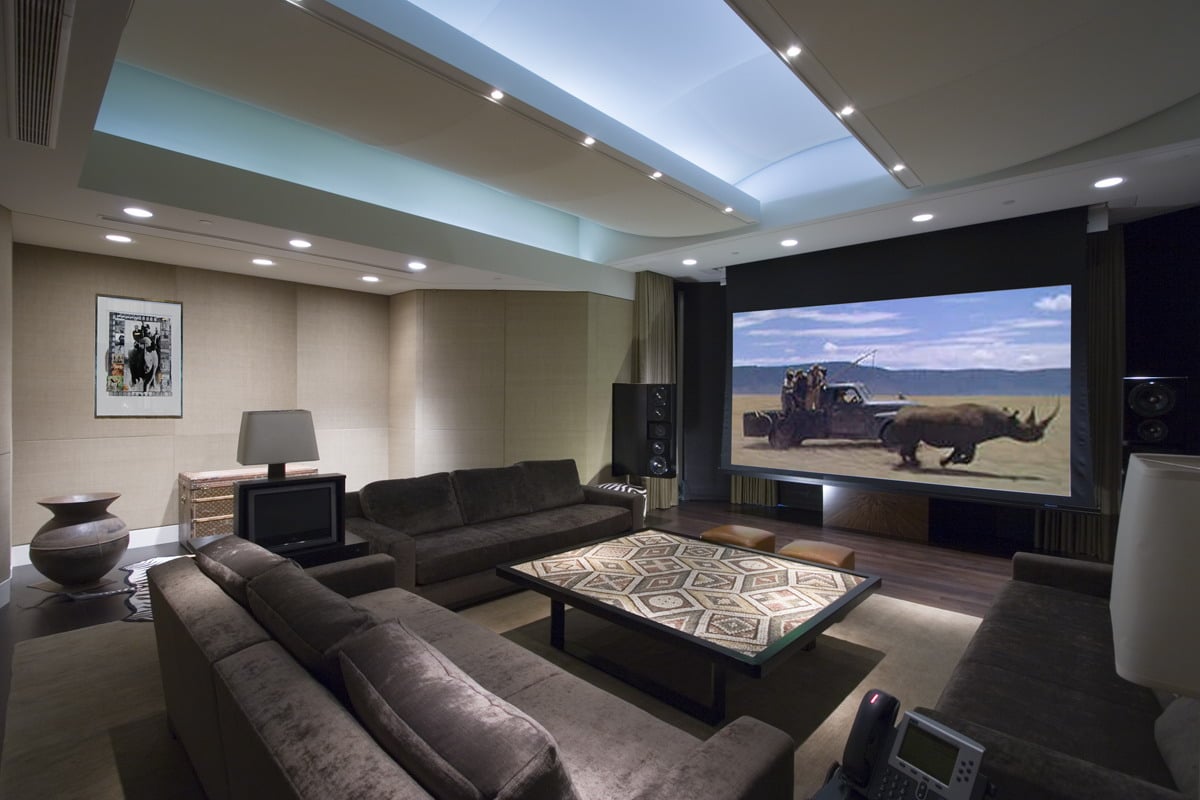

Russ Berger of RBDG
Russ Berger of RBDG is one of the leading media facility designers in the world. Russ has developed many of the most commonly applied design/build practices for professional audio and residential audio spaces. If you are unfamiliar with Russ Berger, it is worth your time to browse www.RBDG.com. Russ has a great “heart” for audio and excellence.

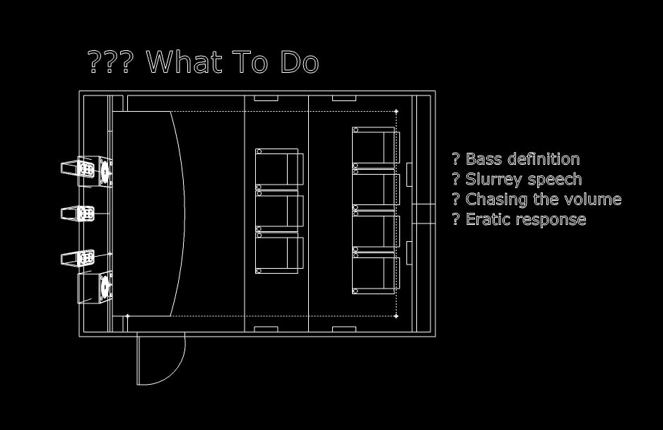

Here are Russ’s comments:RBDG-RhinoTheaterPic.jpg
I am of the firm opinion that electronic measures cannot correct the majority of acoustical problems or address the challenges we face in the design of small room acoustics. We cannot electronically “fix” the results of inappropriate room dimensions, a lack of appropriate volume for the listening space, inadequate distance from source and boundaries, room mode anomalies, resonances related to room volume, poor source and listener placement, HVAC (Heating Ventilating & Air Conditioning) noise, inadequate sound transmission loss, acoustically driven mechanical buzzes and panel resonances, poor finish choices, inappropriate spectral decay time, etc…the list goes on.
That being said, there are many things that modern electronic techniques can do to make a good system sound even better, when the room's acoustical issues have first been properly addressed. We have been involved with electronic architecture from its very beginnings, incorporating it into our design work where appropriate. However, one must be careful to avoid the pitfalls of misguided and sometimes unscrupulous salespeople who would have you apply expensive electronic Band-Aids and perfume, trading one set of problems for another, only to mask an acoustical problem that should rightly be corrected via non-electronic means.
So, in planning an accurate and enjoyable listening and viewing environment there isn't one single area in the design process that is unimportant. Every material is an acoustical material and, for better or worse, the room and speakers act together as a system. The thing to remember in applying solutions is to keep a balanced approach (beware that “when the only tool you have is a hammer, every problem may begin to look like a nail”), manage the process (success is found in getting the details right), and above all listen (don’t be confused by what your are “supposed” to hear, trust your own ears).
Most of our clients are interested in the results, in achieving a reliable experience, not so much in understanding the actual process of designing, documenting, and constructing a theater. However, some clients really enjoy having a look under the hood. The avid audio/theater-phile is usually very engaged with the latest equipment and accessories, but significantly less so with regard to the acoustics, architecture, and interior design of these critical listening/viewing environments.
When we have the opportunity to work with a hobbyist that wants to get his hands dirty and be engaged in the design process, we love that, but to provide this educational service it usually costs a bit more and the process takes a little longer...like the old joke about design fees: it costs more if you watch and double that if you help. For those clients who express interest, we give them open sesame into our design protocol and include and immerse them in the process.
The wisdom and depth of understanding acquired through a lifetime's career experience of designing theaters, screening rooms, record studios, and broadcast facilities cannot be adequately communicated through an article filled with simplistic “cookbook” solutions on the subject. The best way to learn about these things is to hire someone who knows what they are doing and work through the design process with them. While I love sharing what I know and frequently lecture at universities and professional organizations around the world, I’m oftentimes pained to share in 10 minutes what took me 10 years of research and experimentation to uncover.
Acoustical design is part art and part science. It’s an applied science that deals with personal perception. So, if you don’t otherwise mind rebuilding your room a few times, then have fun experimenting, reinventing the wheel, and slogging through myth, in search of acoustical truths.

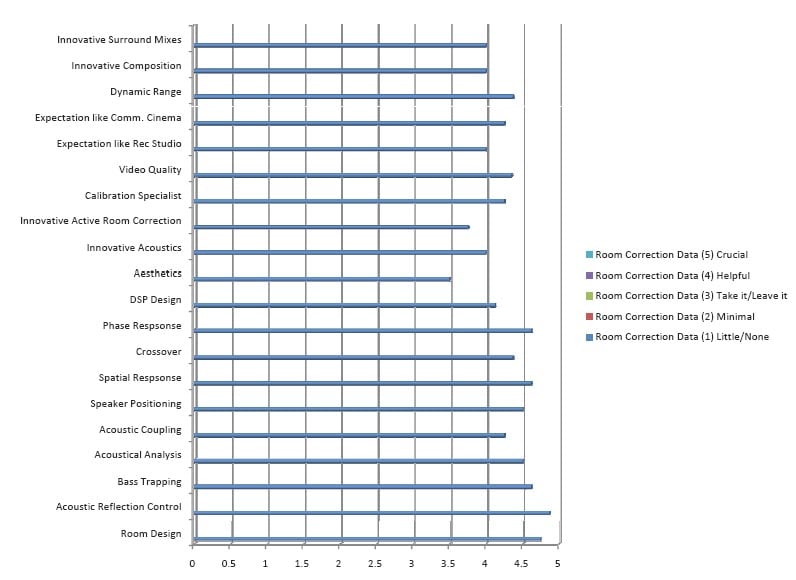

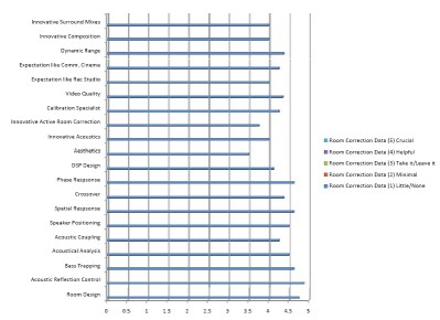

Jeff, Here are you answers!
Responder: Russ Miller Answer ranking 1 - 5
1. Room design including sound isolation, room dimensions, and surface finishes? 5
2. Use of acoustical reflection control devices such as absorption and diffusion panels? 5
3. Use of acoustical low frequency control devices either passive or tuned? 5
4. Acoustical measurements of the room actual or predicted? 3
5. Acoustical coupling of speakers to surfaces, i.e mounting options (stands, in-wall, shelves, etc.)? 3
6. Speaker positioning? 4
7. Spatial response, meaning how the room responds at various positions not just a single location. 4
8. Crossover adjustments. 5
9. Phase response of speakers including subwoofer(s). 5
10. DSP design: number of filter points, measurement points, etc… 5
11. Aesthetics including surface finishes, furnishings and lighting? 4
12. Consumer demand for innovative acoustical treatment products? 4
13. Consumer demand for innovative active room correction products? 4
14. Use of specially trained room calibration specialists? 4
15. Video Quality? 5
16. End user expectation is similar to control room environment? 5
17. End user expectation is similar to a commercial cinema? 4
18. Dynamic range of content 5
19. Changes in musical composition and sound effect elements in relation to the advances in residential theaters? 5
20. Changes in surround mix techniques due to advances in residential theaters? 5

Responder: Gavin Haverstick from Auralex Answer ranking 1 - 5

Responder: Bryan Pape from GIK Acoustics Answer ranking 1 - 5

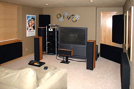

GIK Pic.jpgProper room construction and isolation techniques are largely ignored. People do not realize that it is as or more important (from a performance perspective) to keep sound OUT of the listening environment than it is to avoid bothering other people in other parts of the home. Having a quiet environment with a low noise floor yields a ‘free’ potential dynamic range increase from an identical system. If the system will do 100db and the ambient noise level is 55db – the best I can expect is 45 db. If I can drop the ambient noise level to 35db, then the same system can be expected to have an overall dynamic resolution of 65 db.
Also, improper fixtures and furnishings can cause issues: track lighting can buzz and rattle, a nice hard coffee table between the listener and the speakers can cause reflection issues, etc.
Many people also only concentrate on frequency response-related issues. Frequency response is only a small portion of getting a room right. Impulse responses and decay time control are just as important if not more so for proper dialog intelligibility, deep tight punchy bass, and proper imaging.
Room dimensions are another area that is largely misunderstood. There are NO perfect dimensions. All one can do is to avoid particularly bad combinations. ALL rooms will have modal issues. Identify how the room will be used and how many seats you want (be realistic here and avoid seats by walls, etc., that will NEVER sound good no matter what you do.) From there, one can identify appropriate locations, proper screen size, dimensions with the fewest issues that will allow all of the above. All else equal, I’ll take more space every time. When I design a room, the seating locations come first and don’t change. Seating location drives everything else.
Lastly, in my opinion, to properly deal with most rooms, a combination of passive (treatments) and active (parametric EQ) solutions are required for best overall performance. If one spends the time to get the best frequency response possible simply by adjusting speaker, sub, and listener locations, they are well on their way to a good solution. Treatments can then be used where applicable and overall for reflection control and decay time control, which EQ cannot do. The trick is to also identify which responses are best.
For instance, if I have a choice between 2 response curves that are similar but 1 has 3 peaks that are all similar for all seats vs one that has dissimilar peaks or large nulls, I’ll take the one with the similar peaks. This allows passive treatment to be used for general decay control and the EQ as the finishing touch to tame the peaks (tough to EQ out nulls if not impossible).
Also, one needs to identify what is causing the response aberrations. Is it a null off the rear wall where corner treatments will not help? Is it due to the typical 70ish Hz hump from seating in an 8’ high room? Is it something that can be corrected by tweaking crossover spacing between sub and mains? Can we play with phase to ‘lie to it’ a little bit to get rid of a hump in the crossover region? Again, I’ll take the one that is easily dealt with in terms of the particular room I’m working on. For instance, if the room has issues off the back wall but the back wall is open to a kitchen so I can’t treat it, then I don’t want to deal with that set of curves – because I can’t fix it…

Repsonder: David Frangioni Answer ranking 1 - 5

This is an exciting dynamic era in audio presentation. There are more effective options in terms of getting a tremendous experience than ever before. Still, one must search to define what a correct room is. We are 30 years past the proof that you cannot EQ a reflection yet technology is just now offering solutions in active room correction to deal with the complex spatial aspects of sound in a room. Active Room Correction is coming of age with many manufacturers offering options (including Audyssey and Trinnov). Speaker and Receiver manufacturers are jumping on board and licensing ARC technologies to offer with their products. Meanwhile, acoustical treatment materials are readily available. There is more application knowledge than ever before regarding acoustics. RPG Acoustics (not mentioned above) is a creative product design force with tremendous room solutions, Auralex and GIK Acoustics are caring manufactures who want your space to perform at the highest levels, and there are many others offering a variety of types of materials/finishes/price points.
When the answers to the questions are compiled, one can quickly note that the items a “lay-person” may desire most in a home theater are inversely rated to the experts. Aesthetics are key because who wants an uninspiring room. However, a correct room is not directly related to how the room looks. Now in terms of the experience a room that is comfortable, visually appealing and has superior video can offer a fantastic theater experience…the psychoacoustic intangibles can help offset audio issues.
On the cautionary side, expect a growing onslaught of marketing spin on this topic from all sides. As more speaker and receiver manufactures embrace and offer ARC, the message that you can correct all room issues digitally will be loud. It certainly is easier to get wife approval on a black box than “bulky” things on the walls. Please understand that as great as the advances are in ARC, you have to put all results into perspective. I’ll restate there is no definitive “correct” room, only rooms where the compromises are known and addressed appropriately.
On a personal level, I greatly appreciate the input of all the participants. These pros offer tremendous insight. Don’t be fooled by the brevity of some. In fact, the response from Chris at Audyssey sums up the whole topic in my opinion. Also take to heart the depth of others, the carefully chosen words from Curt of Trinnov or the approach oriented comments from Bryan at GIK. Each of these individuals has a stake in your space, each wants your experiences to be tremendous, and each influences the advancements and tools that are available.
If you haven’t by now, take the Twenty Questions survey yourself and see how your room and knowledge fares. Each question is a topic worthy of in-depth study. As suggested by most, ask for professional help. There are levels of fee support and free support that in Russ Berger’s words can offer “the wisdom and depth of understanding of a lifetime's career experience”. Be wary of random bits of information because the “magic” lies in the balance of all of these tools.
